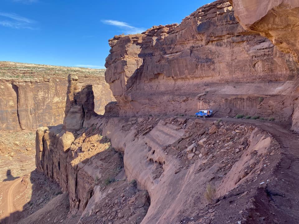

    We spent a good amount of time looking down at the Green River so we decided to take a shelf road down to drive the banks of the river on the Hey Joe Canyon Safari Route.
    Shelf road was beautiful and slightly sketchy at a washout before a switchback but we managed just fine.

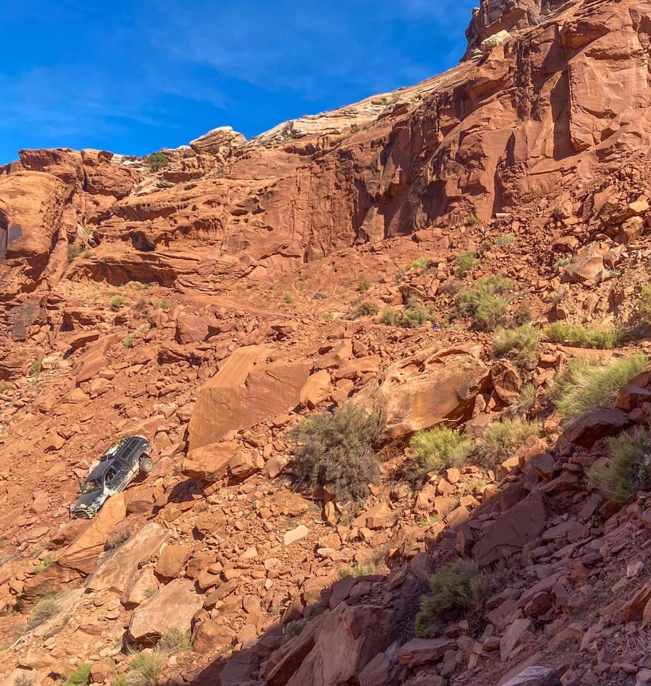

    As we approached we noticed a tacoma down the cliff, it clearly was not there when we came down this trail in the morning.
    Turns out one of the guys got out of the Tacoma for a picture, but the parking brake failed or for whatever reason it started to roll. He tried to reach in and turn the wheel to turn into the cliff rather than off of it, but was too late and got dragged down (unclear how far) with the truck.
    He ended up with a bad head wound, described to us as "spurting blood", which explained all the blood on the ground.

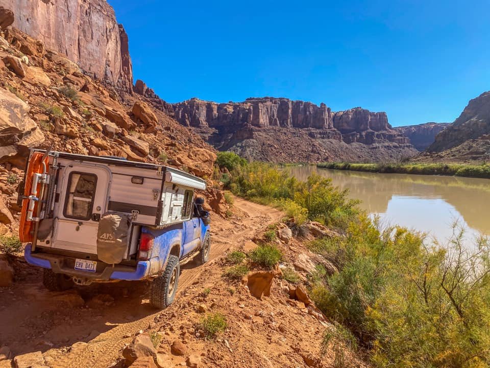

    driving down the pretty shelf
    315595140_10101897604577077_417115698831_8a36de75c4d4eec0ec12f9715578ceb2f5895c62.jpg

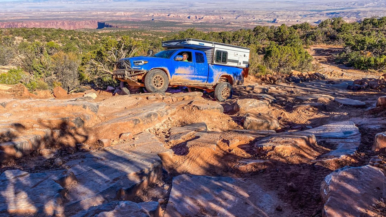

    some climbs up the "top of the world" trail
    316016709_10101898898943157_133247488476_b0fade5fd2f7e10b22ea8a20b40c9aa641dc8632.jpg

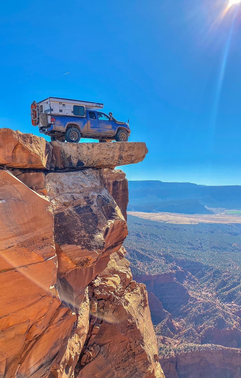

    THE iconic photo at the top
    317933079_10116876527480463_221866016039_ac18335b0eda90b7017bd880921818f792918ab5.jpg

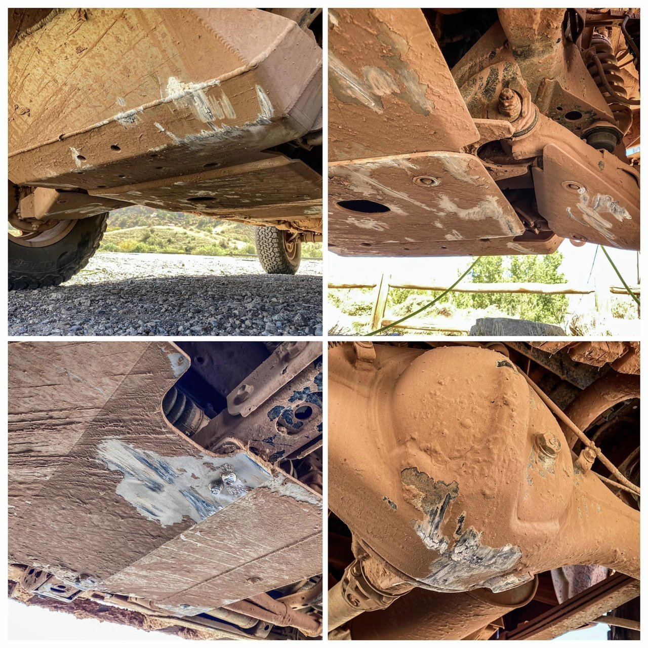

    and the minor scuffs we got
    316134502_10101898899242557_397323895007_537fc0c14c6284be2e043265311bc208f4c99efb.jpg

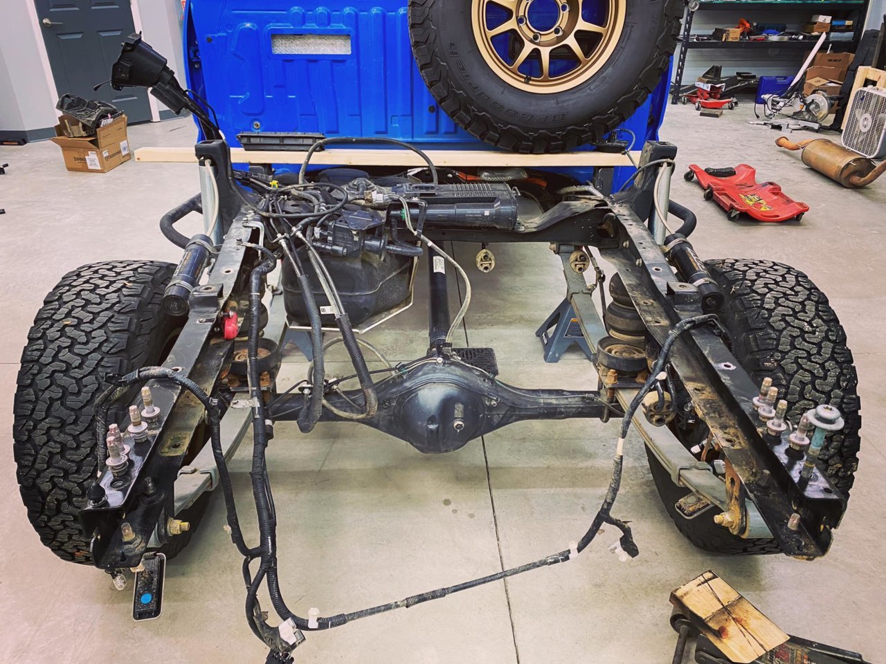

    now that trip season is over, build season begins!
    current status: disassembled.

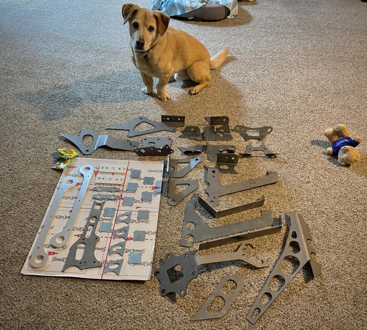

    Hello shiny new thing.
    Dog for scale.
    317988721_10116880287615123_331355497407_da84ba2716c9585275f97471b6c89d7562d06f64.jpg

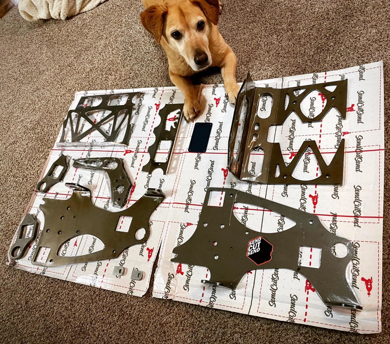

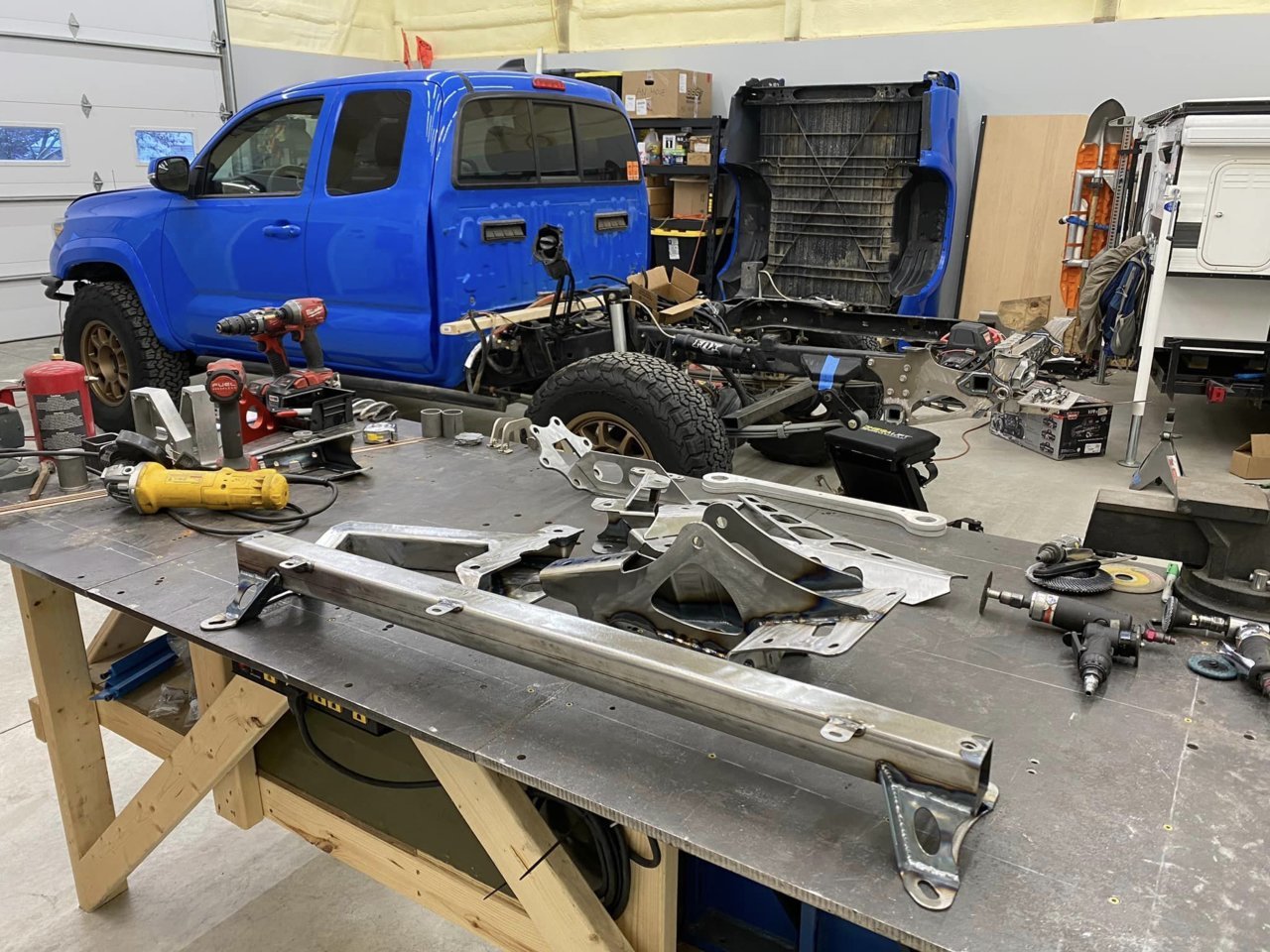

    Finally got the sendcutsend stuff i sent out a while ago. Note to self: make a separate order for anodized parts to minimize the time before they ship
    320736231_897174398305214_66832962412543_adc9eb2f402efc1efe5ed3567c51b2a64430444a.jpg

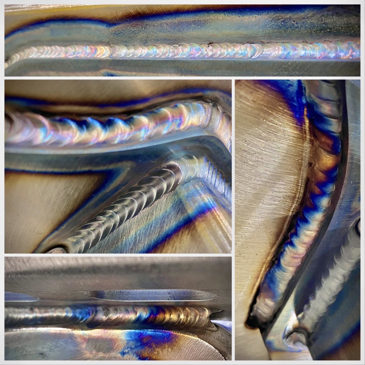

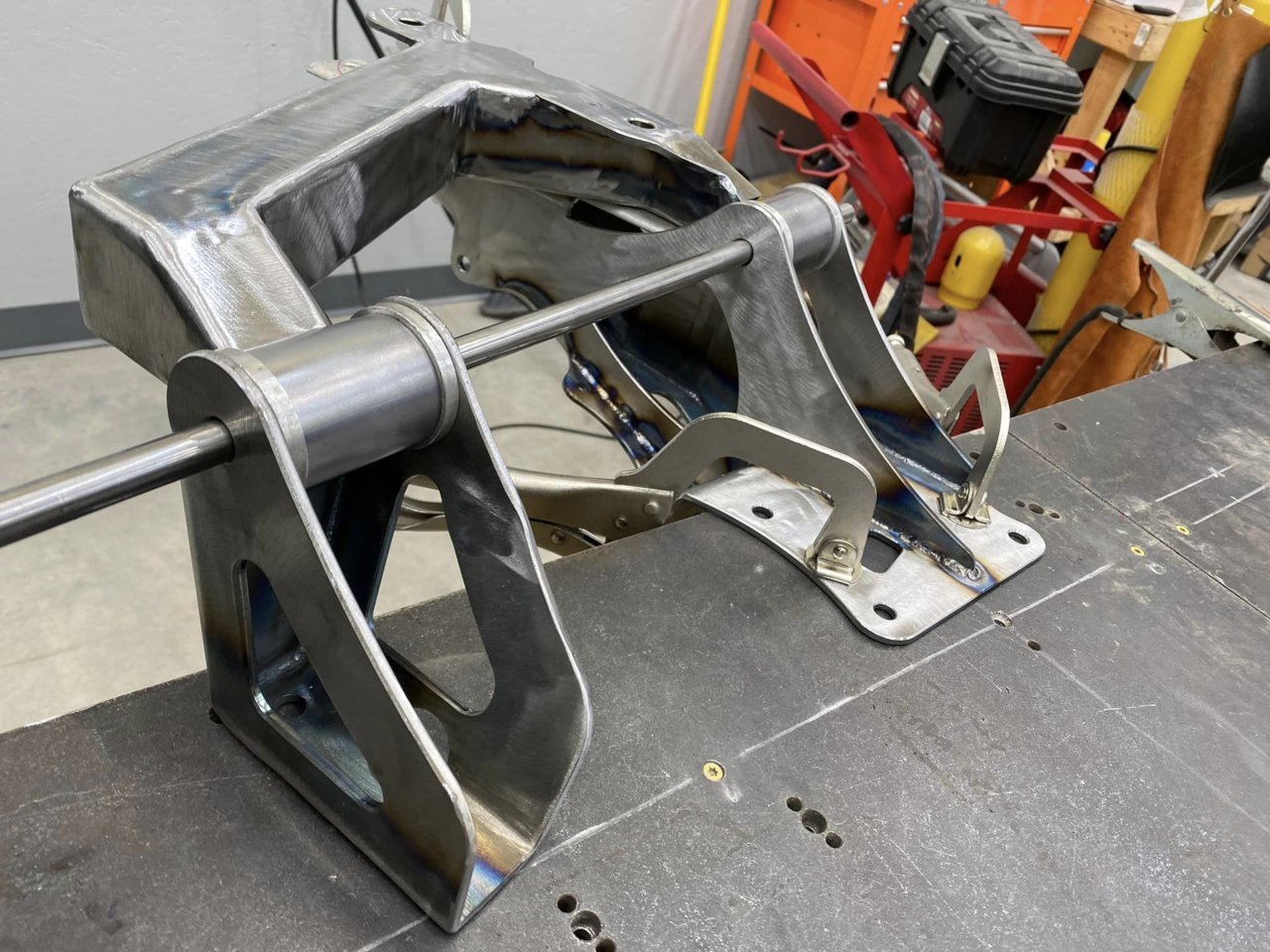

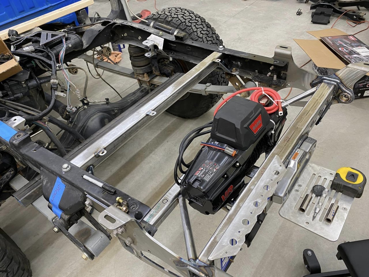

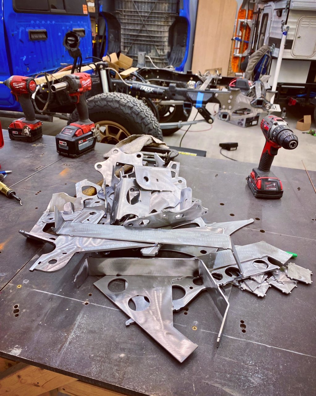

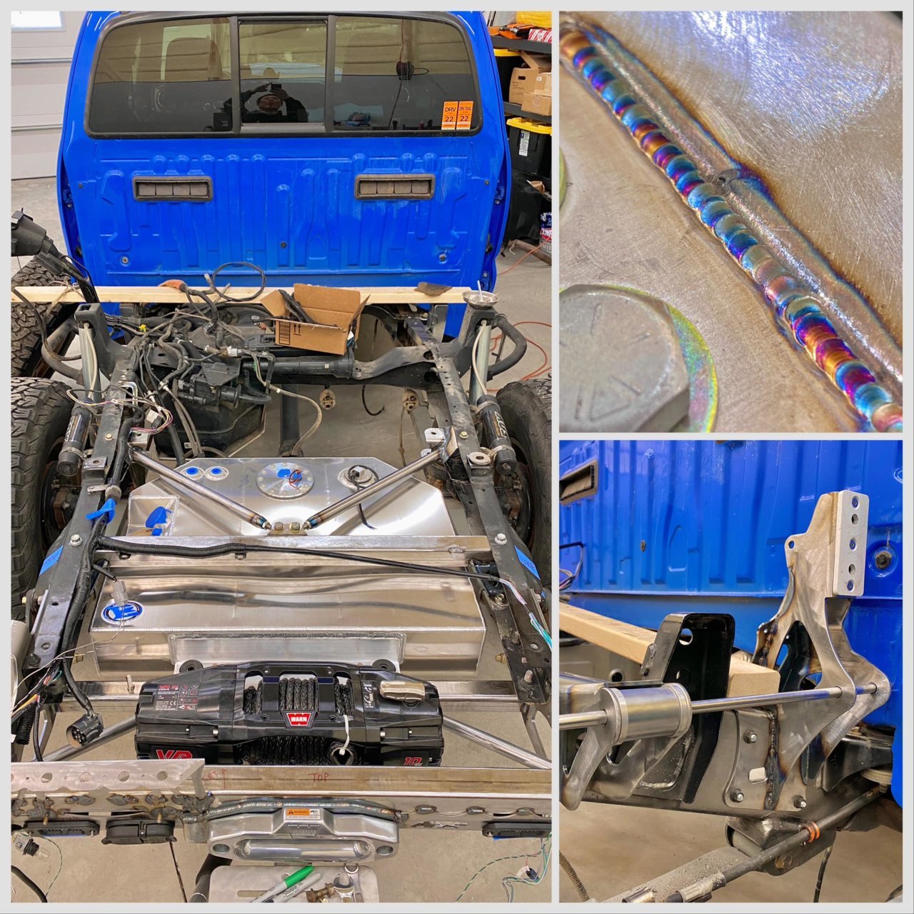

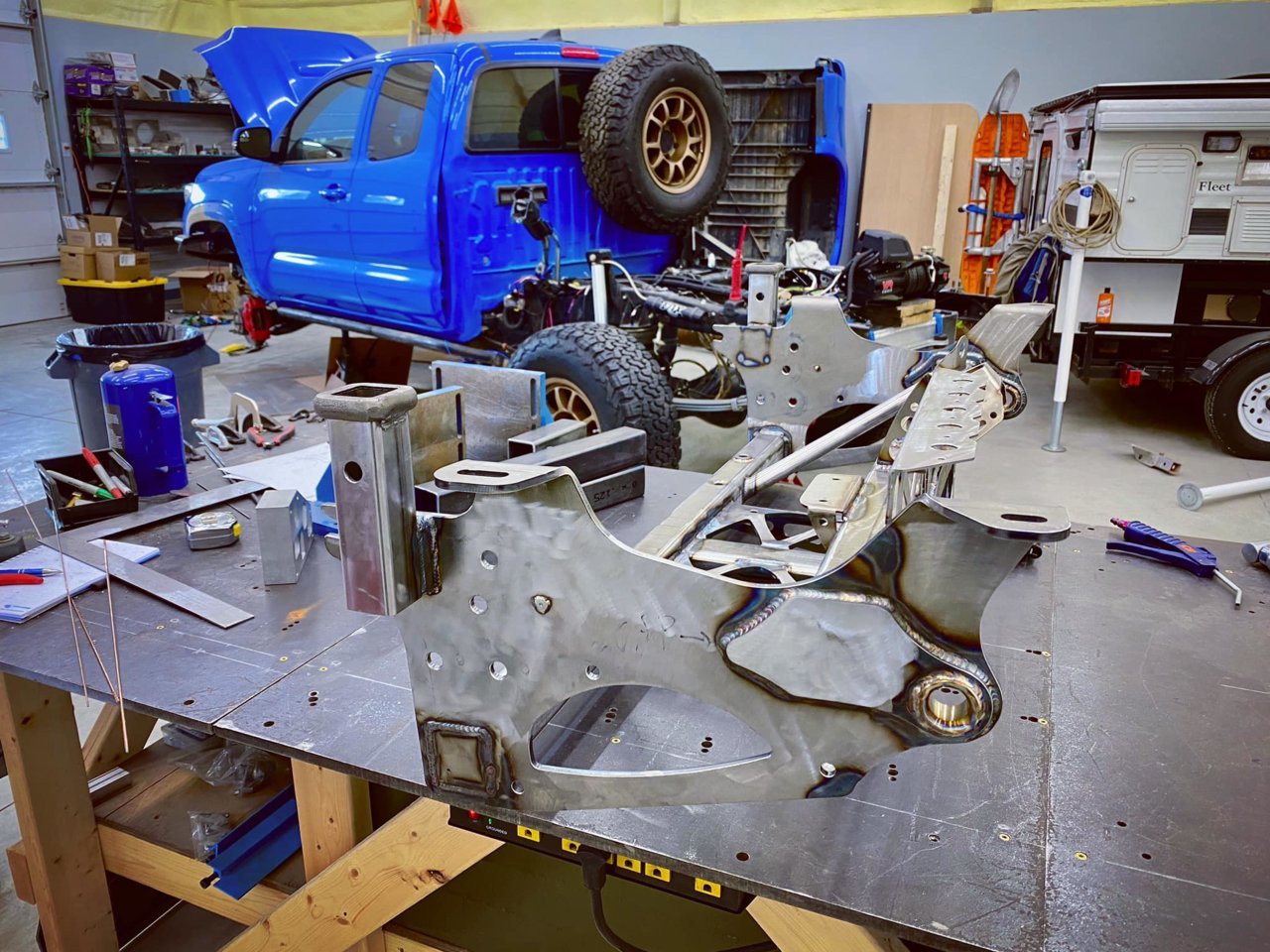

    did a bunch of welding this weekend
    322235136_493934722924797_84019957580569_de0938225eb88cde41a688ce14f886deb87d28e0.jpg

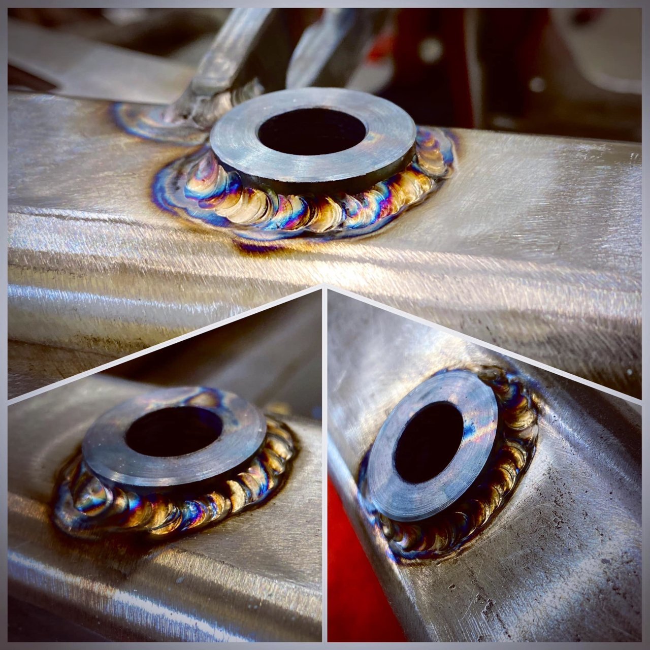

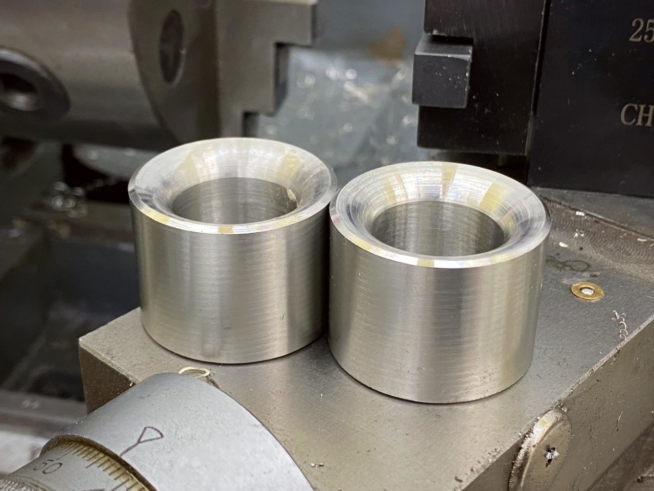

    did some turning
    324147006_689194522903945_79970384071769_5b9116d23edcb81498ae4f5648a958f194100b5f.jpg
    and fitted some tubing.
    structural bits of the winch mount are done
    323780365_1306877299887931_1353583847614_60cf67afce1caa3f28aa63cc4d8909dedba66c8f.jpg

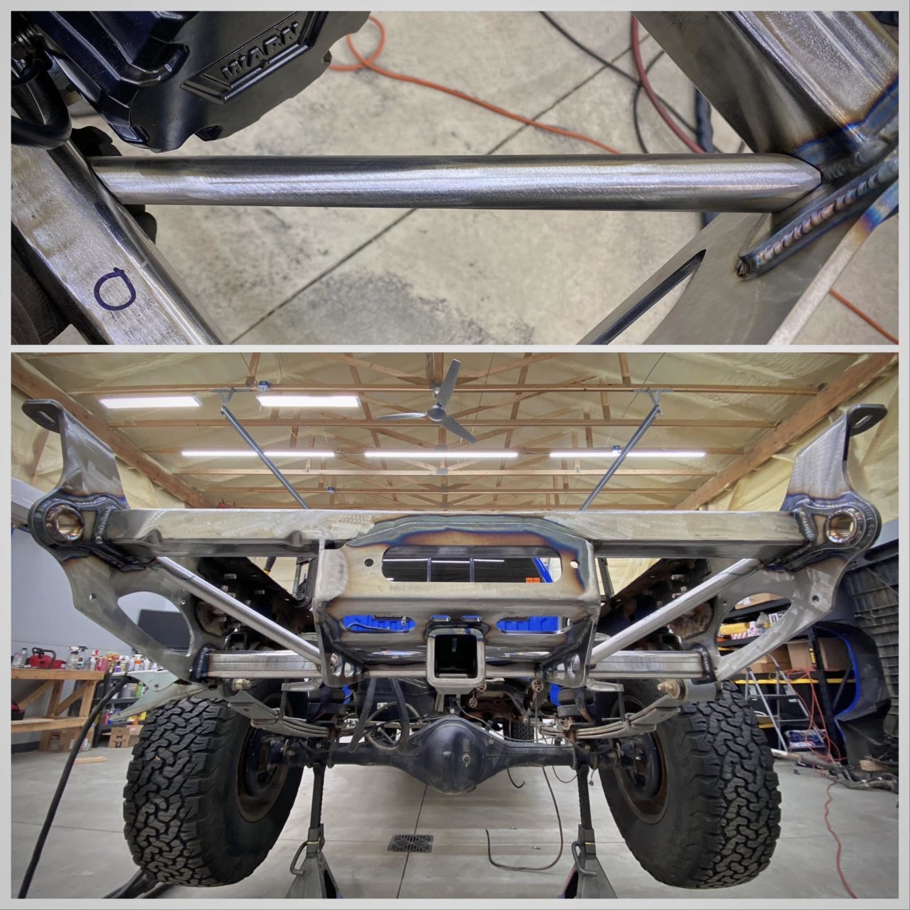

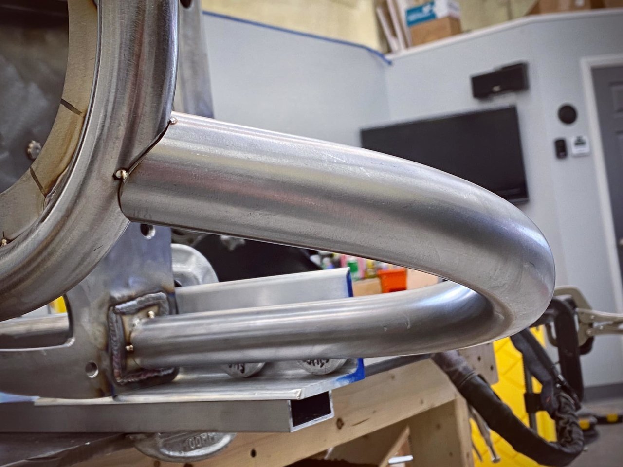

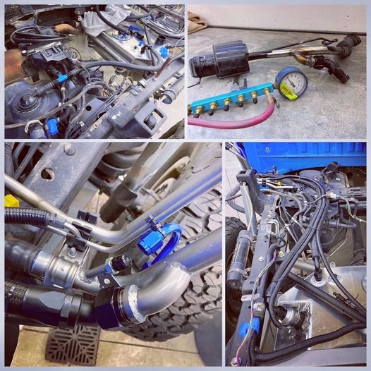

    work has been a bit nuts so didn't have a chance for much updating but here's a dump
    326056136_886327365744324_89167257151596_aadaea06f27e6ef1555665c86dd81b747d939187.jpg
    wishing i had a sand blaster
    326190012_942843959930912_36527292187105_a97e945794f887460a5444b639591e99c36a882b.jpg
    welding them together
    321640091_487247910240892_17593338377719_f5c6f6bf7cc8ef948d6979e2578b5a24c1477373.jpg

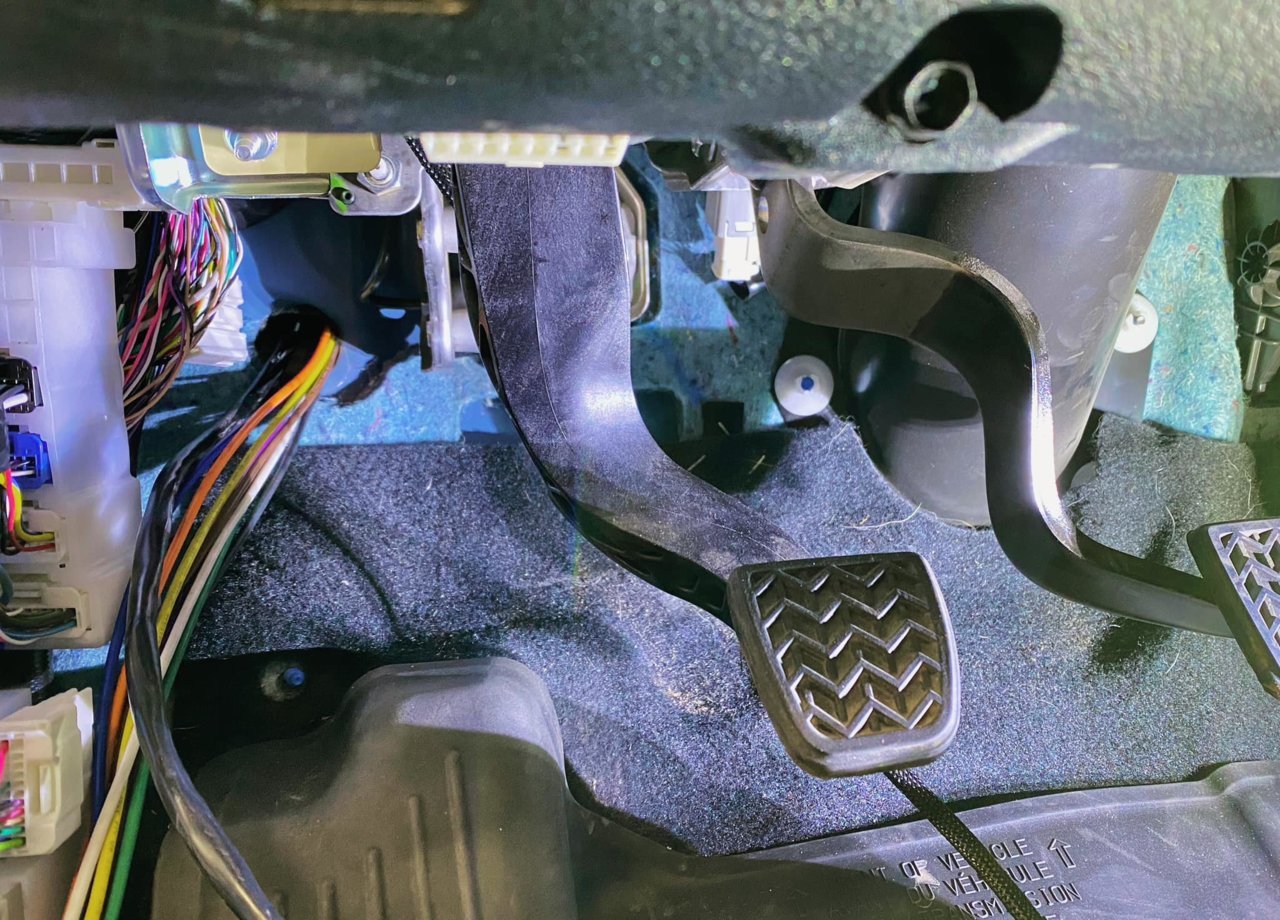

    more test fits.
    you can see i got stock harness clip equivalent tabs so i can route the harness without random zipties everywhere.
    I am fully reworking the stock rear harness but i can try to match OEM quality/attention for reliability.
    327155441_587415389863496_86655797330817_e57be5c0a5ce9cb9053caae1e36b1fb0ee1c57a0.jpg
    323413415_3289795357939461_2382237550824_18ae7fdafb824ed0a603e446e2b5b23b1e73fc1b.jpg

    Making some regularly scheduled weekend progress.
    Just barely got to tacking everything today before running out of argon

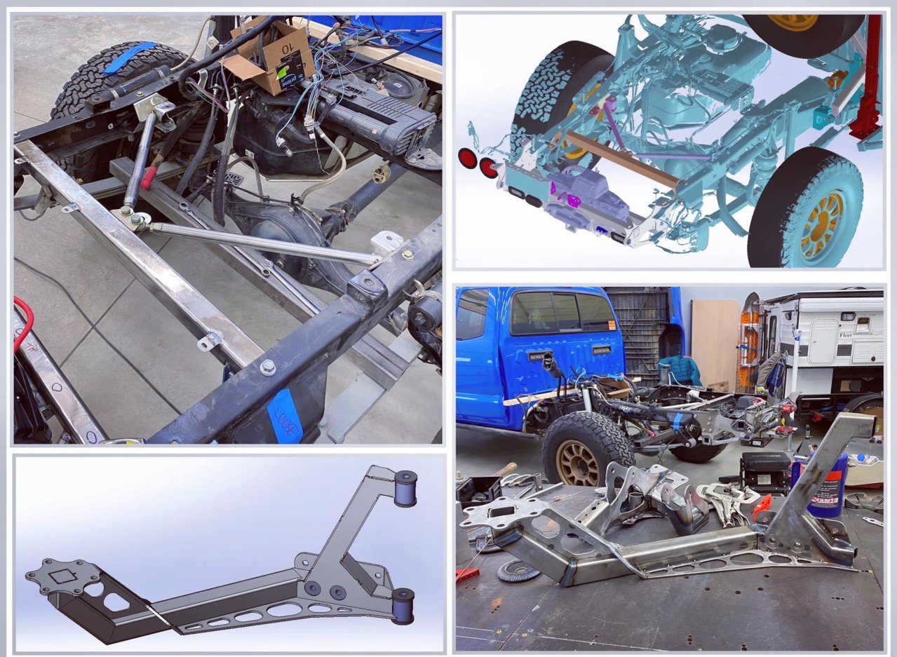

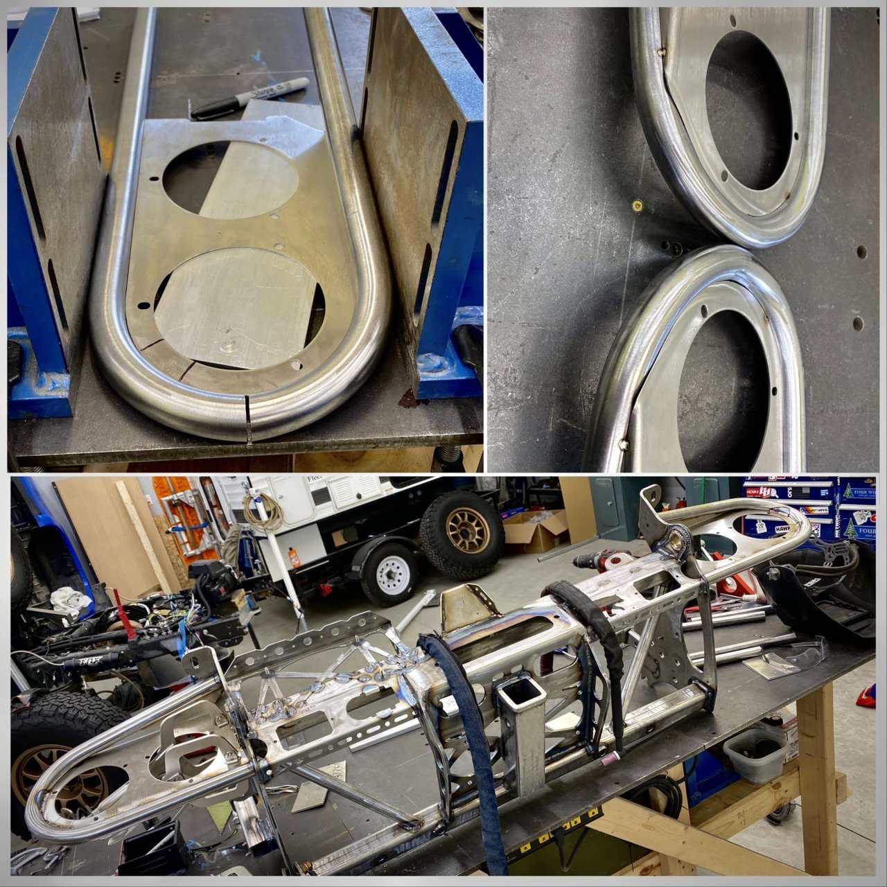

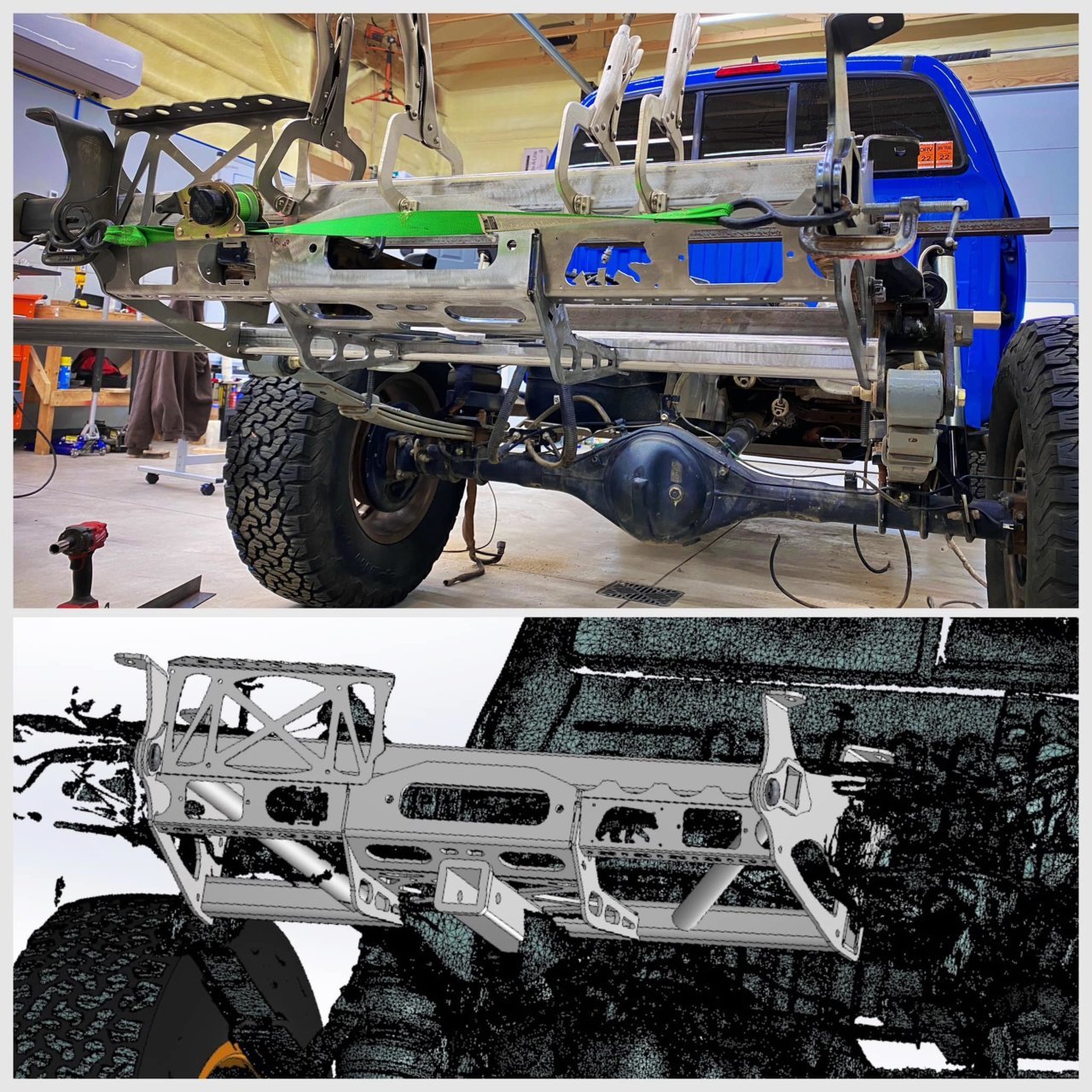

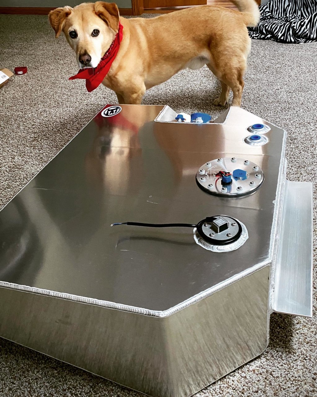

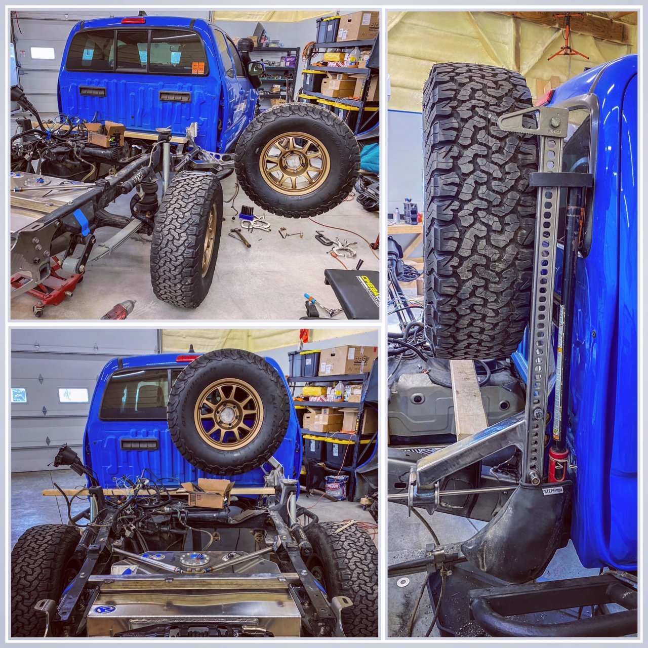

    fuel tank mocked up for the first time, some more welds, and the tire swing out brackets bolted in.
    329177034_1684582168611163_1706230306322_9091af2f5be5514b5450216c1adb202940d9e5af.jpg
    329740182_705279617972591_34711982556075_d042d9f9239cb61b6dad1c695d68498abcc424a1.jpg

    I don’t think too many overland Tacos have all these AN hose and fittings all over their truck but when seeking ultimate reliability this is where I landed.
    Top left: tying the vents from both tanks into the charcoal canister
    Bottom left: now very complicated stock filler neck with some mods -16 hose heads to fill the aux tank.
    Missing a 45 degree fitting to complete the pressure line from the aux tank pump to fill this stock tank. Tiny 1/4” gas pump nozzle shut off vent line thing teed from both tanks.
    Top right: pressure testing the modified filler neck for leaks
    Bottom right: overall layout. Still waiting on some fittings to plumb the pressure line through the filter before heading to the stock filler neck.
    With all this, the theory is I can fill both tanks from one fill neck, and it will self shut off the pump when both are full.
    I can transfer across tanks as needed and no worry of over filling the main tank because the overflow will just run back to the aux tank.
    Also fingers crossed all evap functions work as normal and the diagnostics don’t notice anything.

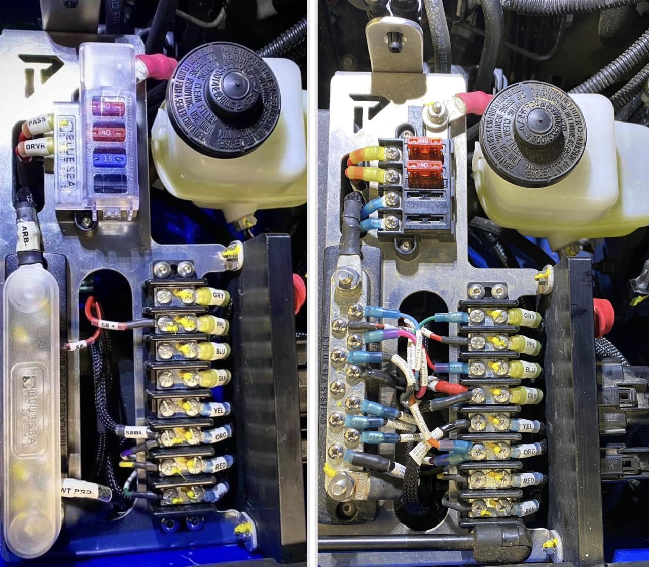

    I finally ran out of room to piggyback wires through existing grommets to poked a big hole in the firewall for more bundles of wires.
    Used this grommet from Amazon, hope it lasts! https://www.amazon.com/gp/product/B09B6W82TD?ie=UTF8
    337396236_5680225768755864_3541977392652_4b11444a0bd6cf69f942d6a138c5224c8ff632f4.jpg

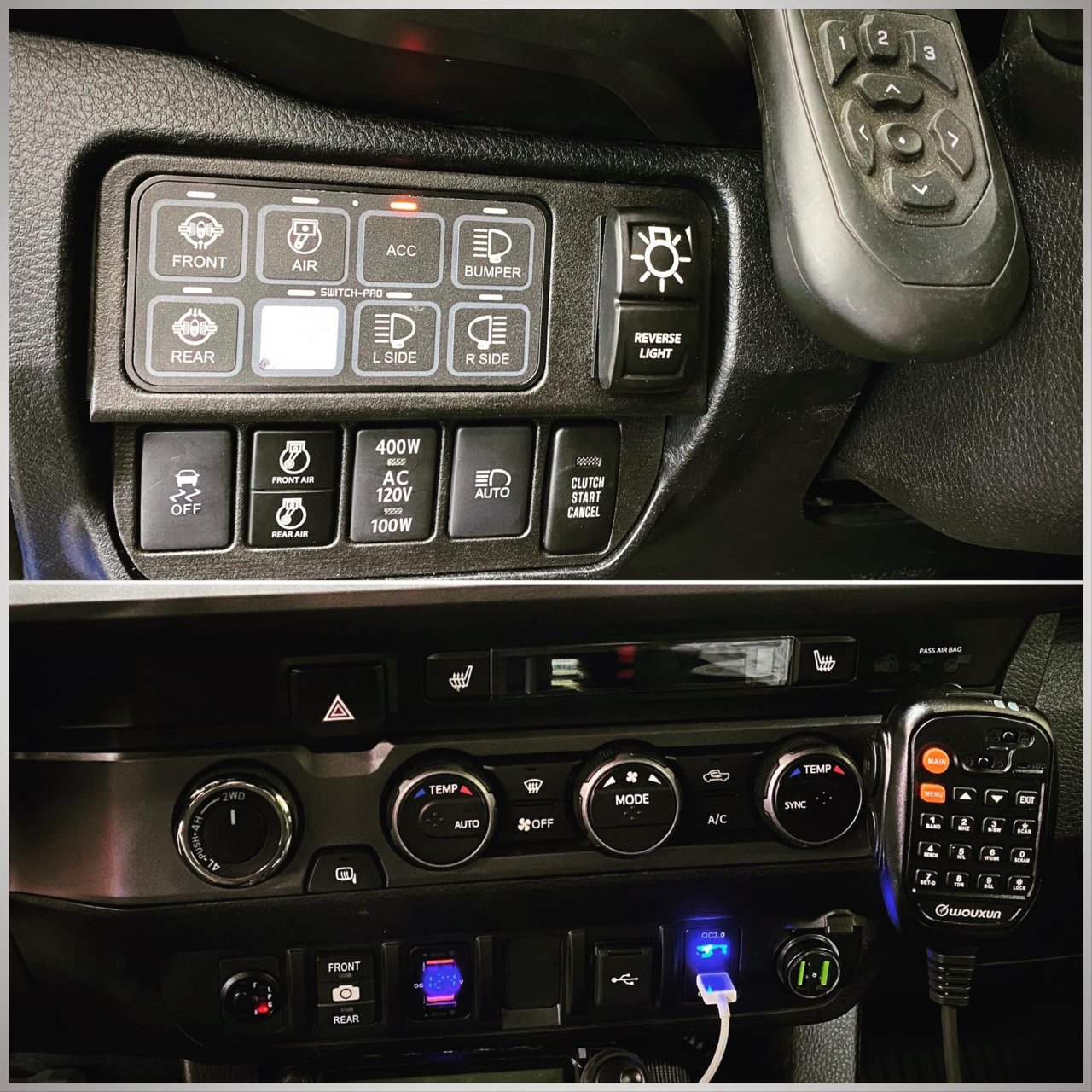

    my powertrays/switchpros is getting pretty populated with wires.
    got a new label maker which makes much tidier labels without having to clear shrink over them to last
    337050346_227513713101579_51999350343778_da207a39207dbf860f3835dd21206722aa397b9a.jpg
    and some more switches. what #overlander doesn't need more switches and USBs?
    New front vs rear air switches turn on and off some valves for the ability to air up the tires per axle from the comfort of inside the cabin.
    not a big fan of the giant gaudy rocker switch, didn't realize how big that would end up, so it'll most likely get changed out later.
    337411692_752671483082467_52338237568314_07f6b33b23079ea3a958f937905a876be00ec8c6.jpg

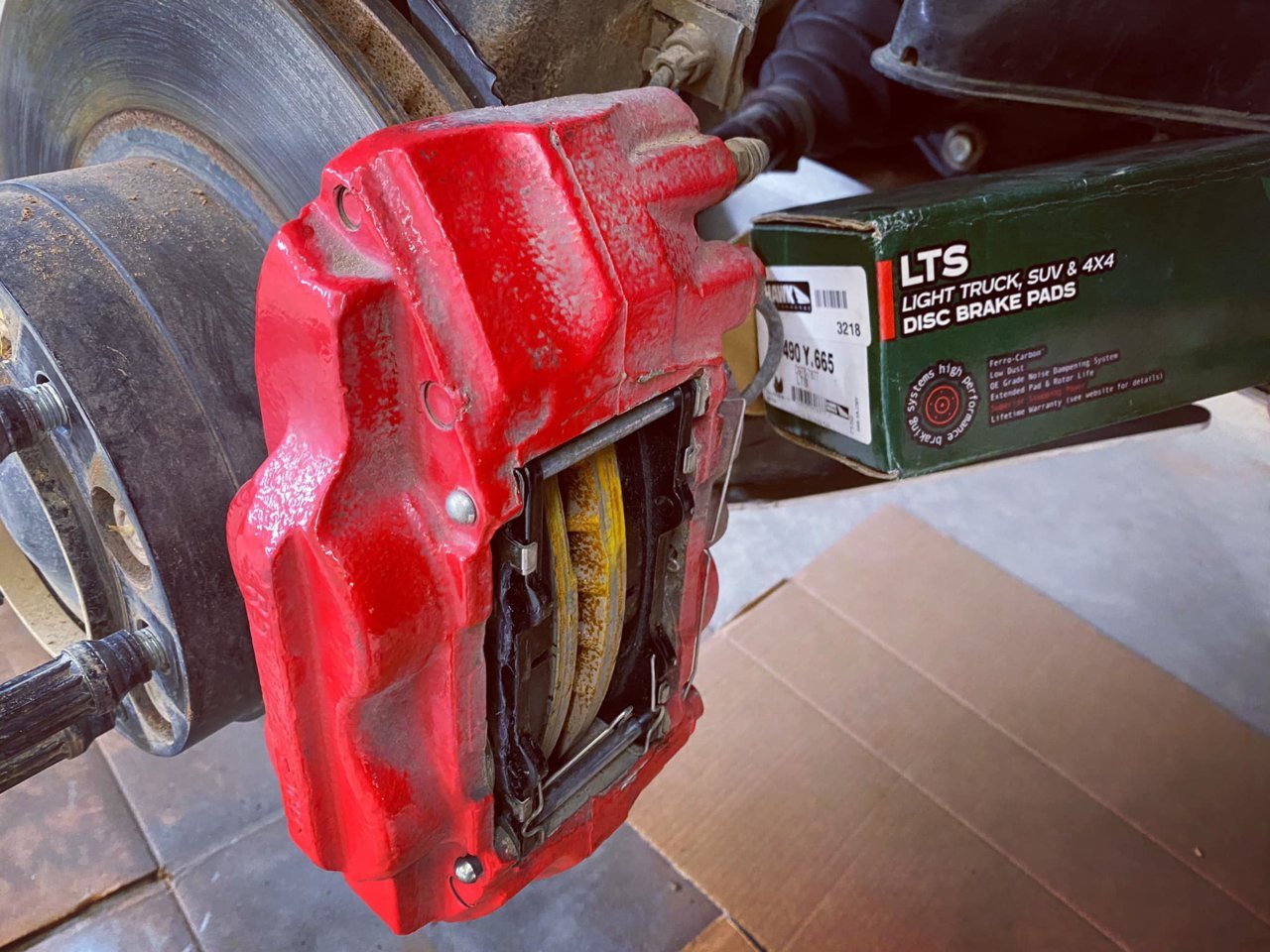

    Trying these Hawk LTS pads for more bite to deal with all the extra weight
    343952378_634222411377463_72417735184172_fc4b751a5d53e451b1a60335312f62e85bfad124.jpg

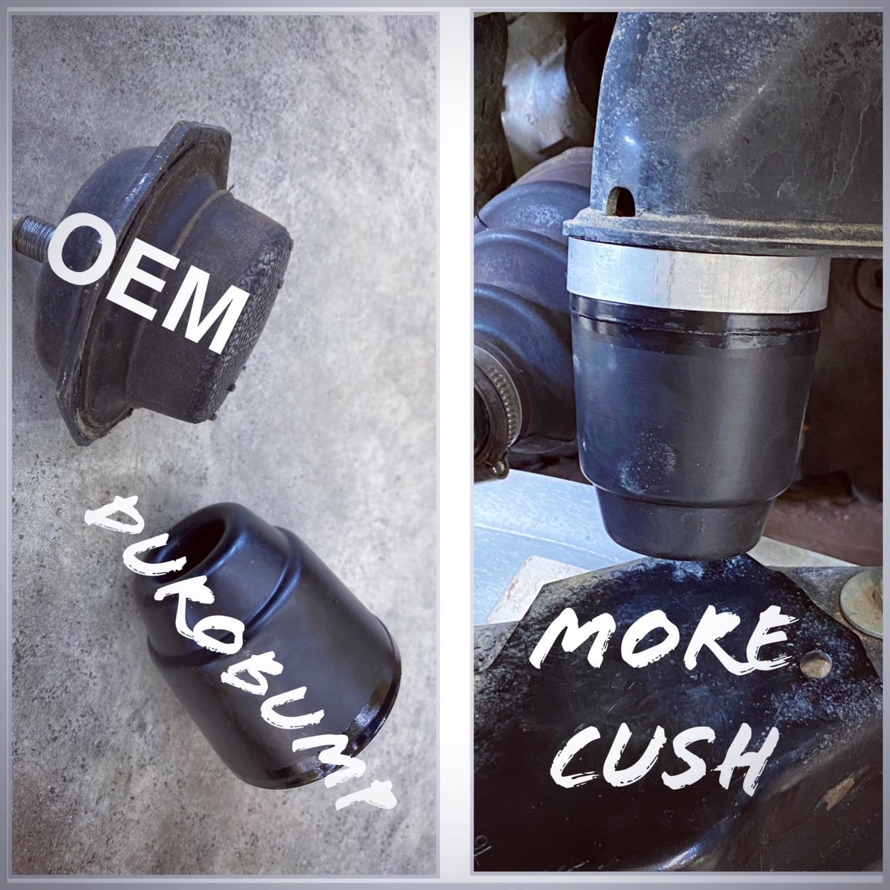

    Trying out some durobumps for more end travel comfort
    344253821_707803097767728_37992835931889_17387d607b36157cdc45b99157b633a3b4447543.jpg

    got some tubes bent up
    345317918_160366906728663_84517094875940_2df1ab2218ae7e94e8d5d1166e5b1ff040d658a6.jpg
    this one was a fun one to notch to get good fitment
    344748875_890913738673552_89913239729816_c95457380d7f4c120b4310a1f84fa5ff79dbba1c.jpg
    and rear bumper welding is complete, finally into primer!
    345569133_776776824095277_18221516527772_9422d024e90d6fedcae14d4f33ec880491a322cc.jpg
