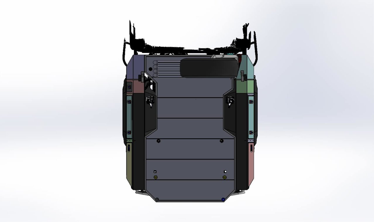

    spent a looooot of time behind a computer getting the cabinet system finalized.
    Who knew it would be so complicated to make sure all the seals, latches, hinges are happy and all the parts are manufacturable via online fab shop capabilities. (really pegging out the size limits constantly)
    but everything is kicked off to SendCutSend, and then a few things to Xometry on parts I could not shrink or split into multiple pieces to fit in SendCutSend's size capabilities.
    now we wait, but luckily there's plenty of bed floor fab to work on while waiting.

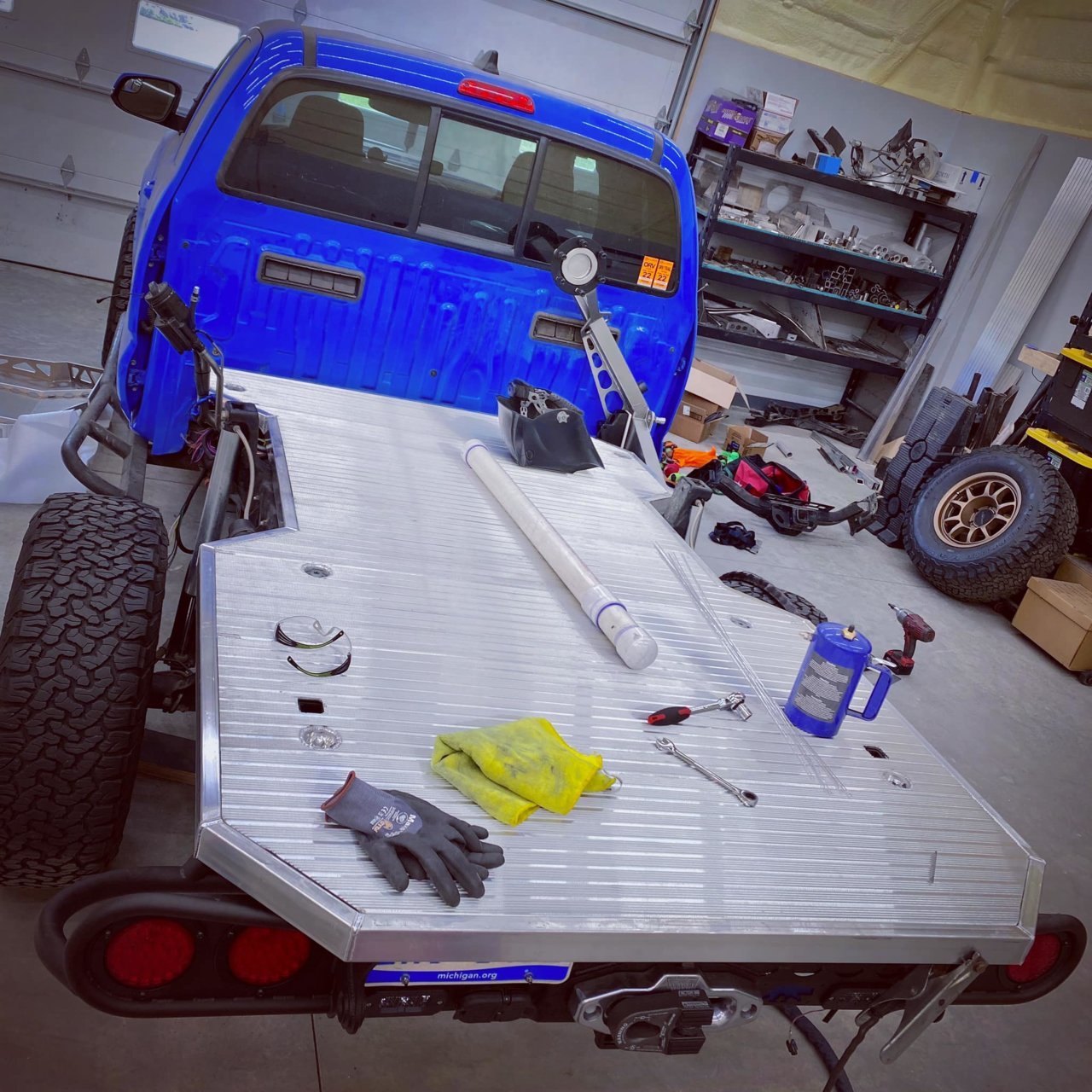

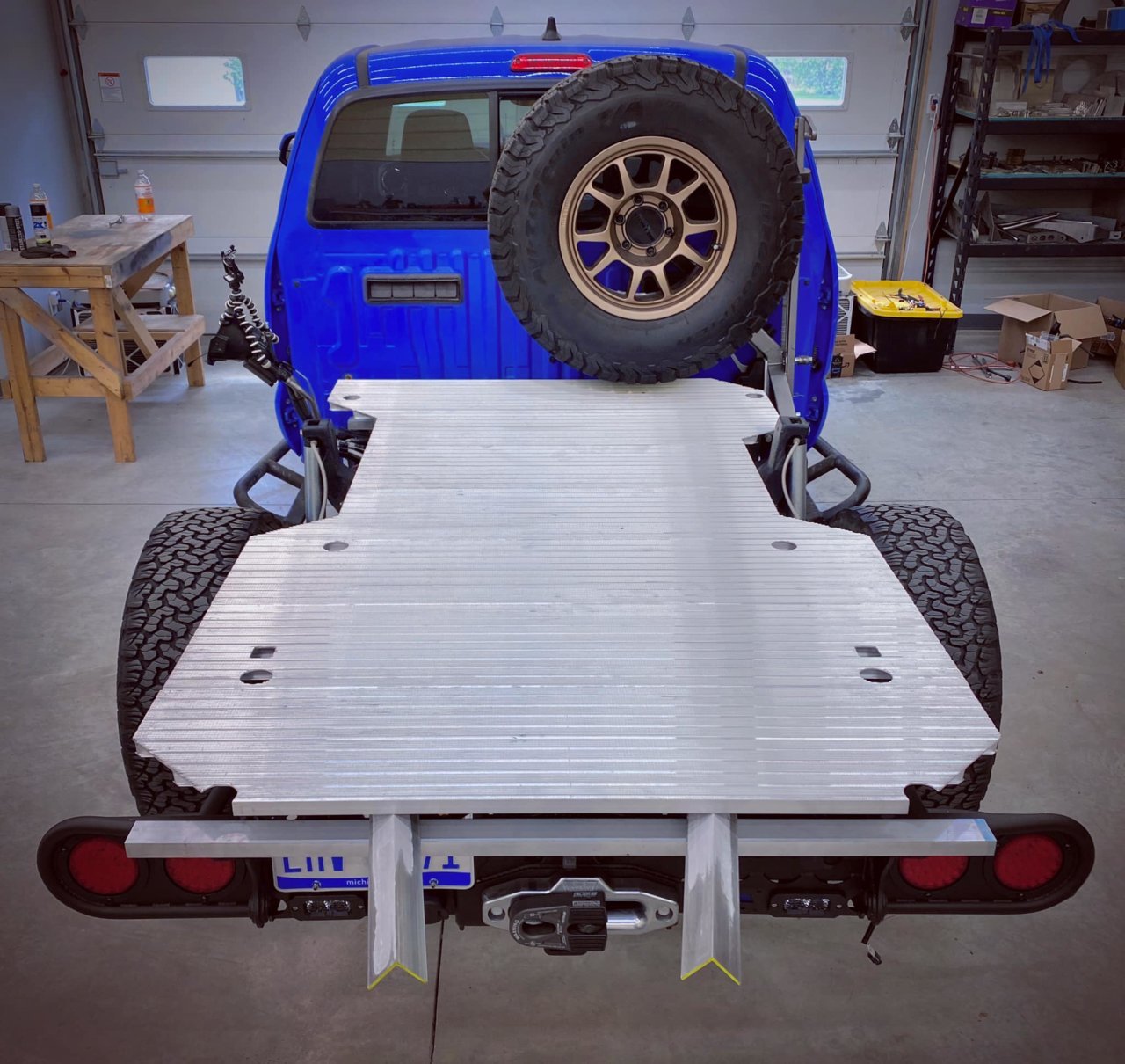

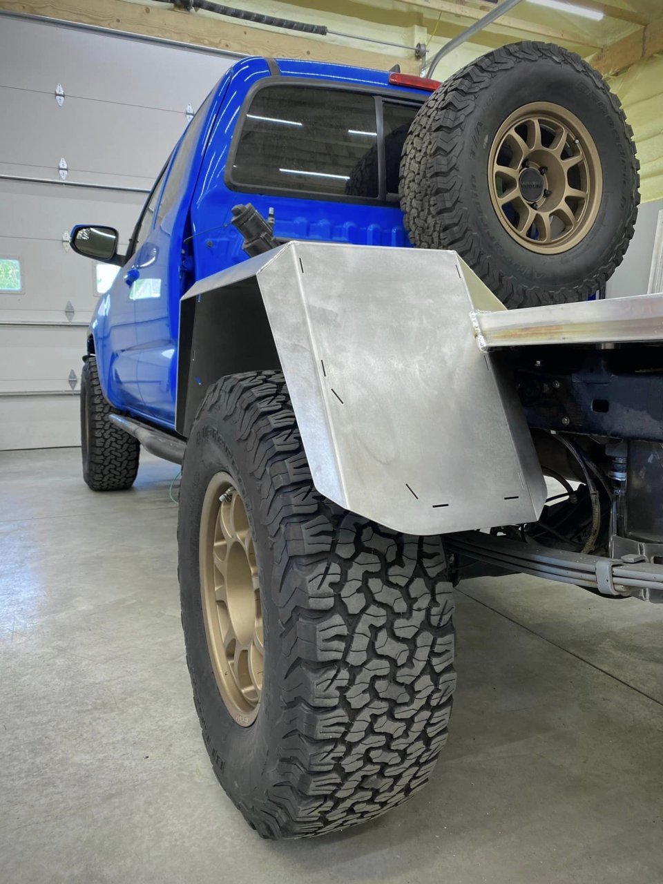

    making progress on the bed floor
    I forget how long it takes to weld everything together when the assembly is just so damn big.
    I TIG everything so it takes extra long compared to the spool gun people.

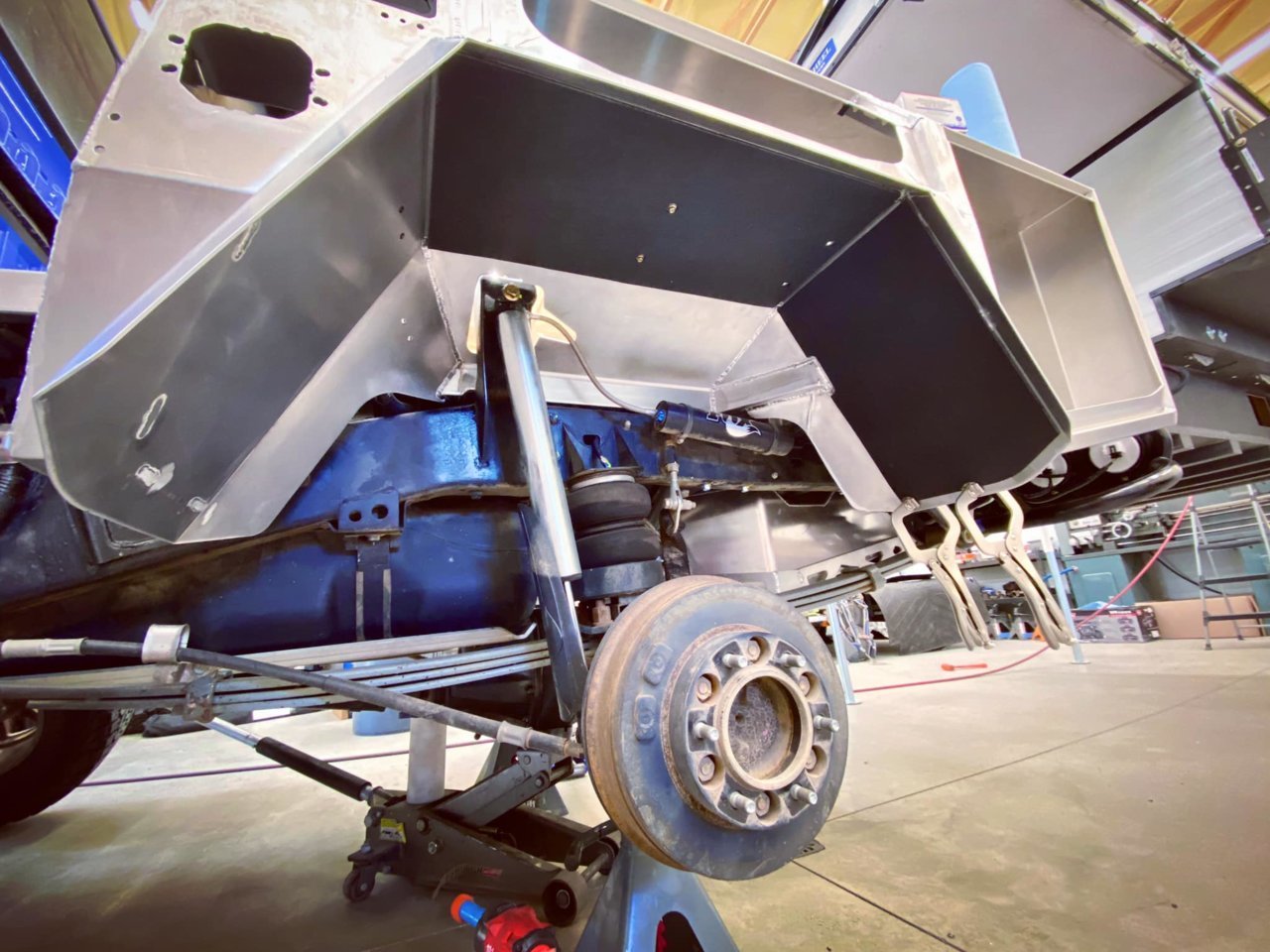

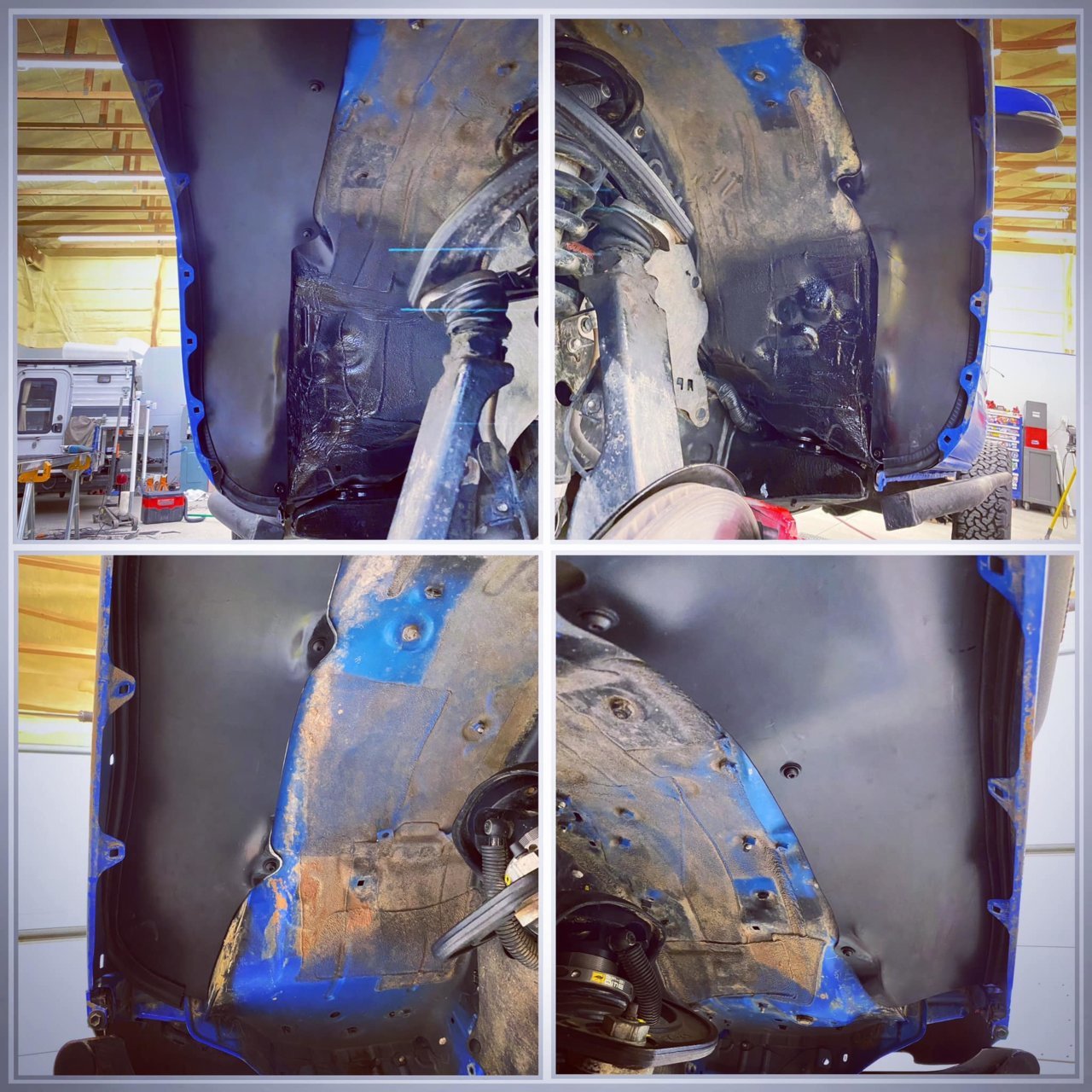

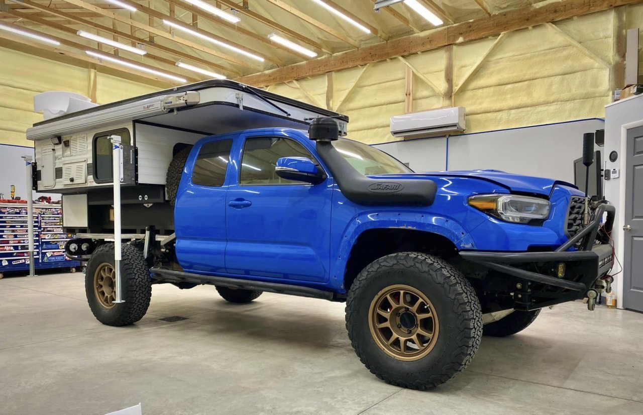

    heat formed some 1/8" ABS sheets for some high clearance front inner fender liners
    356390919_10117563989091883_254050695695_f0ee791745e403bebcdf89dcc90318db249c7911.jpg
    temporarily set the camper on the finished bed floor
    356038951_10117563989136793_221461327208_d5b0920d7f09ebf2038fbb0cbba5203c65b30f11.jpg

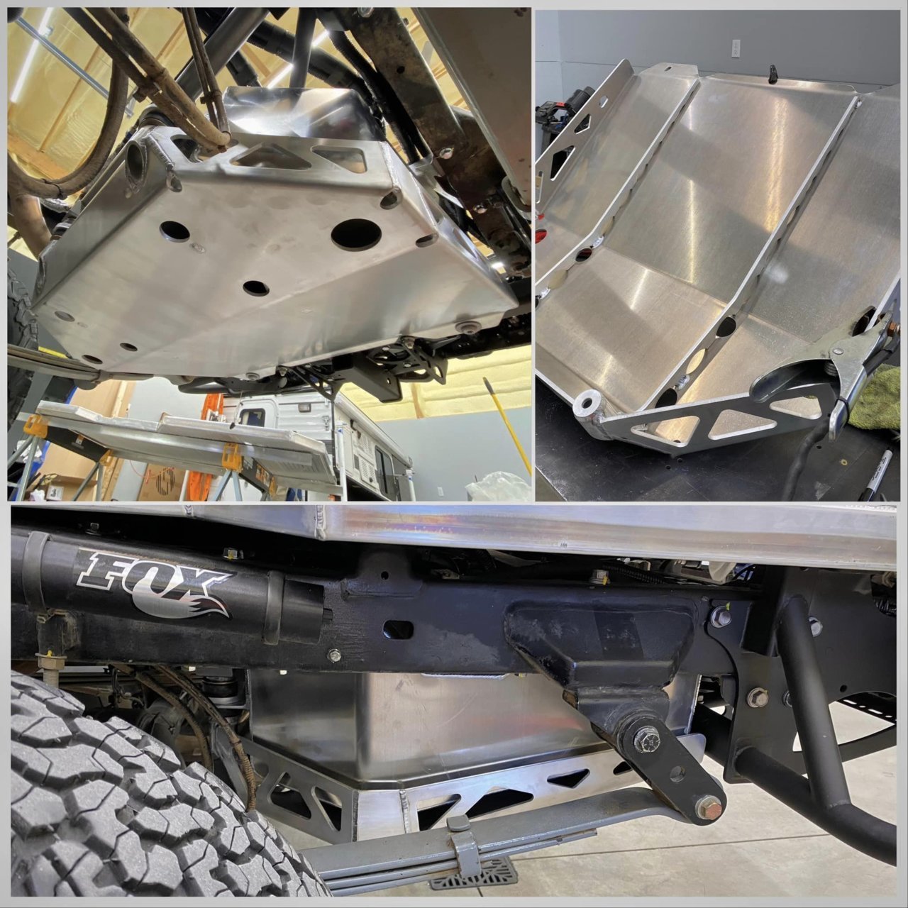

    welded up and bolted on the aux fuel tank skid plate
    357371305_10117580820022563_772541484232_319725764acf9e4d633114e11225be1277b9a07f.jpg

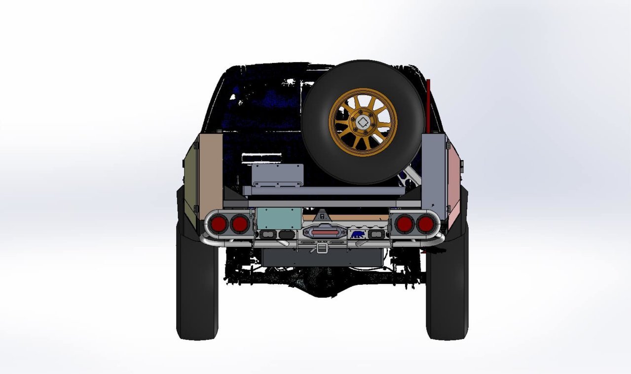

    got a fender mocked on
    347252129_10117580820007593_276089077786_1de55c0ed29cf7ced6b84c05b054097254051452.jpg

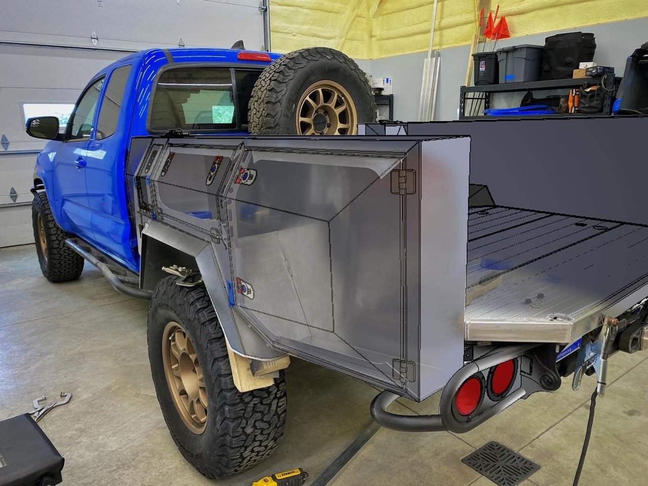

    and photoshopped in the CAD cabinets for what parts i haven't finished welding in yet.
    Should look pretty sharp when done!
    356411846_10117582817714173_311475732716_b1086a04f6ea978de96d57790d3a24befb58f7c3.jpg

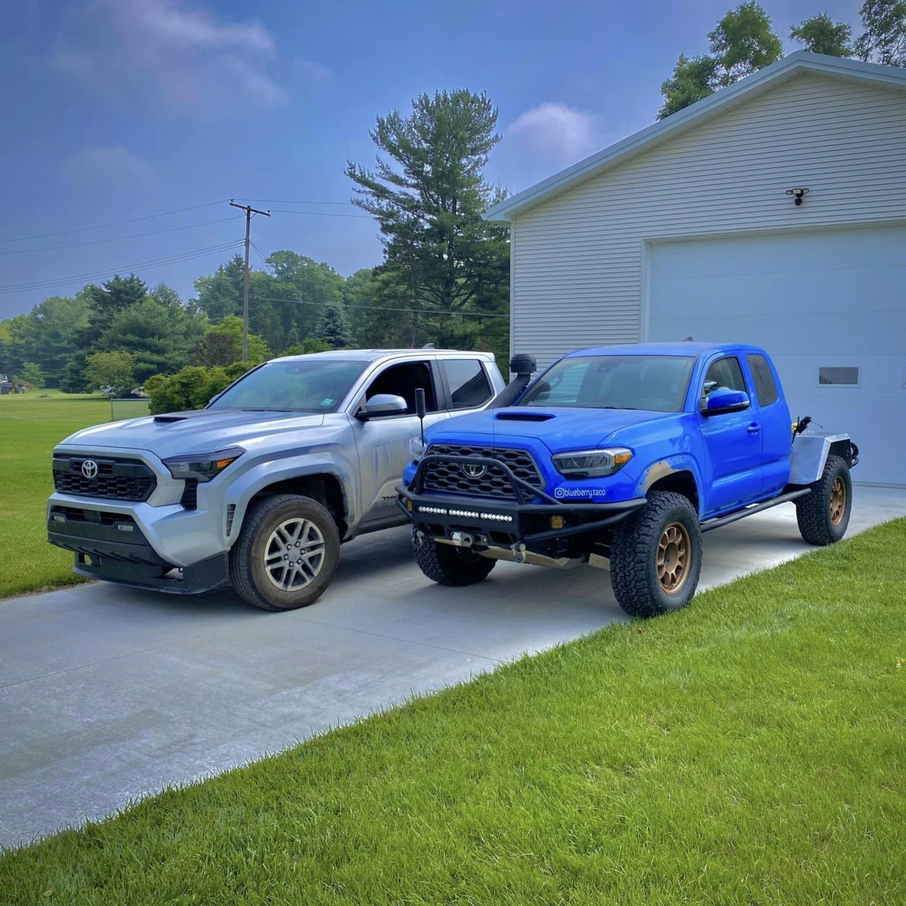

    oh and hung out with the pudgier younger sibling.
    357592833_10117580820212183_705902412083_182c256a18fc719b21f1e93585d7602b09350772.jpg
    words cannot describe how big that airdam is, and how much bigger overall the whole truck feels from both inside and outside

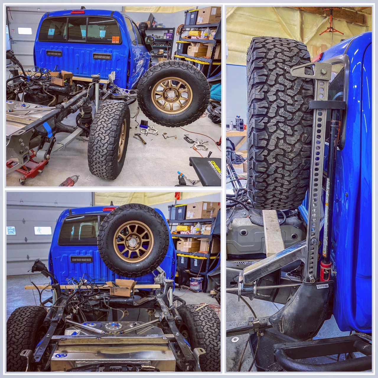

    Subbed AF for this build.
    I see the swing door for it, but does the spare tire arm pivot down?

    Yup,
    329740182_705279617972591_34711982556075_e3e1cf51a2136a80cc0cfc74c53b019acce123df.jpg

    been busy doing shakedowns every weekend since the mechanical bits were finished up. so quick update.
    sheeted the inside of the aluminum fenders with ABS sheet to help protect the aluminum + keep the rock pinging down

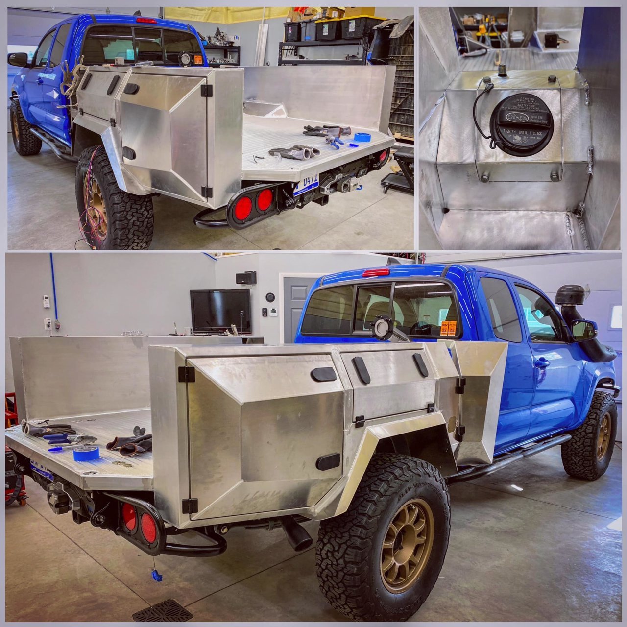

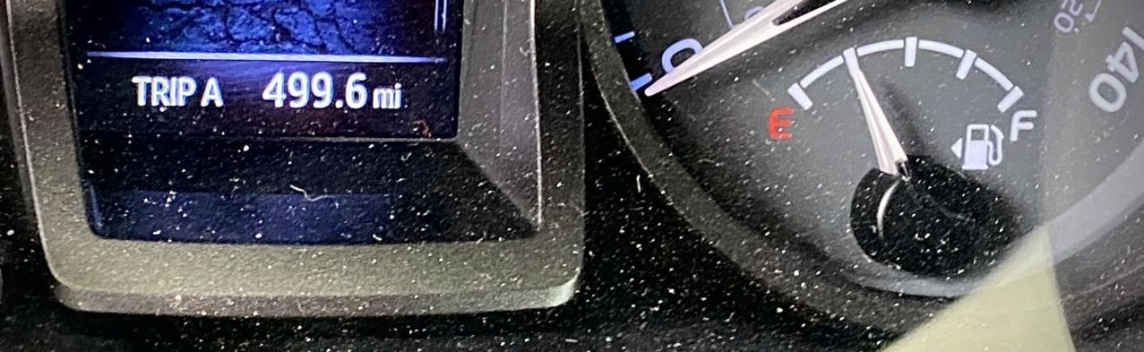

    first shakedown was to mainly test the fuel system. Happy to say we successfully ran over 500 miles on a single fill up, no issues, no CELs, and fillup was a breeze.
    with the single fill neck, just the main tank fills at the first click of the pump, then slow down the fill rate to fill up the aux tank, which then auto shuts off the pump when that gets full too.

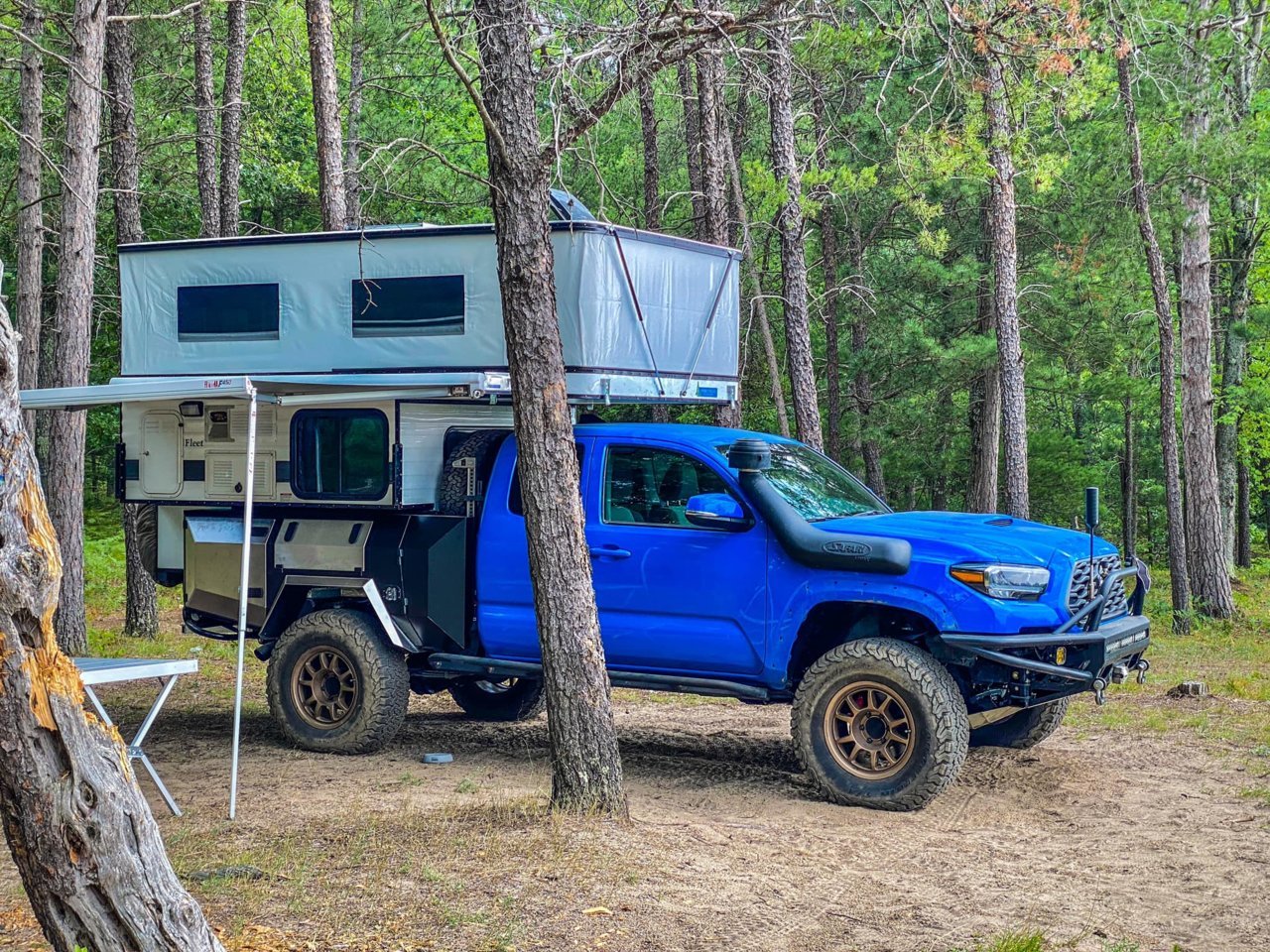

    Following weekend we took it to a local ORV park with the camper on to do some more articulation and bumpiness testing, and used the sand drag strip to do some light suspension tuning.

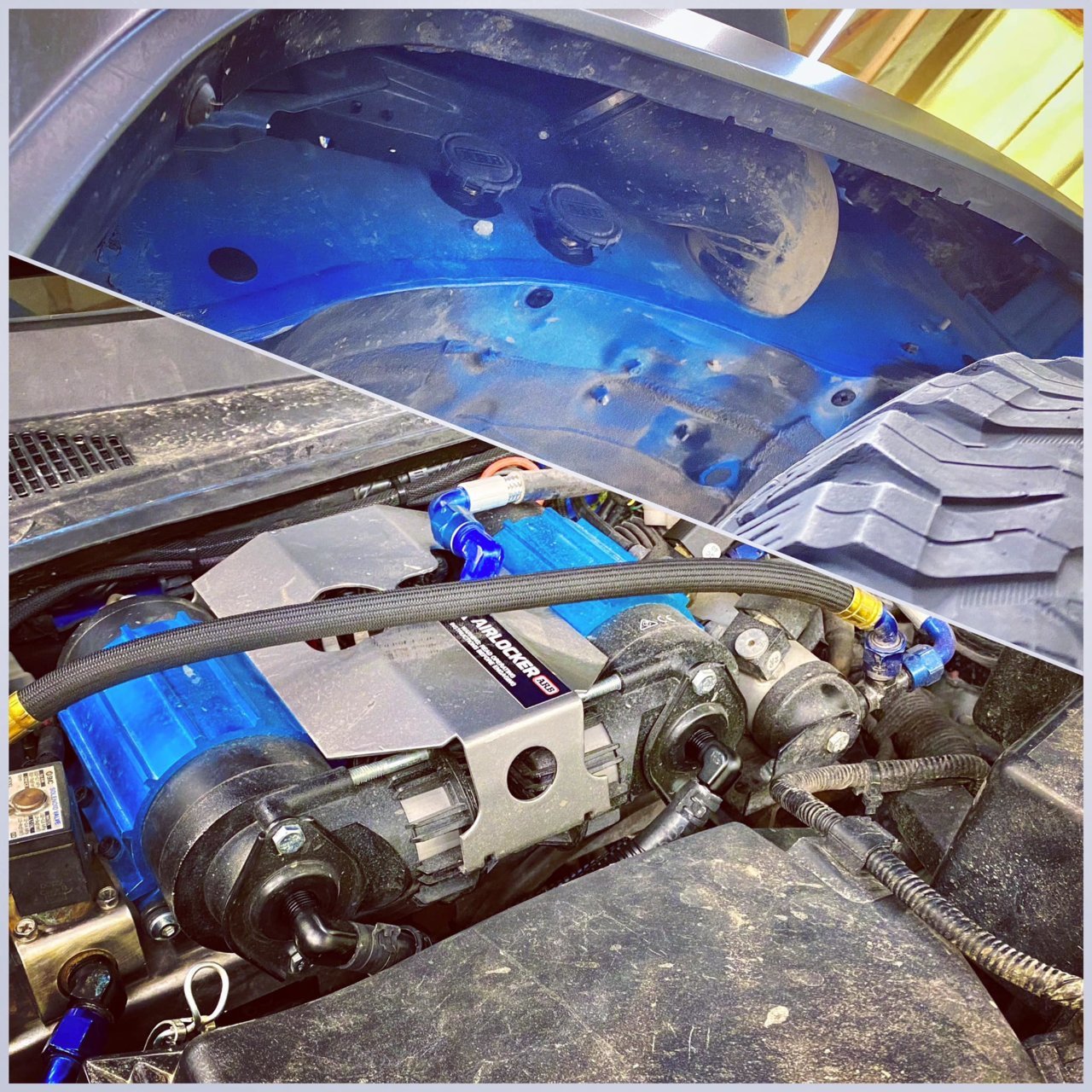

    added dual cold air intakes! ...for the ARB twin compressor
    I'm using the Slee bracket in the engine bay and always pop the hood when I'm airing up, but been killing the pressure switch due to corrosion every year.
    ARB has been great at sending replacements, but the 3 year warranty just ran out so I'm trying to keep the switches alive longer.
    My theory is the hot/warm air from the engine bay contains a bunch of moisture and when it cools, it condenses and rusts out the pressure switch.
    hopefully by pulling cooler air from above the wheel well will keep intake temps down.

    Coastal HC Front, 6112s+650lb King Coils, JD 62 Swap + 14" Fox 2.0s
    I'd be concerned with splashed up mud/dust/debris in the exposed fender area. I'd probably make some covers that can be popped on and off for peace of mind in that location.

    How much weight are you at now?
