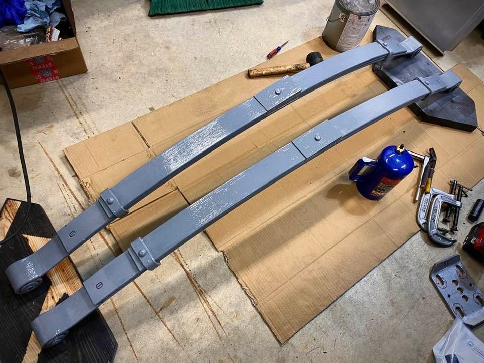

    new chevy leaf pack with the overload removed (with airsprings I wont need them) and 4 deg shims clamped in and painted.

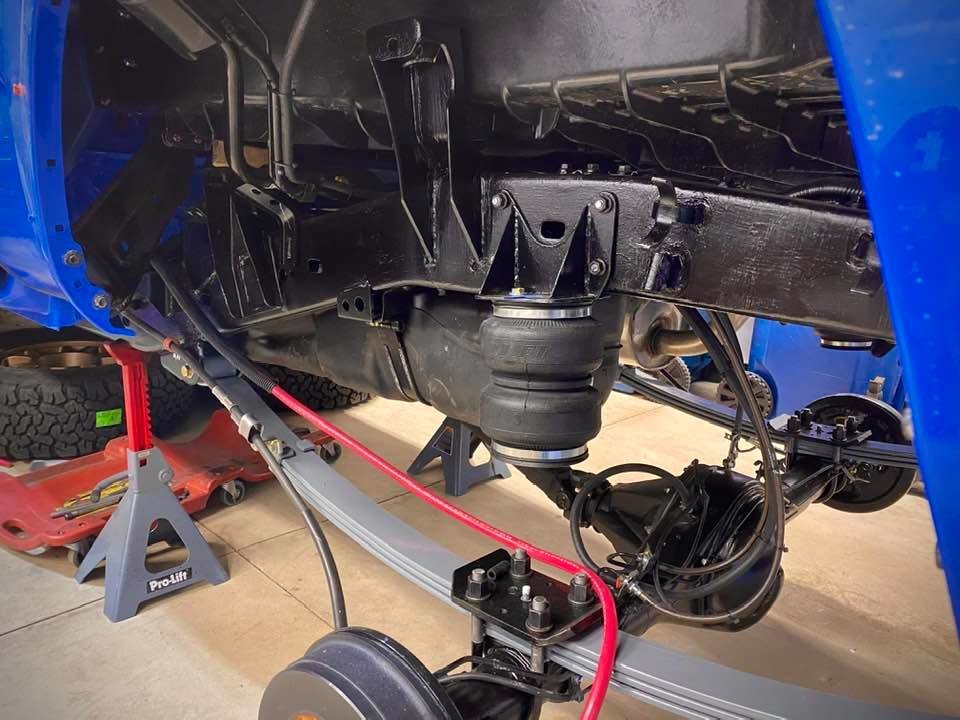

    over the weekend i did a bunch of painting to finish up the frame, axle, and suspension bits, and started a soft assembly.
    everything still bolts together which is always a good sign.
    little details:
    - modified the wheel speed sensor harness hanger bracket direction/orientation and a couple bends so i think i can get away without having to extend those.
    - cleaned up the shape of the upper air spring perch to minimize excess material
    - added a clip point for the parking brake cables to both the front leaf clamp and the mount bracket, similar to how the stock toyota ones were.
    - you can just barely make out the extra fuse block and ground stud bracket i welded to the frame in front of the front bed mount bracket, and started running the 2/0 wire from the engine bay to it.
    I'll be using the MEGA fuse block here as a terminal junction for the house wiring in the bed (in the future) and to the rear winch setup (also future). There will be a 500A MEGA fuse from the battery to this fat wire. I ended up pulling the stock exhaust out and running this above the stock heat shielding
    138655641_10114476229866123_512463977866_d55e12bcfa6f4997d0fa0a1f1261937d527e62f7.jpg

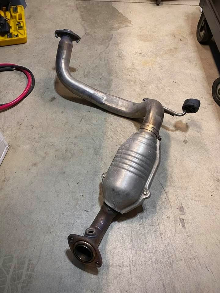

    had to pull the exhaust to route the 2/0 wire over the heat shields and to the engine bay.
    I'll be making a new crossover pipe while I have it out to gain the ground clearance lost by the factory pipe.... once the new stainless bends arrive. (I'm too used to prime shipping, multi-week waits feel ridiculous)
    140732352_10114485304265953_290194209170_a1e7dc3b2e1d1b30670dfcb47942fbb2d8f70492.jpg

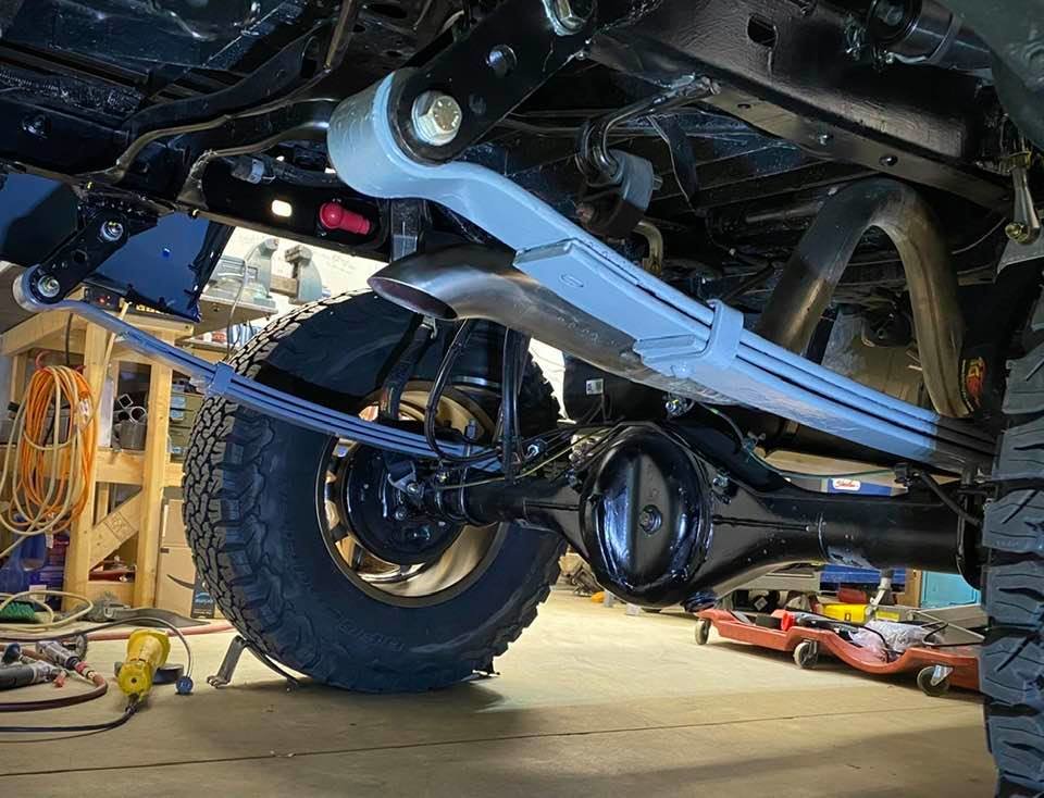

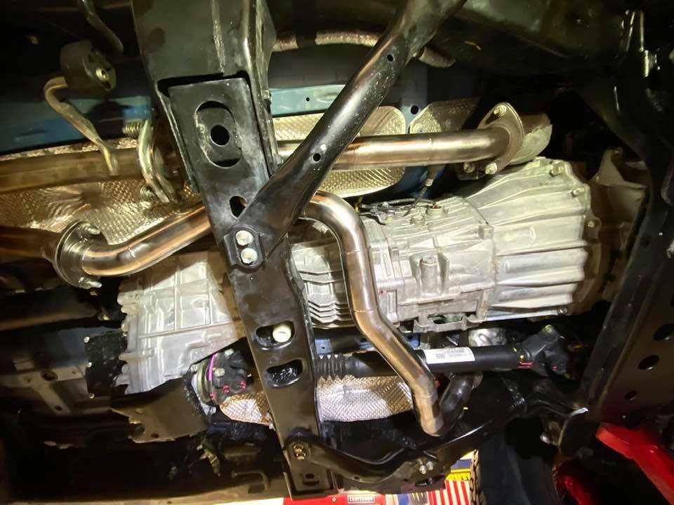

    just finished up an exhaust reroute. did it a little differently than what I've seen but I'm super happy with all the clearances, all mandrel bent 304SS, I made it so it's a "bolt-in" to the manifold and factory Y pipe.
    I made sure to keep the pipe far away from both the u joints and the "extendy" portion of the front driveshaft boot, while also making sure it wont get in the way of draining the trans.
    142277616_10114513089449223_295426392879_6bb392b2d85b02639c6144adee9f203c60327dde.jpg

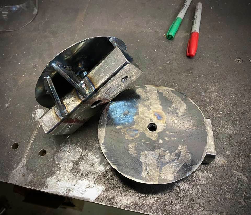

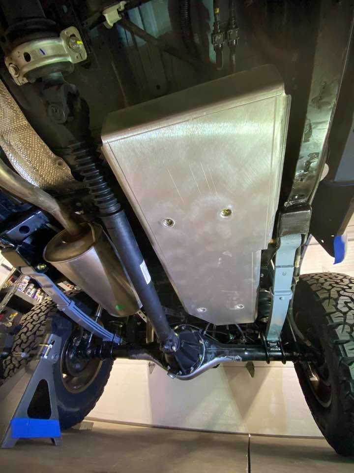

    The lower air spring perches became a lot more complex than I wanted them to but they’re done now. Who knew u bolt flips would be annoying on the top side140868500_10114517035690923_645688897532_4e91d04b36775270e5ff3bb03854626b64ccb543.jpg
    also gained some fuel tank protection.
    ended up drilling and welding in studs to the stock tank straps and the skid needed some clearancing to the new leaf spring hangers but otherwise a good fitment.
    141408550_10114517044119033_786732661749_39a2459e793c39f6b34f98327dee5799b272e1bf.jpg

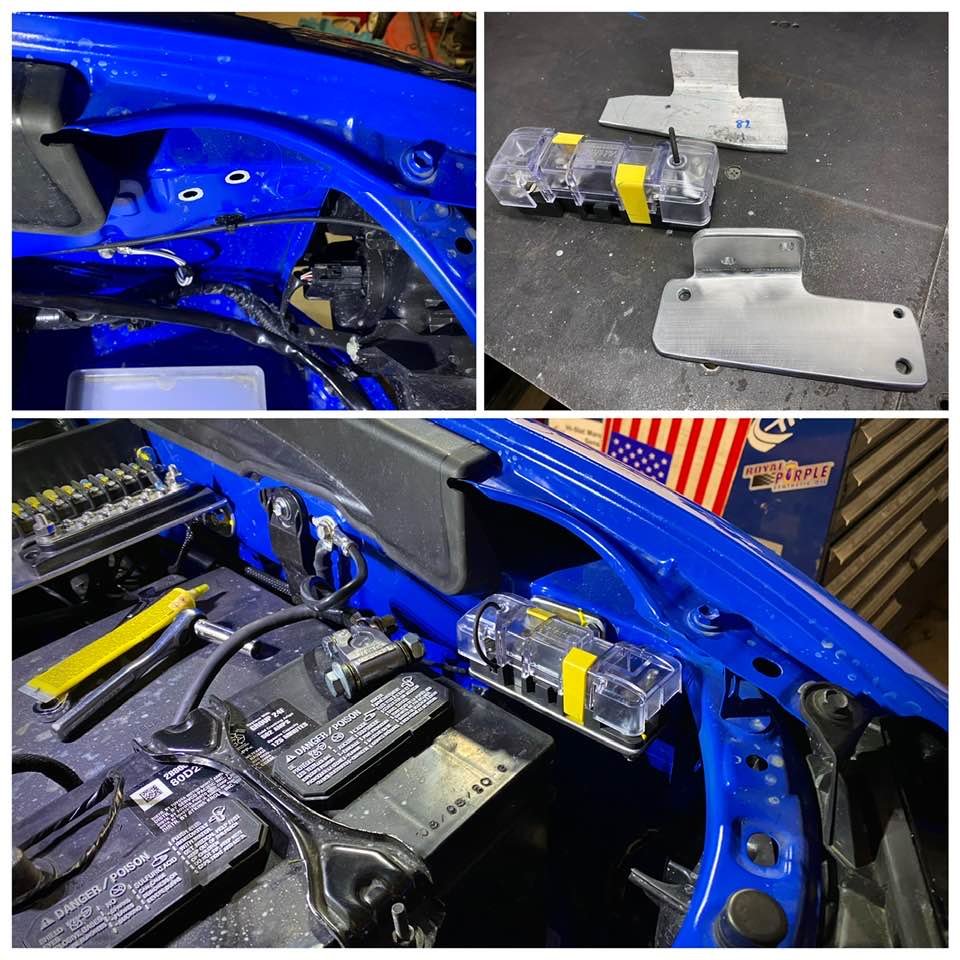

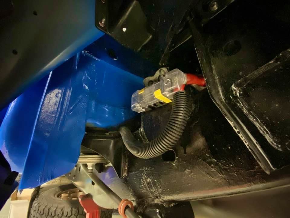

    little bracket to mount a MEGA fuse block as close to the battery as I could, took some time to make sure it is parallel to the battery to keep it clean looking, even though the inner fender panel isn't parallel to the battery. 2 rivnuts (usually I avoid rivnuts because they tend to spin at the worst times) but because the backside of these are fairly easy to access (pull the headlight out) I figured a field repair if I ever need to wouldn't be too difficult and went with it.

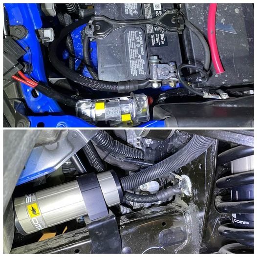

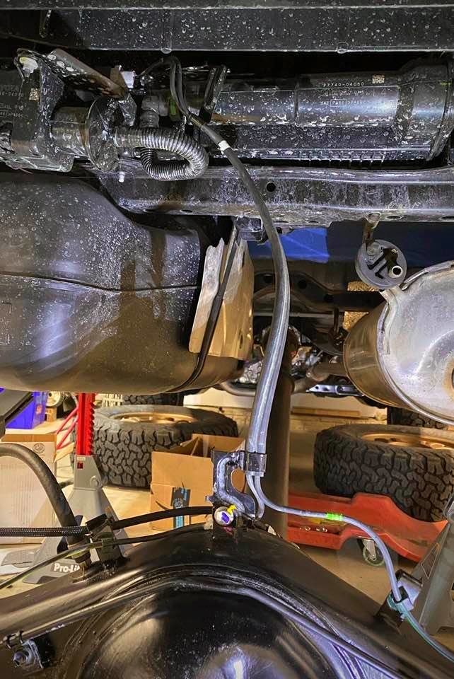

    since the stock tailpipe crashed into the new leaf springs I got rid of the 90 turn to the RH side, and converted it into a turn down.
    Eventually I'll make a new tailpipe that tucks higher but until I build a high clearance rear bumper I don't think it matters from a performance standpoint, this will be plenty good enough as a temporary setup.
    you can see in the LH rail the red boot over my power terminal where I ended my 2/0 wire from the engine bay. This is where I'll connect my rear winch to (when I build the rear bumper)

    2/0 ground wire run from battery to the LH shock tower (stock ground point, just took off the paint, used the stock bolt, repainted)
    144102162_10114555011297503_663736498697_2b2825986093ff3f9968b82c735f7184de5be3ef.jpg

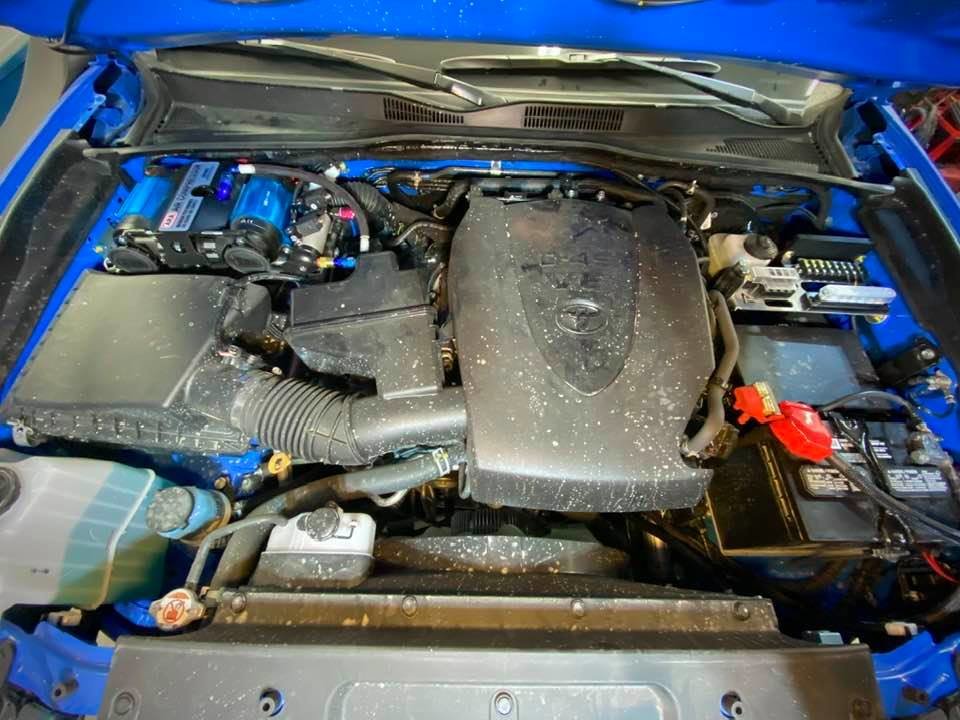

    For how much stuff I’ve added under the hood I think I was able to hide most of the ugly hoses and wires.
    Little unhappy about the 2/0 crossing over the battery but it is the shortest path to the fuse block
    You can see that I upgraded from the stock -4 fitting and line size the ARB manifold comes with to -6 and added a check valve.
    Pretty happy that all the compressor/locker wiring and hoses are basically invisible crossing the firewall to the powertray
    147160922_10114582627848713_234009806828_7b73f430accc7e41e0e8e1d339b793b4108ea8fd.jpg

    What compressor mount did you use/make? Is your ABS module underneath the compressor?

    I splurged for the Slee offroad one. with the ABS unit there, space is pretty tight and I justified the initially seemingly high cost of the Slee bracket because it would have taken me hours and possibly several tries to get a nice fitting (and looking) bracket that fits in that cozy little spot. and you know, time is money!
