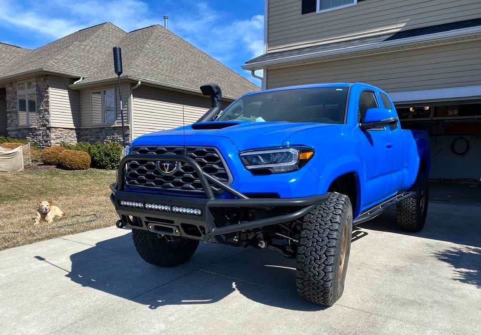

    Major milestone!
    Truck made its maiden voyage with the new rear suspension.
    It successfully backed its way down, turned around and backed up the driveway again for more front end work.
    Alignment is pretty bad right now, I'll try to get that done this coming weekend.
    After that it's getting pretty close to seeing some road time.
    It was nice seeing the blue in the sunlight for the first time in a looong time.
    Although keen eye would notice a slight reduction of voodoo blue on the front end. Which probably isn’t a bad thing.

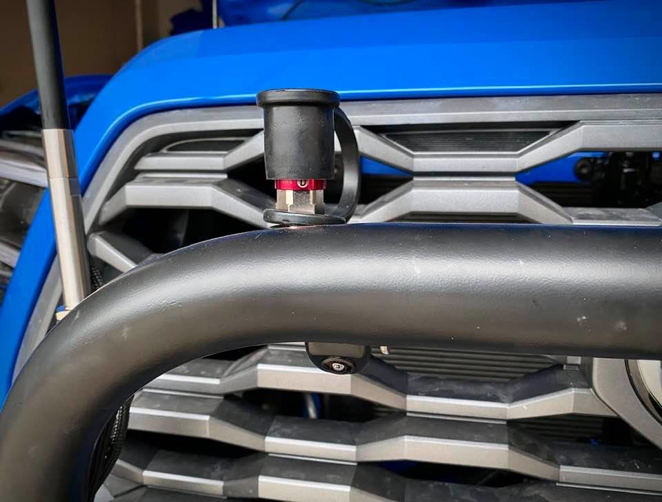

    GMRS and weboost antenna mounted, we'll see how I like the giant weboost thing right there....

    I've never been a fan of large antennas on front bumpers usually seen on the Australian trucks, but to each their own.

    I'd prefer to place it anywhere else but the future plans of having a cabover camper limits me to pretty much only the front bumper as a reasonable option :(

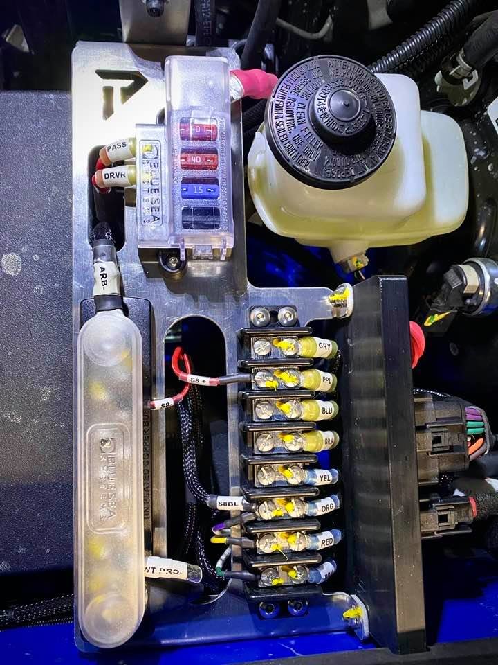

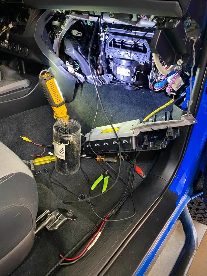

    got more wiring done, switchpros sure does make things easy.
    reran the compressor wiring to go to the fuse block on the powertray, hook up the light bar and thought i was clever hooking the backlighting to the compressor enable.
    164069779_10114761043851613_911953963622_a8155bb76b71aa044c2f84aee3c7f7b437eeaac3.jpg
    Ran a 10gauge wire to feed an in-cab power distribution unit, a pair of 14 gauge wires that are currently not allotted for anything but for future proofing, a front camera cable/harness, a GMRS antenna cable, and a Weboost antenna cable all through the stock safety feature harness grommet on the pass side firewall.
    What a pain! the stock harness is wrapped in a gooey sticky caulk-like mess of goop inside the grommet and passing all these wires including the RCA connector for the camera was quite miserable, even with the added access I gained by removing the SLEE compressor mount tray and the airbox.
    But the peace of mind from not adding any additional holes for water to get in, and not tearing the stock grommet and maintaining full sealing was worth it.
    once into the cab, i routed the front camera and GMRS stuff up and around the glovebox, following the existing harness in the dash structure.
    I plan on having the in-cab power distribution live in the "back seat" area so I'll be running wires up and down under the pass side door sill.
    I put everything back together again for now but I know for sure I'll be taking it apart just like this a couple more times, should be much faster next time now that I know how things come apart.

    I really appreciate the labeling and cleanliness of the wiring.

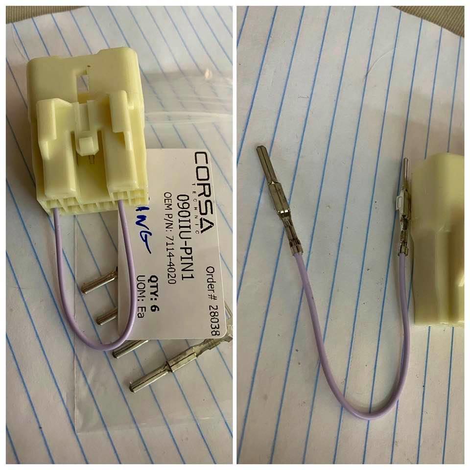

    This simple little jumper took weeks to put together due to an online dealership who went out of business after I placed the order but didn’t notify me, and hung up on me most of the time after trying to call them, and then a 2nd dealership who never called to let me know the housing came in.
    But it’s done now and I have factory bed lights that work!

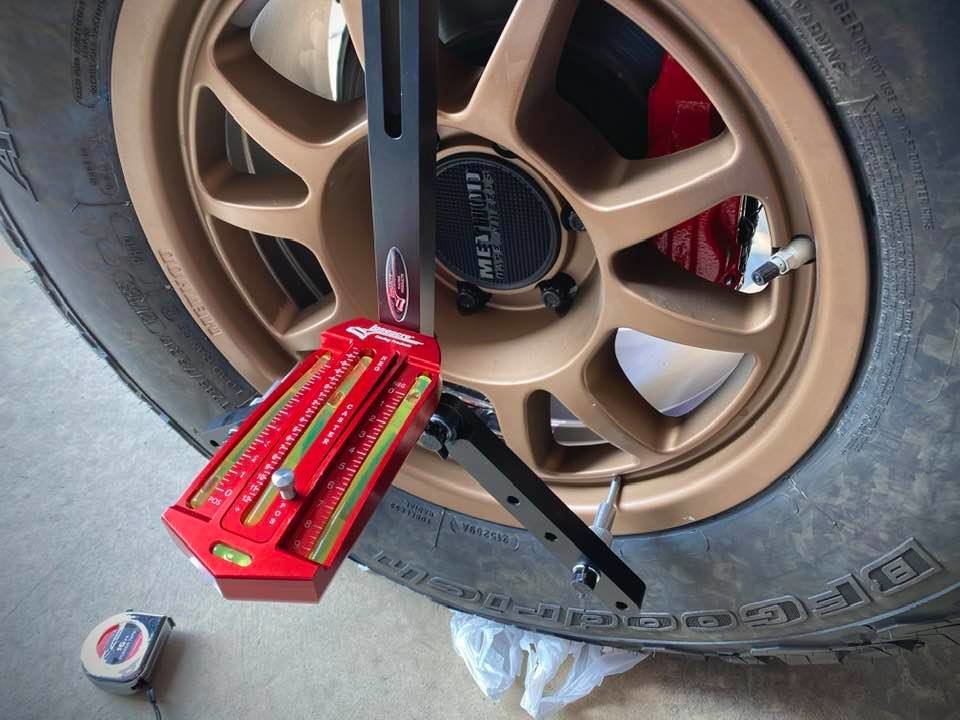

    and alignment time! which means super close to first drive time!

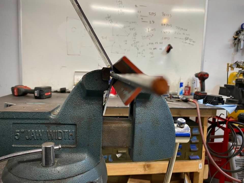

    yea, i used to do that, and then up until this I just used and angle and a round bar and sandwiched but it was always a pain lining up everything while tightening the vice. Usually required a forehead or a knee to make work but no longer!
    oh here's a pic of that concept
    150057277_10114613149408263_230169830912_6d7e982abfdc8806f4c35f1e8fba2904a8cb3ce9.jpg
    to be honest I should have just bought this eastwood thing when I was first shown it by a friend but of course i didnt and didn't want to wait around for it to show up if i ordered it now.
    homemade works just fine!

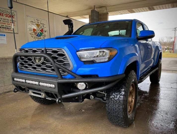

    first test drive to the carwash!

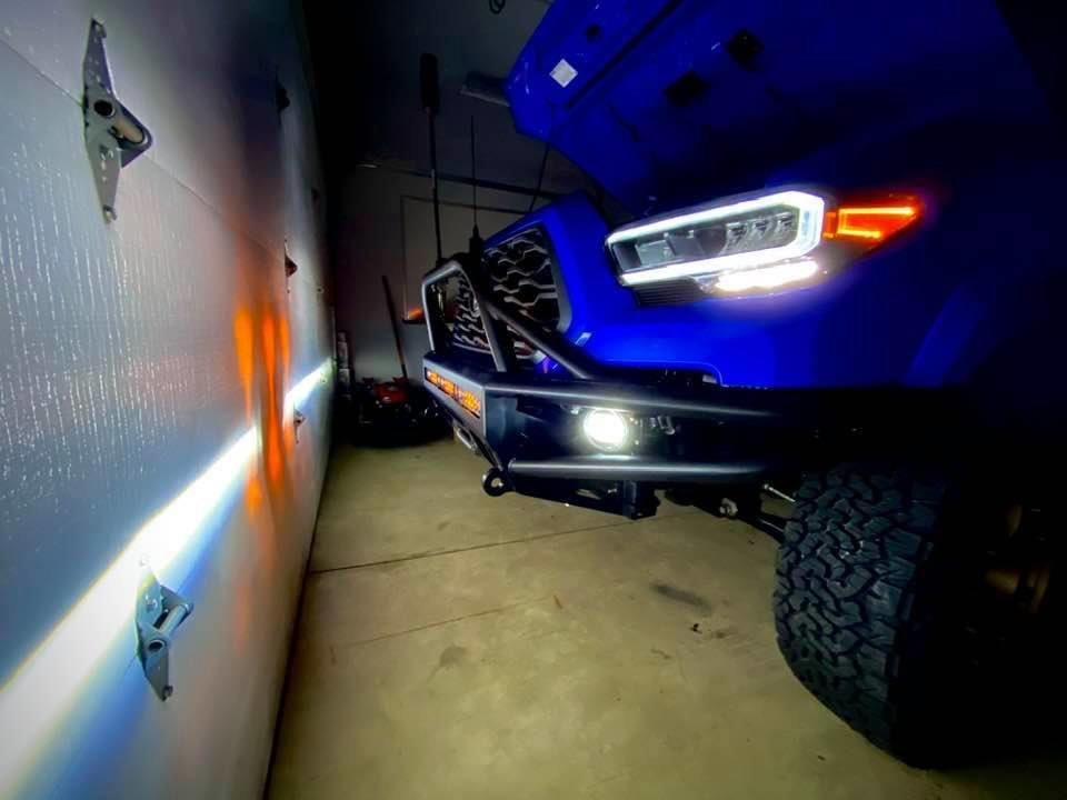

    oh yea, I made little brackets to temporarily keep the stock fog lights until i upgrade them
    163937028_10114787931318913_517933912304_8a5c3a1928d3d508de3018d281c7fc19d71af926.jpg

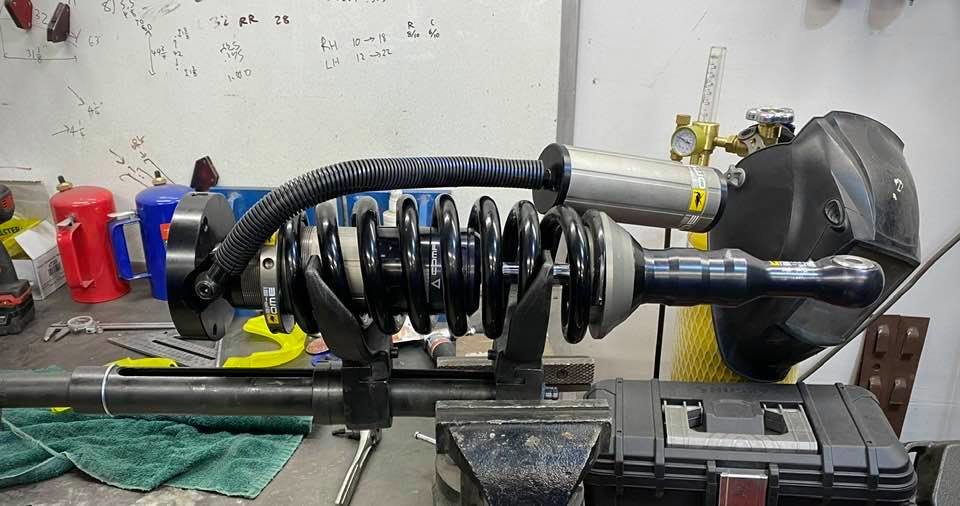

    changed the preload on the front springs to get closer to the design ride height spec'd by OME/ARB
    168824288_10114815112173263_626418858612_3e6911fe4b209dfce83c5f639dae5a537aa817a5.jpg

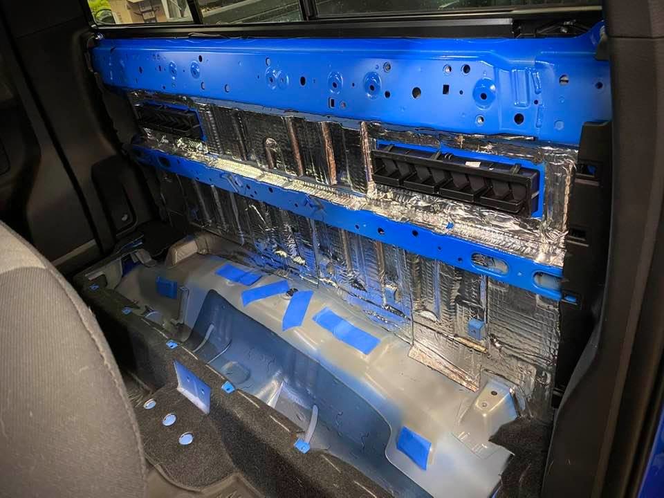

    and pulled the entire backseat area out to prep for more storage space plus a dog platform, added some sound deadener stuff while it's accessible.
    168898909_10114826308211313_186981292316_be84ab7f55fc4515ab78462a4d35c352207026e4.jpg

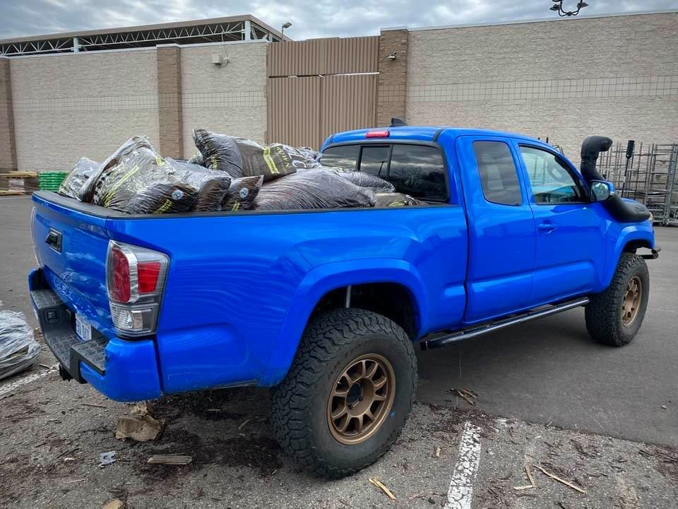

    truck got to do some truck stuff for once.

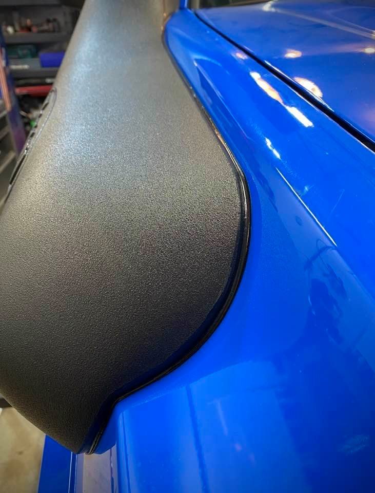

    Bead of silicone around the snorkel to fender gap to keep crap from getting stuck in that seam (like all the aluminum chips/dust flying around the garage this weekend)
    172238049_10114846029130433_680610332532_69c9c960216f8d79c0508eaae733d34544f8fb8a.jpg
