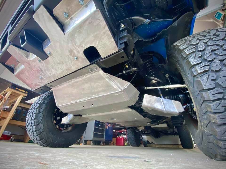

    Took a bit of work to make these skid plates work (not sure why it wasn't a direct bolt-on as advertised from the manufacturer) but it looks and fits good now.
    172129332_10114845981905073_454396768050_c5318d329036096e90222afbd36b172553431cd8.jpg
    This t-case skid came with a big step down to clear the stock exhaust crossover pipe, which I relocated previously, so I got to chop it up to make it flat and give me back all the ground clearance.

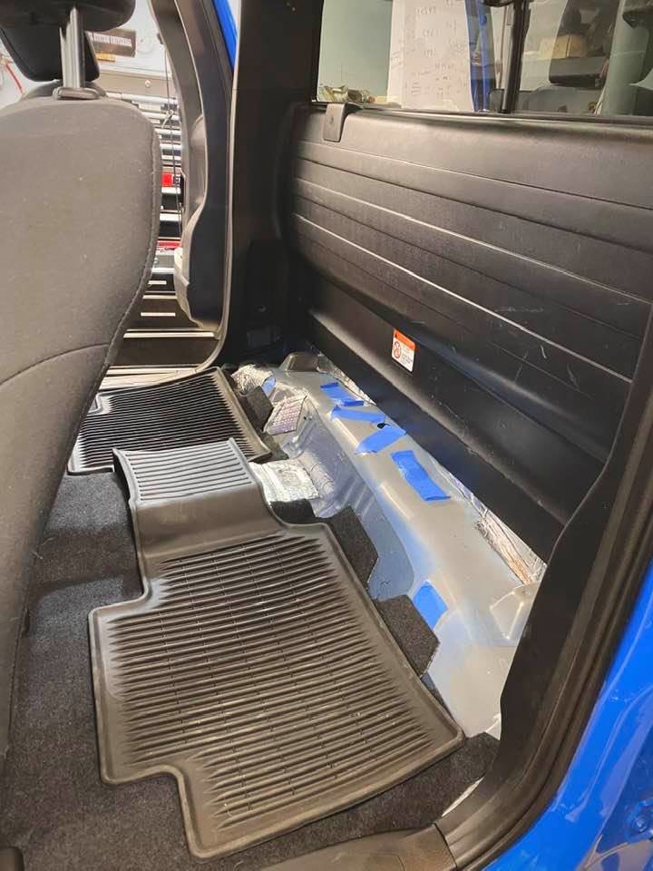

    Now with a seatless back wall panel from a utility grade SR trim truck.
    it's nice and quiet with the panel + all the extra sound deadening i added compared to a bare wall!

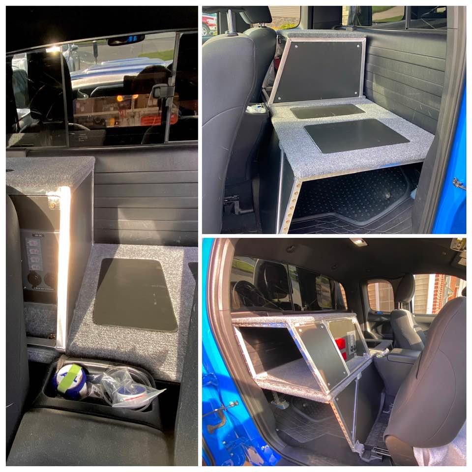

    been slacking on updates, but really the only thing I've worked on in a while is a shelf system for the rear seat delete
    havent taken a fully complete pic but this was 90 there. since then i added hinges and slam latches to the openable hatches.
    framework out of 3/4" x 3/4", 0.065" wall aluminum for lightweightness, and then panels out of 1/2" plywood
    both materials which are outrageously expensive now!
    The dog will have the whole "60" section behind the driver's side, which is why I don't have an upper level on this side.
    I don't work with wood much but quite happy with how this all turned out.

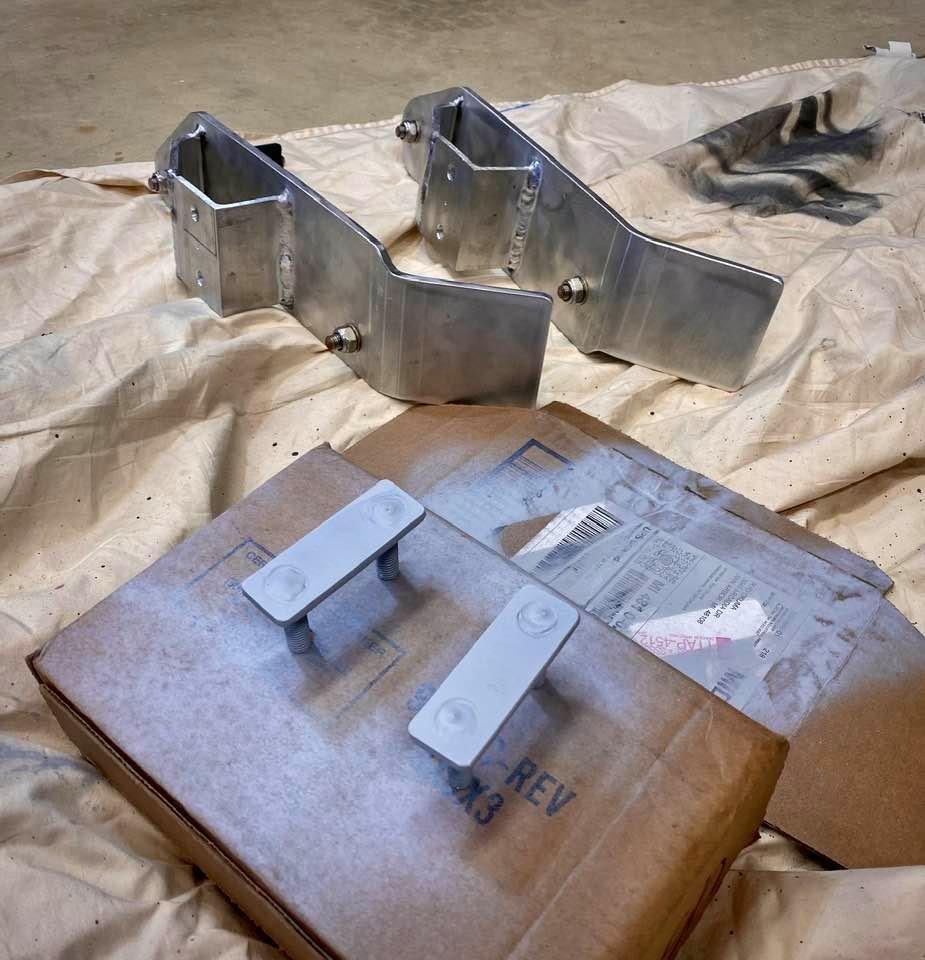

    last night i whipped up a quick bracket and stud plate to mount stuff in the bed rails.
    I ordered t-nuts from Amazon but looks like I'll be able to return them before i even get them delivered!
    all of this material was from scrap pieces i had laying around, always happy when i successfully recycle from my hoarding.
    bent aluminum bits are the pieces i cut off the front skid plate, so nice to find a home for them again.

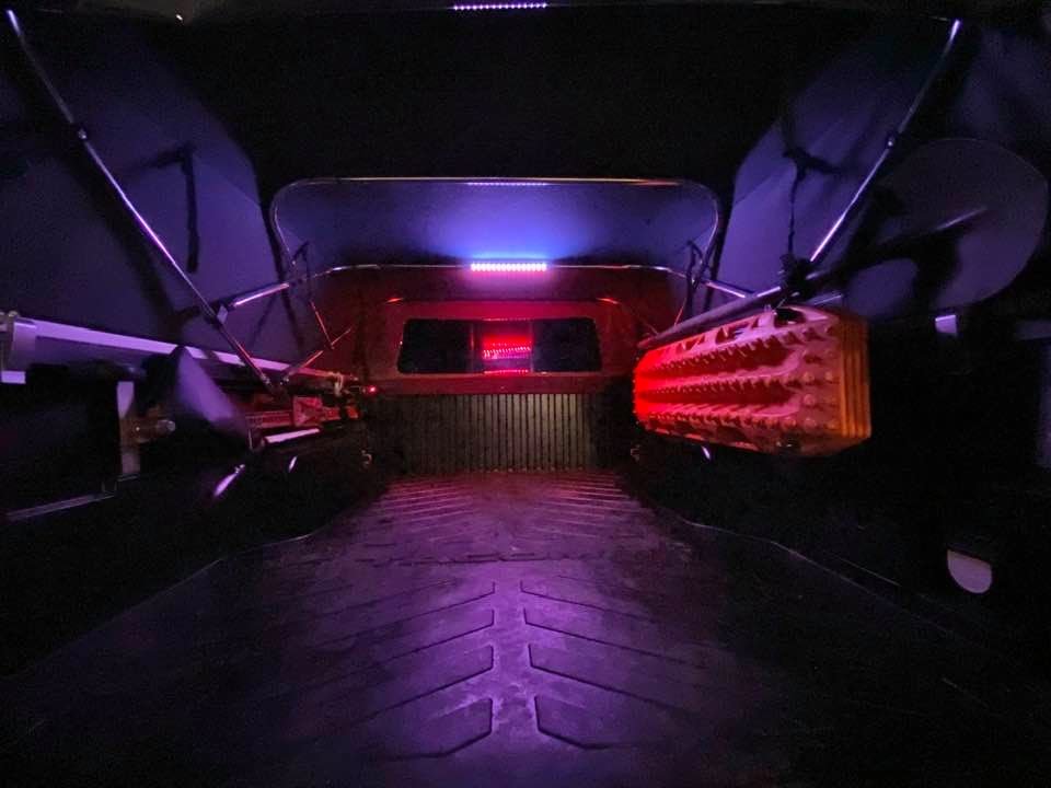

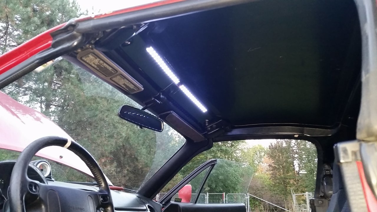

    the side effects of recycling parts from "leftover" bins...
    I thought I had wired in 3 LED strips leftover from the dome lights I added to the miata and then also leftover from the cargo lights I added to the disco.... but turns out 1 of these was exaclty that, but 2 of them were leftover from the brake lights i did through the spare tire spokes in the miata....
    so now i have accidental mood lighting.
    this is a temporary setup anyways so good'nuff for now
    185557006_10114978837291813_819046197565_8562f04ddccbedfac1bd15fe88858443d253a9a9.jpg
    the miata dome lights

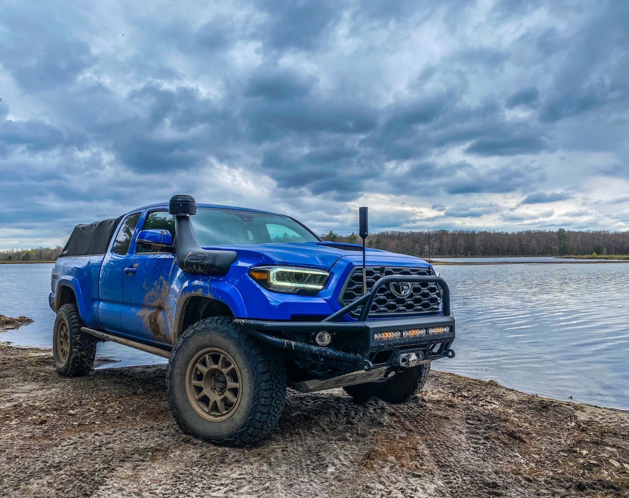

    Correct me if I’m wrong, but I believe it’s a WeBoost antenna.
  16. May 20, 2021 at 7:47 AM
    #96
    Blueberry.Taco
    Blueberry.Taco [OP] blueberry.taco (IG)
    Sep 14, 2020
    #340806
    878
    Ryo
    Fulltime Overlanding
    Long travel house on 35s with a custom aluminum utility bed and FWC
    some welding required
    yup, Weboost and a GMRS antenna on the bumper (both not wired up to anything yet, that's the current mini project)

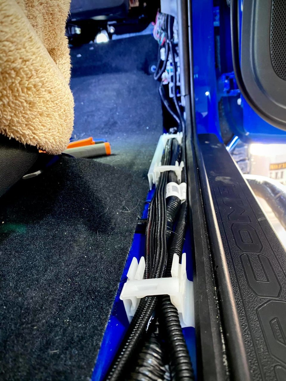

    ran the antennas and power/ground wires here yesterday.
    Super happy I was able to fit all of them in the stock pass side door sill trough
    188027797_10114999872566953_723092911261_cf33eabdb29c7c810751d35eb8523a9081d667ea.jpg
  17. May 20, 2021 at 7:55 AM
    #97
    MountainManGuy
    MountainManGuy Well-Known Member
    Jul 26, 2019
    #300316
    808
    Colorado
    2019 Toyota Tacoma TRD Off-Road DCSB
    That door sill sure does fill up quick. I've got 3 runs of RCA's, 2 runs of speaker wires, a power cable for my pop n lock, and probably something else in there and it's pretty much full. Miles and miles of wires!

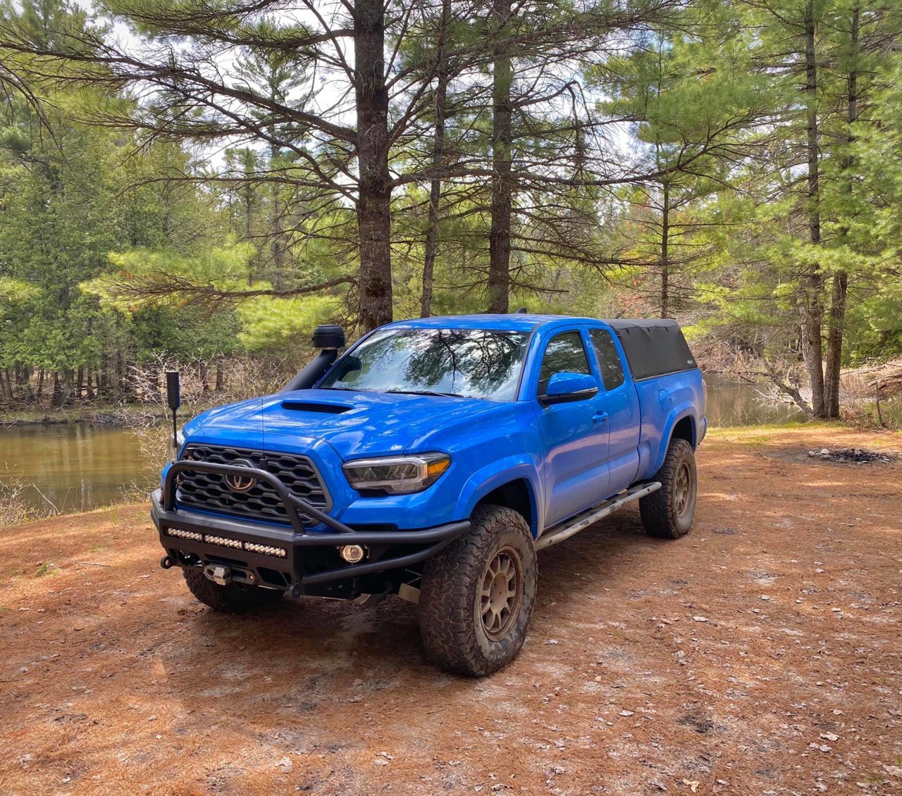

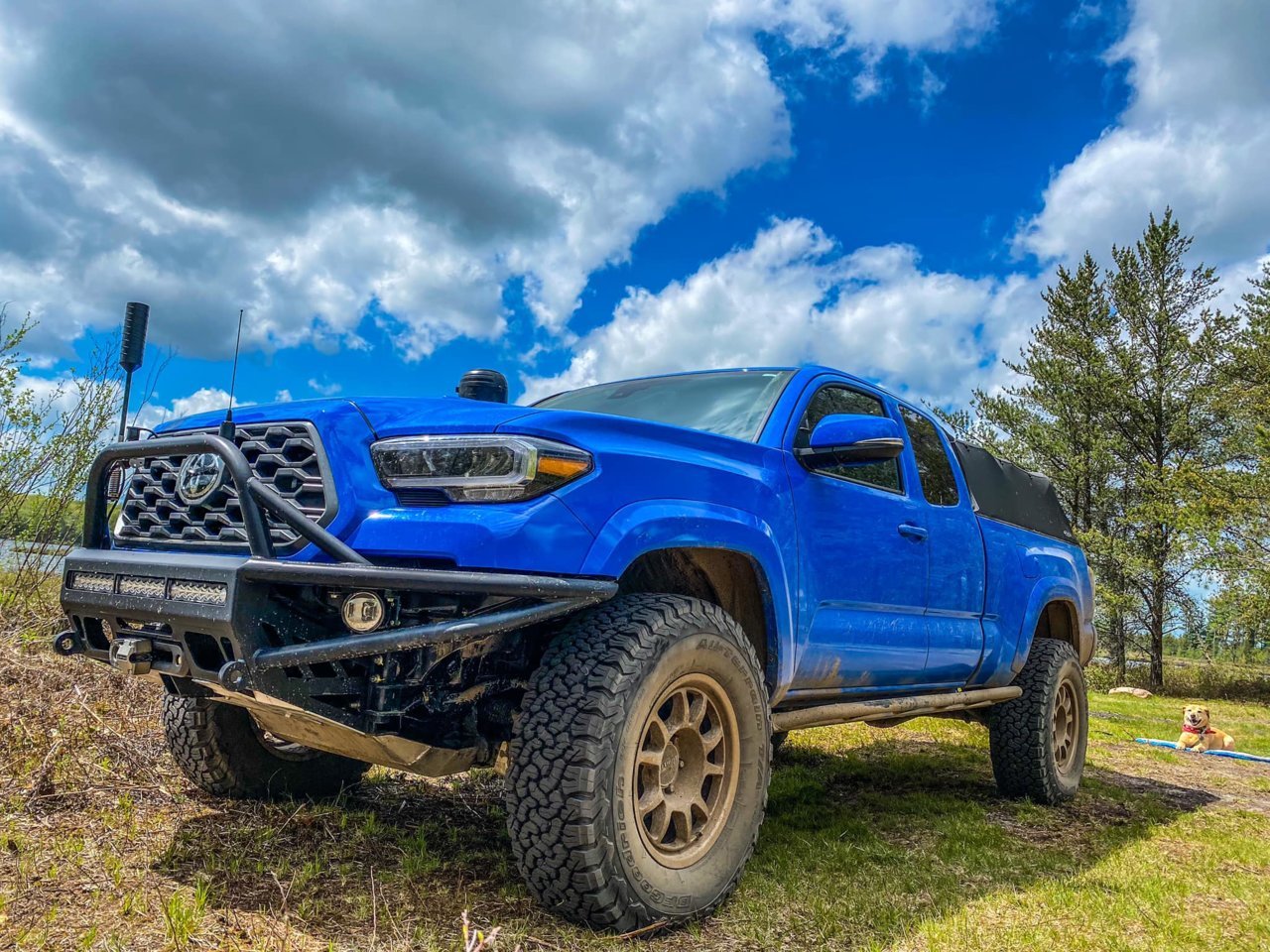

    on saturday we woke up to just drizzle for breakfast before hitting the trails and came across a familiar puddle again, and drove over the worst washboard roads I have ever encountered, but that was the perfect opportunity to dial in the BP51s.
    they are set good for <5mph washboards now, at least in current setup.
    184862129_10101619326244087_830412555131_1610a693df0ae6e562ba77528e4c238de18a8304.jpg
    186513614_10101619326378817_634729814399_9fe2c8dd4a76f8f1298b9db9fb586e927b17c4e6.jpg
    we had eyed this spot last weekend and it was as good as we hoped for.
    188016021_10101619326174227_881185289524_dd398dc4d5f841167d672f2939d4fd2cccda32ee.jpg
    186461844_10101619326608357_199620076914_d4e2ed6438c564a738231f10c33c494ea6bd832a.jpg
