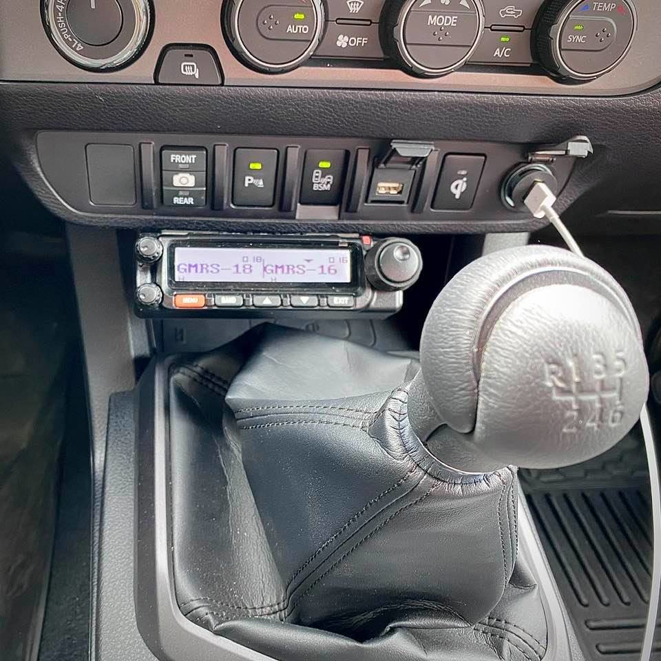

    this radio can do dual channels and also has preset NOAA weather channels which i think will be nice.

    Did you go CB or HAM? Clean install.

    I ran CB in all my previous rigs and hated it, went with GMRS this time, so far (only played with others within line-of-sight) crisp and clear with no noise!

    Same here. I tried multiple CB setups and none were that good, all had some sort of issues. I went GMRS and it's better in every way.

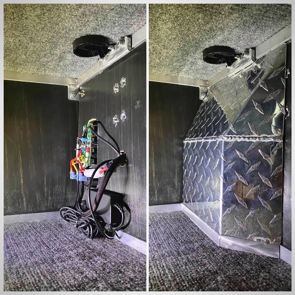

    as far as updates go, finally got around to making a quick little shield for the wires and bits in the shelf
    197694030_10115066968875413_434120650514_1b99820f0a26d3513feb6888d540c881304d8844.jpg

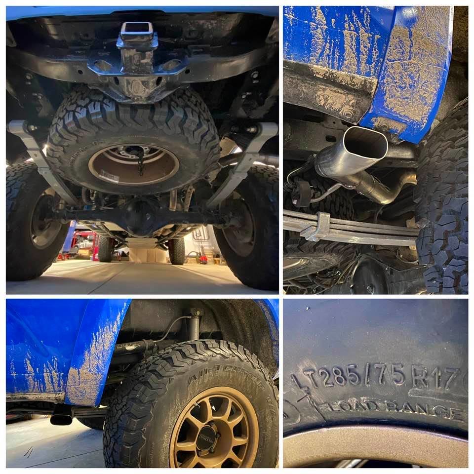

    I hate the idea of a spare tire under the truck but for it’s current mall crawler status it makes sense to have one. Took some exhaust rework, tire winch relocation, and some bracket bending but managed to fit a full size 34” tire up there.
    Managed to get all this exhaust reroute done by reusing the stock pieces. if that exhaust "tip" looks familiar to you guys, it's because it's from the stock crossover pipe (had to chop it up a bit to get the inner wall out)

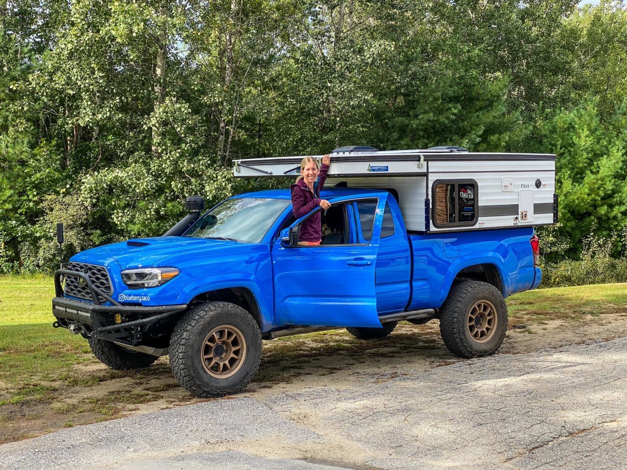

    well, it took a while to get to here, but after 392 days of waiting from when i placed the order, I finally have the camper!
    Took the weekend to enjoy cool weather ground tent car camping for the last time (we'll still continue to tent when backpacking).
    got some nice dispersed spots in the Adirondacks and an okay one in the White Mountains, then woke up at 5am on monday, packed up camp and drove down to Bow, NH to visit Mainline Overland to receive our camper.
    a week or 2 early for best fall colors but it was good enough for a quick weekender.

    aaand what we've been waiting for for so so long.
    243138357_10101683031024197_725255676194_2e7651dafce36c239344324c97499da8e4d2cede.jpg
    suspension handled it beautifully, with no air in the airsprings it sits just about level and rides fine.
    add about 50psi to the springs to get it back to original ride height (pictured).
    So looks like i can pull a leaf out of the 3 leaf pack and be fine.
    I'm looking forwards to being able to set ride height lower!
    Bonus: my dog found a new chin pillow. He loves this position and slept like this for a while multiple times.

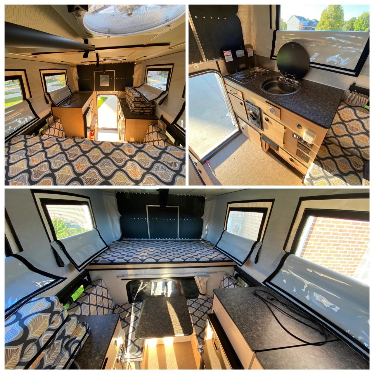

    pic of the inside "as-purchased"
    244429119_10115455995517903_338227081712_d1f088000b23ced4e5794754d47949604cff9dec.jpg
    since then made some changes: some visible, some not so much.
    took out the heavy and unnecessary bed slideout and extra cushions. Oh and the entire bed mattress too.
    We've had an Exped Megamat that we love for both insulation and comfort that we've been using in the previous rig and ground tenting when using our half dome tent.
    perfect fit in the cab over area, better R value and comfier and lighter. win win win!

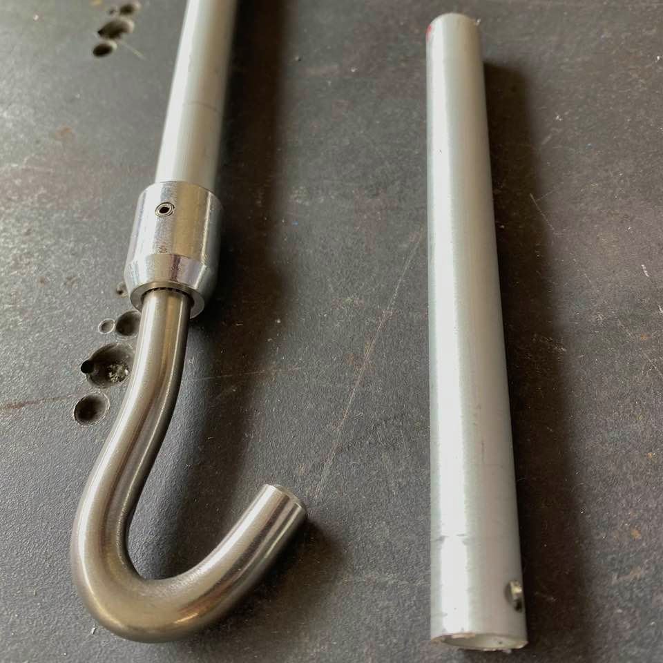

    shortened the stock awning handle for a little more comfort and weight/space savings (see a trend here?)
    244229178_10115452664009273_851370467618_6f6c55b8a1cfe35446101964c5079a98914fb2fe.jpg

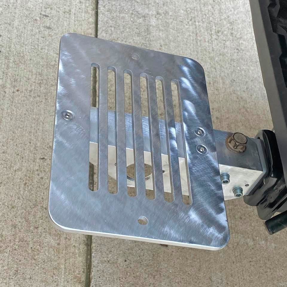

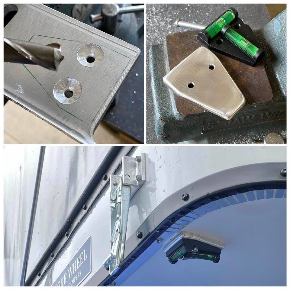

    made a quick and dirty hitch step. big hole underneath is so we can clip a carabiner to the dog leash on it at a convenient location
    242524488_10115452664084123_559055512490_814a6281855917dac092a28e8ad07028cd6b5535.jpg
    and since i hated the idea of screwing into the camper directly, made an intermediate aluminum bracket to 3M VHB double sided tape onto the camper.
    I can see this level from the driver's seat, so leveling at camp should be super easy (especially with the individually controllable from in the cab - rear air springs)
    243100779_10115454680772663_764760497982_9c670ebbf488e5790ff3b8c2c76331dbf525daf5.jpg
