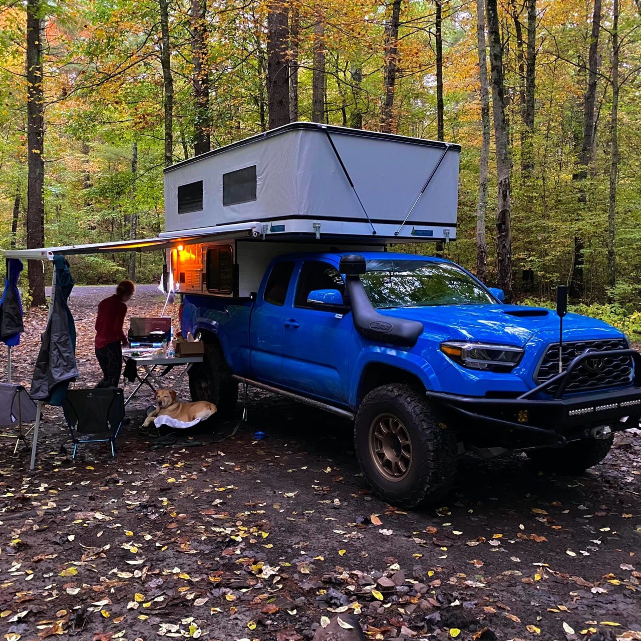

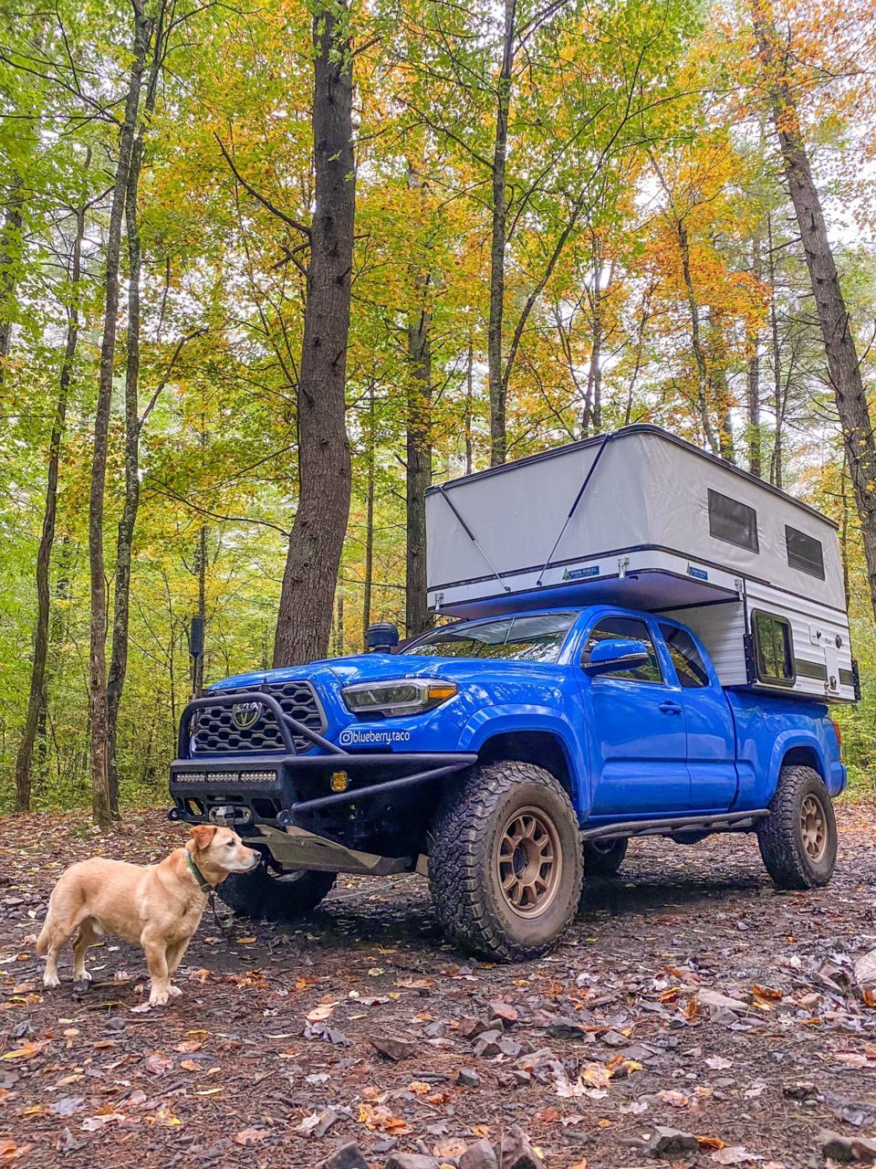

    Other nights were at a quiet dispersed campground in WV where our dog was a verygoodboi after all the excitement and stimulation at Expo

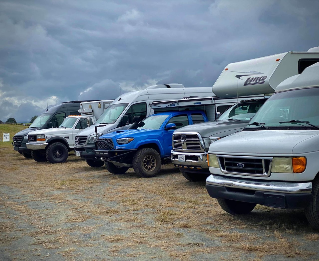

    at expo itself i didnt take any pictures partially due to having a hold on the dog's leash the whole time, plus the weather was not particularly photo friendly.
    but, parking lot guy told us to park in the back with all the other camping rigs.... we sure look tiny

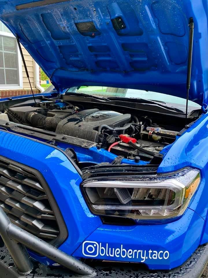

    fairly simple upgrade, makes the heavy hood less terrible.
    245692547_10115488532658213_269145441886_ef493fbb46f249bc73041d94ccf0c2c1e61018d5.jpg
    had to move the ground bus bar on the powertrays over (2 new holes required) to make this redline tuning hood strut kit work but it was easy enough.

    After looking at your power tray setup I realized your clutch fluid reservoir isn’t in the place as mine- which would require me to do things much differently. Out of curiosity where the heck is yours mounted??

    it shares the brake reservoir

    Ahh ok. That makes a lot of sense since they use the same DOT3 fluid.

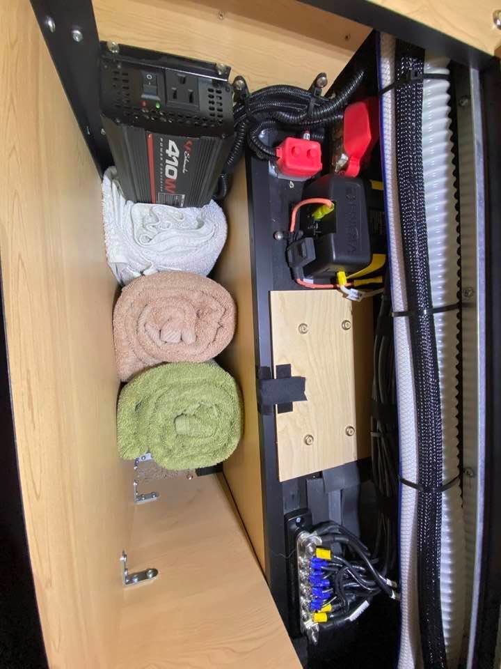

    Right, maybe i should update this thread.
    quick camper mods:
    addition of a small inverter to power laptops
    250895917_10115557168182073_518848260337_80a4d23690396601756e0a816346447d4cfe0718.jpg

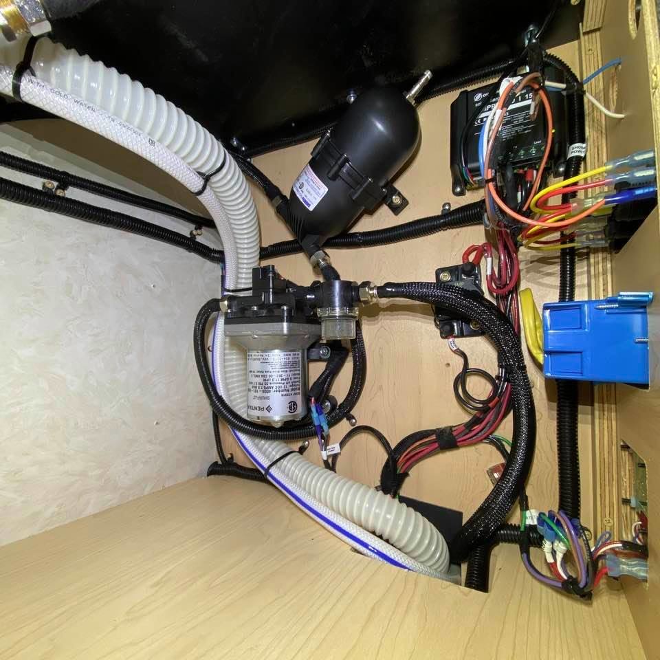

    and a water accumulator to reduce wear on the pump, and a bit more wire tidying.
    255385621_10115578457433243_535972461319_306d38afe17f4b5d0fababb730d4cf5110b7238d.jpg

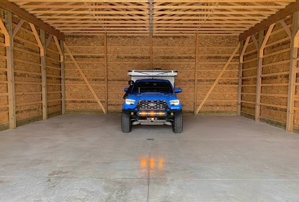

    so, I've been looking for a new garage to move into for over a year, I don't know if you guys noticed during the suspension build how crowded the tiny 2 car garage was, but wife and I found what we were looking for and moved into the new place around Christmas last year.
    a blank slate 30x40x14 barn.
    no electricity, no heat, no insulation, nothing, built within the last year.

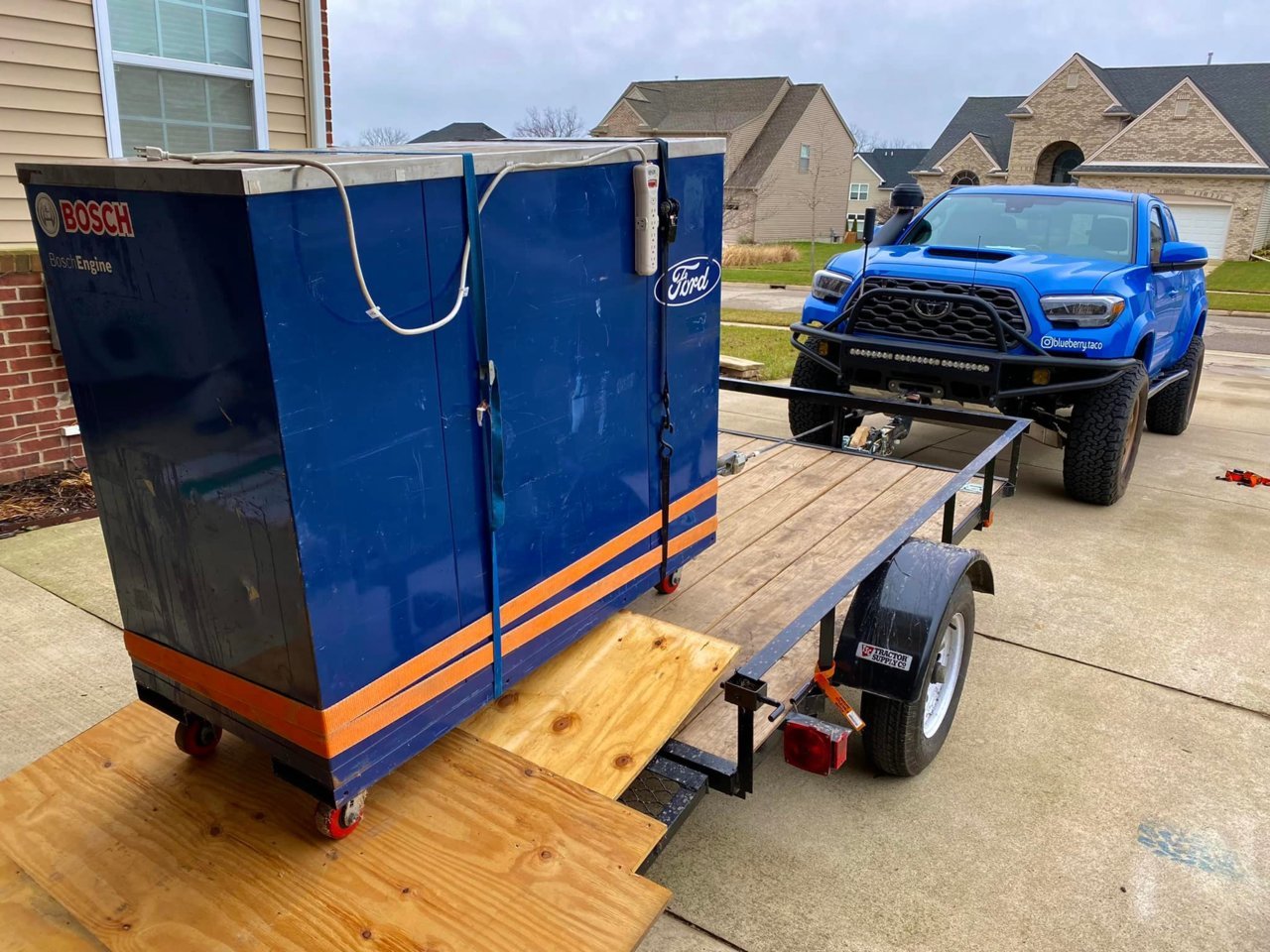

    moving my fully loaded toolbox wasn't easy, but a winch sure makes things safer than doing it by hand!

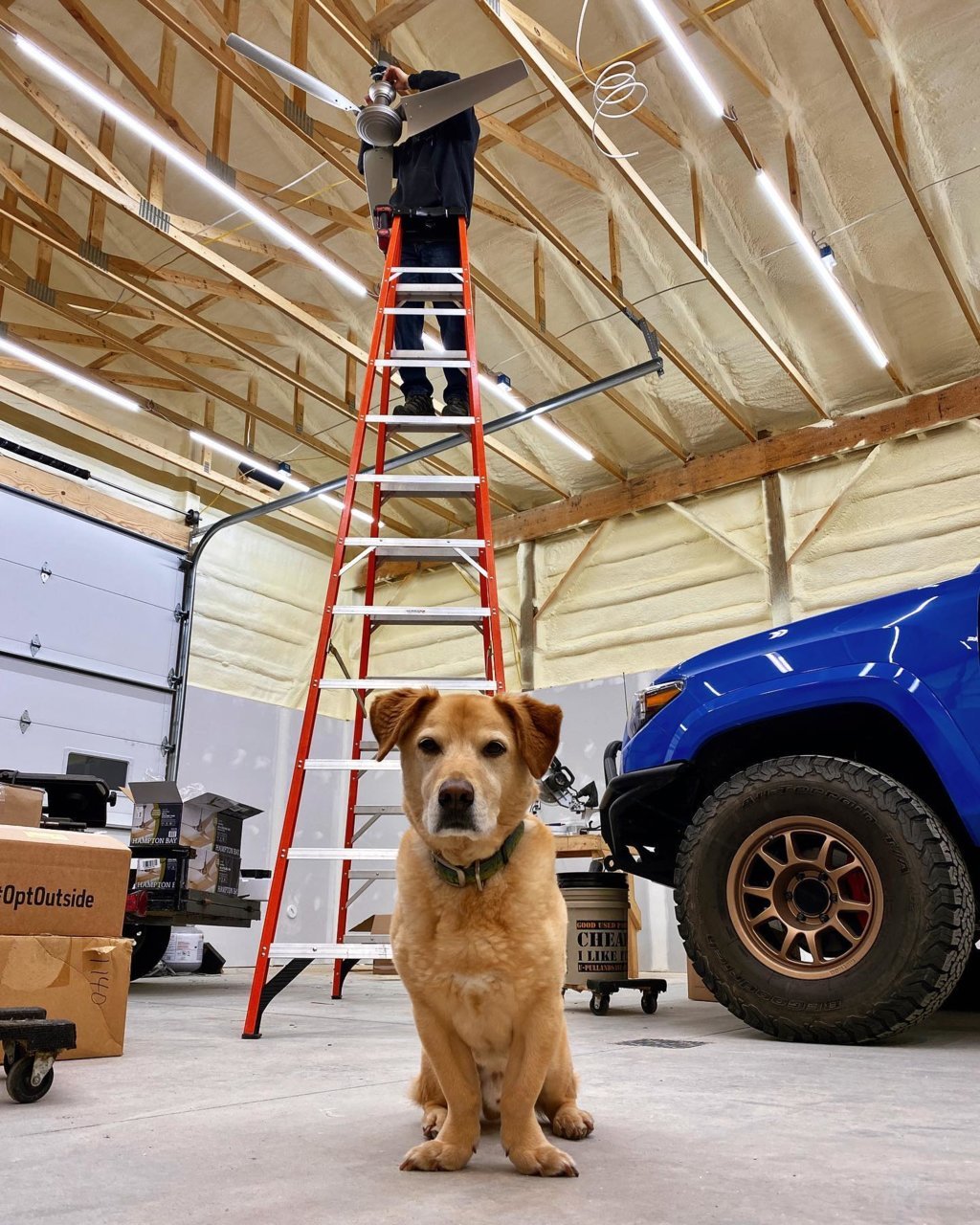

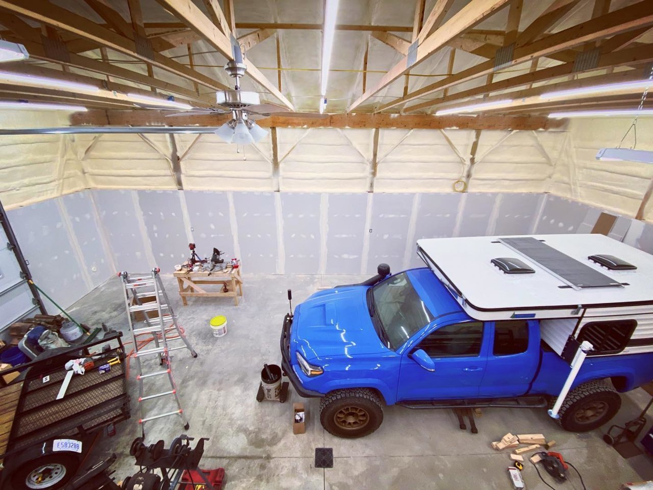

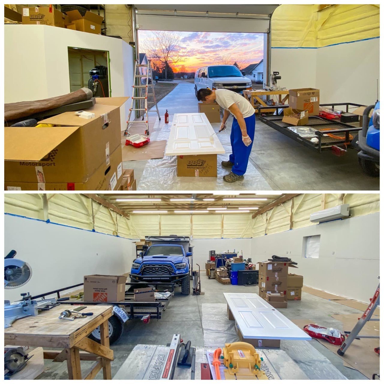

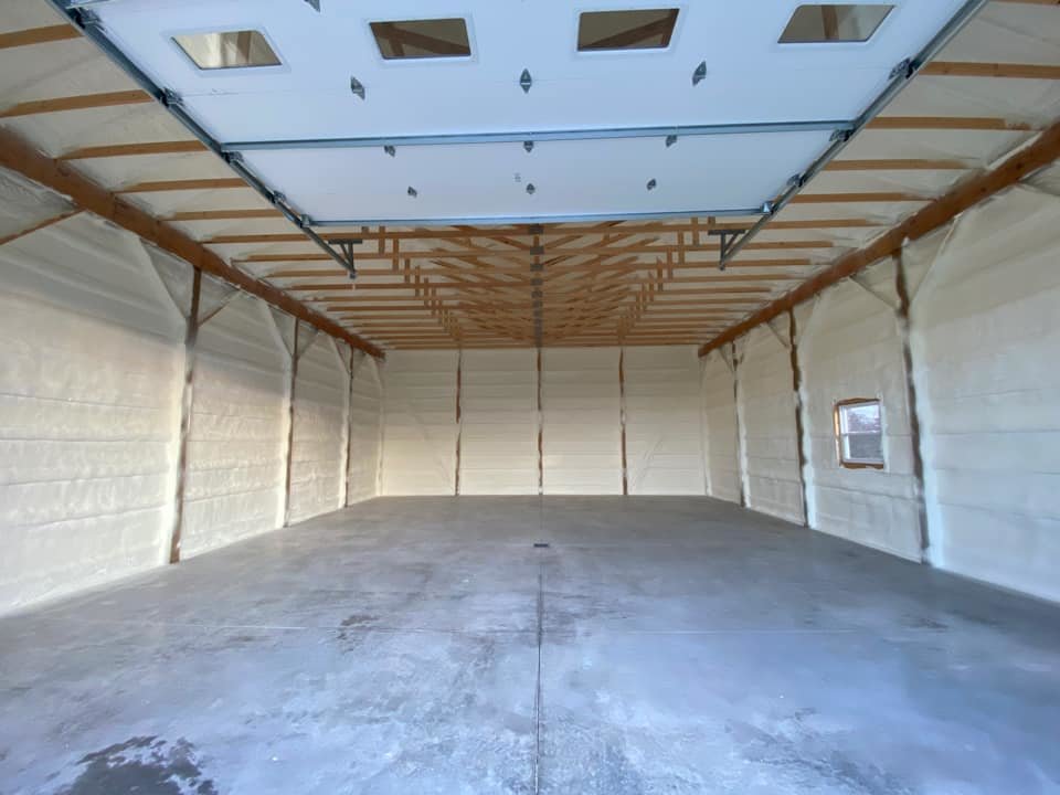

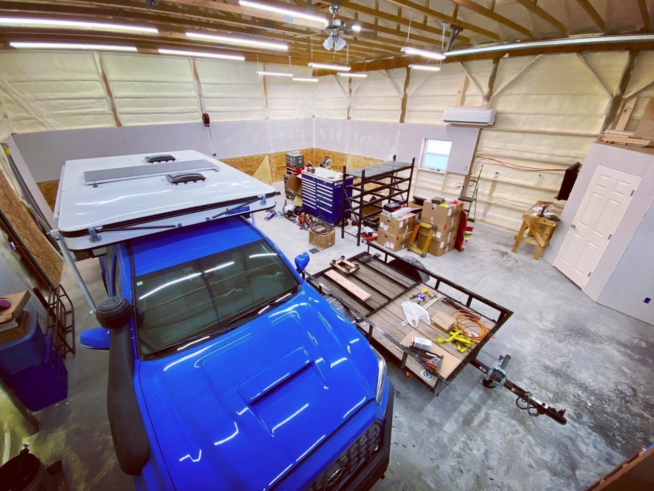

    Spray foamed the whole barn with 2" of closed cell,
    270130082_10115710101242993_705116268255_580a3967fd90d02cc8239e0acc8478927a6e2660.jpg

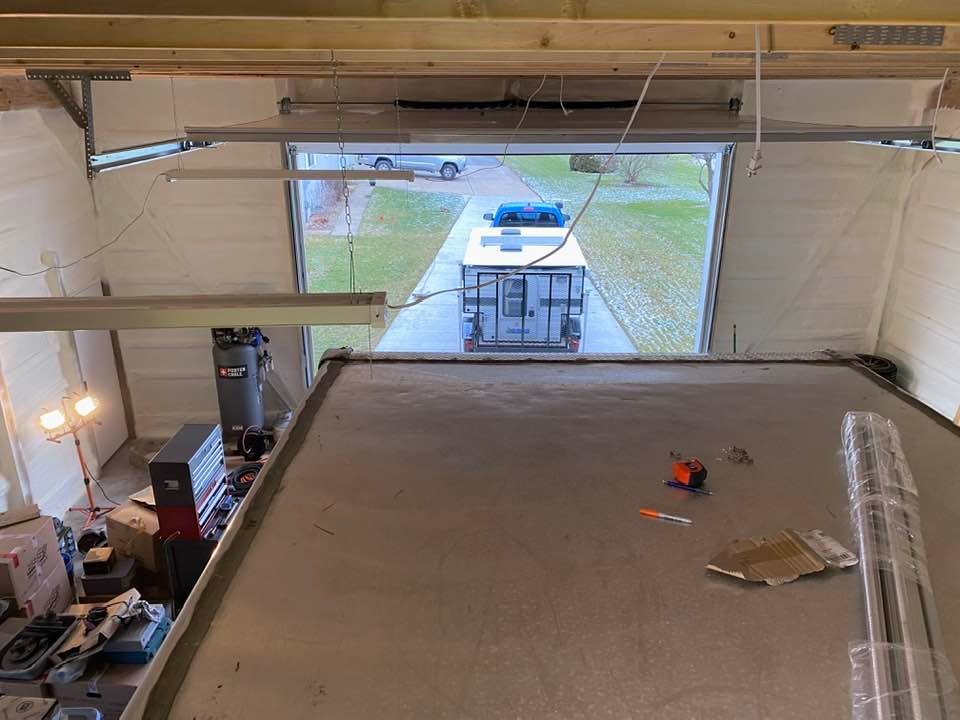

    hung up a bunch of lights using the most unmanueverable portable scaffolding in the world (known as a moving truck)
    271117168_10115720946149713_197315388495_fc7ca1f05db55b9f545debcee58b619c91d9b698.jpg
    trenched and ran electricity out to the barn
    272089291_10115768751217973_433077915654_a10947ff3237ea6009b55a22a8585190998a066f.jpg

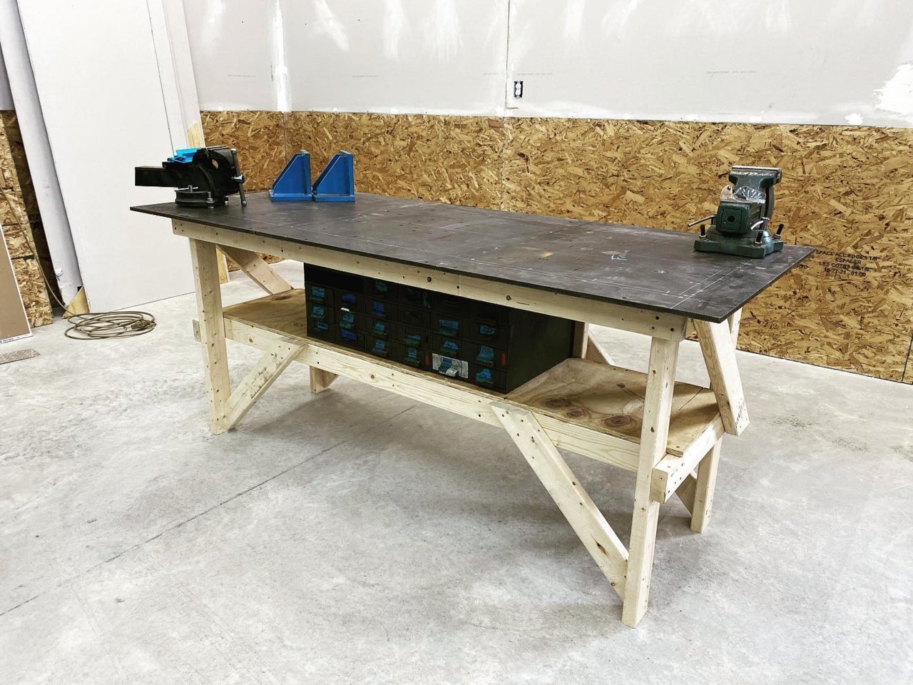

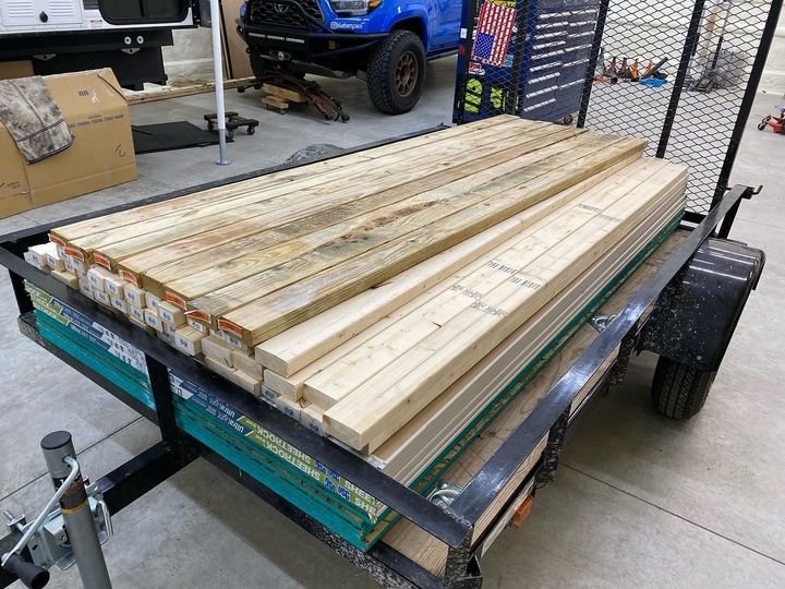

    spent ALL of my money on lumber (i am in about 3 trailer loads about this size already)
    272131432_10115771564734663_116830956273_1a7ee735857e62c83e0f4456bfe57a32433baac0.jpg

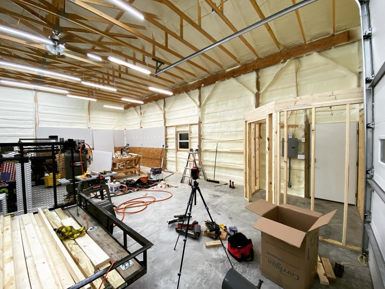

    and building it into the workshop i want it to be (in the cold, no heat yet)
    272695687_10115795519409303_392944013209_bbf2ded2cfa37fcd8a66c8f3e51a79a8d0afb5c5.jpg
    and we're mostly caught up.
    I got the mini split delivered on monday so will be installing that soon!

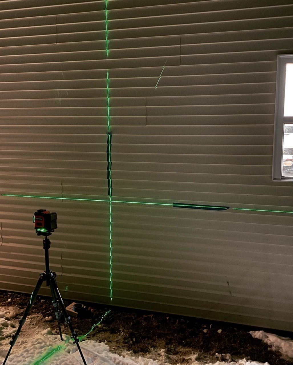

    i spent a lot of time outdoors in one of what felt like the coldest weekends we've had and got the minisplit condenser mounted on a wall bracket and hooked up.
    no idea how i used to get anything done square before buying this laser level.
    273656649_10115832429715753_915883761967_c56c446ced980fa51373c4bffd772accb9016298.jpg
    Pole build structure means i need to add some studs to help support the heavy condenser.
    again, laser level comes in handy to draw straight vertical lines to trim the expensive spray foam efficiently

    also built up a new workbench, 1/2" steel top plate is my go-to with a 2x4 base.
    i've never had the space to have a full walk-around island workbench, super excited about the stuff i can build on this thing in the future
    273298152_10115822261003933_269636433950_a3dc90b11e347fc7ddbc84cab6adcc7e03c9f8ab.jpg

    working in the warmth is a nice change, got the rest of the drywall hung, lots of mudding, hung some more lights, making progress, but can't wait to be done working on the barn and back to truck stuff
    274979313_10115875912500903_480123105310_98f2efa470d4ccf345a664d9226c8e65330dc403.jpg

    Damn, looking sweet. What's the purpose of the little room near the man door? Little office or just an added layer of protection to keep heat from escaping when you walk in and out?

    it's my compressor room, I hate having the compressor make so much noise I can't hold a conversation/hear music, so i decided to box in the room which also allows for a small amount of dust-proof storage (mainly so I can keep a clean bed for the dog when he wants to hang out in the barn with me) and other things. Room for longer term storage above too, which I haven't quite decided how to best utilize yet.
    Definitely helps with being an airlock for less outside air making it in, but that's just a bonus.

    hung a pair of 999CFM (according to the specs) ceiling fans which definitely move a bit more air than the one I originally put up, recycled from inside the house
    274984046_10115885531743863_788430341532_b68d00ae10ef8531eed89699c710785d4d1e345e.jpg
    painted the walls
    275933511_10101757235153527_246537899345_2c5b58a40bade9f1514f8909b779ff706c7bc9a5.jpg

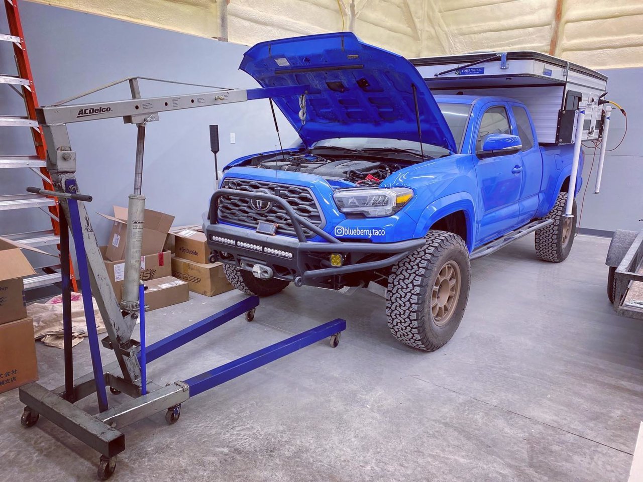

    pulled the weak little v6 out
    277671614_10115955025038743_833466552499_d2ded7f14a4c1ed4815131b591c4f7b12f895d72.jpg
    (actually that's not true, i just bought another of the same engine hoist i sold a couple years back)

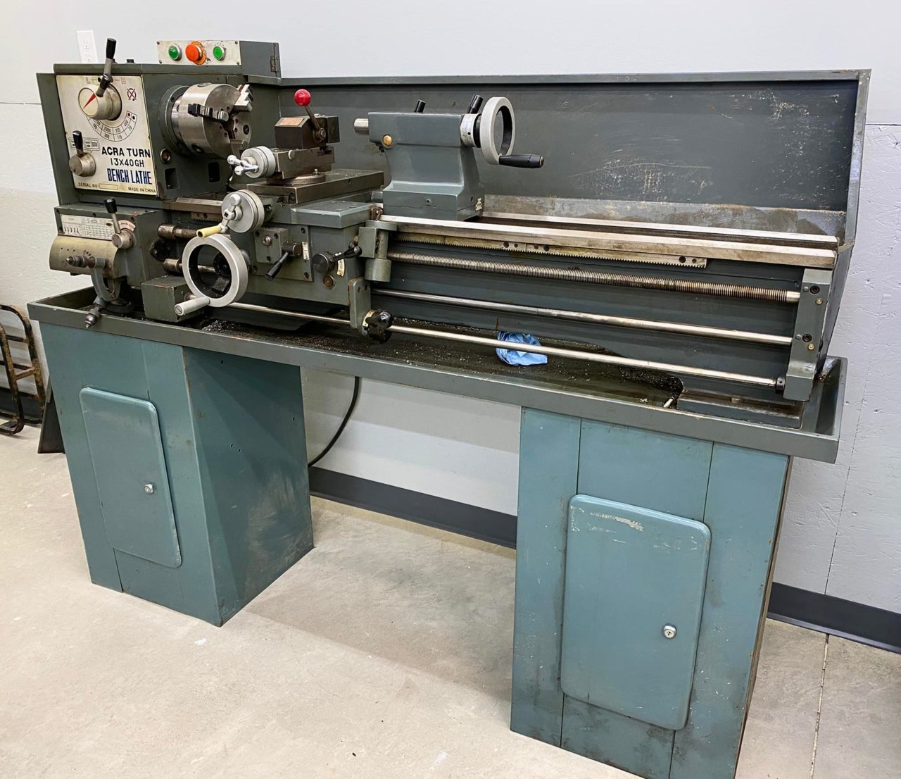

    and last night i picked up a lathe
    277806364_10115967365129103_478702308769_bf7d3a78225fd2ae09e50f577b05794662a0d6fa.jpg
    It's going to be nice being able to turn stuff again (had to sell my old lathe a couple years ago also to make room to fit into a tiny 2 car garage)
