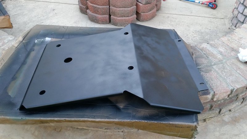

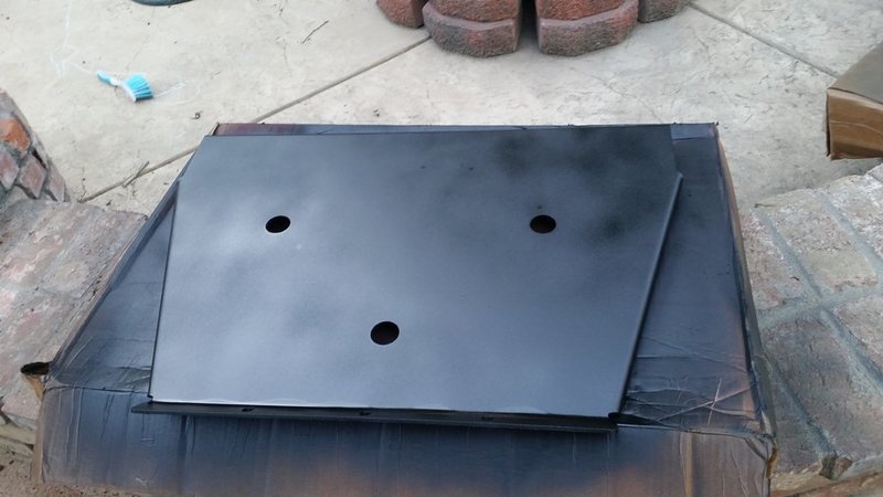

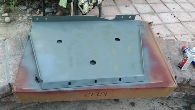

  3. Aug 13, 2015 at 10:50 AM
    #43
    bluedegeon
    bluedegeon [OP] Well-Known Member
    Oct 25, 2013
    #115241
    621
    Colorado Springs, CO
    2017 TRD OR ACLB 4WD
    More to follow :D

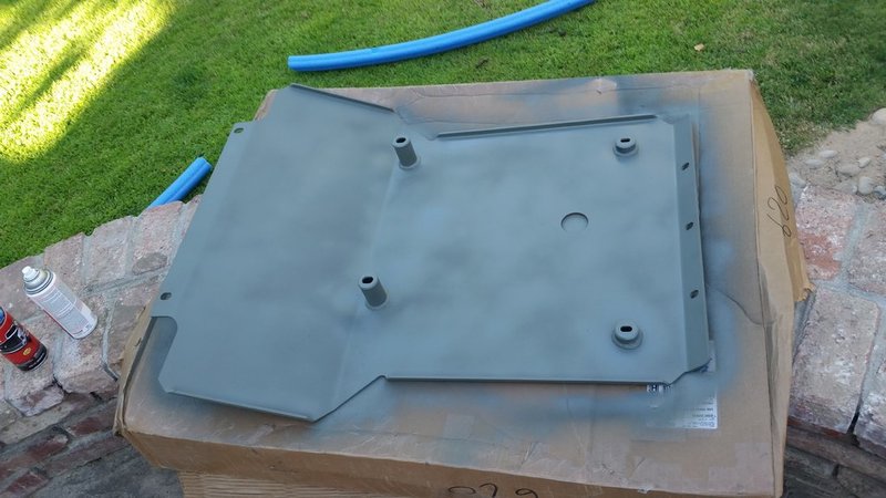

    20150812_180601.jpg 20150812_180604.jpg 20150812_192653.jpg 20150812_192708.jpg
    Crom and Alfred like this.
  4. Aug 13, 2015 at 11:16 AM
    #44
    Crom
    Crom Super-Deluxe Member
    Jun 22, 2009
    #18782
    9,647
    Nick
    San Diego, CA
    2009 4x4 DCSB Camp Supreme
    Millions
    Armor! Looks good. Did you make it?
  5. Aug 13, 2015 at 11:21 AM
    #45
    bluedegeon
    Oct 25, 2013
    #115241
    621
    Ha I wish. It's Pelfreybilt IFS and MID skid. :thumbsup:
  6. Aug 13, 2015 at 11:33 AM
    #46
    Crom
    Jun 22, 2009
    #18782
    9,647
    Nick
    San Diego, CA
    Millions
    Very nice! I'm going to get the same when $$ is replenished. Congrats.
  7. Aug 15, 2015 at 8:49 AM
    #47
    bluedegeon
    Oct 25, 2013
    #115241
    621

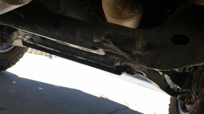

    Ran into problem when installing the mid skid. Haven't had time to work on it since Thursday, maybe today I can straighten it out. 20150813_152033.jpg
  8. Aug 15, 2015 at 9:22 AM
    #48
    Crom
    Jun 22, 2009
    #18782
    9,647
    Nick
    San Diego, CA
    Millions
    very common for that cross member to get beat up. hammer + stout punch should work. :)
    bluedegeon[OP] likes this.

  10. Aug 15, 2015 at 11:11 AM
    #50
    bluedegeon
    Oct 25, 2013
    #115241
    621
    Yep! I have a pretty big friend who is built like a tank I'm going to have him straighten it for me lol.
    Thanks! I want a heretic mainly because it's better build quality and its a single row. I'm having a hard time fitting double row to get it just right. A year later and still can't get it right lol.
    Crom[QUOTED] likes this.

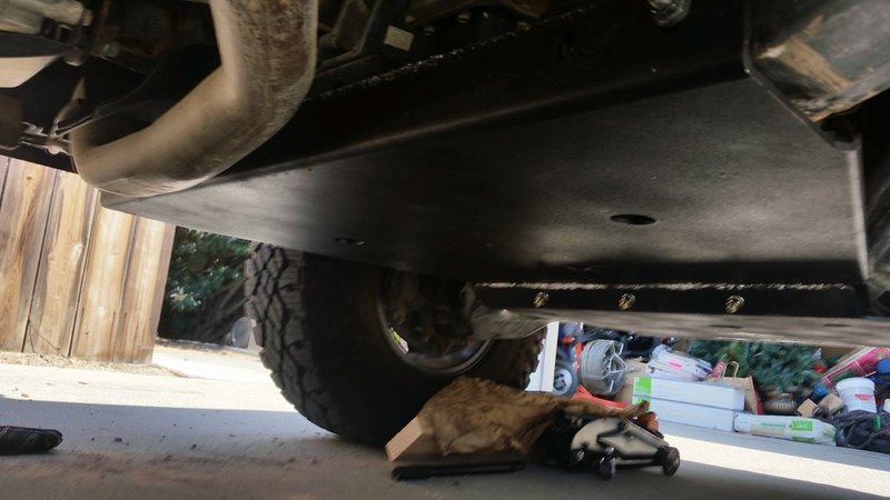

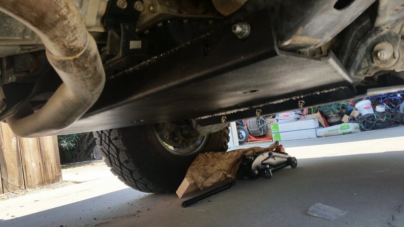

    Skids are on. Bad paint job I know. I'll touch them up eventually but these last couple weeks been kind of hectic 20150818_130556.jpg 20150818_130608.jpg

    Nice are they 1/4" thick?

    Thanks! They're steel 3/16"

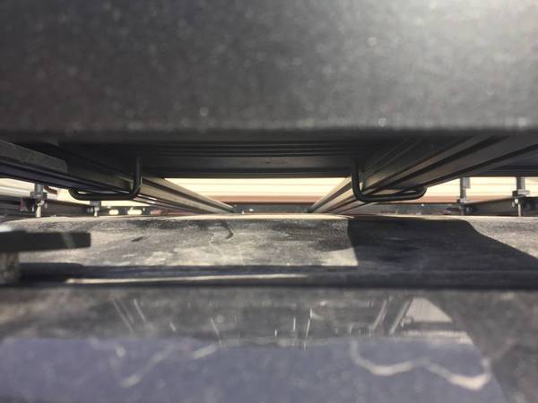

  17. Sep 22, 2015 at 10:30 PM
    #57
    Maximus
    Maximus Well-Known Member
    Jun 18, 2011
    #58482
    1,678
    North Bay
    11 Tacoma TRD OR 4x4
    Icon Suspension with CDCV, SPC Light Racing UCAs, Wheeler's 3 Leaf AAL, Wheeler's Superbumps, sPod SE BAMF Sliders, All-Pro Skids, AFE Drop in filter, Magnaflow Exhaust, RCI Aluminum LCA Skids, BAMF Bed Brackets, 4X Innovations Rear Bumper, FX-R Retrofit Headlights with Philips 4300k, Custom Nestah Edition Firestik AM/FM Antenna, Famous Fab Hood brackets, FrontRunner SlimLine 2 Roof Rack, Mob Town Offroad tailgate reinforcement plate, Ram A pillar mount, Anti-Dark hood lights, Lots of LED lights,
    Nice! How did you mount the rifle case to your roof rack?
  18. Sep 23, 2015 at 10:43 AM
    #58
    bluedegeon
    Oct 25, 2013
    #115241
    621
    Thank you! I used 2'' wide u-bolts from a hardware store, drilled two holes and bolted them down from the inside

  20. Sep 23, 2015 at 10:51 AM
    #60
    Maximus
    Jun 18, 2011
    #58482
    1,678
    North Bay
    Very nice idea. Thanks, guys!
