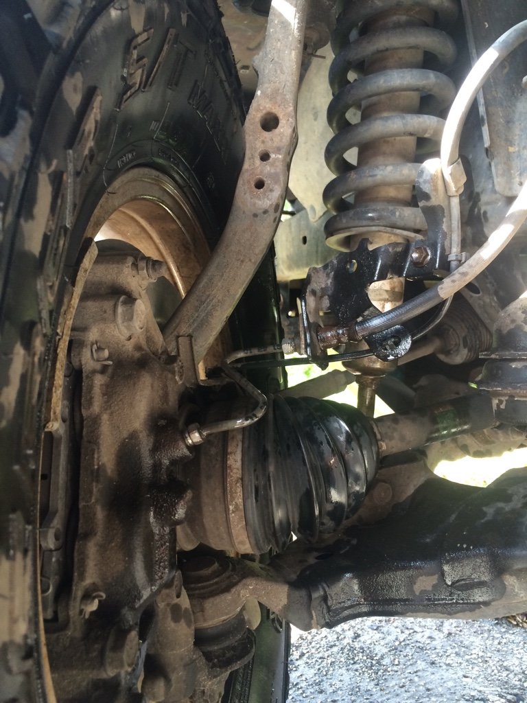

  14. Aug 18, 2015 at 9:00 AM
    #174
    Blueitrgsr
    Blueitrgsr [OP] Well-Known Member
    Jul 25, 2011
    #60495
    1,436
    Brad
    Gainesville, Fl
    2006 Reg Cab 4wd
    Some bilsteins, OME 885's, and an AAL.
    Brake line busted at the caliper. Again. I guess I fudged up by not bolting the brake line bracket on the spindle. When I did the wheel bearing the bolts going into the spindle for stripped. And I just figured the spindle was stripped aswell. So I'm gonna clean the threads and get some new bolts and replace them. Hopefully remedy the issue instead of just a bandage.
  15. Aug 19, 2015 at 7:00 PM
    #175
    Blueitrgsr
    Jul 25, 2011
    #60495
    1,436
    Brad
    Gainesville, Fl
    2006 Reg Cab 4wd
    Got everything taken care of tonight. Put a fresh bolt in the passenger side brake line bracket and it went in no issues. Different story for the drivers side, i really had to force the new bolt in. Just had to make the decision that id rather ruin another bolt and everything be attached then ruin another brake line,and lose brakes again. I guess those threads in the spindle are messed up.
