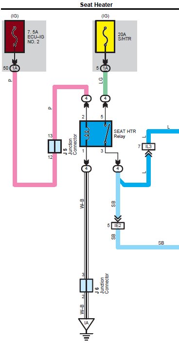

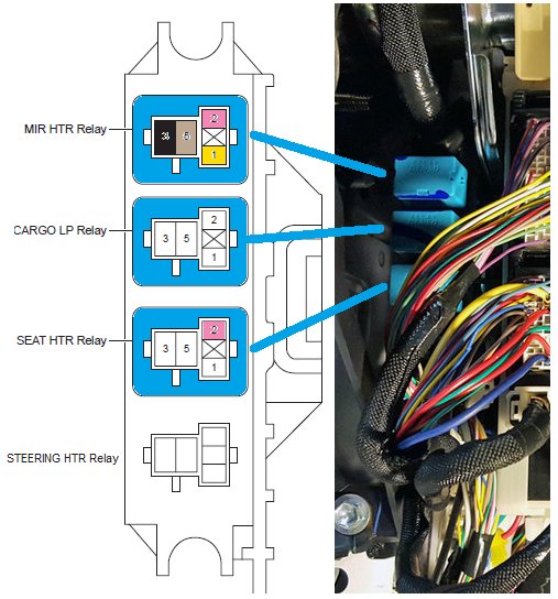

    OP, have you looked at the cab fuse panel? There should already be a relay and a dedicated fuse to the seat(s) heater circuit.

    No, had no idea, thanks for pointing that out. Assumed that the company that did the install would have tapped off that if available but they used the ignition wire. I will take a look and see if I can find it. That would be amazing.
