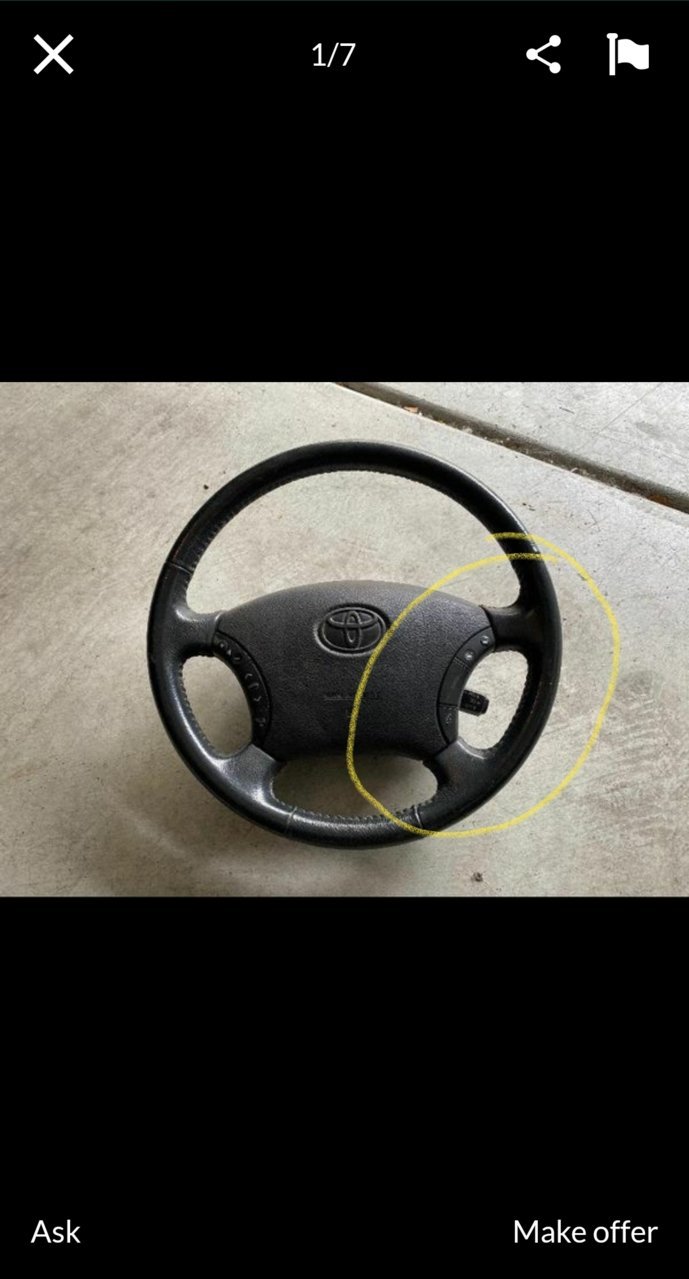

    Hi guys first post I have a 2011 tacoma sr5 it didnt come with the jbl bluetooth package I think that's what's it called. Anyways I came across a steering wheel that has the right side buttons speak pick up or hang up call my question is has anyone swapped it over and it worked plug and play also would the harness take it or is it pinned differently. TIA.

    I have a 2010 that didn't come with JBL or Bluetooth. I installed a BluLogic a few years ago and it has worked great. About a month or so ago I installed the phone switches in the right side of my steering wheel. It looks good but doesn't work with my non-JBL radio or BluLogic system. I think to get that steering wheel to work, you'd need a JBL head unit or non-stock radio with Bluetooth with some type of switch.

    There is a connecting crossover cable that is required to get it to work. if you just swapped out the blank with the switch then it will not work. You will also need a Bluetooth compatible head unit to enable the features.

    Crossover cable was installed too. Moral of the story is that if you don't have the correct head unit, Bluetooth isn't going to work (even if you have BluLogic) just because you put in new switches in the steering wheel.
