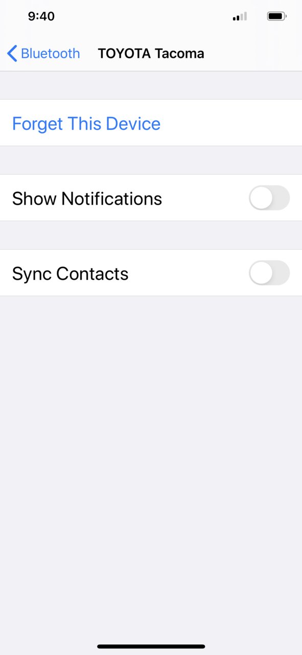

    I’ve had both the iPhone X with 13.3 and a brand new 11pro max. Both have worked fine and not dropped calls on 2017 entune. Couple things I’d try: completely forget phone and entune and start over with pairing. Also, try to toggle off these options in Bluetooth menu on phone.

    Thanks! I tried that several times on both cars and still the drop calls occurs.
