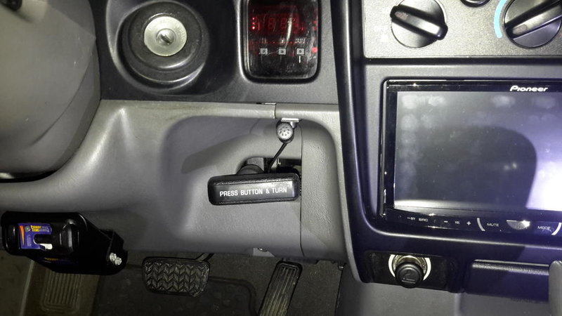

    I mounted my microphone just above the parking brake handle. I wasn't sure how well it would work in that location but it works good and very easy to run the wire.

    People can hear you clearly in that location?

    Yeah, I made a couple calls after install to test it and I was told that I sounded clear. My head unit is a pioneer also and it picks up good.

    Where exactly did you put it? The clip on the mic is too loose to hold on right below where the parking brake is

    I used the double sided tape.

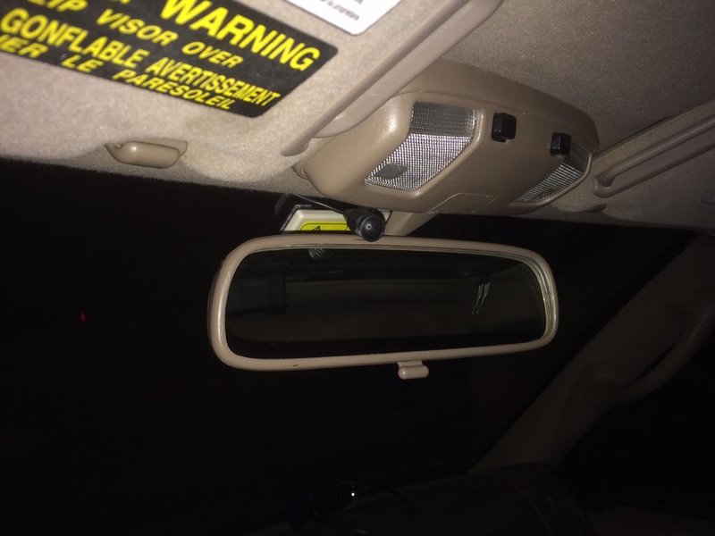

    Crutchfield installer is correct - you can go up the A pillar and across to rear view mirror. Mine is mounted just behind, or under?, the rear view mirror. My truck's not here right now or I would take a peak. IIRC you take off the "Oh shnit" handle (screws or bolts) and the A pillar cover just snaps off from there. Like everything else inside it comes apart pretty easy.
    Mic works fine. Quality of mic varies with your choice of radio and is hard to know how a given location will work until you get going with the requisite road noise to trial it.

    up by the rear view mirror definitely.

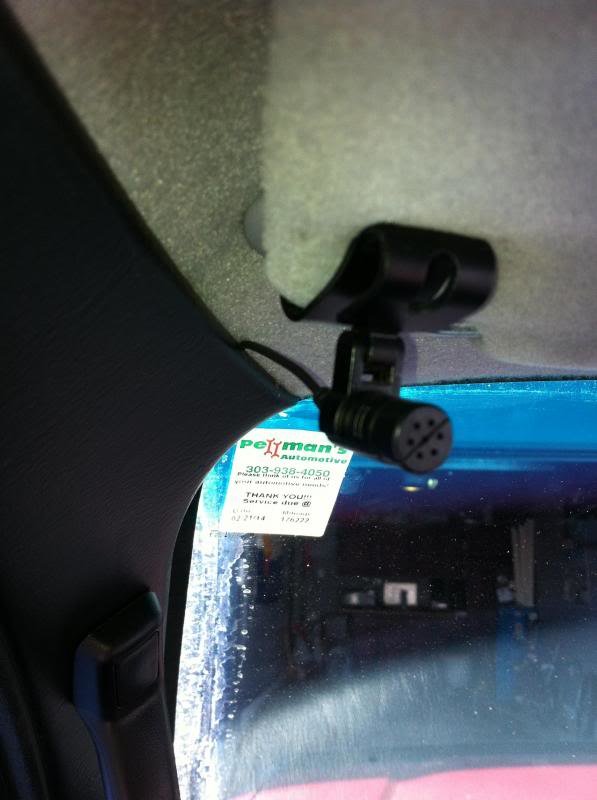

    The caller on the other end of my call will sometimes hear themselves. Which makes sense since the mic is picking up the audio coming out of the speakers.
    They say it's not that bad if I turn the volume down. They say I sound crystal clear.
    I ran my mic up behind the driver's side A pillar and clipped it to the driver's side visor.
    Works great.

    ^This is where I put mine. Works great.

    Based on where the mic is in another vehicle I have, I'd mount the mic near the base of the rearview mirror

    I installed mine almost identically to Madjik_Man. Routing the wire behind the A-pillar was a relatively simple matter and did not damage anything. My mic is actually clipped to the top of the pillar, rather than the visor.
