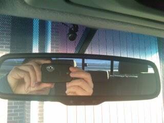

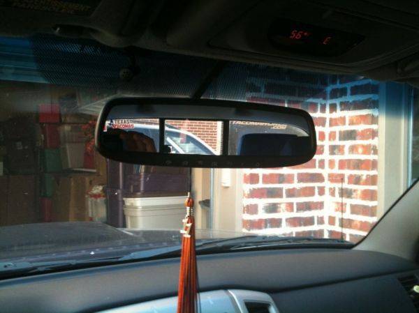

    Mines mounted to the left of the rear view mirror, First pic is a close up and the second pic kind of shows where its at, you can kind of see it, top left of the mirror

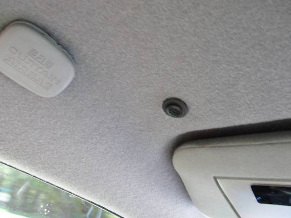

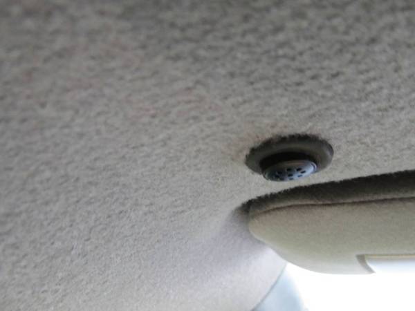

    i mounted min in the garage door holder on the ceiling...

    Hi, I really like your install, I think I might do the same, may I ask where I would be able to purchase a small little grommet like that? thanks

    Check an auto parts store like auto zone or pep boys, they usually come in a package with different size grommets, usually they are used to pass wires through the firewall. It should be on the aisle where they have wire, electrical tape etc. If not check where they have fittings and small parts.

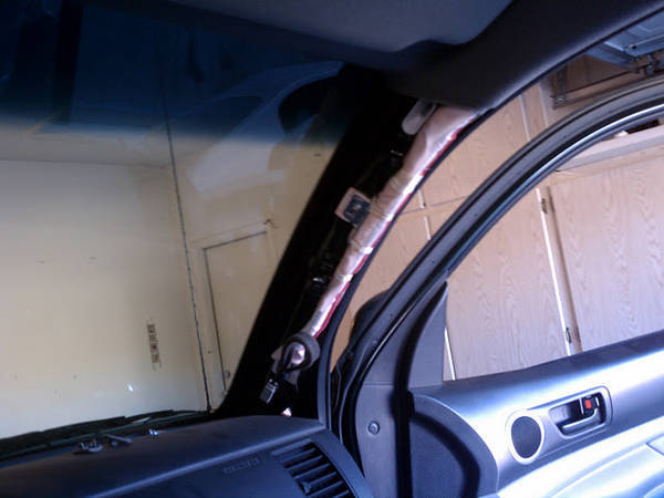

    I mounted mine in the mirror trim. Call quality and voice commands work very well.

    I tucked it into the headliner and ran it down the passenger side A-pillar

    A Pillar drivers side at the top. Works great.
