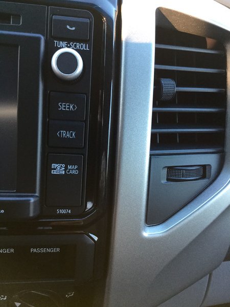

    My Bluetooth sometime disconnects while on a call, is there a chance I could get the update for my 2015 TRD Pro?
    Is this the number you need? 510074
