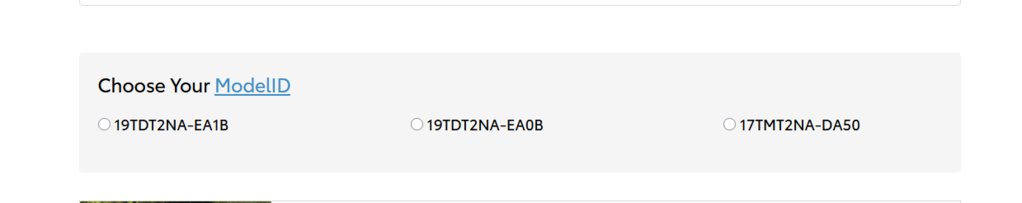

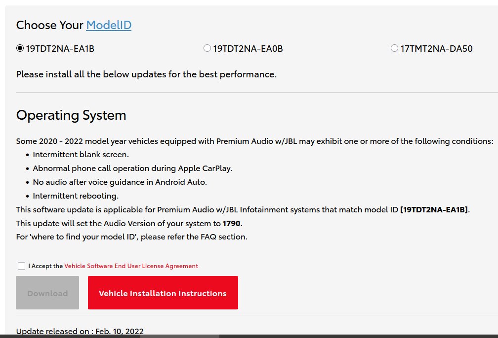

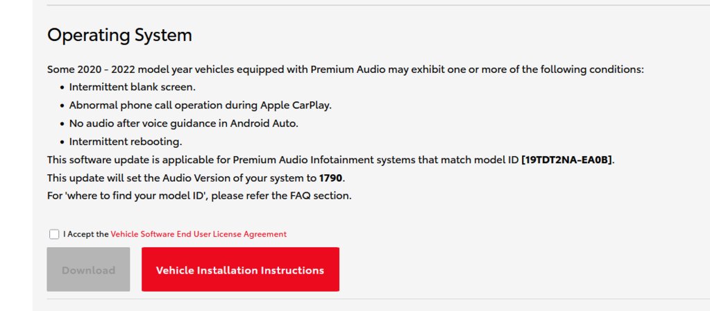

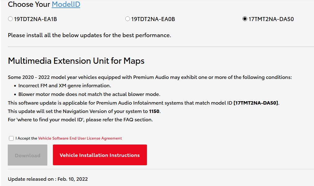

    Check the update link posted above. My 2022 had an update for the Audio system, which specifically addressed iPhone.
    I would wager that your iPhone had a system update that made it incompatible with your car stereo.

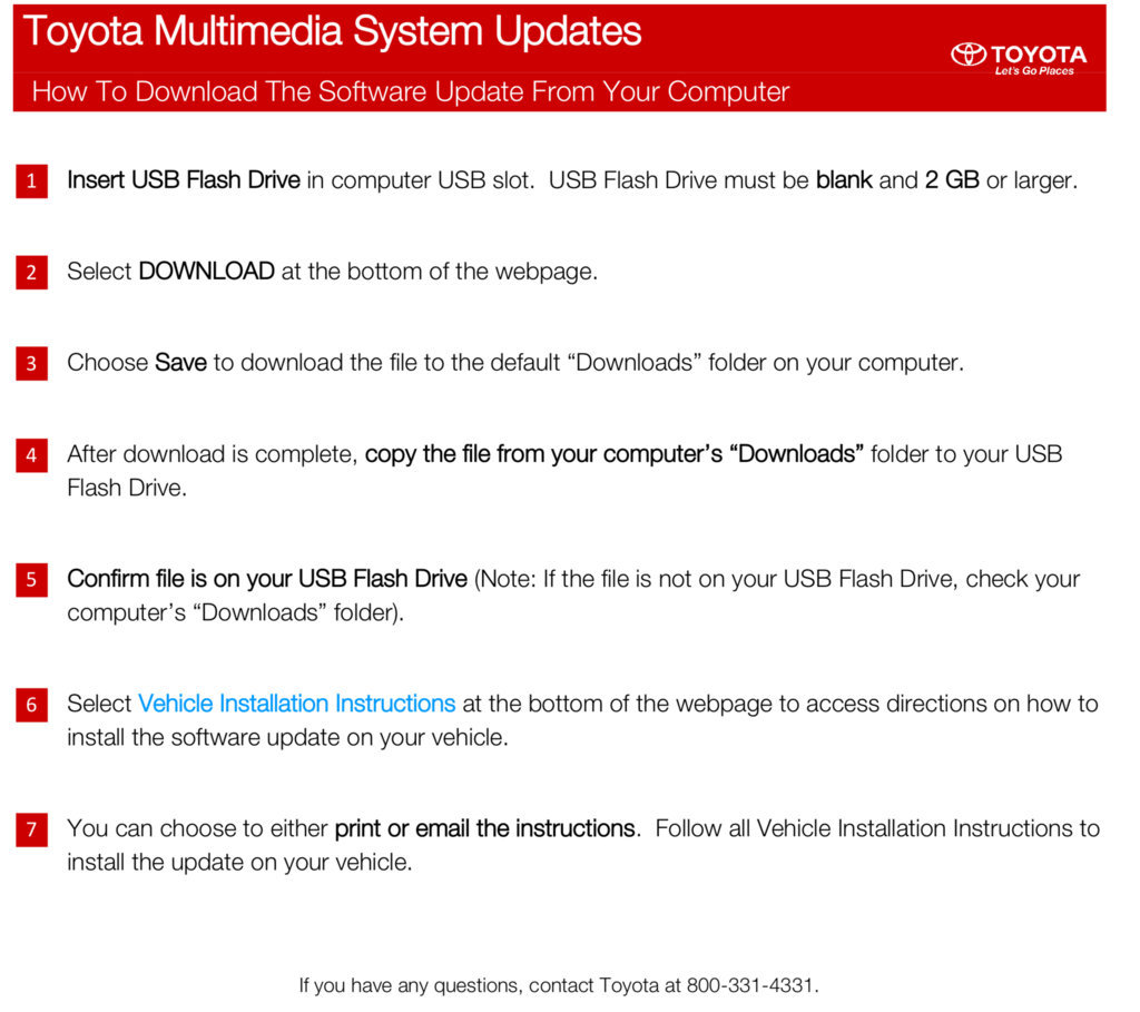

    Update does not seem hard to do. I will do it tonight for my truck. Its Map/Navigation is up to date, but audio system needs an update.
    Download the file, copy to a blank USB stick, go to the update screen, check for an update. Done!

    Here are the complete Entune Firmware Update Instructions also on the link in post #2 above. I had no problem updating my Entune. See if you feel comfortable doing it yourself.
