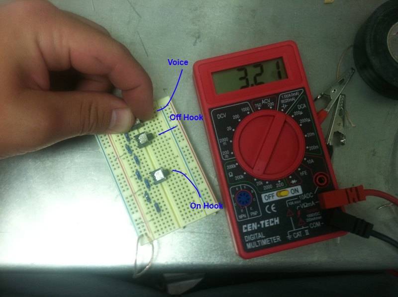

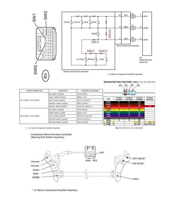

    I started making my own switches while I try to search one out at a wrecking yard. Buying direct from the dealer is still too much for me.
    My home made switches work when I hook them up to the left hand side control signal wires. I am able to adjust the volume and what not but when I hook it to the right hand side controls I get no response from the head unit. I am wondering if the microphone has to be connected before the Head Unit will respond to the steering wheel controls.
    Here are some of my pictures...
    Cheat sheet used for making the switch board:
    Testing the switch board.

    I did. I made my own mic as well using parts from radioshack. If you have the older JBL stereo system with out bluetooth all you need is a 09+ JBL Headunit, less than $20 in parts from radioshack and some basic solder and wiring skills.
    Here is my thread link on the project.
    http://www.tacomaworld.com/forum/au...09-jbl-head-unit-w-bluetooth-2005-tacoma.html
    I realize it is a bit of a read but I tried to include as much information as I could. There was a lot of trouble shooting that I went through but hopefully it makes sense so someone else won't have to make the same mistakes. Let me know if you have any questions.
