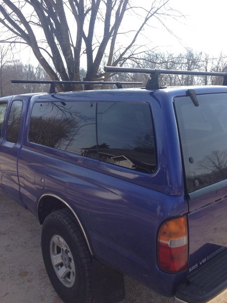

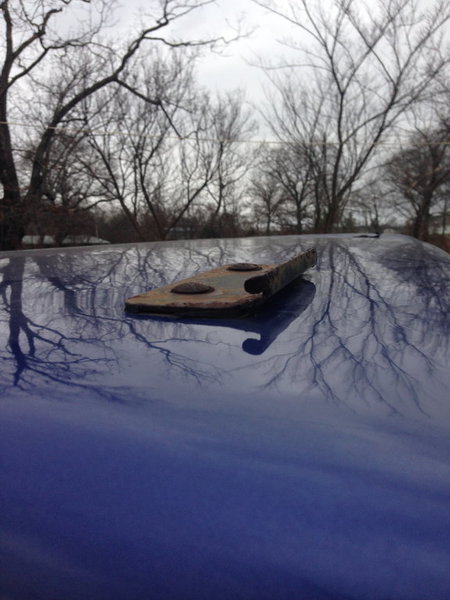

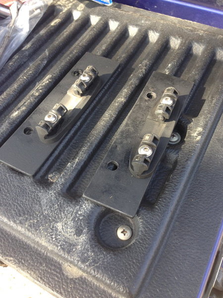

    The truck came with the topper. It apparently had a rack on it at one time. All that was left was some metal plate mounting points for a rack. I had an old yakama rack that i had been saving. The rack wouldn't fit on the existing mounting points. Myfriend fabricated some new mounts that the yakima towers and racks could bolt on to. We used the existing holes in the topper and lots of sealant. No leaks!
    existing mount
    new fabricated mounts with Yakima rack base

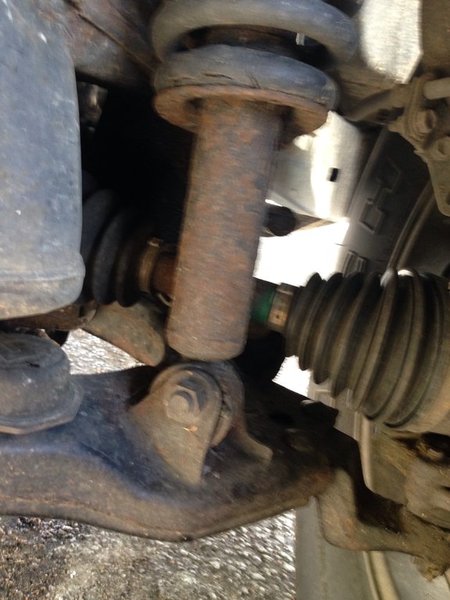

    Took my truck to my mechanic friend to have the oil changed and the suspension inspected. He said that I had a strut that was rusted and likely to fail and that I had a broken end link. The end link connects to the sway bar so I've been riding around with no sway bar for a little while.

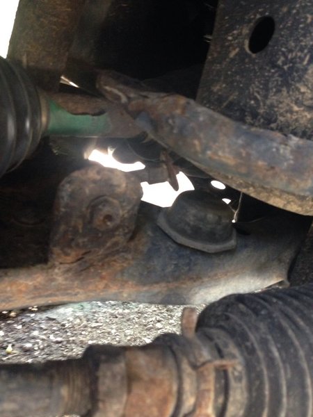

    Broken end link
    You can see the end of the sway bar with nothing connected to it. You can also see the end link leaning over to the right behind it.
