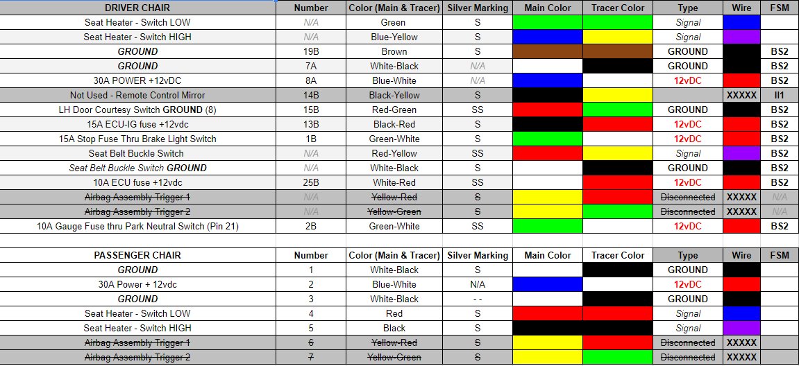

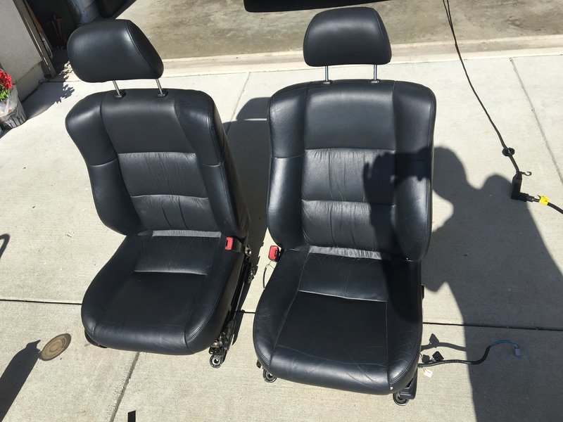

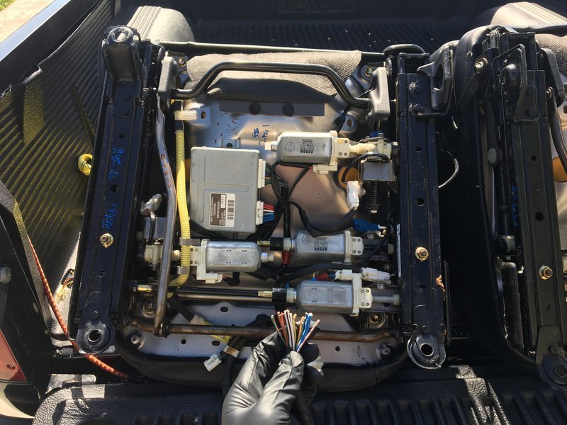

    Finally finished the install of my BMW seats. I started this project with a set of 2011 BMW 328i seats from a salvage yard. One of the key determining factors for selecting these seats was that the width of the rails was nearly a perfect match to the factory ones. I made sure to get the section of wiring that goes from the floor to the seat. My biggest mistake was selecting a seat with memory functions for the driver. I would hate to guess the number of hours I spent on researching the wiring to get full function of the six way power, lumbar support, and heat. Ultimately, I had to basically lobotomize the driver seat, and replace all of the wiring and switch with those from another passenger seat. This was due to the driver switch being tied back to the central computer system, as part of the memory functions. So I had to purchase the wiring harness and a switch for a passenger seat from eBay. Hopefully, I will have luck selling the ones that I pulled from the seat. Spent a couple of evenings pulling and moving pins in the various connectors to get proper function.

    If you have all of the movements functioning, I would say scr** the memory function!! I wish I had been so lucky to just have the motion. Actually, I did have the motion functions for a few seconds, as long as I was moving stuff, but once I stopped adjusting, it would lock up and not come back on until you had disconnected stuff. Apparently, it was trying to save the settings for the memory, and when it didn't have signal from the "brains", it just shut down.

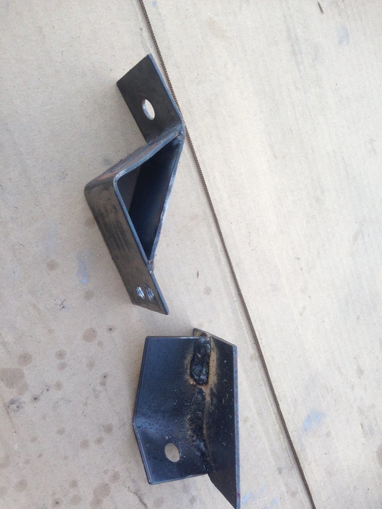

    I heated and bent 1/8 bar stock for the two front brackets, copying the factory profile. Here is the front bracket.IMG_0636.jpg
    Here is a box bracket I made from two short pieces of 2 inch angle iron, after shortening two of the sides to 1 3/4. The one next to the tunnel was 2 3/4, so I added stock to that one, after creating the box. (Just working with what I had lying around, which wasn't much!!)IMG_0637.jpg
    Lastly, here are the taller brackets that were factory height, that I chose to replace with the boxed ones. They match what was used on passenger side, which were welded to the BMW rails.
    If I were to start over, I would remove the bump up in the floor pan (see first picture above), where the front stock brackets mount. This is actually a double layer in the floor, with a void of probably an inch or more. I would remove that upper layer, all the way from the door sill to the tunnel, which would allow the front of the seat to be that much lower. If I were concerned with the strength of the cab floor (which I don't believe I would be), you could always bolt a piece of strap underneath. In the case of the BMW seats, I could bolt them to the floor, using the bolt holes in their rails. This should give them much better range of usable motion. As mine sit today, I doubt that anyone will ever need to tilt the front of the set up. and that is why I didn't make the rear brackets any shorter, though I could have. If I get industrious at some future point, I may go back and remove that hump and lower mine down. Right now, I am tired of working on them. LOL
    Hope this helps!!!

    I got similar sport seats from E92 with same features (memory, lumbar, heat, side bolsters) and because I needed to do way more work to get all features going and had to leave town at the time, I just did a quick kill switch to power the forward/back position and seatback recline features. Kill switch because the CANBUS system in the seat wouldn't be getting this specific signal from the car (because it's basically not connected to anything other than power), so it would shut itself down. So when I want to move the seat, I turn it on, adjust, then turn it off. But I don't have all the other features when I do that, just the absolute basics. I want to power the other features ASAP before winter BUT I don't need memory if it just creates more headaches. I just want to be able to adjust the other parts and have heated seats.
    Did you eventually just abandon memory feature? Did you find out more about the way to make them work? How critical was it to have the floor-side of the seat wiring harness? If you have any pics or wiring diagrams, I'd SERIOUSLY KILL FOR THEM lol. I feel like a caveman working on a space rocket (I hate wiring).
    THANK YOU
