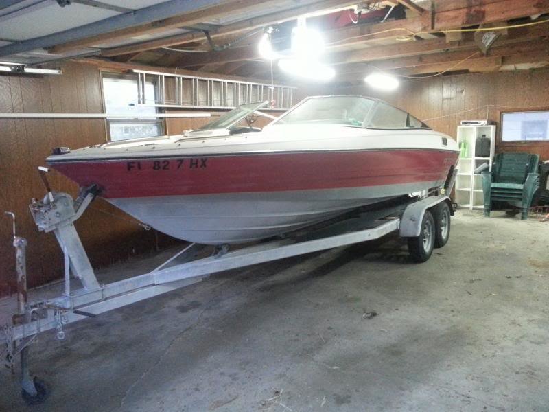

    This was the day I pulled her home:
    Her life sitting outside is now over, she will be cared for as a boat should:

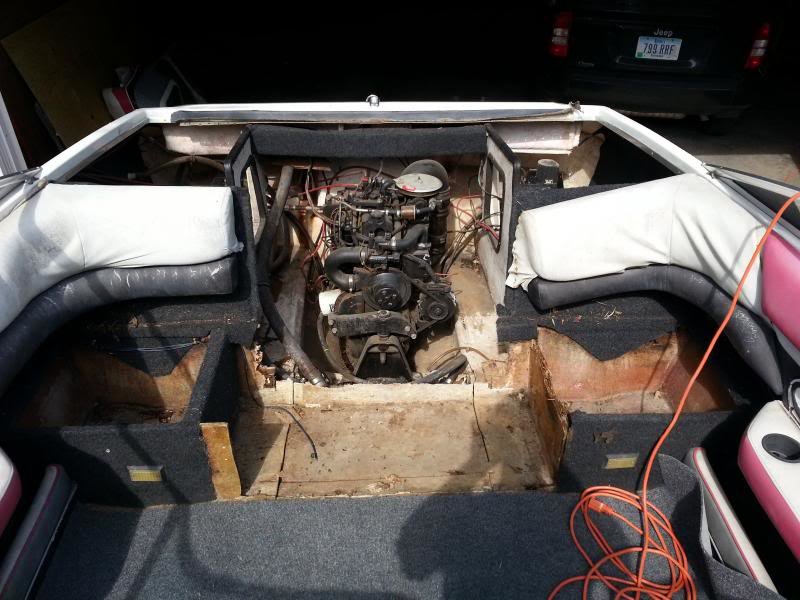

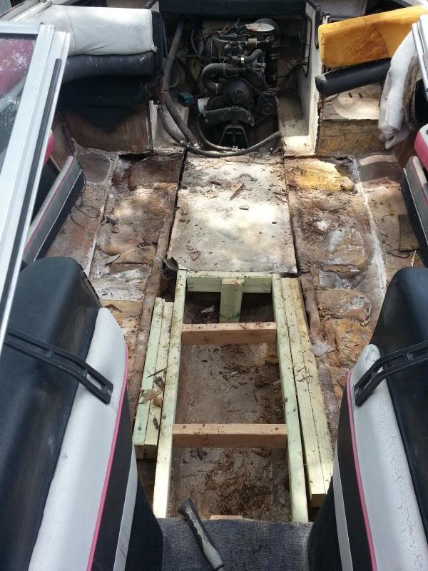

    Here is the damage...
    Diamond in the rough, a perfect running 3.0 Mercruiser:

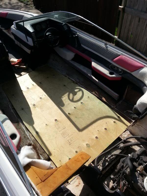

    The whole floor was weak and squishy, so it all came up.

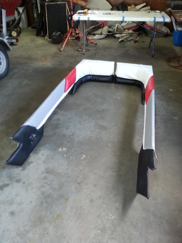

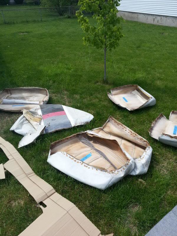

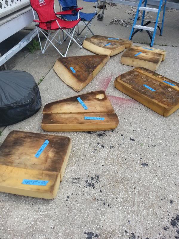

    Also took all the seats apart, dried them out and got them ready to be re-covered:
    I saved the vinyl in case we want the patterns someday.

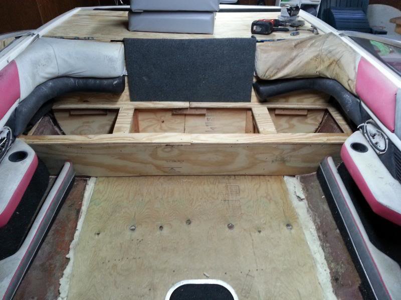

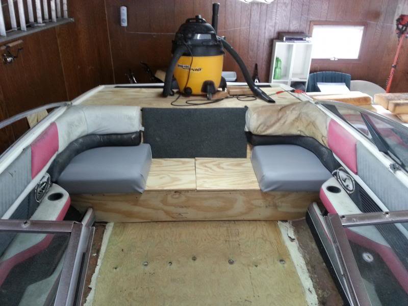

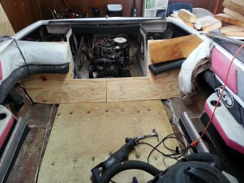

    Next was rebuilding the floor and back seats:
    Also rebuilt the engine cover/sun deck at this time:

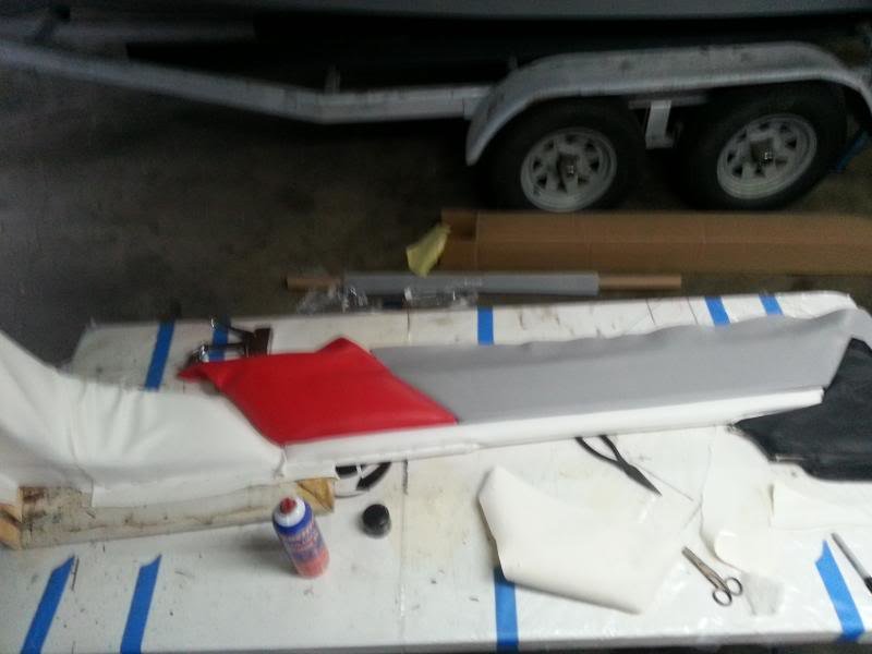

    Did a real basic wrap on the seats, here is a couple with the seat framed in:
    Previous owner called me to let me know he had the ski hatch, so I put that back in:

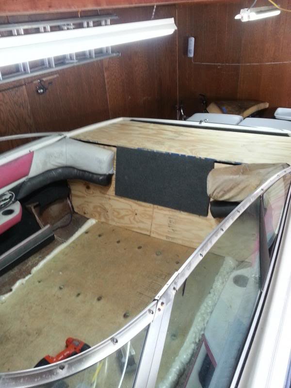

    Various rebuilding pics, I didn't take any pics after I glassed the floor in, wasn't much to see...

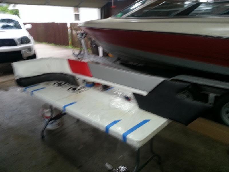

    At this point I decided to take off the side panels, and try my hand at vinyl for those as well. Also redesigned them into a more basic piece...

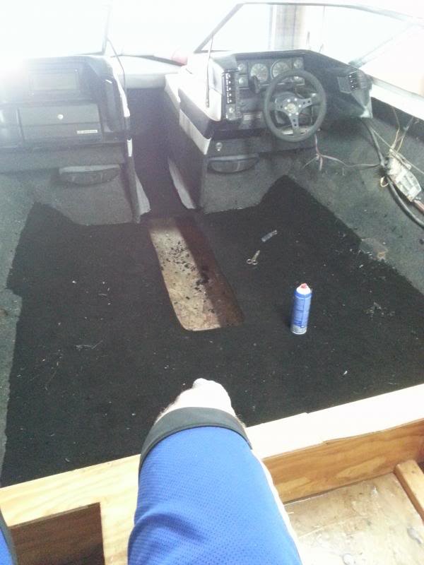

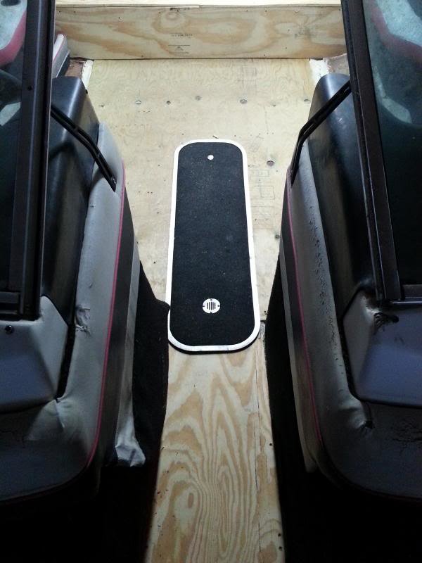

    Time for carpet now.

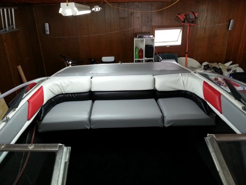

    Alright now here is everything back in and finished up. Really happy with the outcome:

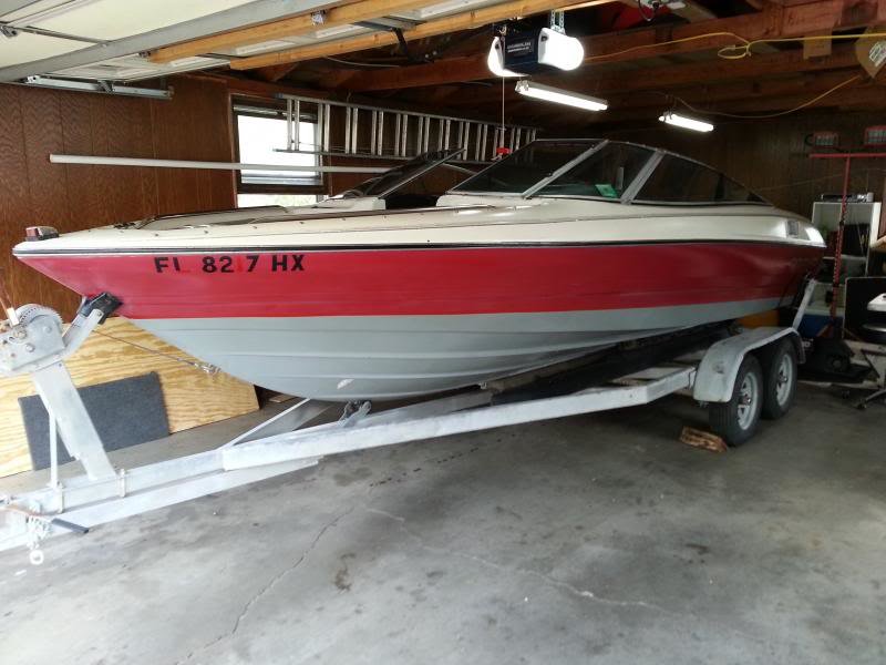

    Shined up and ready for the water:
