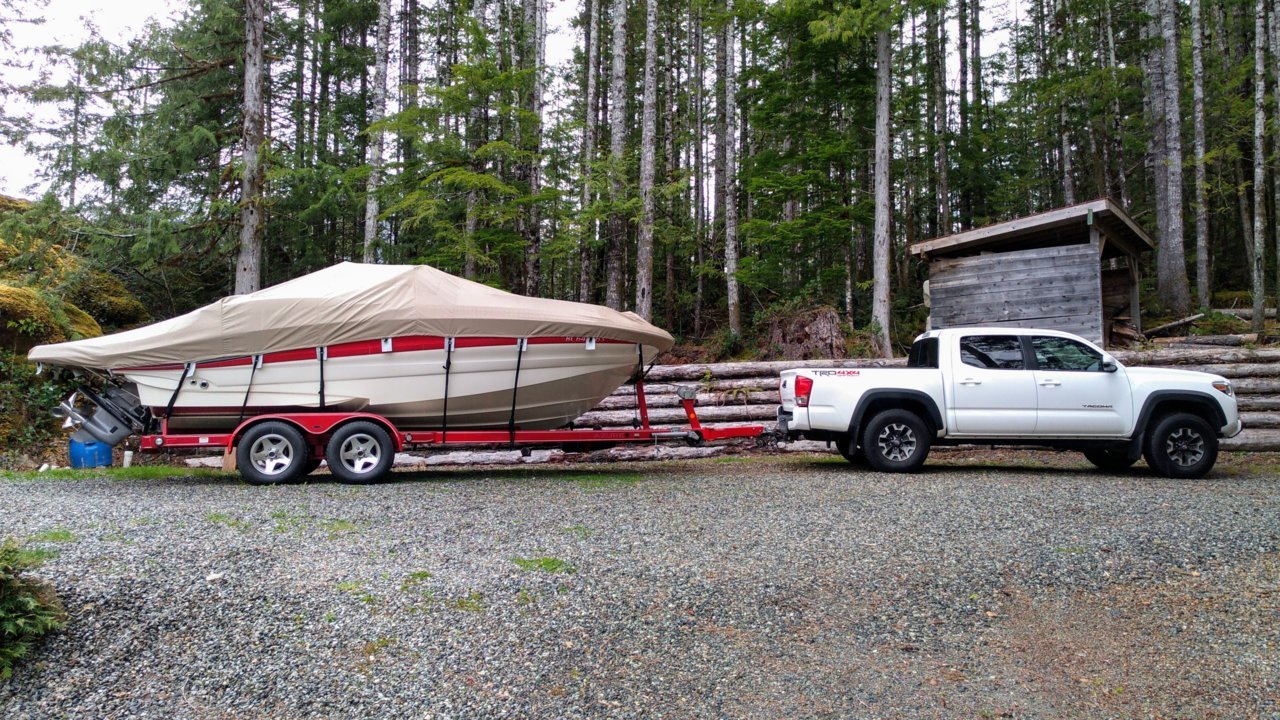

    My boat and trailer weigh in at 5700lbs, definitely feel it back there but tows fine. Tongue weight is about 600lb and drops the rear some but not a problem IMG_20190414_1435433~2.jpg
