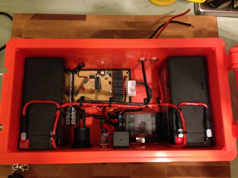

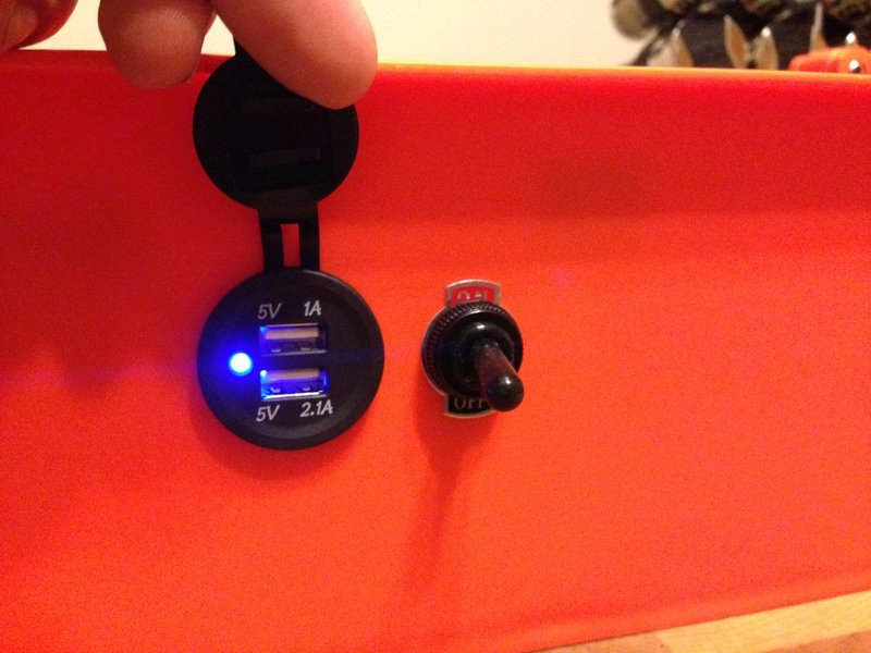

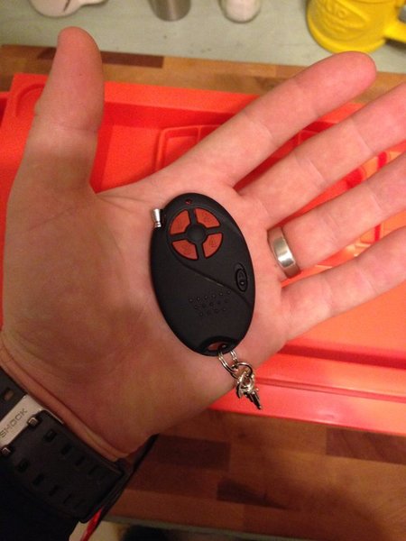

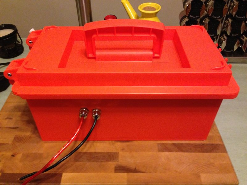

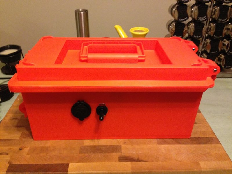

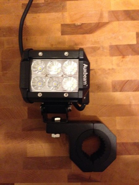

    almost done with my dad's birthday present. got it working, but I still have some tweaks to make before it's done.
    Summary: When coming back to their boat (44' trawler) at night on the dinghy (8' inflatable) it can be hard to safely approach, tie up to, and get off onto the back of the trawler. I'm giving them lights that will clamp to the back railing on their upper deck. with a small key fob, they will be able to turn on the lights wirelessly as the come up behind the boat, making it much easier and safer to get on and off the boat at night.
    How:
    it's a watertight box that houses two sealed 12v batteries. also in the box are the fuses, relay, and wireless control panel. even though they will likely house the box in a compartment near where the lights will be mounted, everything that penetrates the box is fully waterproof. a 12v solar panel with built in charge regulator (to prevent overcharging) will be remotely mounted (probably on the aluminum beam that supports their radar dome/satellite/etc. so once this system is set up, they should never have to think about maintaining it (until the batteries die years down the road.
    front of box. waterproof switch and usb charger with waterproof cover.
    back of box. main power and grounds that will run the lights. still need to toss the waterproof plug on the end. still to be added is one more of the stainless steel waterproof penetrations, which the charging cables from the solar panel will run through.
    The guts
    The key fob. I the box can run 4 different items. my folks came by for dinner last night, so I showed them how it works......they've already expressed an interest in some other things they'd like it to run, so I'm glad I can be easily expanded to run more channels. have not tested the remote range yet, but all they really need is 50 feet or so.
    the lights and mounts I'm supplying them with.
    the lights are just your average 60 degree led flood. cracked them open and re-sealed them since they will be outside in a marine environment 24/7. mounts are powdercoated aluminum with stainless hardware, and different sized rubber inserts that allow it to fig a range of tubing, since I'm not sure what size their handrail up top is
    and that's all for now. next pictures will probably be when everything is installed. they've moved the boat from Maryland to north Carolina for the winter, so I'm not sure when they'll be there next to bolt everything up.
    k9cop and 95 taco[OP] like this.
