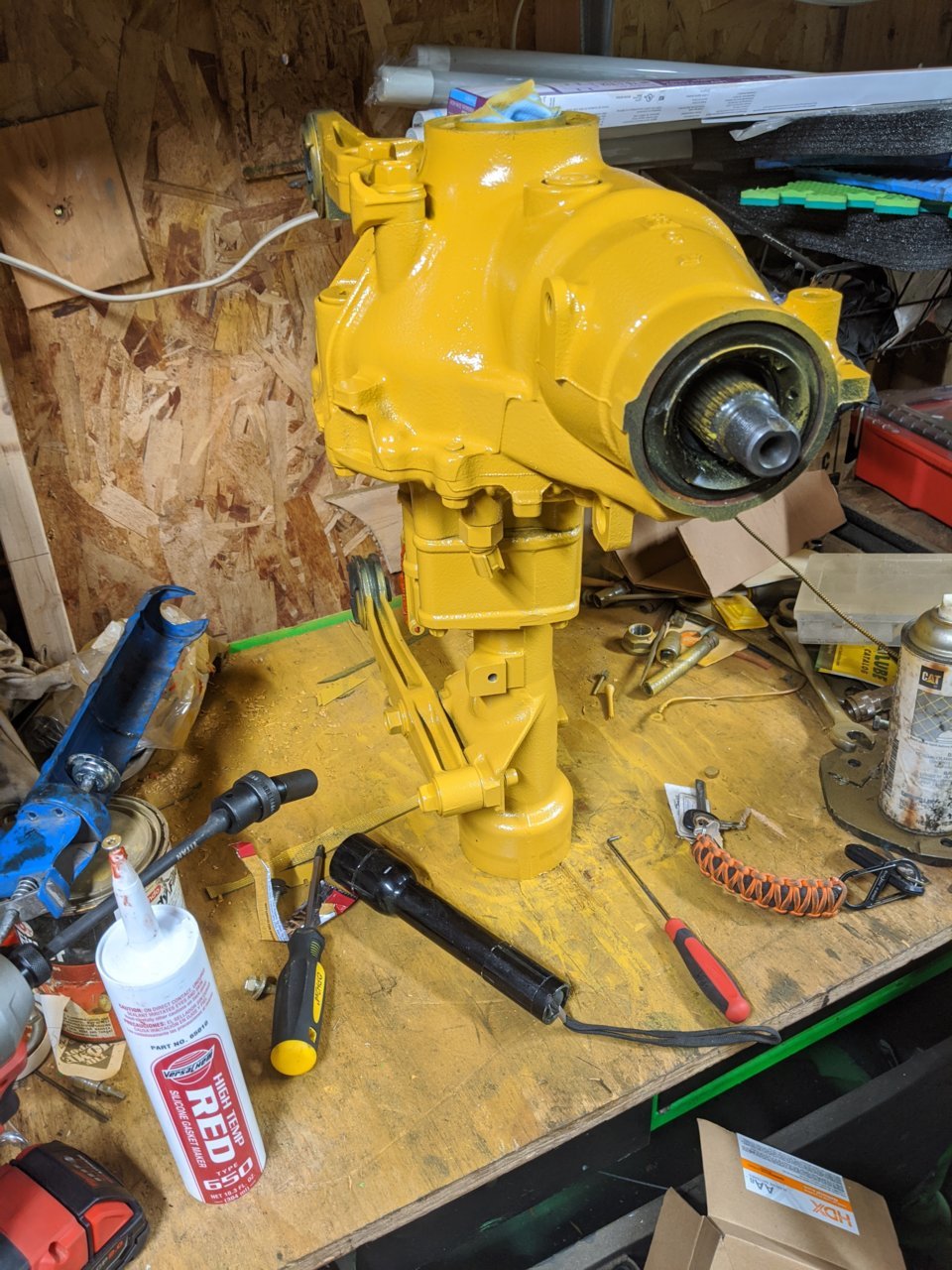

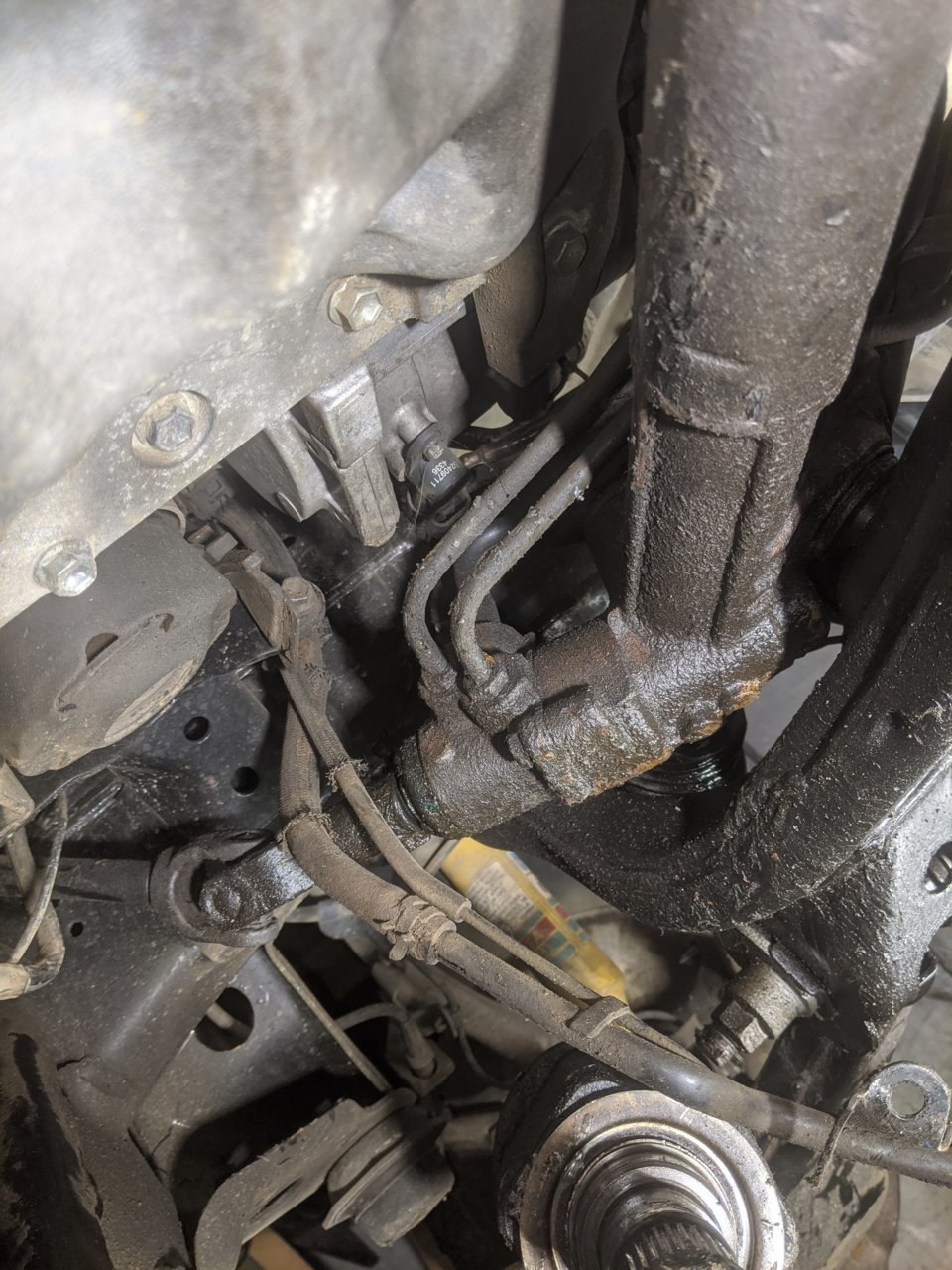

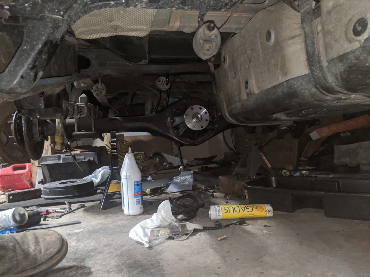

    Front 3rd member is out, now on to this leakin sonova pig.

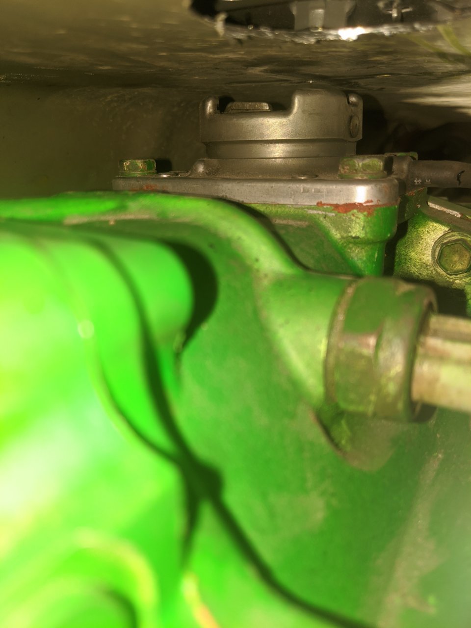

    Because cat yellow.
    Currently waiting on the right pinion flanges to arrive. I ordered the wrong one last time. The splines were right, but not the bolt pattern. Doh.

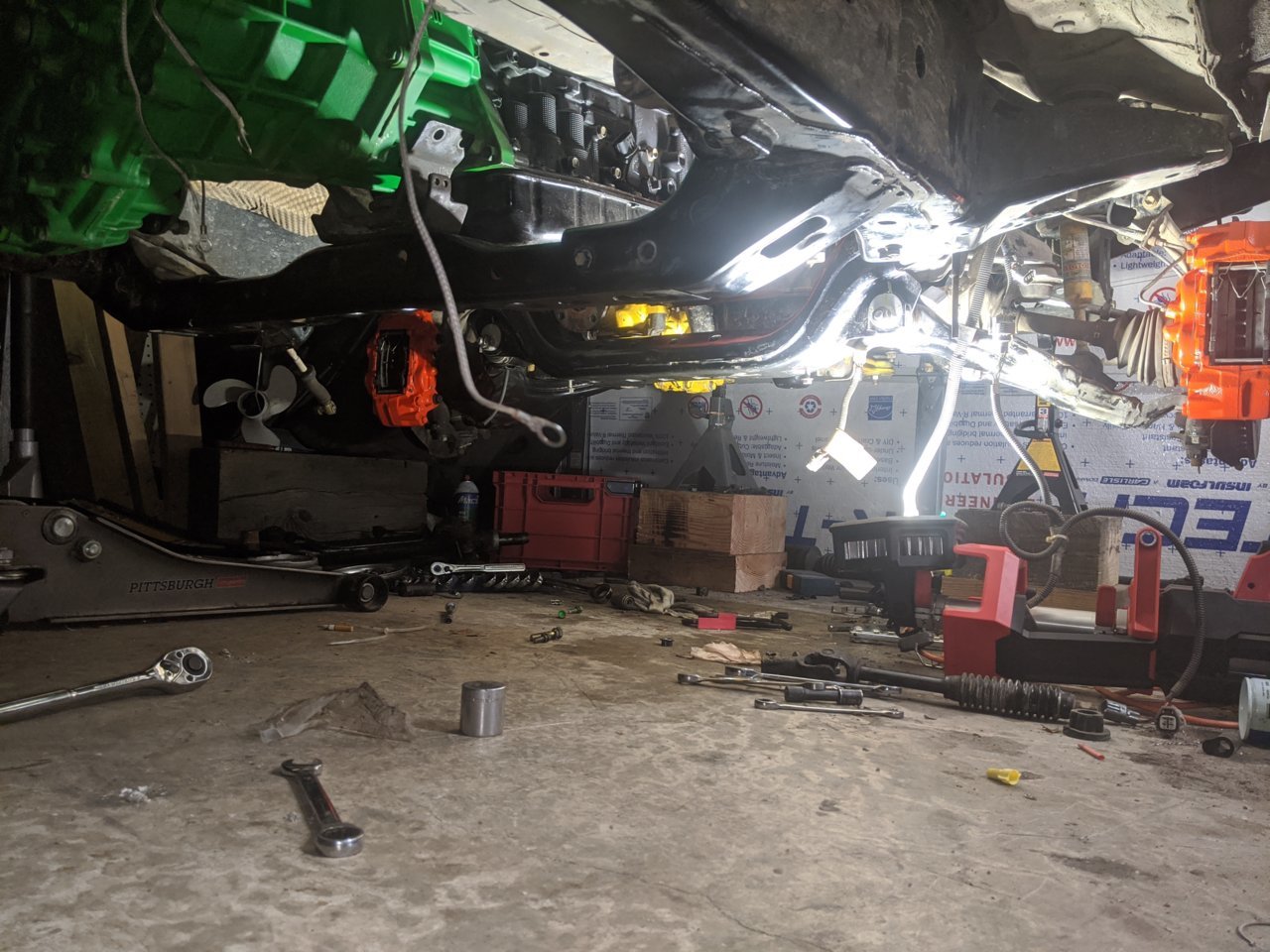

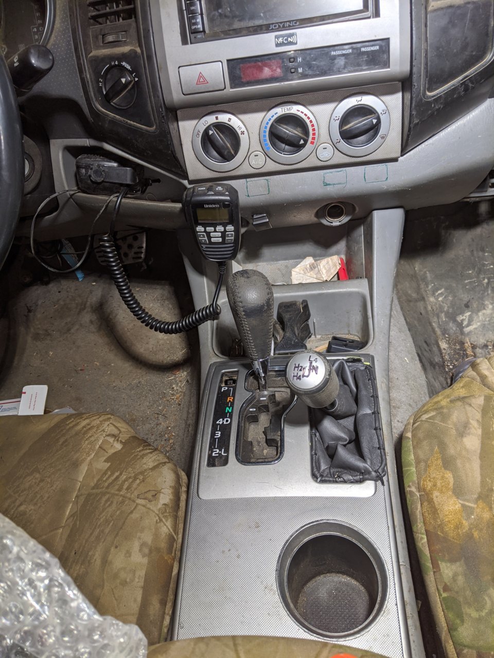

    Suited and booted. Shifter is all ready to go, now much left now. Waiting on new front calipers and new rear axle hub/bearing assemblies. Feels like I haven't driven my truck in a year. :goingcrazy:

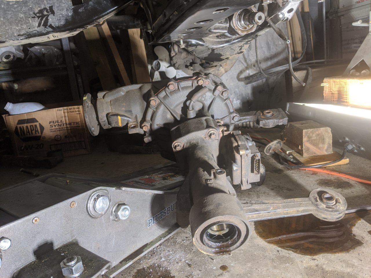

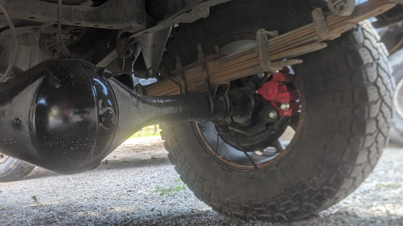

    Well trucks all back together, transmission has been swapped using a donor from a 2012 t4r, and 4.30 gears are swapped using a 2017 Tacoma front clam and a 99 limited t4r rear elocker. Completed a 400mile round trip excursion over the memorial day long weekend and now it's just various odds and ends to wrap up. Like: finish 1" body lift on the bed, install rear leaf springs, finish rebuilding icon coilovers and the list goes on.....
    The rear diff is subject to escalation on the list as I almost had a fubar situation with it when the fill plug on the rear axle fell out along the way on my road trip and as far as I can tell, cooked the bearings. It now makes a god awfull noise at freeway cruising rpm. I luckily had brought extra gear oil and found a way to plug the axle off again from spewing gear oil the rest of my trip.

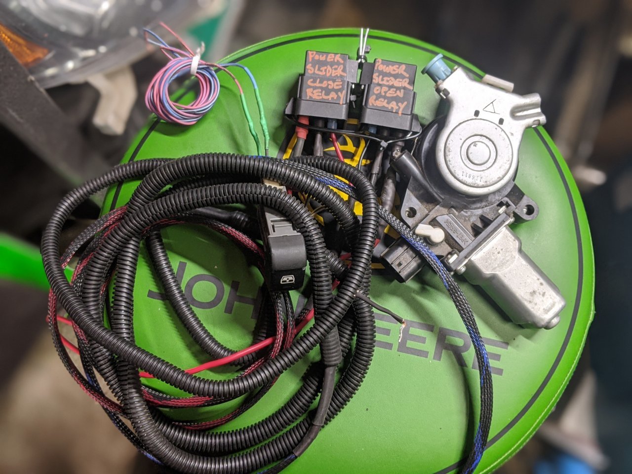

    Made the wiring harness for the power rear slider, now to get my cables in routed and I'm in business.

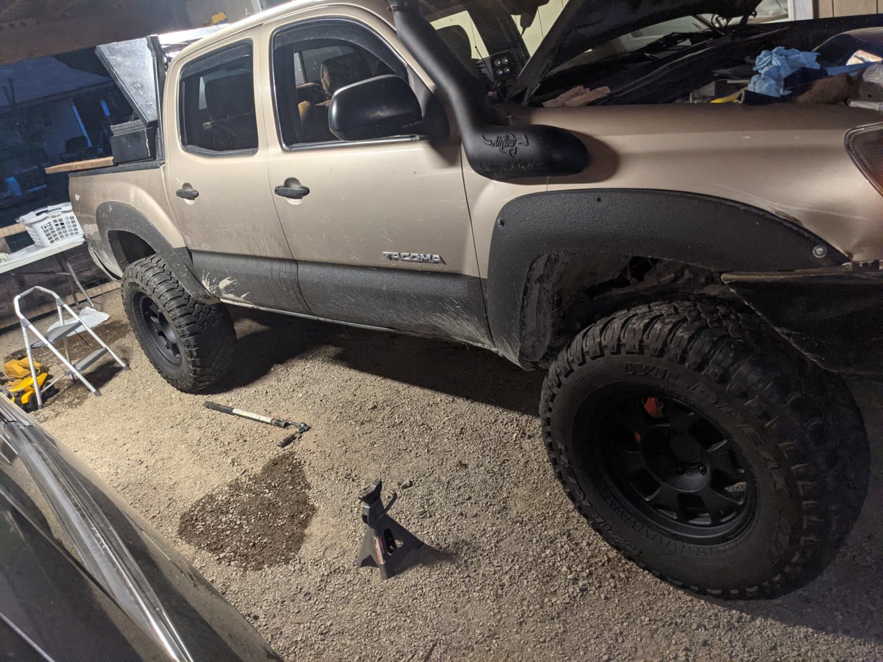

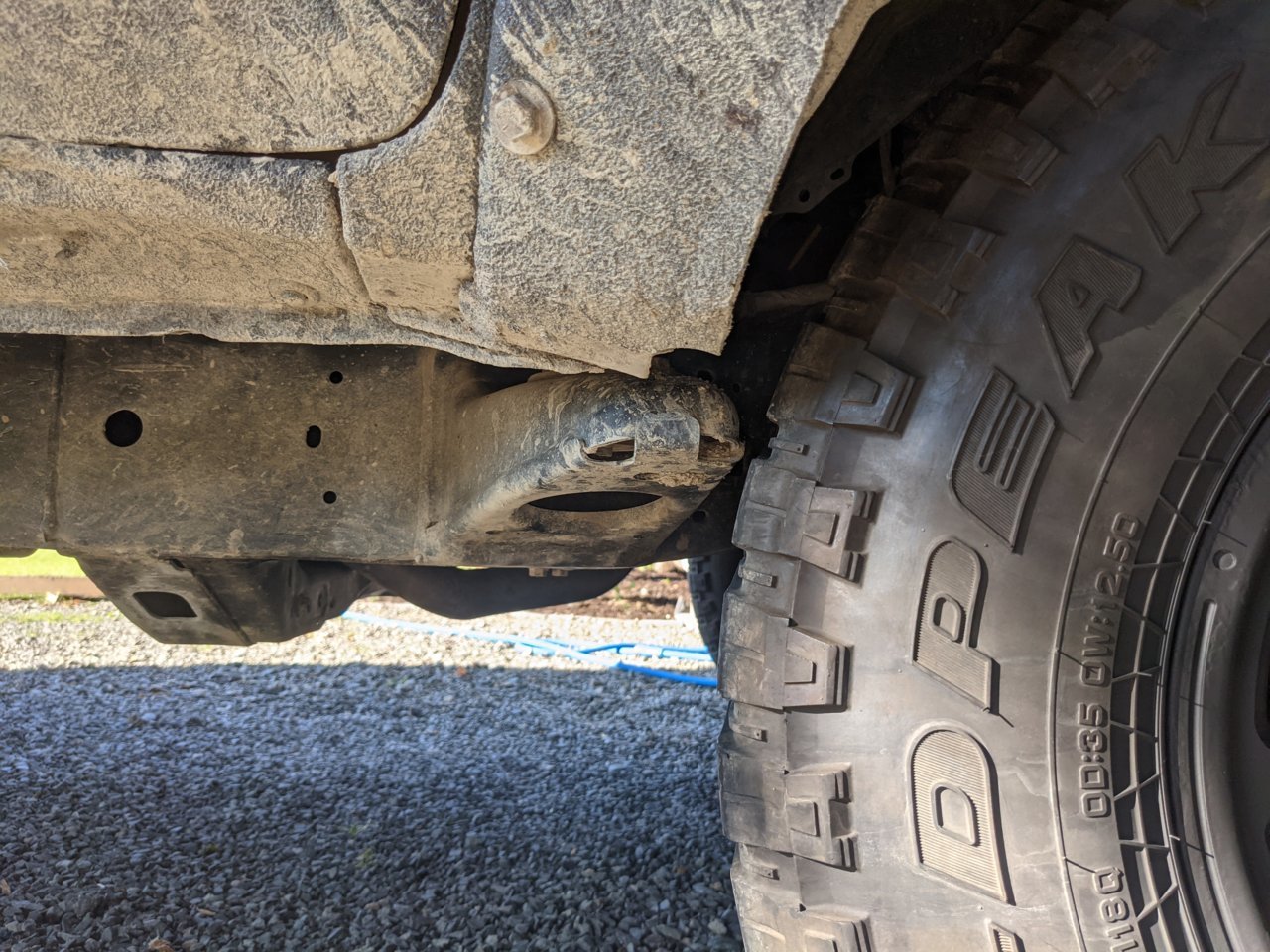

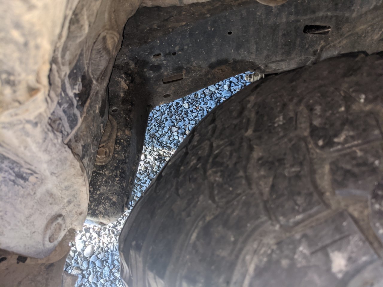

    Because 35s are always the next phase of progression. @Usethe2nd generously donated his old falken 315/70/17s to the cause. Tomorrow I'll take them for a spin after I finish up my AC repair project.

    You want dibs on my 37’s when i get my next set of tires :D
    how’s the frame clearance at full lock?

    Yeah that's gonna rub like a mf'r on the trail, or flexin at the mall.
    Edit: just rubbed a lil backing up and cranked. :bananadead:

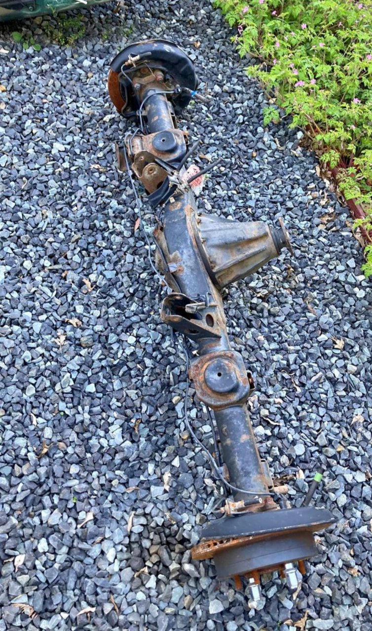

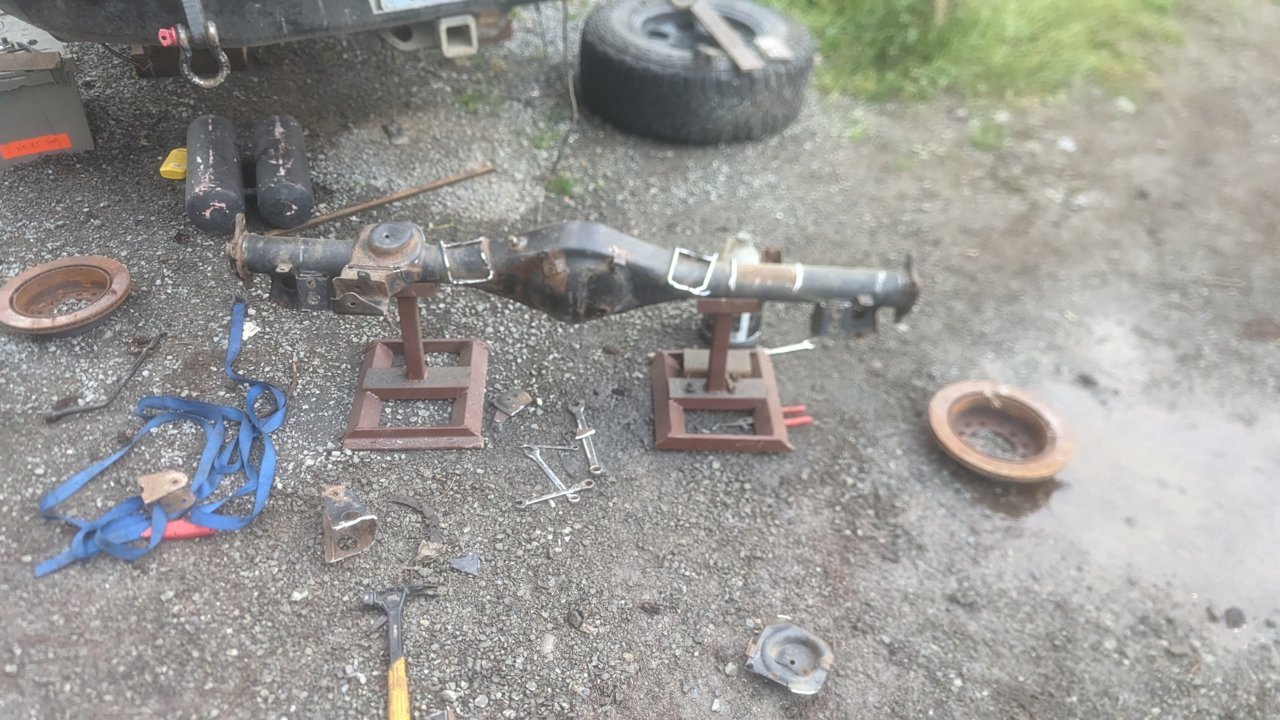

    Been a minute since I've updated my trucks changes, so here's an update. A few weeks back I had a wheel bearing fail, allowing the rear axle shaft and wheel to leave the axle housing and try to pass me doing ~50mph. I figured it was a sign that it was time to do something with the rear axle so I decided on rear disc brake conversion using an axle from a 03+ t4r/gx470. Need to finish cleaning up the remaining suspension brackets the t4r and gx use, and weld on the leaf spring perches.

    Are track width and axle ratios the same? I don’t think the diff pumpkin from a Tacoma would fit, right?

    They use an 8.0 rear diff

    track width is the same. depending on the source of the axle, the gear ratio can vary between 3.73 and 3.90. v8 vehicles received the 3.73 such as the gx and some t4r also the AT fjc, or the 3.90 being found in the 1grfe t4r anb MT fjc. i cant speak for all years, but the axle im using, the 3rd is bolted in using 10mm studs, similar to the elocker axles. i also have an "8.4" axle houseing and the biggest noticable difference between those and the elocker/non elocker housings is that they use 12mm studs to mount the diff. so it would stand to reason that much like the earlier mini truck axles, which also used 10mm studs, i will be able to modify this housing by notching out on the drivers side (right hand side when looking to the rear of the truck at the pinion, left when looking to the front or from the rear of the truck) and also need to drill and tap a couple new holes to add the studs needed to accomodate the elocker actuator.

    For now I'll be just running it as is, 35's on 3.73 :anonymous::annoyed::bananadead:, and down the road I'll either notch it for an e-locker or source another axle for the end cups to weld on my elocker axle. I think the notching idea would be easier than trying to align and make the axle tube end cups true so that I don't end up going through wheel bearings like candy. I'm about to start tacking the perches and then burn them in once I know they're in the right place. I've decided to also clock the perches to compensate for the pinion angle and eliminate the need for a shim.
