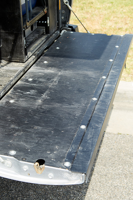

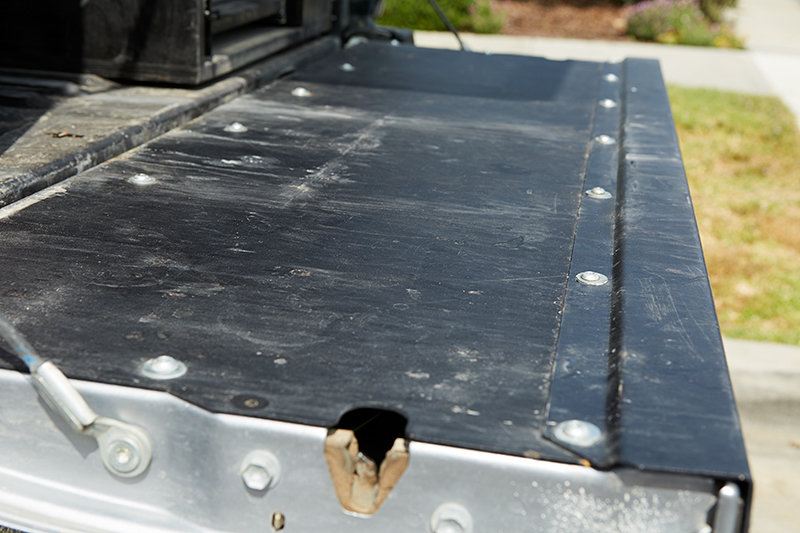

    About a year ago, I installed a Tailgate Reinforcement Plate and Tailgate Reinforcement Cap from Mobtown Offroad. These were modestly priced and a very easy mod. But I gotta tell you, this is one of my favorite modifications to the truck. I always hated the ribbed tailgate plate, because the uneven surface made it a pain to set down beers and other things. (Emphasis on the beers!) Also, I tend to kneel on the tailgate while getting in and out of the truck, and the ribbed plate was so uncomfortable on the knees. Therefore, I bought the smooth version of the reinforcement plate from Mobtown.
    Go out and buy this now!!! You won't regret it. @Mobtown Offroad

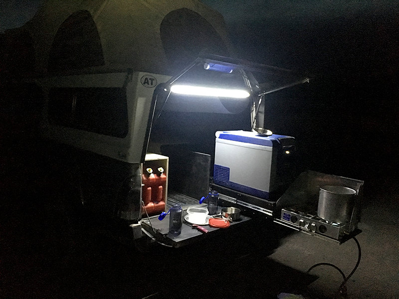

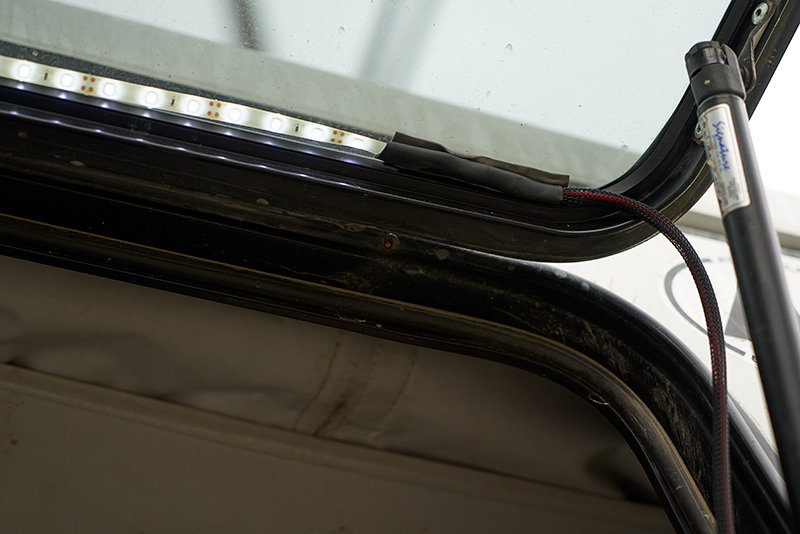

    Another mod that I did was add LED strip lighting to my shell rear window. This serves as great lighting for the tailgate area when cooking. Simple! Cheap! Easy!

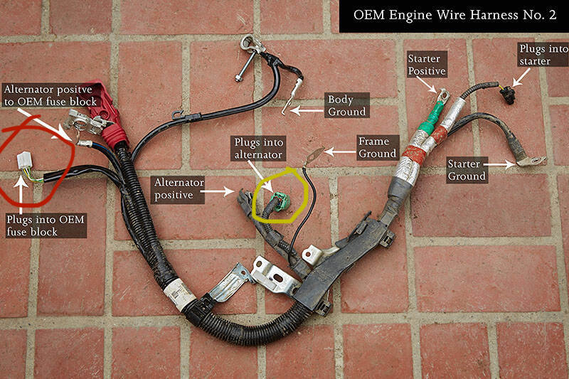

    About 3 years ago, I purchased and installed a 250A alternator from CAE in Van Nuys, CA. Well, today I removed it and re-installed my OEM 140A alternator, because I was having problems with the 250A this past weekend. Basically, the battery light turned on and then fluctuated while I was out in the desert. I also observed via my ScanGuage that the voltage level of the primary battery was jumping around from as high as 13.7v to as low as 11.2v. This was looking like a voltage regulator failure. Bummer because I planned on camping out Sunday night, but I didn't want to take the risk being in the middle of nowhere with this problem.
    Anyway, with the old one back in, things look good so far. I think I'll take the 250A alternator back to CAE and see if I can swap it out for another one or if they can sell me a new voltage regulator.

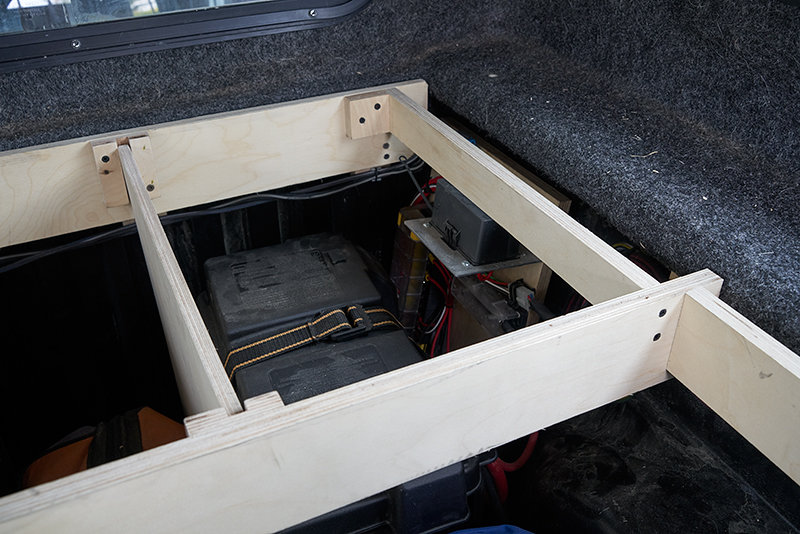

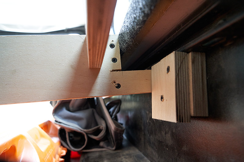

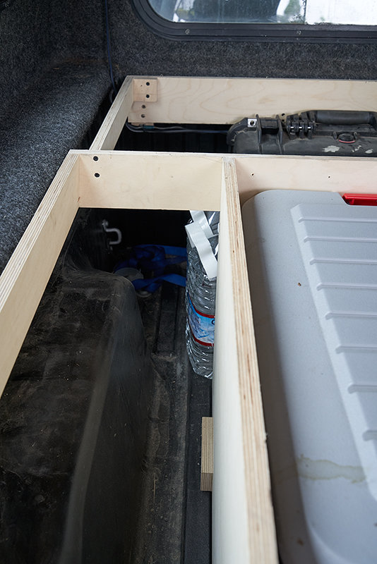

    Last November, I started work on my bed storage. I used 3/4" Baltic birch plywood for the structure and walls and 1/2" Baltic birch plywood for the lids.
    The storage is basically made up of a frame and walls. In this image, you can see the basic frame setup. This is front driver side.
    The manner in which I secured the frame in place wasn't necessarily uniform throughout the bed. But generally, I attached small blocks of wood to the bed walls and then attached the frame to these. This image shows the detail of how the frame is attached to the bed sides and how I had to fur out some of the blocks to accommodate the rails and shell. This image is just above the driver-side wheel well.

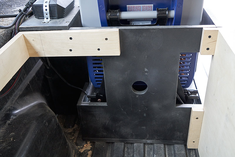

    Here's the framing around my aux battery and RTMR. This is front passenger side. Take note that there is a wall to the left of the battery, which is removable, and basically keeps the electrical area isolated.
    With regards to design, the entire storage area is simply a frame. The only walls are what surround the clear area down the middle of the bed, which you'll see in just a moment. This was done to maximize storage as well as keep the weight down to a minimum. To secure the walls to the bed floor, I used rivet nuts and then attached small blocks of plywood with 1/4-20 bolts. The walls were then screwed to these blocks of wood.

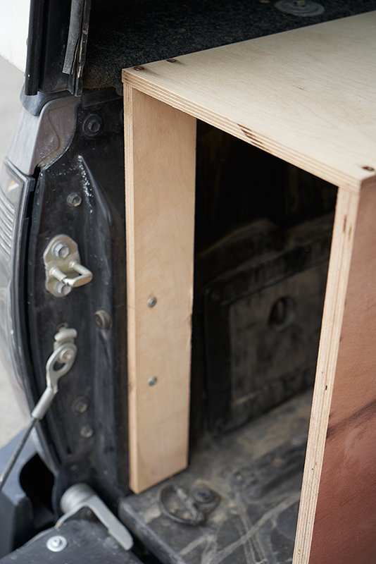

    At the rear of the vehicle, I simply attached the plywood to the bed sides using wood screws directly into the fiberglass bed. Worked out great. Notice that I still have access to the OEM storage compartment.
    With the fridge slide-out cabinet already installed, I was able to attach my storage framing directly to it.

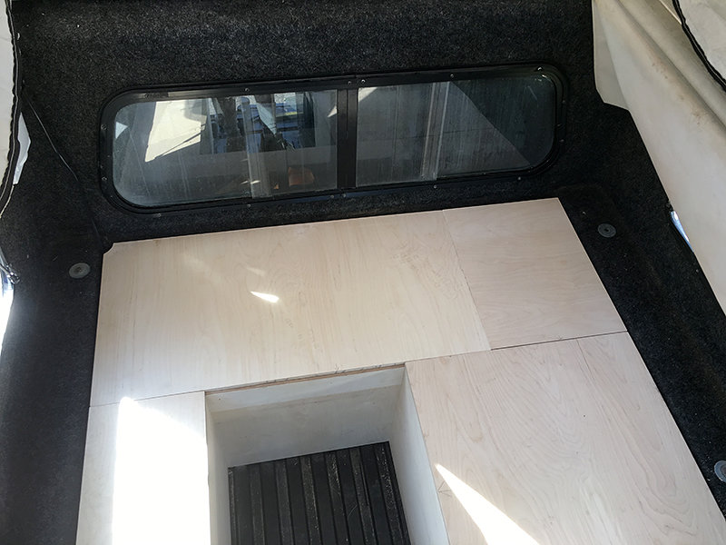

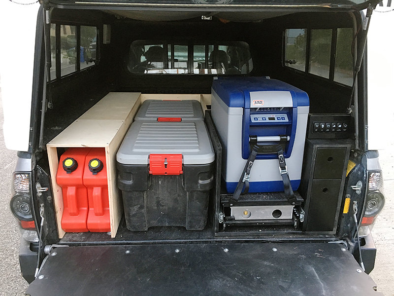

    The storage is complete, but not yet painted or covered in carpet. I haven't decided exactly how I want to do this. All of the plywood on top of the frame is removable to allow access to the storage underneath. These are currently held in place with gravity, but I installed small blocks of wood to the underside to keep them from sliding around. Also, this image shows the walls surrounding the clear area down the middle of the bed.
    Here's another angle taken from the tent/sleeping area above the cab. Notice that I left a corridor or "hallway" down the middle. This is used for two Action Packer storage boxes while traveling. These are removed when at camp so I retain standing height in the bed. It's also a great bench to sit on.

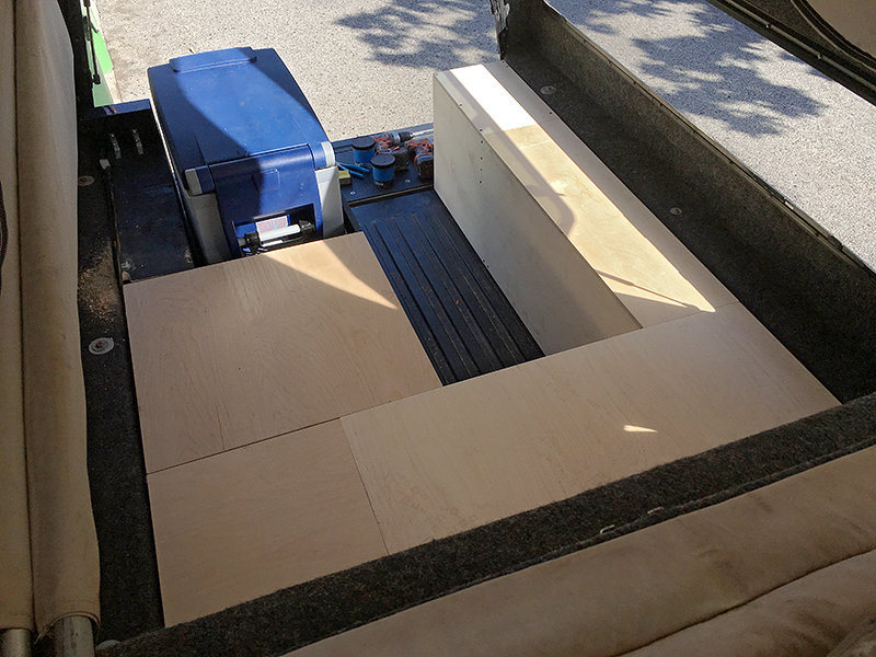

    From the rear of the vehicle, you can see how everything is packed in. If you recall earlier from from my post showing my fridge slide-out build, I mentioned how tight the tolerances were. As this image shows, there is no extra room. I had to build the fridge slide-out with the exact measurements of the gas cans, Action Packers, plywood wall thickness, and the width of the drawer slides. That was quite the challenge.
    In conclusion, this build has definitely met my needs and I couldn't be happier. I went into it without a clear vision of how to make it work. I just knew what I needed and worked around that. The key was to have enough foresight to think of any potential pitfalls. The prime example is the tight tolerances that I had to keep in mind when I built the fridge slight-out.
    Let me know what you think and if you have any ideas of how I could have improved this. Maybe it'll help the next person who wants to do something similar.

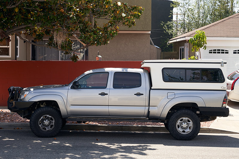

    My truck had been long overdue for new leaf springs. After installing the Flip-Pac a few years ago and recently the auxiliary battery and bed storage, my OEM springs with an Icon add-a-leaf were really starting to sag. I had always planned on doing custom leaf springs, but I felt like the springs were becoming a safety hazard so I didn't want to wait any longer. After some research, I settled on Dakar EL096R heavy duty leaf springs. These made quite a difference as the pictures show. The distance from wheel hub center to fender was 21.5" before and 24" after.
    BEFORE:
    AFTER:

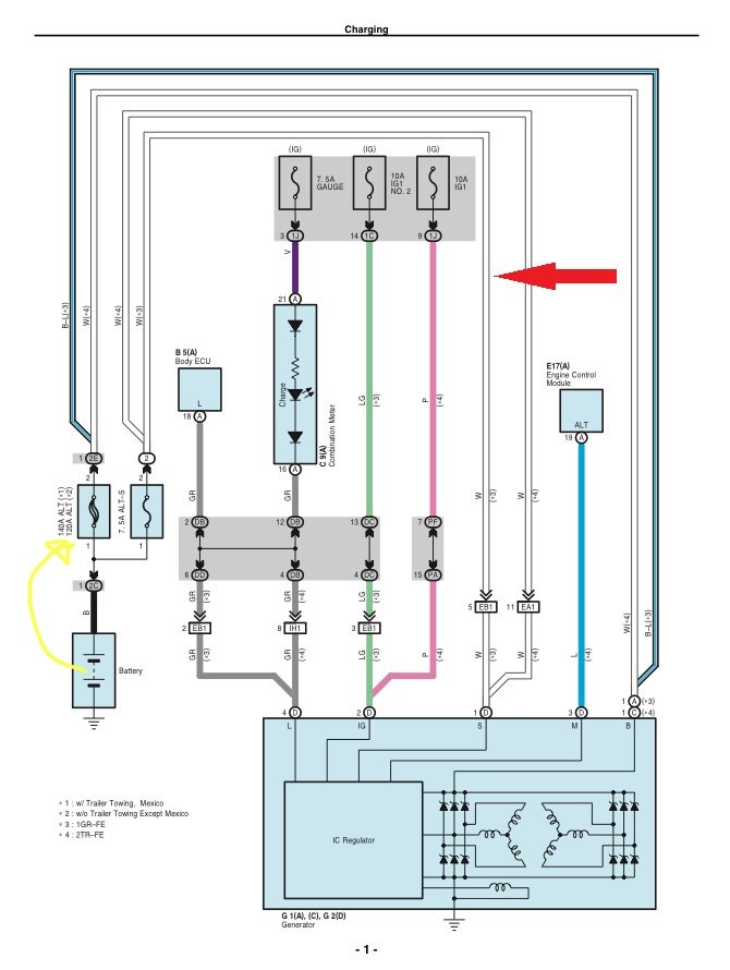

    @tacozord - I wanted to say thank you for thorough posts. I just picked up my engine battery wire harness no. 2 and will be doing the big 3/4 soon after I get all my parts in. I am also using your posts to wire up my switch panel. So, thank you!
    questions:
    What happened with your HO alternator? I planned on upgrading mine so was curious.
    For the alternator - fuse box - battery cable, did you have trouble getting the 2 gauge in there? In other threads I have read they had trouble with 4 gauge or it barely fit.
  13. Oct 10, 2020 at 2:25 PM
    #173
    Subway4X4
    Subway4X4 Shameless Copy Cat
    Nov 10, 2015
    #169260
    11,653
    Lloyd
    NY/NJ
    05 Speedway Blue DCSB OR TRD
    Everything TW members recommend
    Hi from NY!
    I could use some help.

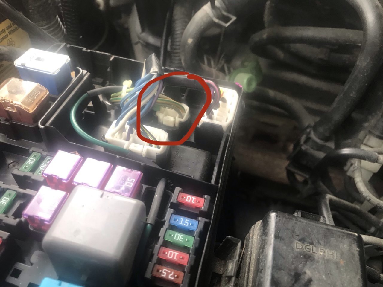

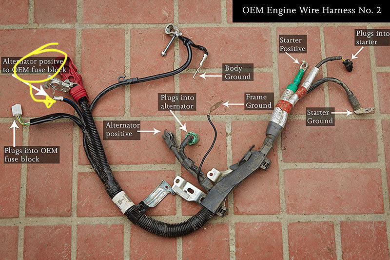

    I’m trying to locate the voltage sensing wire in the engine fuse box. I’m trying to diagnose a low 11.8 v charging rate of my new 250 Amp Alternator.
    Is this the terminal plug that contains the white sensing wire from the alternator? I circled the plug in red. From your nice write up, I’ve determine the location of the green alternator connector (circled in yellow.)
    Is this where that connector is plugged in the engine bay fuse box?
    I’ll need to figure out what voltage the alternator is sensing.
    Thanks so much!

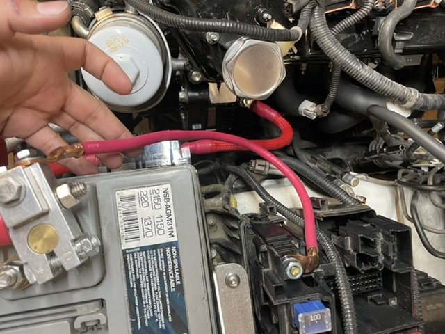

    Whoaa. This is my issue. I installed a 250Amp in February. Last month it started showing 11.8-ish
    The 250 Amp was replaced under warranty. Still the same thing. So I bought a 180 Amp from Advanced Autoparts (Carquest) and same low voltage charge rate. So I’ve eliminated the alternator as the problem.
    Now I’m investigating the voltage sensing wire.

    Sorry for the late response. Yes...you've indicated the correct plug at the fuse box.

    Hi @tacozord
    nice write up on the big 3 upgrade. One thing that I had a difficult time visualizing is how you powered the oem fuse block. I’m referring to when relocating the alternator (+) wire from oem fuse block to the ANL fuse/positive bar.
    did you run a 4ga cable from positive busbar to the fuse oem fuse block? I’ve seen other big 3 take this approach. Or did you keep the stock wire that used to charge the battery from stock alternator positive wire location?
    These guys:

    Hey! Sorry for the late reply. I haven't logged into TW in a while. Anyway, if I recall correctly, I simply left the OEM cable to the OEM fuse block.
