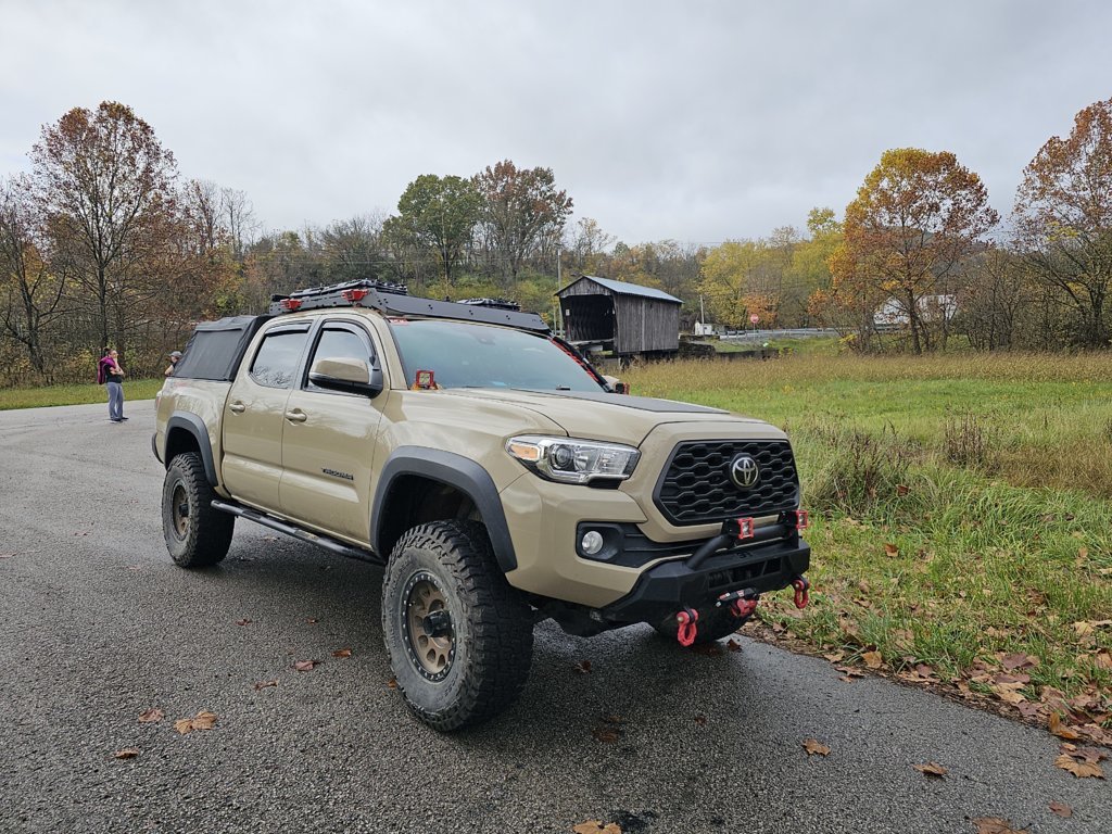

    I had a 12k badlands on the ba hiline (grey tacoma) and now I have a 12k warn on the same bumper (quicksand).

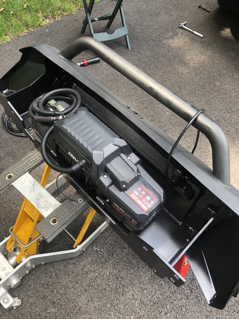

    12K Harbor Freight winch fits in the Hiline bumper. Been there, done that. Search for my posts.

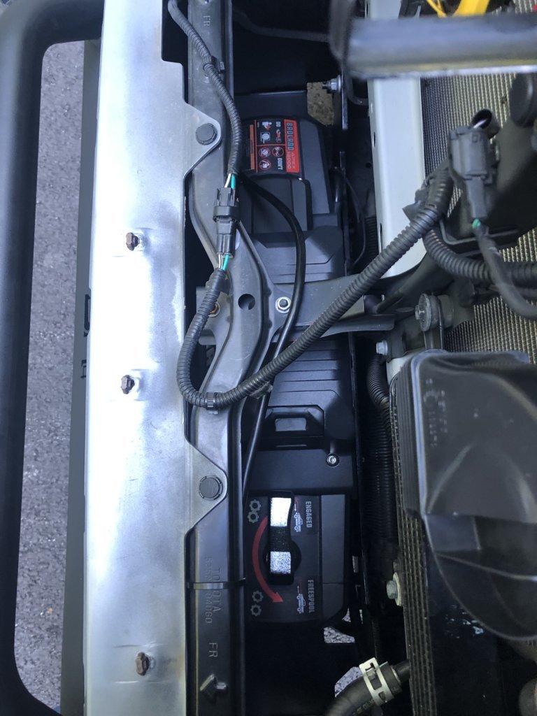

    You just reach down and flip the lever for free spool. Accessing the switch is not hard either. Just reach down, plenty of space for your arm, hand and fingers. See the 2nd pic in post #3 above.
