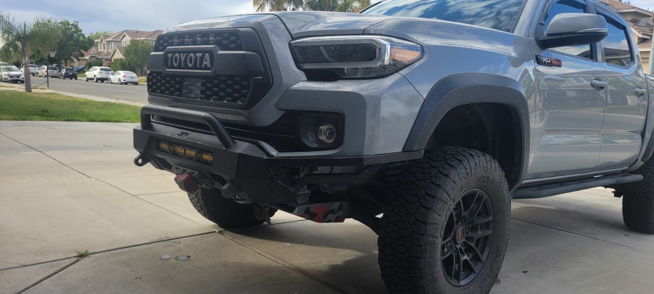

    Wow i never knew these existed, i got my bumper back when is was 400.00 range. I always planned on a lil fab work to add my own side extensions, then i did it.20230502_171034.jpg
