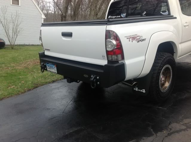

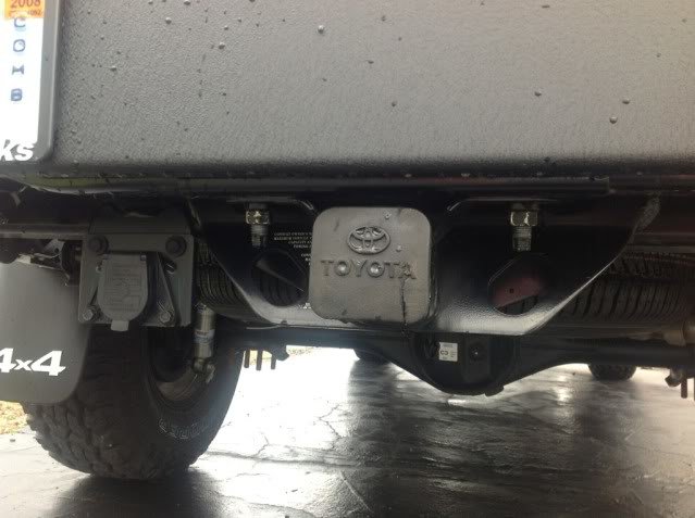

    Jotster. Pay a pro next time.
    First: the two Bolts that were not in the instructions that you removed for no reason at all.
    6415F4C6-91CC-41F8-BCE1-6B849C8520A3-330_5cbddfc5ef953e37bef6cffea945a627c76c4af0.jpg

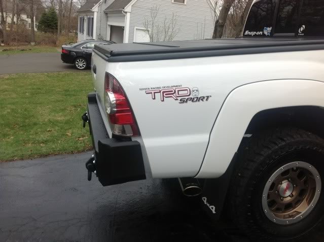

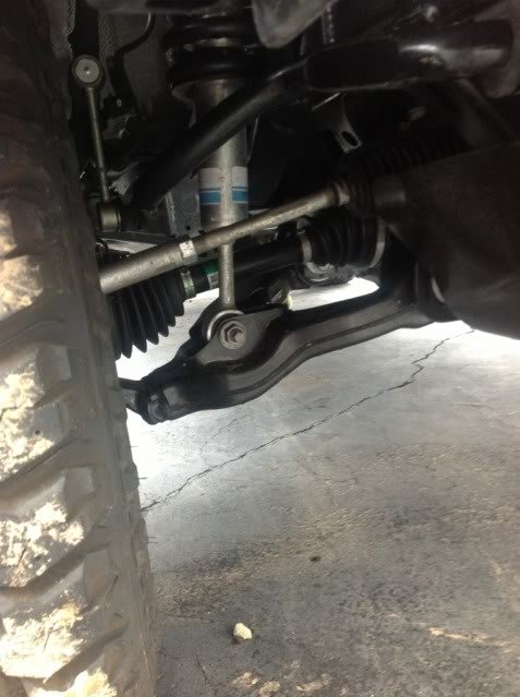

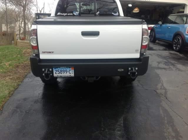

    Other pics:
    4F18FCDA-602A-4A82-A9F7-87DF45123642-330_5273bf2a390e7e17045142a9793188927b076b41.jpg
    334B5244-5DB4-4470-A0B9-EE6358B4B4B8-330_26733dbed88010156dd96187326b8b186fe43251.jpg
    BBC88C1D-5FA6-413C-B6F5-8B78E8A1863F-330_1e923388f905ff23ee4ab1e11bf335b3ba004f9e.jpg

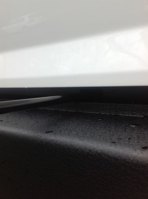

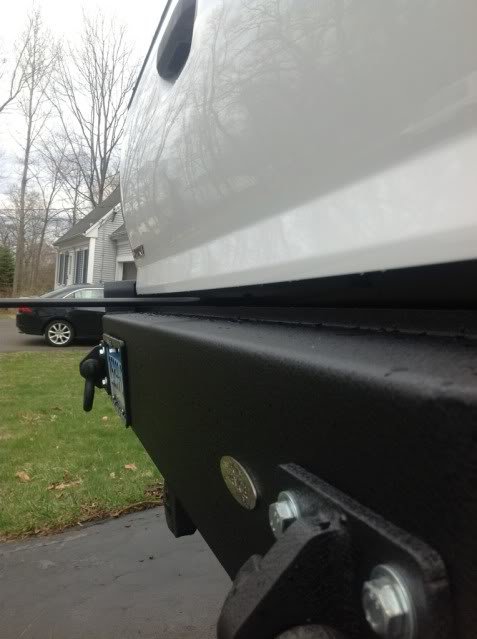

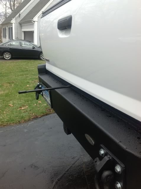

    And so you stop PMing me, here are three pics accessing the spare. Noob.

    I understand that found this to be a hard project but that's a reflection on you. Not the product.
    I read your rant and for a half second I debated not purchasing this bumper. Luckily, my assumption that you are not a DIYer was/is correct.
    Do me a favor. Address my point about the vertical bolts.
    Why did you remove them when the instructions don't mention them?

    Looks like your bumper is on a Pre Runner and a little lower than mine. I dont get the 4x4 mud flaps. I sold mine to a guy on ebay with a prerunner, maybe it was you. Looks like you reinstalled the two hitch nuts and bolts that connected the receiver to the stock bumper that are now no longer connected to anything. I see to that you were unable to find a solution to lighting your tail light. All States require that all vehicles have a lighted rear taillight.
    It also looks like the rod is resting on the top of the bumper and that you have to align the hook just right to slide it through to the square hole in the bed sheet metal that allows access to the tire lowering crank. Thus the rod rides on top of the bumper.
    My half round circle cut out makes it so that Im not scratching the bumper or tailgate and I dont have to "fish" the rod through to reach the spare tire crank. With the spare tire installed you can not see the crank and the only way that you can is between the bumper and the tailgate. My extra room lets you see the crank clearly in day light and shine a flashlight through it with the rod installed to see the what your doing.

    I may be a tool but the truck is 4x4. Wanna see my front diff?
    If your bumper sits higher that's your poor adjustment.
    Yes, the rod is touching the bumper. I have two hands and both were taking the pictures that your dumb ass requested. No hands touched the rod and as such something called gravity had its way with the rod. I see your fab skills are too notch. I know there's no evolution in Texas but you do have gravity, right?
    Those two bolts attach to the stock bumper tongue. That tongue is still connected with 4 bolts and acts as as a truss on the stock hitch. If by connected to nothing you mean connected by 4 bolts as shown in the instructions then ok. You win.
    If by tail light you mean license plate lights ill address: With regard to my license plate lights I have ordered a kit, it hasn't shipped yet, so if by "not found a solution" you mean "placed an order for the appropriate solution" then again you win.
