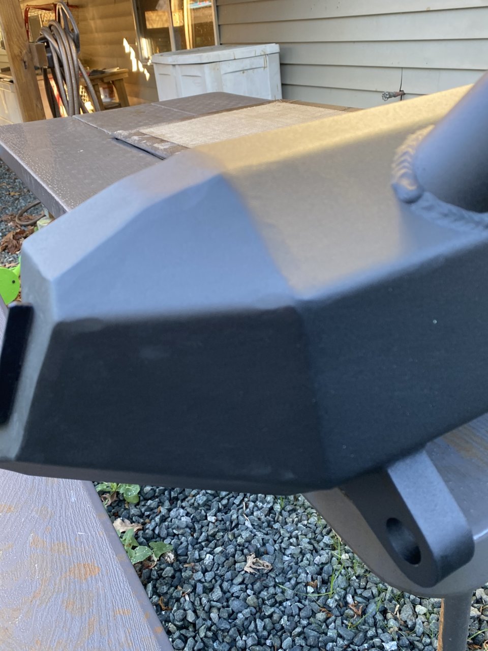

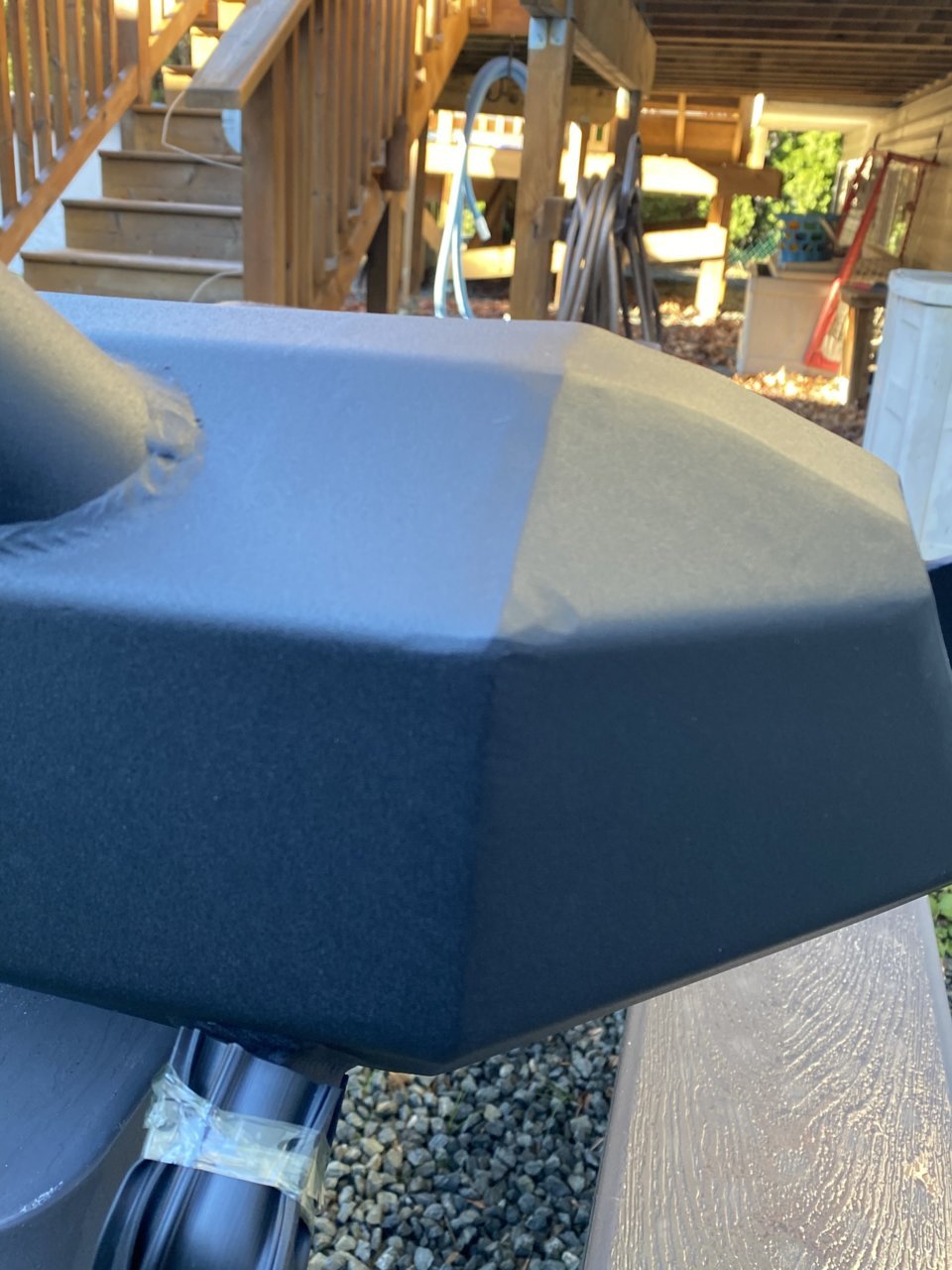

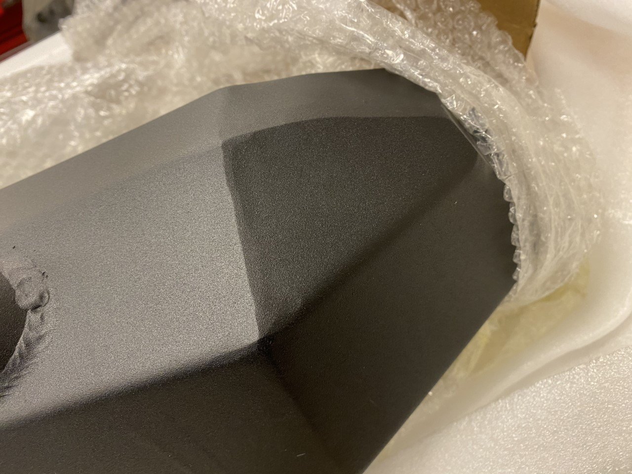

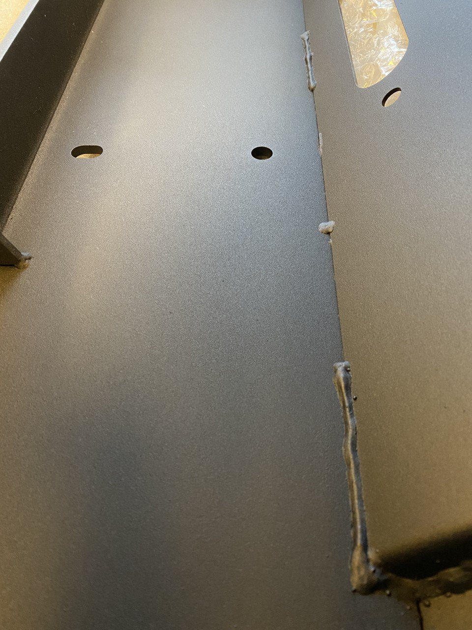

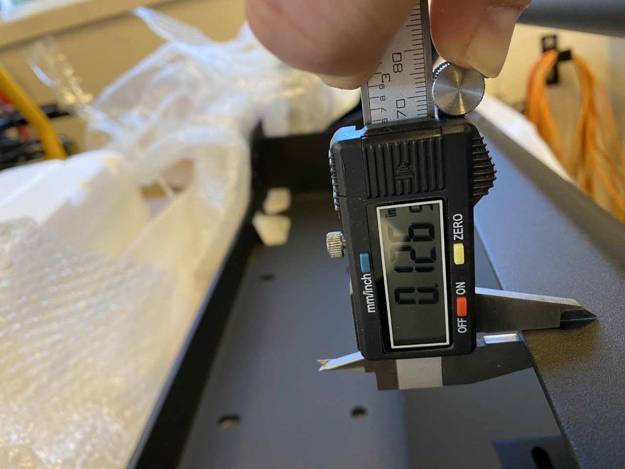

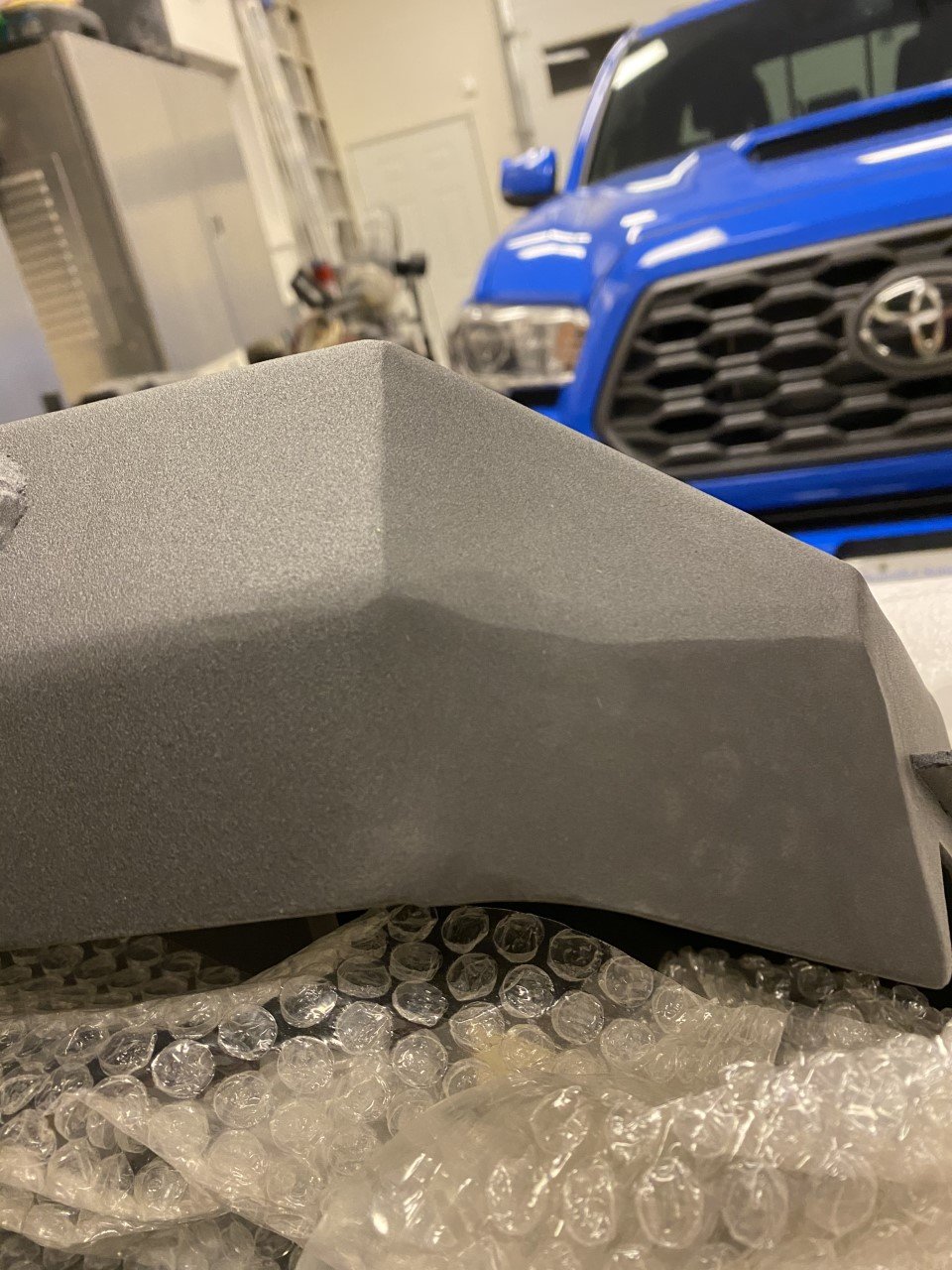

    2021 Tacoma Sport, 2020 Honda Pilot Black Edition
    Be cautious of this bumper quality.
    While I love the geometry of this bumper the one I received must have been made at the end of the day on a Friday. Grinding work is so bad I have contacted BA for action replacing it however I am skeptical as I am in Vancouver, Canada area this unit shipped from Cali.
    I did not see any advertised TC 19339 that stated it was made of 1/8" but mine is. All adds upload_2020-12-12_9-44-5.jpg
    I found said 1/4" winch base plates and 3/16" elsewhere however mine is 1/4" thick winch base plates and frame mounts BUT 1/8" everywhere else. Yes the whole facia is 1/8" not 3/16. There is no 3/16" thick steel anywhere on my bumper. Also the post-weld cleanup is so bad they have remove much of the straight forming lines. Its really quite embarrassing. Pretty frustrated with this finishing quality.

    Looks like a cheap Chinese knockoff of a SSO bumper.

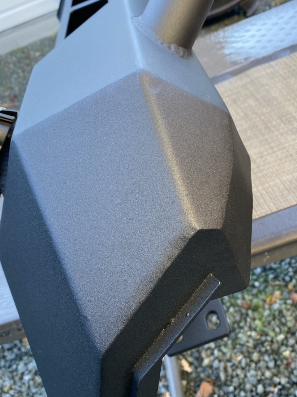

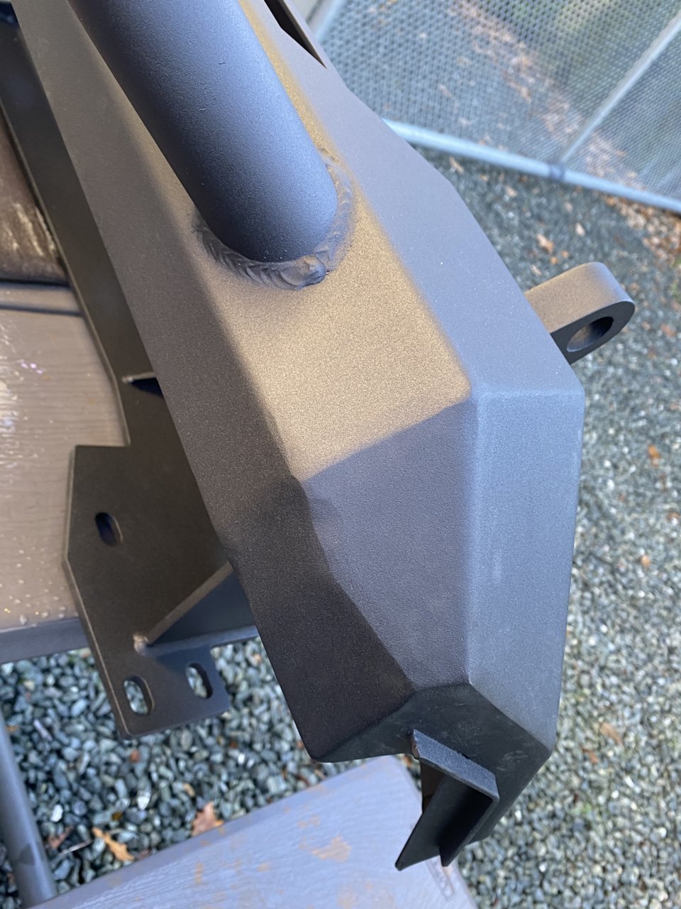

    Ya I have been a Journeyman Metal Fabricator and Pressure Welder for +20 years and I would agree this looks like it was made offshore

    73E4564C-A32E-47C2-A369-2BECEC72BE6B.jpg 80B71241-2FE7-425D-86B0-013A761E0BA8.jpg Couple updated pics. Thought maybe outside in daylight it’d look better but unfortunately this is not the case.4A6FCD0B-16DA-41C5-A934-6AA38AF829B5.jpgC1AE06D5-AF2C-43F4-A9E9-EF9162EA814F.jpg
