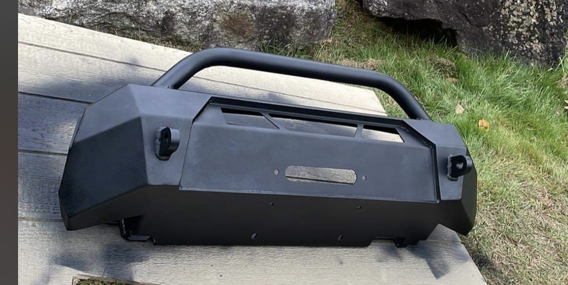

    Fortunately the mounting points for this particular bumper are studs that are attached to the frame (Toyota built). But I see your point. Will measure and thoroughly inspect welds and steel thickness, the best I can, when it arrives. Thanks for the video share!

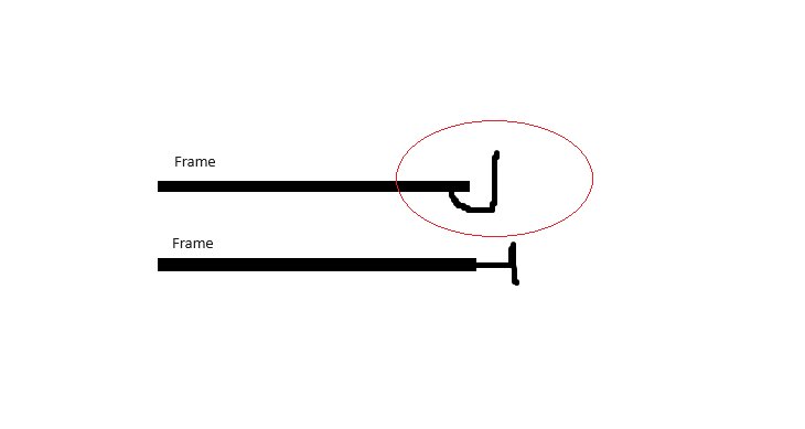

    I was thinking to put this on mine too. But I dont like how it mounts on frame, like L shape, it can bent the frame during impact

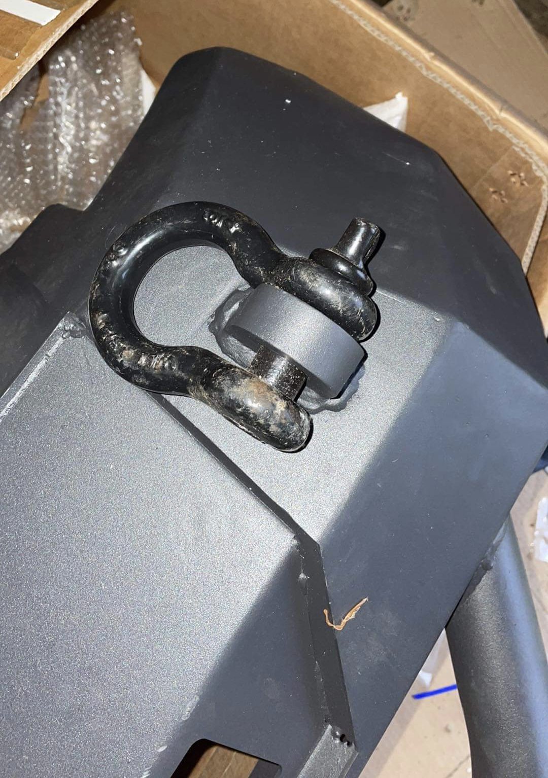

    it's hard to tell in their pictures, but it almost looks like it's just a solid plate that bolts to the truck, and then a single vertical piece of plate steel that then transfers all forces to that mounting plate.
    i'm not worried about the oem studs, or mounting configuration, i'm most concerned about their use of vertical plate steel as a structural component.
    my sdhq hidden winch mount is all 1/4" steel plate, but then there's a large gusset across the vehicle mounting stud locations, as well as 2 underside crossmembers that are added on to further tie in the winch plate to the vehicle.

    I had read about some complaints about the weak points on the DV8 version, which is similar to these, but haven't heard any negative feedback on the BA version. When it arrives I'll try and compare the load points on the mounting plates to the winch plate. Thanks for pointing that out.

    Shitty welds in general? Not sure the BAMF bumper reinforcement plates are gonna help with that unless they bolt from the winch plate to the frame. Let us know what you end up doing.

    I am talking about L shaped mounts. Someone here used paint tool to draw it, i can't find it .
    This is how he drew it, mine looks worse but you get the idea. The first one is bad because it can bent the frame upwards. While second one mounts on frame straight on.

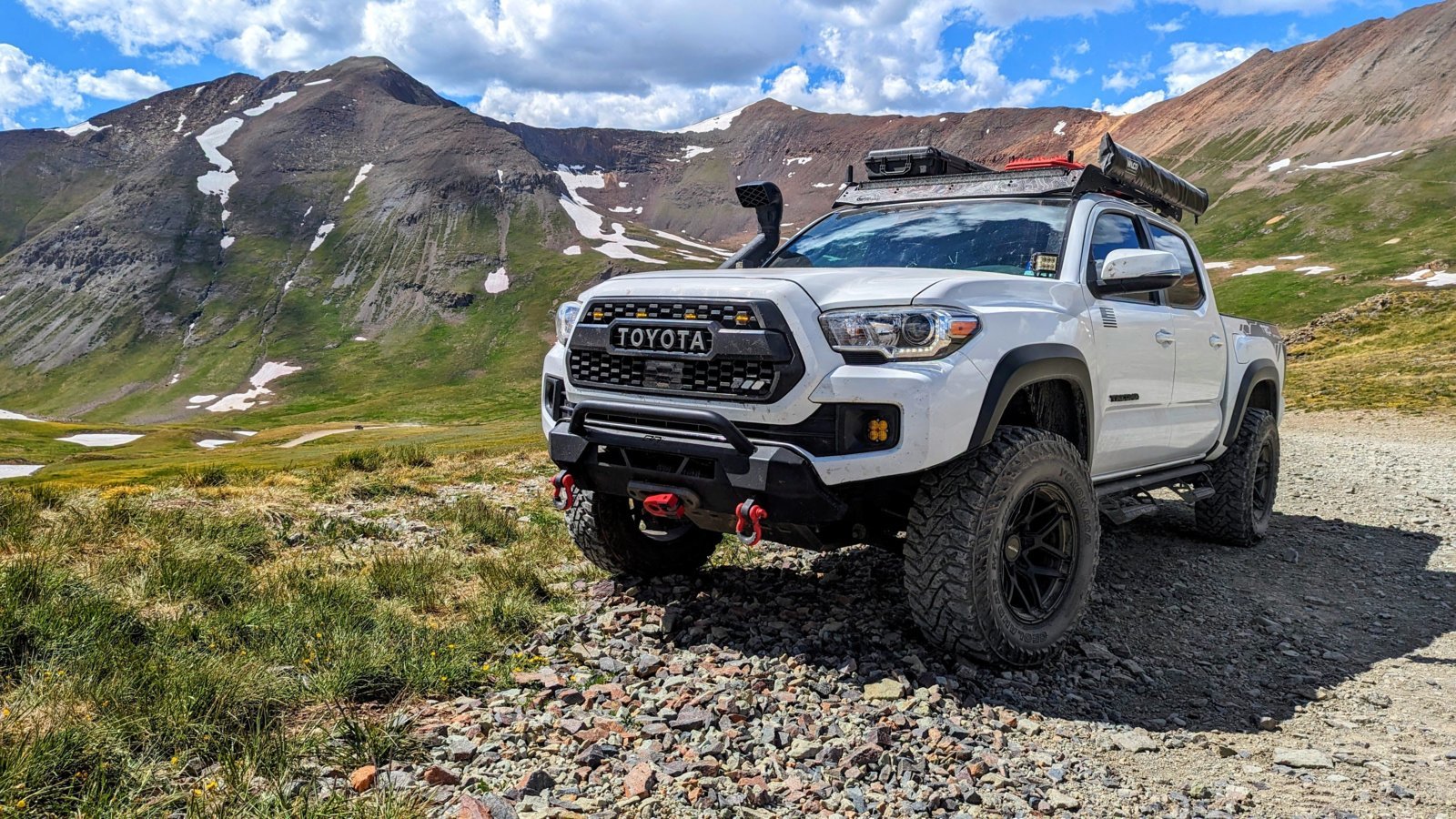

    Love mine. Paired with Warn 10S Winch. Used it a few times.

    Thank you, how shitty are the welds? I don’t think I’m going to plan on using a winch if I get one, but I’m sure that could change down the road.

    That does look really nice

    Theyre ok.. just not the best looking. Who knows if the body armor version is any better. The pictures in the Amazon listing are pulled right from Body Armor lol, they just blurred the BA stamp a little but you can still see it. I am excited about my budget winch ... ;)

    ugly welds can hold structurally. BUT you do like to see stacking dimes because it shows a complete and consistent burn around a joint. Im interested in how you like it. Some guy on youtube bought one installed it and then pulled the truck in park on in dirt/mud condition and the bumper held.
