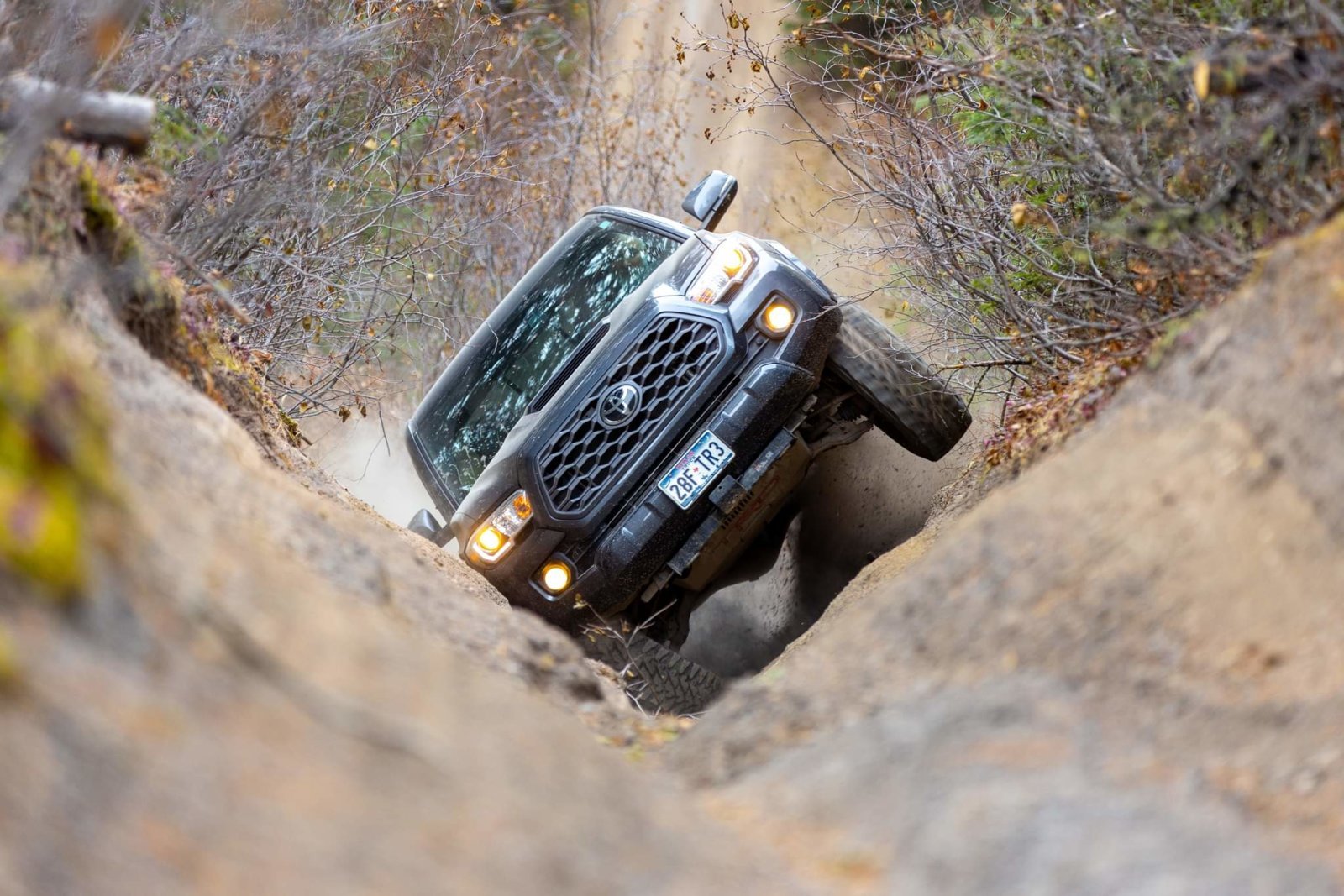

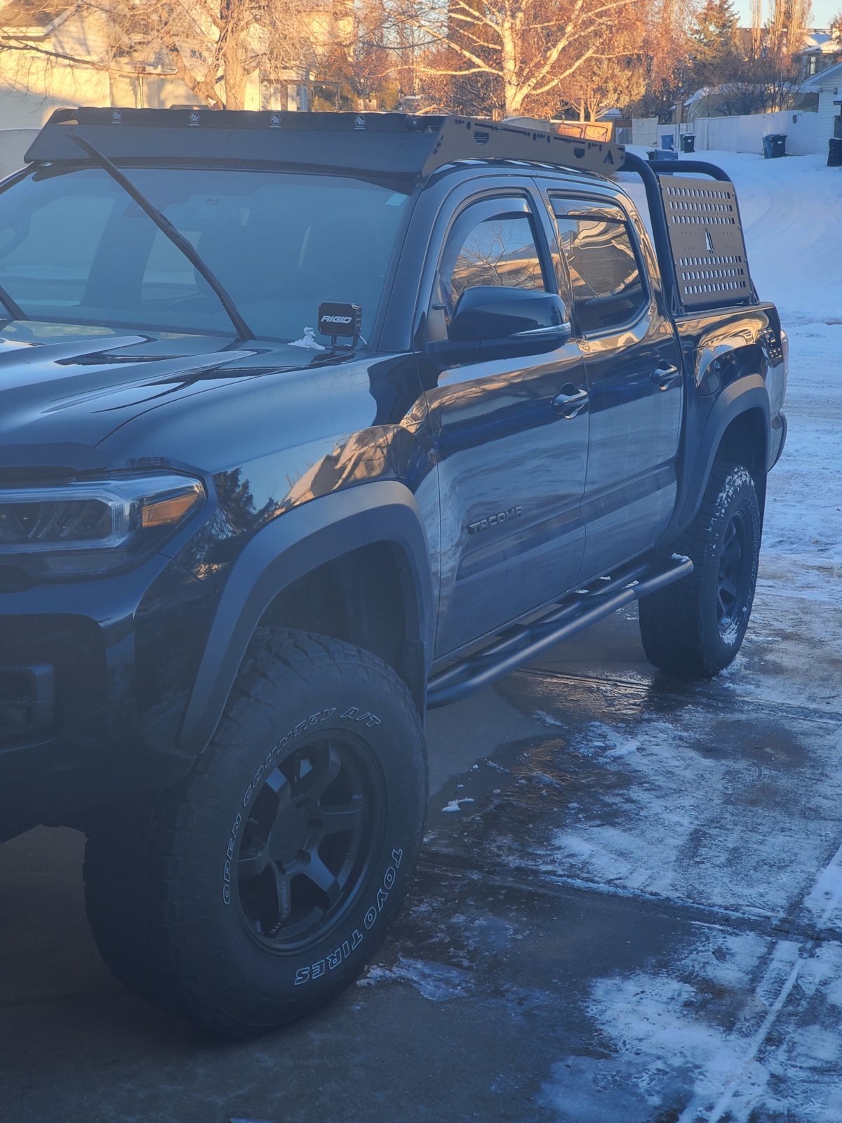

    I've had them on my 2023 Tacoma for a few months. Didn't liked them as much as the CBI I had on my previous Tacoma, so I took them off and got a set of CBI DOM120 steel.
    When I took them off they were filled with rusty water, and, being winter, it took me forever to get them flushed. Had I decided to keep them, I'd definitely run some diesel/used oil thru them before spraying every hole with CRC or another lanolin based fluid.
    By comparison, the CBI DOM120 steel cost more than double what I paid for the BA4X4 but I'm too poor to afford cheap.
    Also, CBI are wider and get closer to the front mudflaps offering better protection. The set if CBI's I had on my previous Tacoma saved my doors/rocker panel when I flopped a V once and I only had minor damage to the front right fender (see the pic), I highly doubt the BA4X4 would've helped as much.
    Sorry, BA doesn't get my vote unless you wanna buy them for looks and to avoid door dings in the parking lot.
