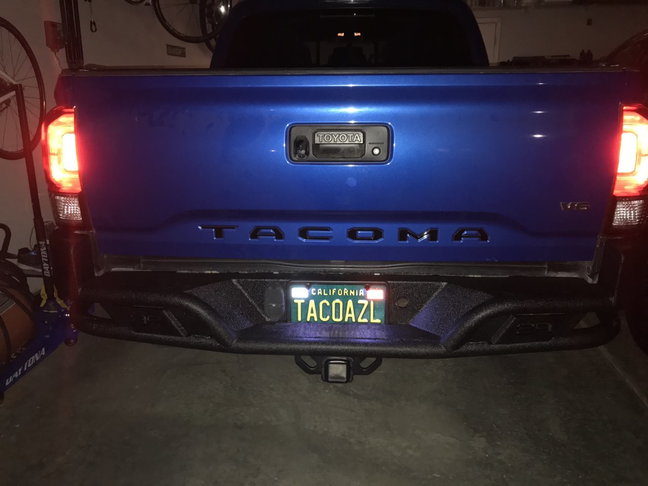

    I have had this bumper since like 2018. no problems with it besides the plate lights falling out, so i got bolt lights for the plate.150573199_10219302494453264_451733197360_705a4ed0928da44e2d86ac944fab6e35fe32e2fe.jpg

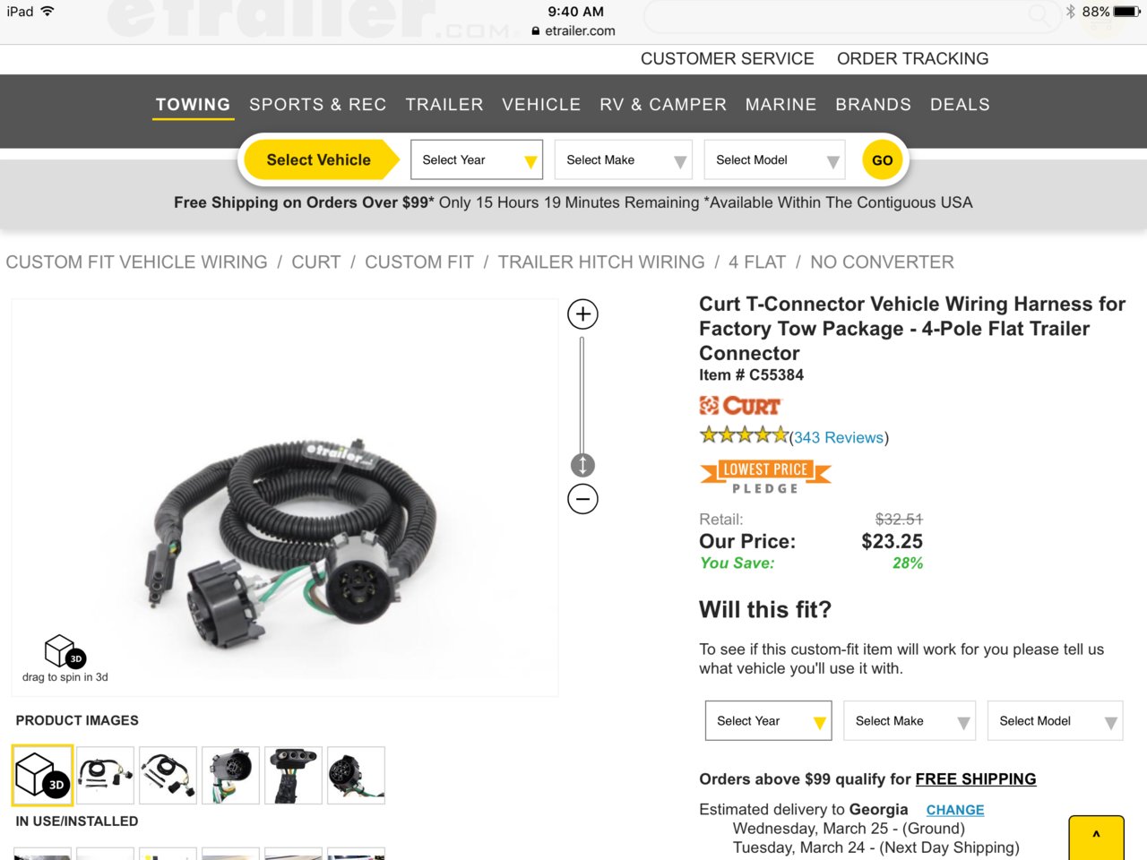

    What I found was that the wiring harness was too intricately bound and secured to stretch it. Unless you are fortunate, you’ll see what I mean. So I bought this:
    Curt T-Connector Vehicle Wiring Harness for Factory Tow Package - 4-Pole Flat Trailer Connector
    It basically acted as an extension cord.
    Regarding the bumper lights, I remember the harness was short, but very easy to extend.
    Good luck!
    Karenlloyd57[QUOTED] likes this.

    It won’t stretch. If you loosen some of the connections holding the original harness and try to route it another way it will still be tight and you will see that it will just rub and cause problems. Get the curt and just plug and play
