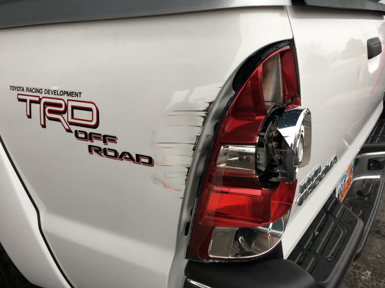

    upload_2017-12-26_9-52-53.jpgHere's one pic.

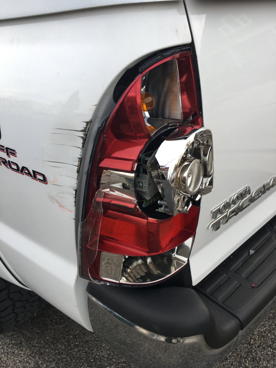

    upload_2017-12-26_9-53-56.jpgAnd another.

    The good news is that can be worked from the inside once the taillight fixture is removed. Quite easily actually. It should be so close that any filler is minimal as final prep before paint work. See @Muddinfun's post above re use of filler for perfection.
    The better news is your white is the easiest color to blend match. I would ask them to remove the rear flare and the bed rail so that area 'ends' under those bits, as opposed to being a line around them. The probably would anyway, but never hurts to ask.
    And it's a great opportunity to lose the TRD decals if you've ever considered doing so. The one on the damaged side has to come off anyway. You might like it.
    It's all in the hands of the tech doing the work. The folks I use for occasional flub ups would have that done in 3-4 days, and it would be undetectable. The filler would be so thin that a kitchen magnet would still attach to the truck. And they'd mask the wire harness inside the fender so when the taillight was removed for future service there was no hint of the repair due to overspray.
    Best wishes for a successful repair!
