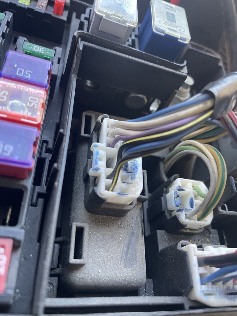

    As long as you get the same year there is no programming required. Plug and play.
    This is the backside of the fuse interior panel with the BCU Cover removed.[​IMG]
