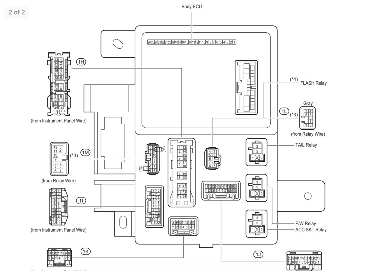

    Can someone provide me a picture of a Body ECU module for a 2012-2014 Tacoma. Is this integrated into the cabin fuse panel or is this a separate module? I think I fried parts of mine during a remote starter install when I tapped into the wrong wire. My symptoms are, the key-less entry receiver doesn't respond to the factory fob and won't acknowledge the fob to be reprogrammed, the head lights (when in the on position) don't turn off when the engine is killed and then the door is opened, and the AC compressor won't turn on. All part of the ECU B module.

    FYI, the body ECU is in fact integrated into the cabin fuse panel. Replaced the panel with a salvaged part and my systems are back to normal.

    Back side of fuse panel.
