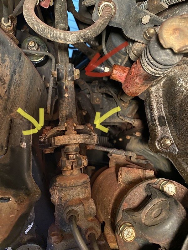

    Old thread kicked up again so pardon. Have done a fair amount of research and would like to see if anyone has done this recently, any concerns beyond what is described already. Intend to loosen all 6 mounts before jacking one side at a time. Saw where OP mentioned two bolts at bumper, fender well skirts etc. Also saw mention of steering column slip joint, post 10? Anyone familiar with that and is that a legit concern when jacking the body up off the frame? Not sure I understand what I am looking for to loosen there. Thanks for any advice.

    Thanks for the reply. Would you mind pointing to me where in the photo below that I need to loosen things? Is it the top bolt left of and alongside the slave cylinder?

    #403855
    106
    Xenia Ohio
    2000 Tacoma PreRunner V6 extended cab
    I always undo the 2 with the yellow arrows. You can do the Red sometimes it doesn’t want to move on the splines although it’s supposed to.

    I did the red bolt only in mine according to the picture above. It just slipped out. Those bolts in the pic look crusty. Douse it all in ATF

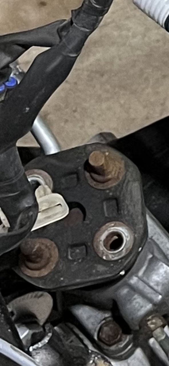

    I later replaced that steering column u-joint on mine. It all comes as one piece. I don't think there's any reason to undo the bolts on the rubber part (marked in yellow).

    Sure there is. As stated before if you undo the bolt with the red arrow and it’s stuck on the splines undoing the 2 bolts in yellow allows the intermediate shaft, to separate into 2 halves.
    There is a nut and bolt on each side with the yellow arrow.
    Here is one separated.
    Also, if you replace the intermediate shaft disassembling, it can help with removal by giving you extra room to free up, which ever side may be stuck.
