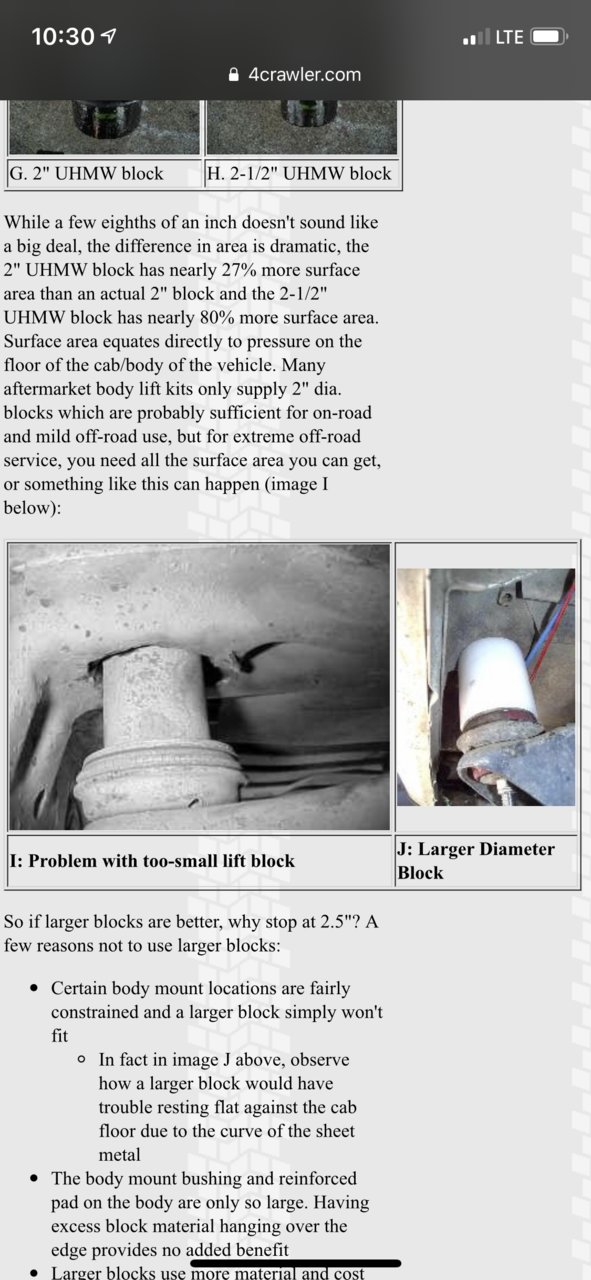

    Wow. It looks like the body has shifted on that body lift. It also looks like the spacer is gonna go through the body mount surface as well.

    Do ya have a pic of any of that to kinda represent what you’re saying?
