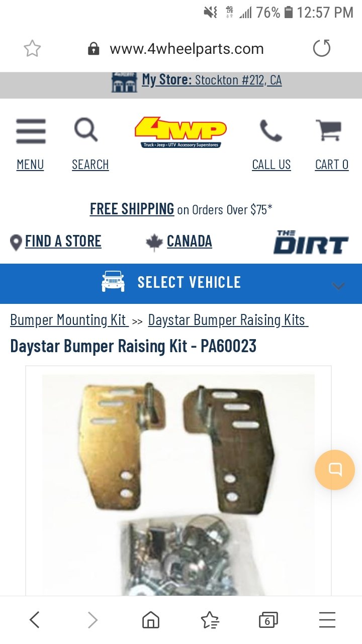

    Look up "Tacoma body lift bumper"Screenshot_20190508-125746_Samsung Internet.jpg

    That would be perfect, but too expensive right now! :)

    Let me check this right away!

    I just contacted them and they don't offer any kit for a 1" BL only for 3". :(

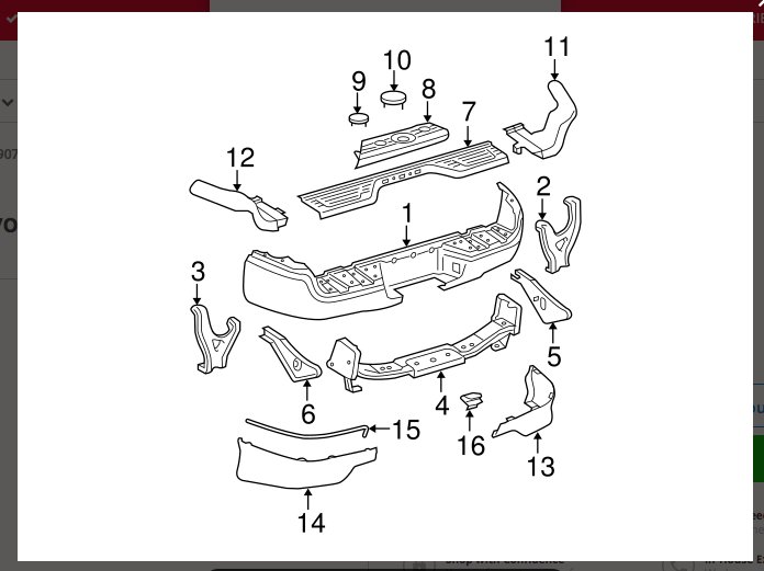

    Thanks, man! That's very nice of you! Maybe I can buy some extra brackets and modified them as you subjected. Can you show me in this photo which brackets? By the way I have the factory hitch.

    I believe its number 5 and 6, as soon as I get off work I'll let u know for sure

    I believe you'll need 5, 6. This does not include the work to the hitch, all holes in hitch will have to be drilled 1 inch lower than the original to raise it up one inch. It can be done easily with the proper tools. Also, 5, 6 will have to be cut vertically and skewed the 1 inch, weld and gusset. Any questions feel free to PM me.

    When it gets dark I'll try and take some with the flash, otherwise you can't see squat.
    The diagram u supplied shows the bumper set up without the hitch, if u have the hitch, its alittle different, I'll have to climb under mine and see, I'll let u know
