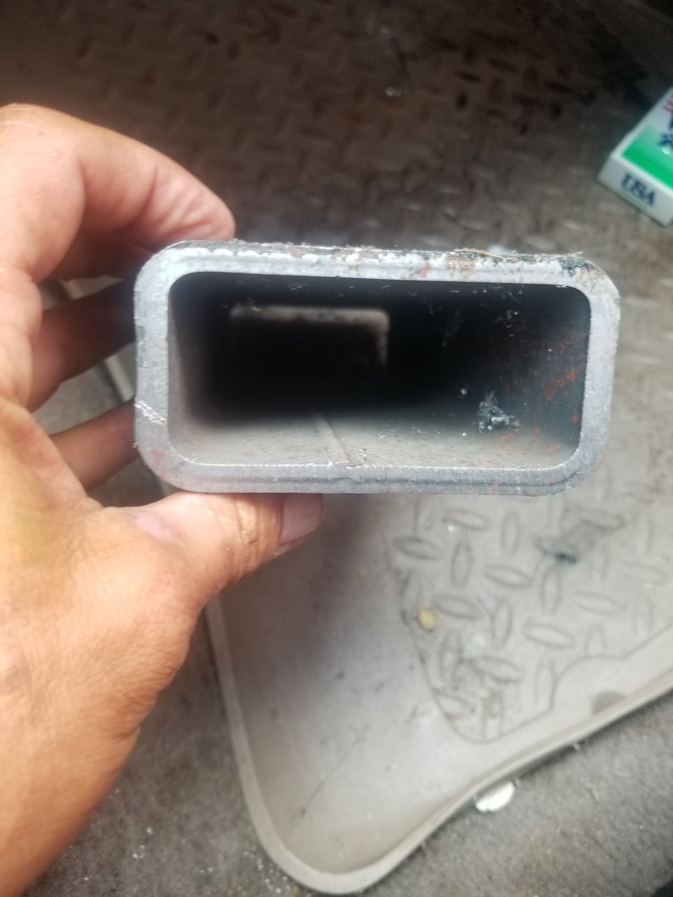

    I was thinking of using this to raise the body 2in. Thoughts?20190608_094843.jpg

    If you're looking for a lift simply for aesthetics, keep it simple and put a 1/2" spacer up front and an AAL in the rear.

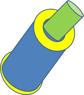

    I have a brother-in-law who loves to put them on his trucks. He has a pretty good system. He uses round pipe and welds a washer to each end. He matches the outer diameter to the pipe size plus maybe an 1/8", and the inner diameter to a snug fit to the bolt size. That way, the weight is evenly distributed and the bolt doesn't shift around.
