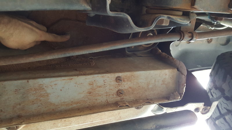

    Well shit... Might be stuck here..
    Not enough room to get the wood block on the pinch weld well enough. Sliders are in the way. Tried it, but the block kicked out (safely believe it or not)..

    Going to have to find another method to pry and hold them up.
    Unless someone with sliders has done these with a proven method already?

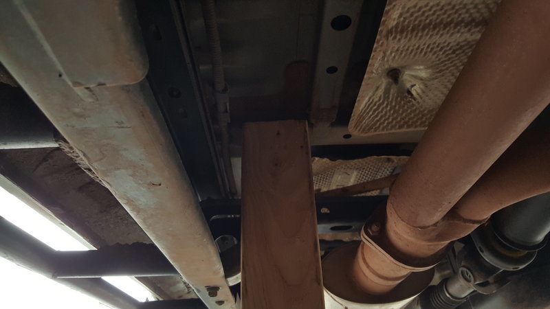

    I know the pinch weld is the best place, but what about up behind it?
  5. Jan 1, 2017 at 12:22 PM
    #225
    Ted Yoder
    Ted Yoder Well that didn't work
    Jul 29, 2016
    #193220
    459
    06 DCLB
    In Progress
    Idea time.
    Cut your block of wood at a slant in order to angle it so it touches the pinch weld on the back of the cab. I used a piece of firewood cut the same way. I can't see what you're working with but I was seated evenly across the back and side pinch welds

    Now seeing this pic my idea might work. Or take a short cut of 2x4 and make a "T" so you slide in beyond the sliders and contact both pinch welds

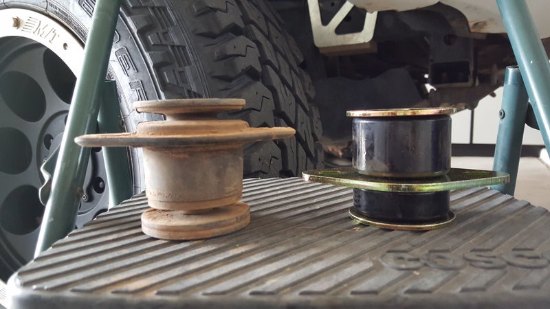

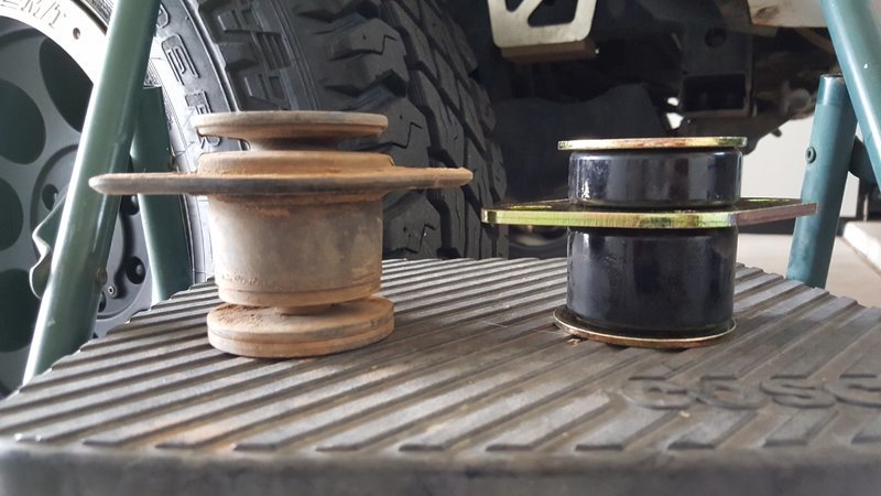

    Got the rear out.
    Just to clarify.. The left is how it came out.. The right is how the new ones go in?
  9. Jan 1, 2017 at 12:49 PM
    #229
    XPOTRPR
    XPOTRPR CNC Programmer/Machinist
    May 29, 2011
    #57449
    30,602
    Chandler, AZ
    [2009 Supercharged Adventuretruck] & [1986 22r Minitruck]
    > BUILD LINKS >
    Or, if I understand correctly, flip the new ones to yield a little more height?

    Jul 29, 2016
    #193220
    459
    06 DCLB
    In Progress
    Thats how I installed them. Body lines wont line up the other way
