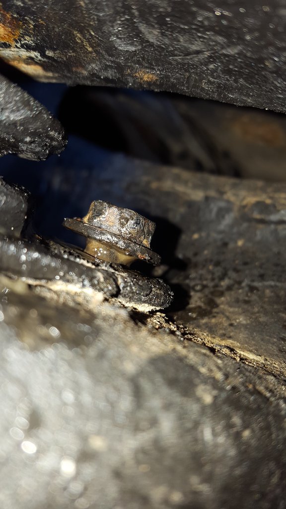

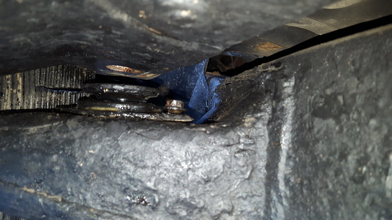

    I seam to have run into a shitty situation while attempting to swap out my body mount bushings.
    - I removed everything for the Rear-Driver side bushing no problem. (Cab mount/bushing, Cab mounting bolt, Frame bracket bolts)
    - Little resistance, but to be expected for the undercoating/rust build-up.
    - I was in the process of removing the Front-Driver side, when I stripped one of the Frame Bracket Bolts (See picture below for which one I am mentioning)
    It is the one located closest to the frame:
    I am curious what my options are to get this out. Will i need to try and cut it off? Will I have to remove all mounts and lift the cab (which will be almost impossible for me to do at the moment)
    Has anyone been stuck in this situation before and had a trick to remove this bolt? Any and all help would be appreciated as I am baffled at how I will remove this.

    Did you get it to break loose before it got stripped?
    I would be spraying penetrant in there (pb blaster) often to keep it soaking while trying to cone up with a plan
