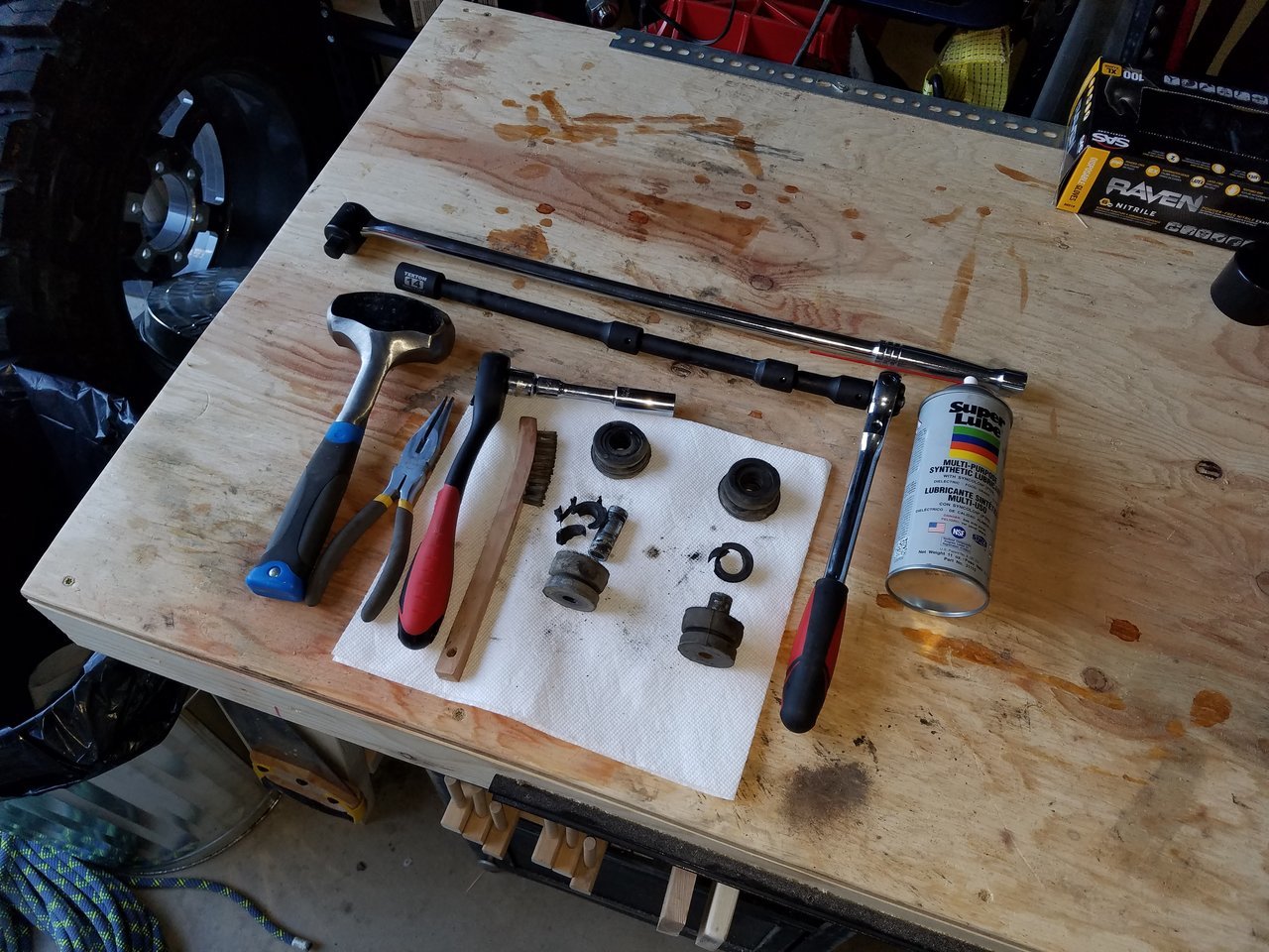

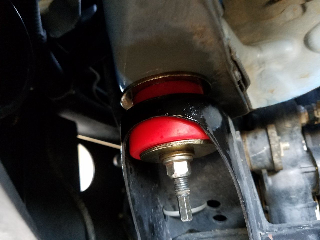

    I got the universal radiator bushings. Energy part number 9.4101R
    I put the big washer & small bushing on top, little washer & big bushing on bottom. I run an aluminum InsainFab bumper and the fit seems perfect.
    Old ones and tools...
    New ones...
