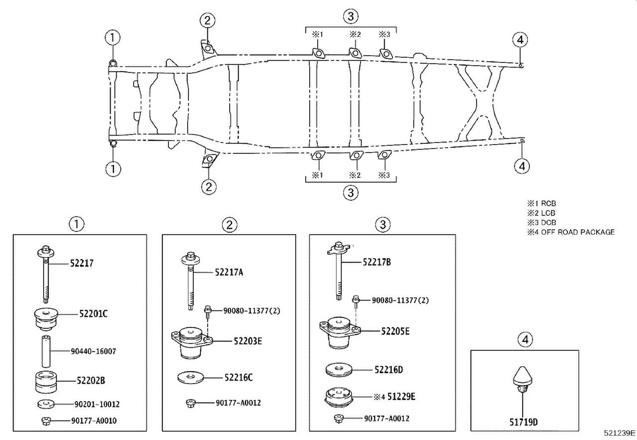

    I was looking into replacing my radiator bushings after hood alignment problems with the energy suspension replacements. My hood is sitting higher than the grille causing a gap. It's not bad, but I see the hood moving up and down when cruising on the highway.
    OEM Part #s for radiator support bushing replacement:
    52201-04040 (52201C)
    https://parts.toyota.com/p/63154062/52201-04040.html
    52202-04030 (52202B)
    https://parts.toyota.com/p/63166507/52202-04030.html
    90440-16007 (if you want to replace the sleeve)
    https://parts.toyota.com/p/63401536/90440-16007.html

    For the radiator bushings do you have pictures? Also did you put the big puck on top?

    Did you consider trying to adjust the hood latch to pull the hood into firmer contact with the 'bumpers' that it fits against?
