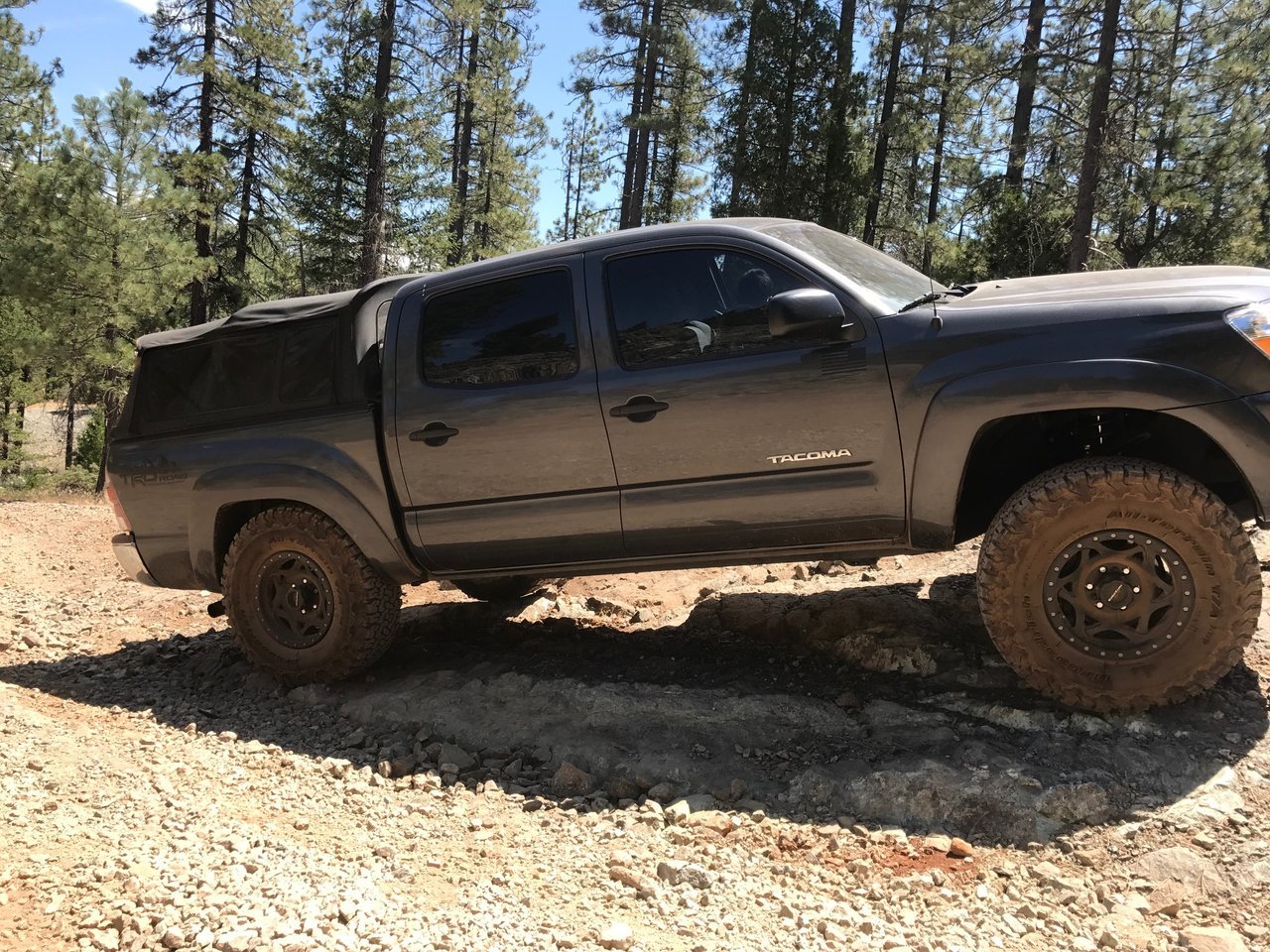

    I spent the 4 hours cutting and capping my body mounts for 285's. Then i got the tires on and realized how much time i wasted sweating in 105 degree heat lol.
    I'm on 285/75-16's tires, rims have 4.5" backspacing, with 5100s and 885 springs. clears just fine

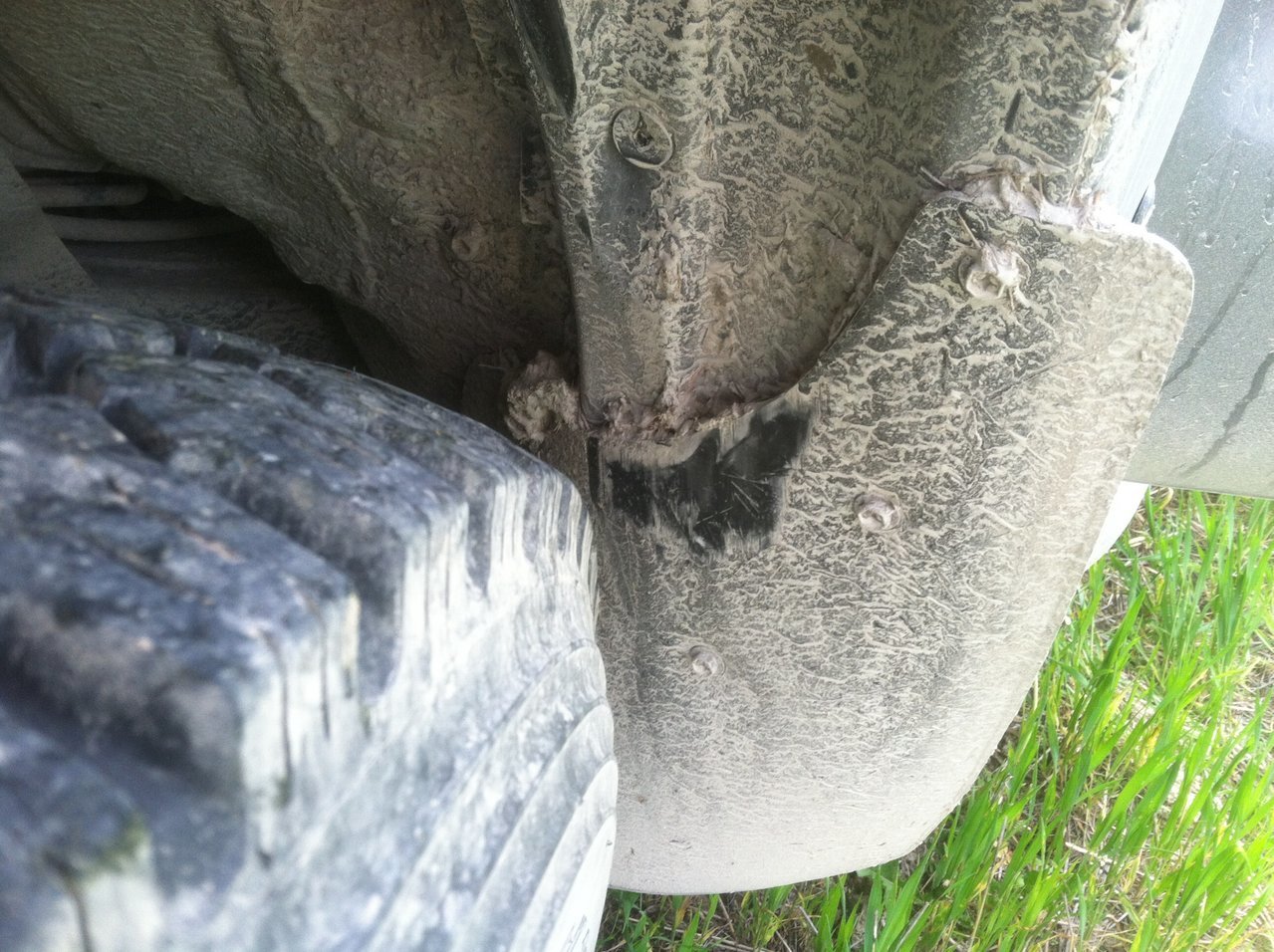

    I have LR UCAs with caster at 2.8 and low profile aftermarket mudflaps. A little rub doesn't bother me at the extremities of flex and turn combined. I did rub the flap a tiny bit when I jumped the truck a couple months ago. Meh.
