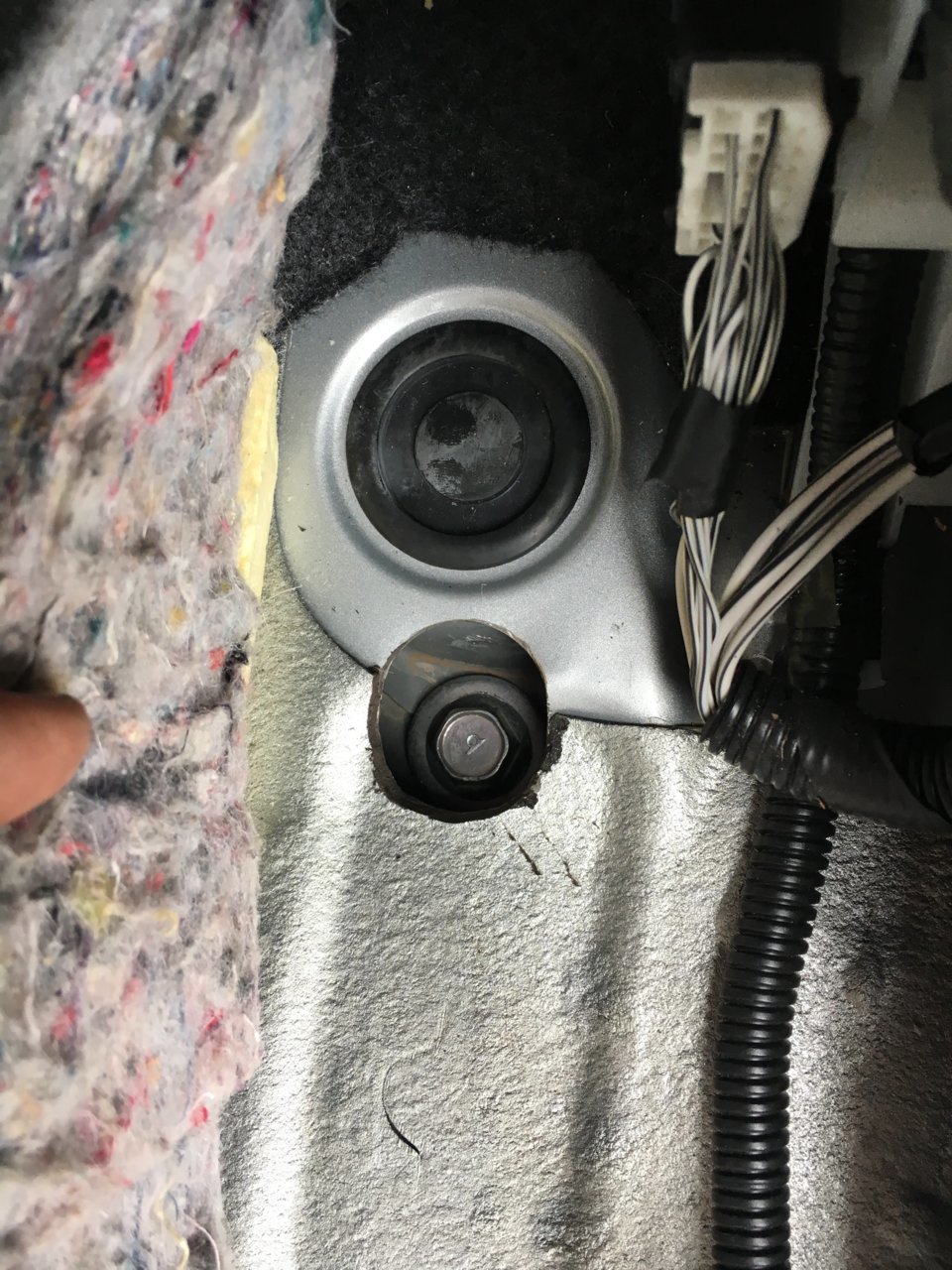

    It has begun. Will take a while though, as I’m bouncing around between this and coil bucket gussets.

    If a chop worked for you then you should have done that from the get-go. This is for when you can't safely chop enough.
    A chop wasn't enough for me. I called him and had no issues (Summer '17). This is not his main business and I doubt the influx of inquiries has been easy to handle or welcomed especially when he gets 20 questions. This is tailored to those that know they need it and know how to do it.
    I did a search for RedGoatFab and it looks like he doesn't even have an active account here anymore.

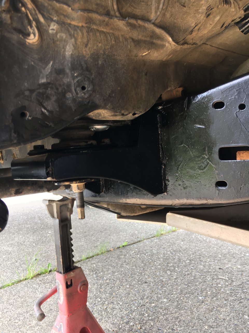

    All done with the passenger side.
    Slathered it heavy in POR-15, then primer and bedliner.
