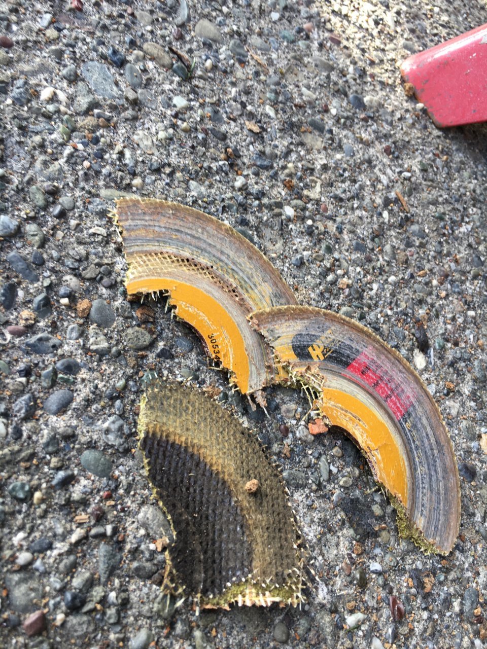

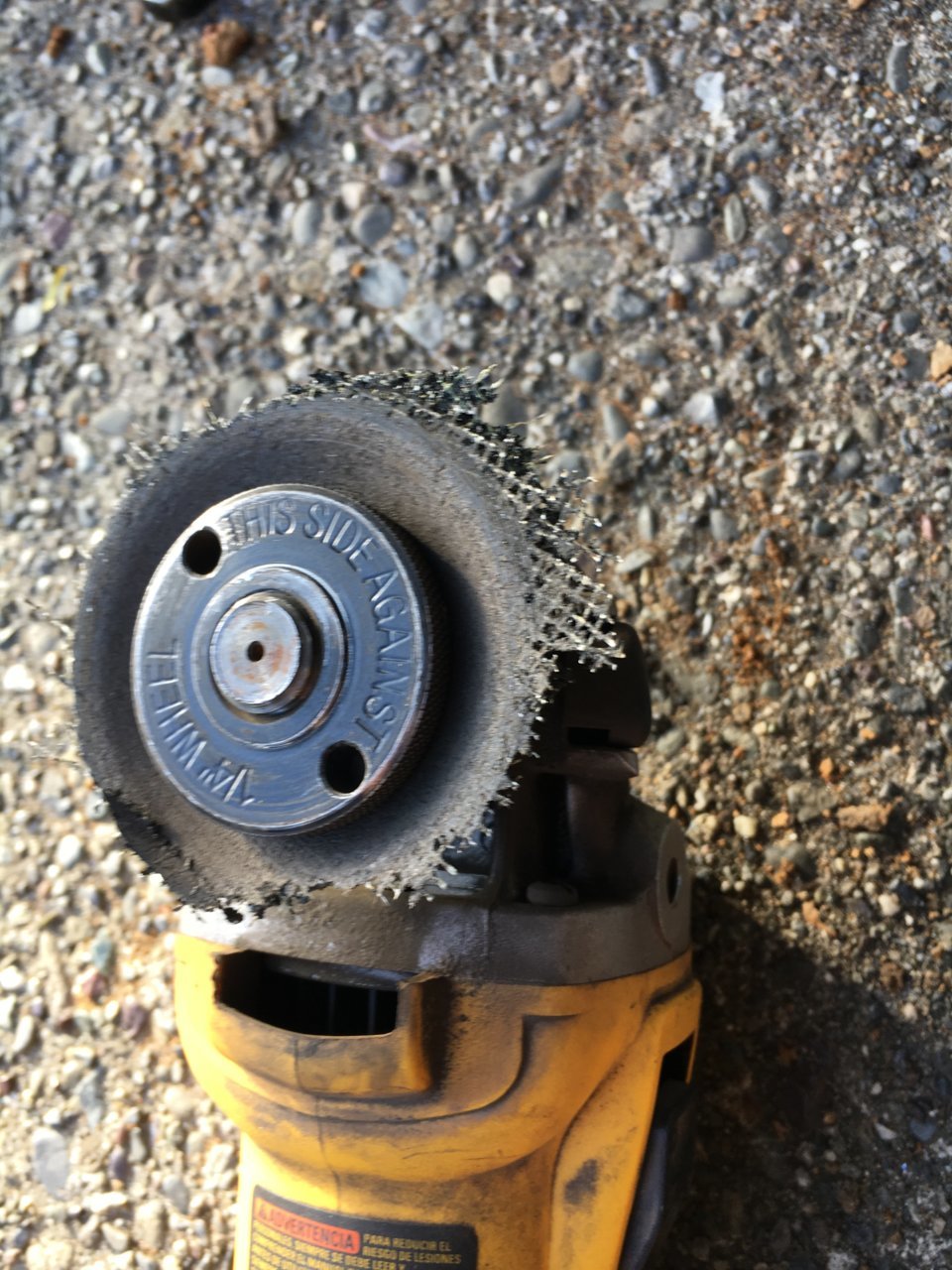

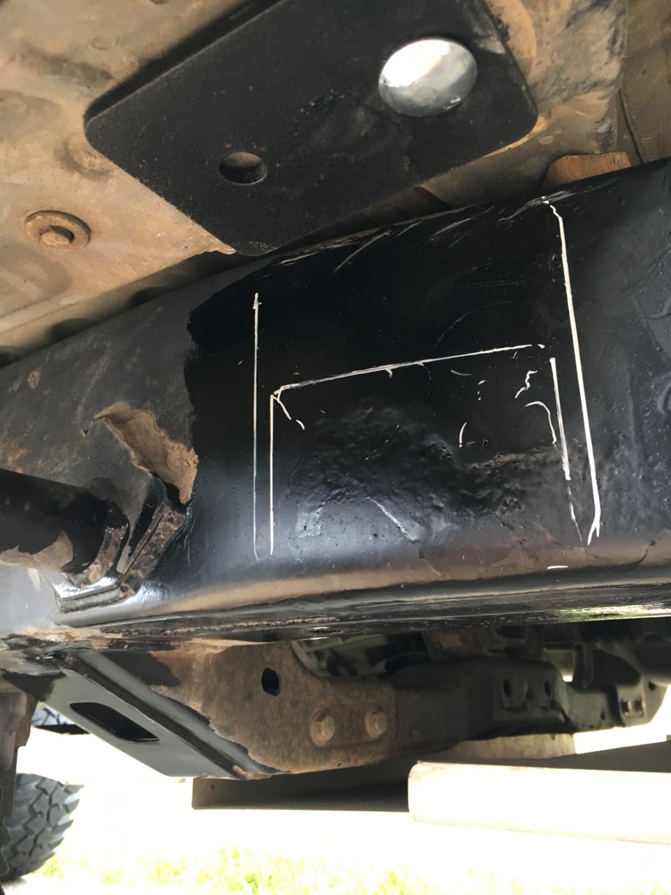

    For those out there still waiting to burn these in @HomerTaco, just thought I’d share some lessons learned.
    1st.
    Don’t fuck around with cheap cutting wheels. The cheaper off brands I had on hand disintegrated in no time.
    After I burned through the Cheapos I picked up a pack of DeWalts and they were superior in every way. Cut faster and didn’t fall apart. If you have a plasma cutter....fuck you.

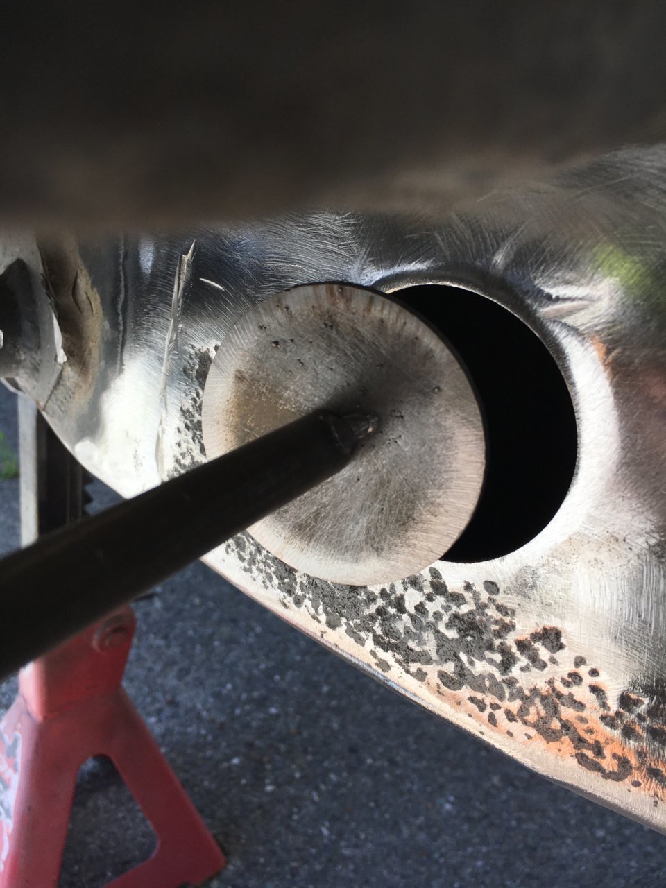

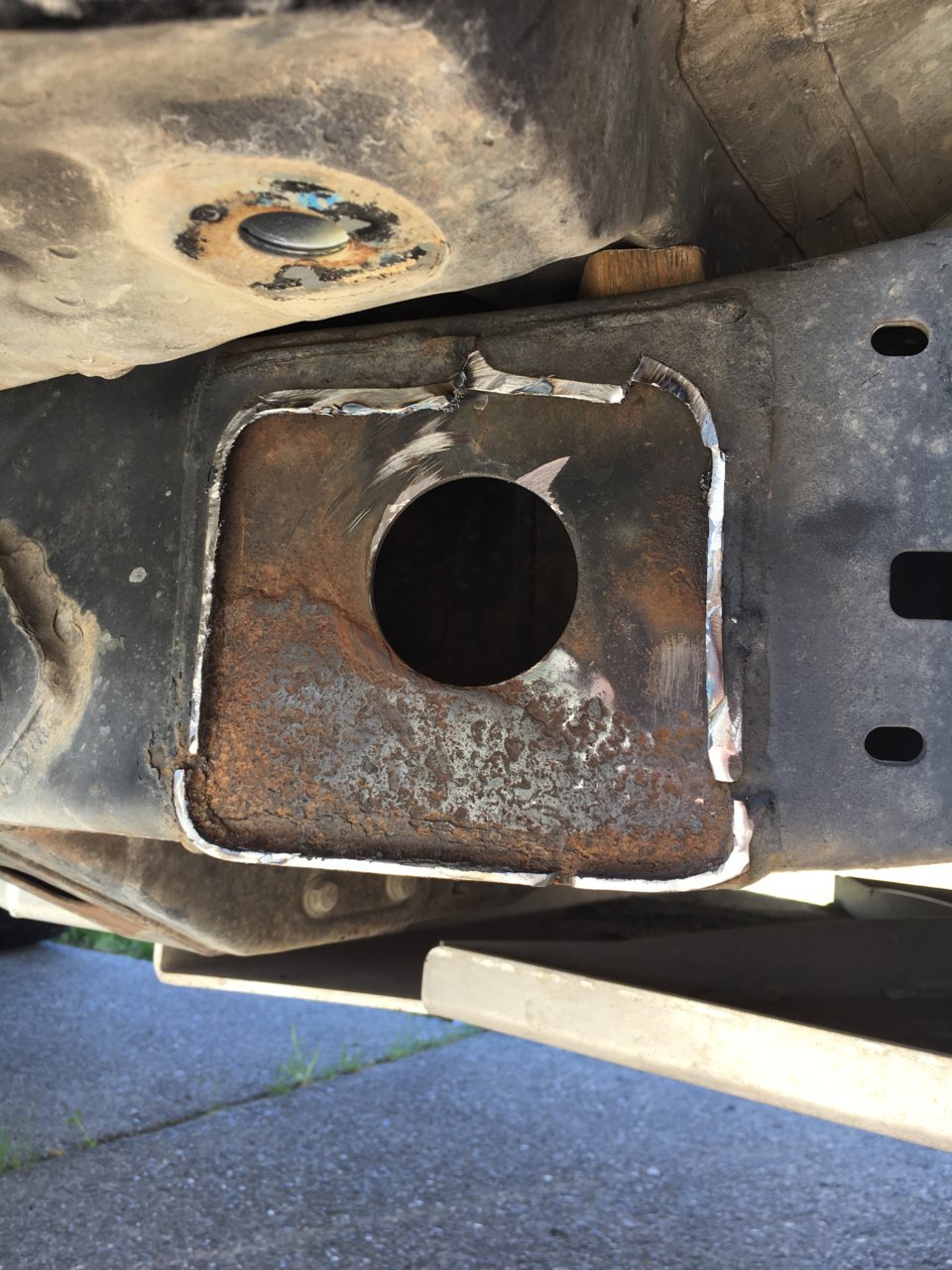

    2nd.
    I found it easier to get the hole plug plate in place by tacking it to a rod then inserting it into the hole. I tacked the plug in place the broke the rod off.
    Notice the pitting up there? Yeah, me too and we’ll get there.

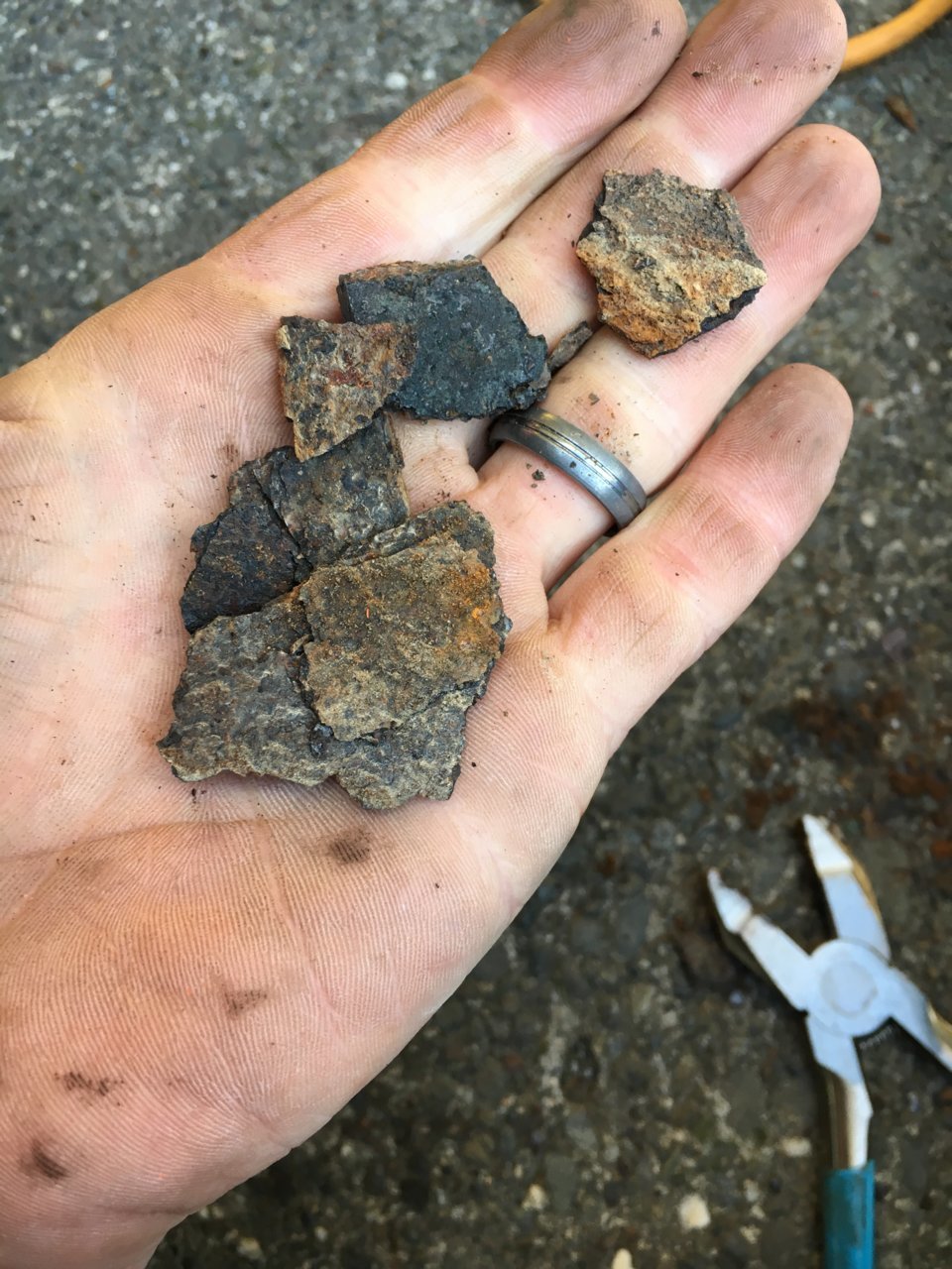

    3rd.
    The frame behind the cab mount was fucked. 12 years of the elements, and some beach driving took its tole. This is a handful of frame that fell out after I removed the stock mount.
    The lower left portion of the area inside the old cab mount in the above picture is what fell away into my hand as seen above, leaving that section of the frame thin.
    The lesson learned here is, if you have that amount of corrosion, you need to turn down your welder accordingly when welding the plug in so you don’t burn a hole in the frame. It doesn’t take a lot of juice to melt that plug in.

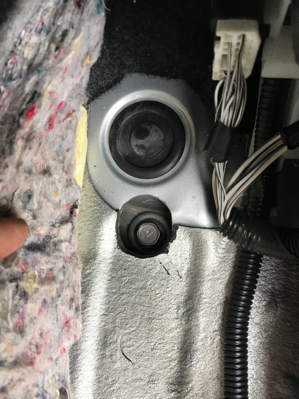

    Don’t drill the hole throug the body until the mount is welded in, or at least tacked in. This will keep you from drilling that hole slightly out of place. Also, when you hole saw the floor board make sure you use a hole saw larger than the washer that has to pass through it... yeah, I’m that guy. Had to bore out the hole with a dremil.
    You can see it’s a bit oblong towards the bottom. I had the right size on hand, just chose incorrectly.
