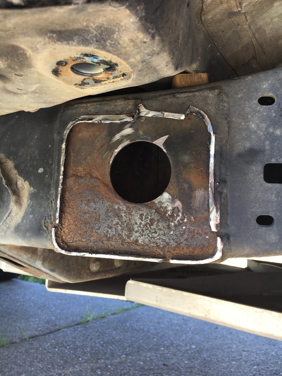

    I would highly recommend no one run open cab mounts unless you live in a desert. If you cut it open and don’t plate it you’ve basically made a little snorkel that sucks up water, mud, and road debries into the inside of the boxed portion of your frame. I ran mine open for about a year and spots of the frame inside the mount were paper thin from corrosion.
