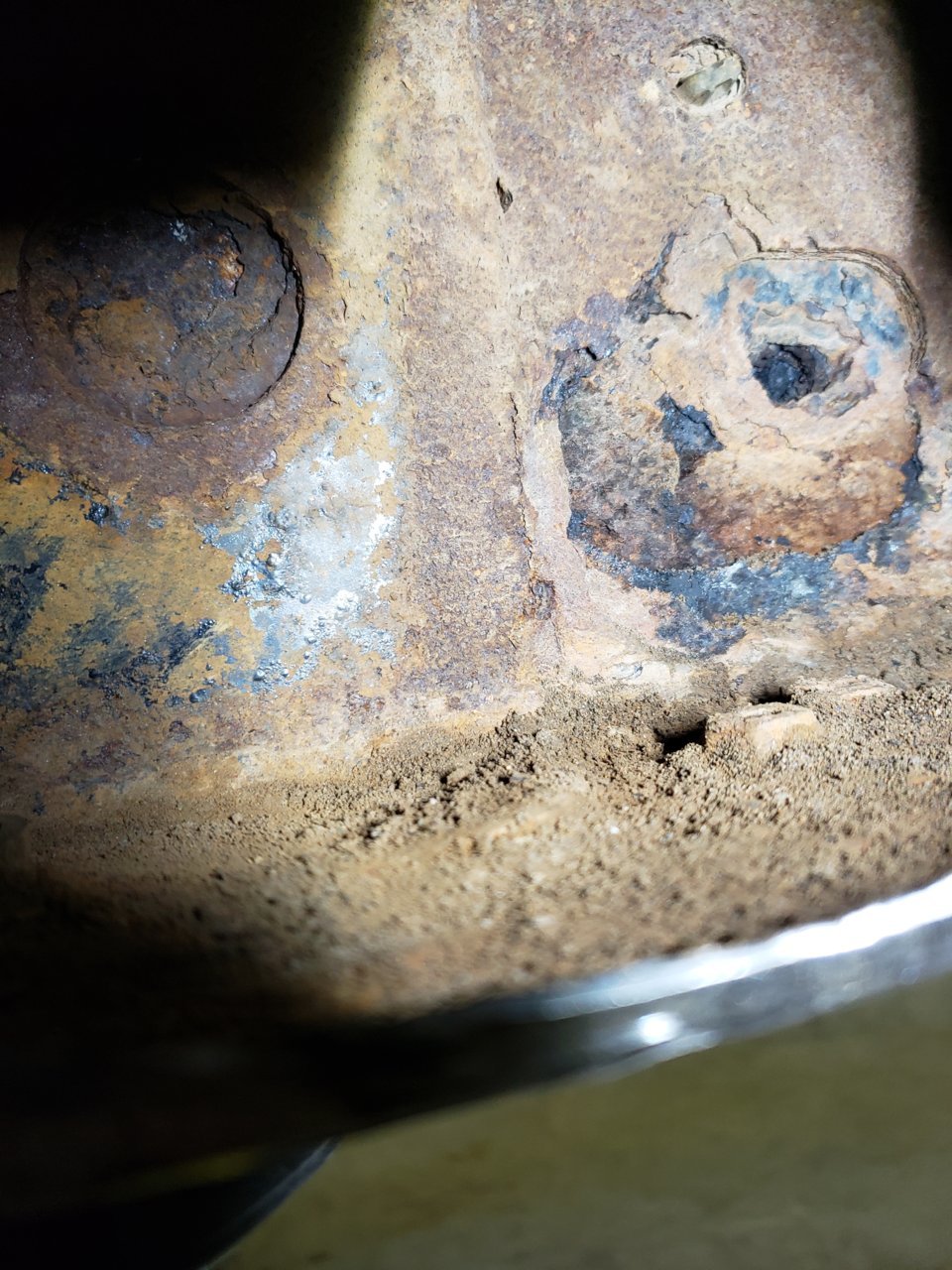

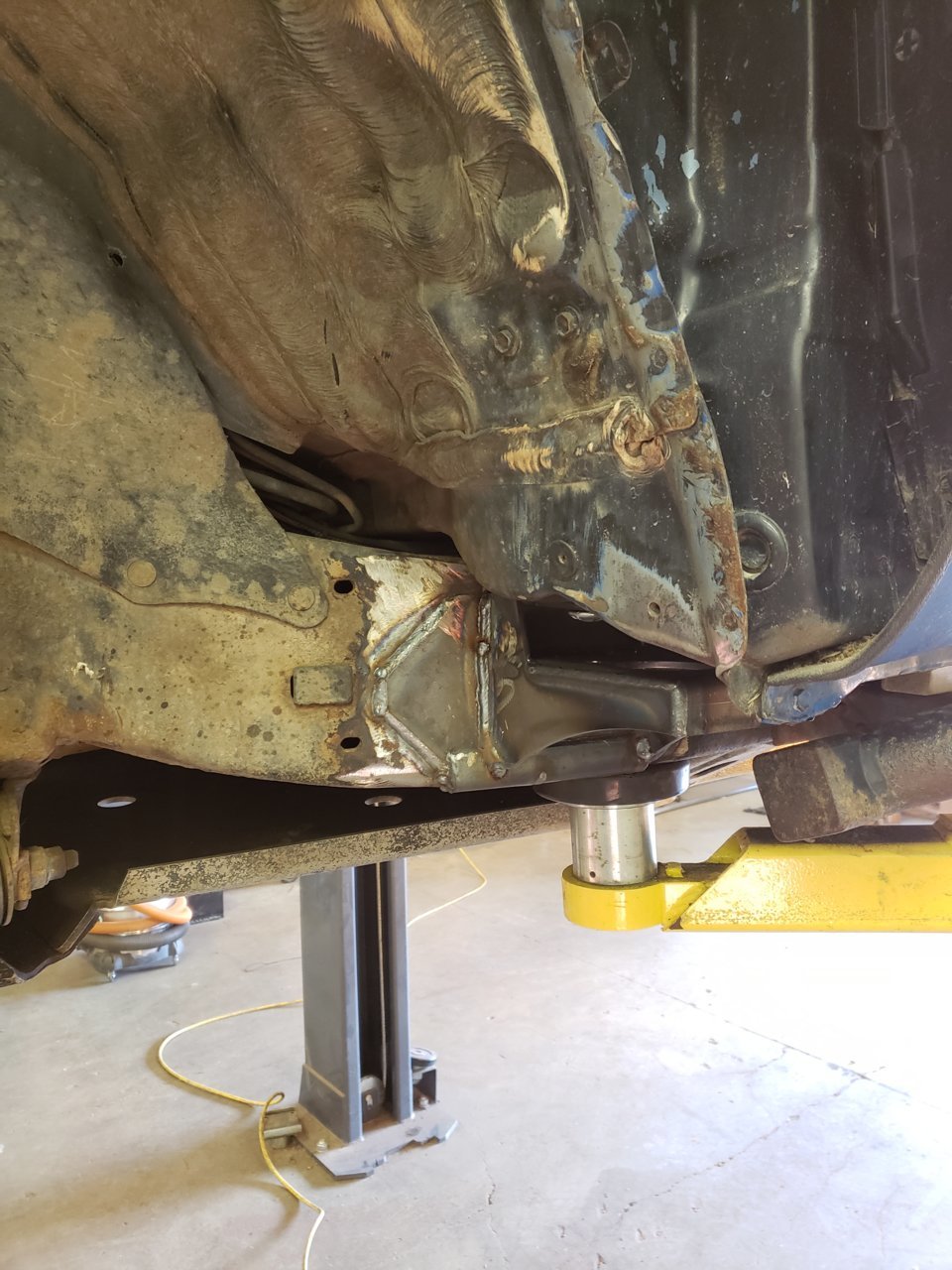

    Started on mine today... Driver side is done. Big holes in the frame behind the body mount and the metal is super thin the welder kept blowing through. Had to do some hack job frame plating. Definitely slowed down my progress.

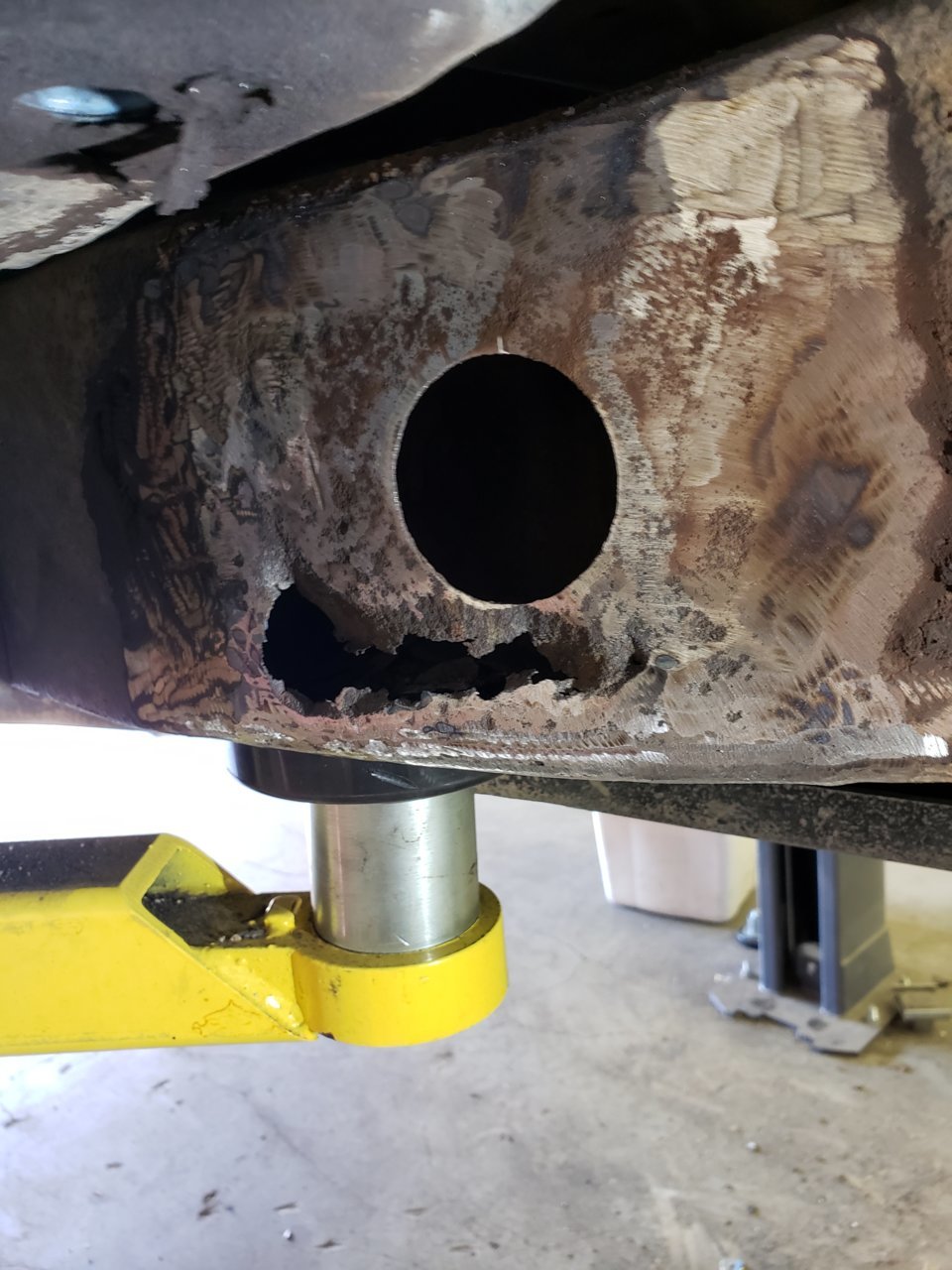

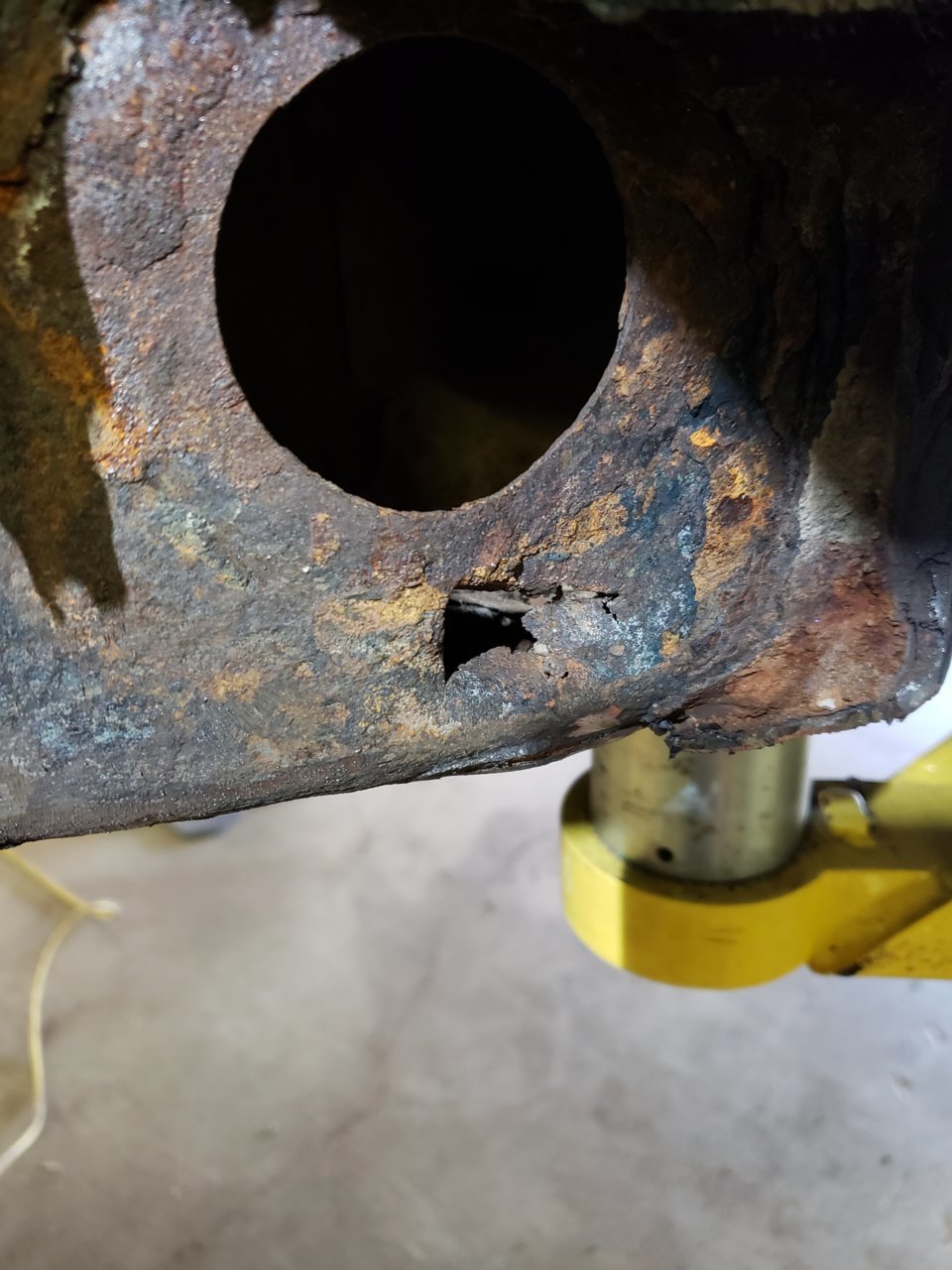

    Was even worse on the passenger side. Kinda annoyed that Toyota denied my frame for the recall twice when it looks like this.20200309_141136.jpg 20200309_143702.jpg
    Oh well, all done now.

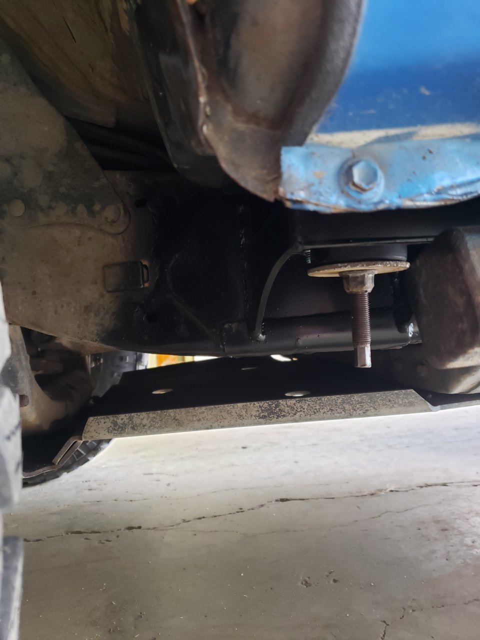

    Got my relocate done this weekend. 35s barely rubbed the cab mount bolt but with 37s it was almost undrivable. Love the kit, i think if I rub anymore on the firewall I can tub a little but I need to look into moving the wheel forward.
    Before
    Bolted the mount up
    After the 12lb sledge
    So far no rubbing for around town driving even in reverse, I tried flexing a little on a ledge and still didn't rub but I wasn't fully flexed.

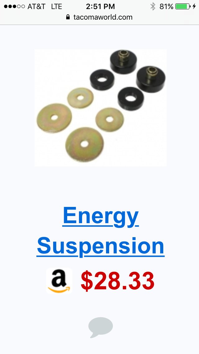

    So i assume I need to buy these to work with the kit?
  18. Apr 15, 2020 at 2:10 PM
    #438
    CGoss
    CGoss Well-Known Member
    Jul 13, 2018
    #259230
    501
    Las vegas
    2006 rad red offroad
    It works with factory bushing.
    Oreo Cat[QUOTED] likes this.

    Is it worth the $30 to replace?
  20. Apr 15, 2020 at 2:24 PM
    #440
    CGoss
    Jul 13, 2018
    #259230
    501
    Las vegas
    These are the correct ones. I'm not sure what the others are for. At 90$ it's up to you. Mine were cracked when I did it and probably should have replaced but poly bushings cause a bit more vibrations in the cab so their not for everyone. If OEM aren't too expensive I will just replace with OEM parts.
