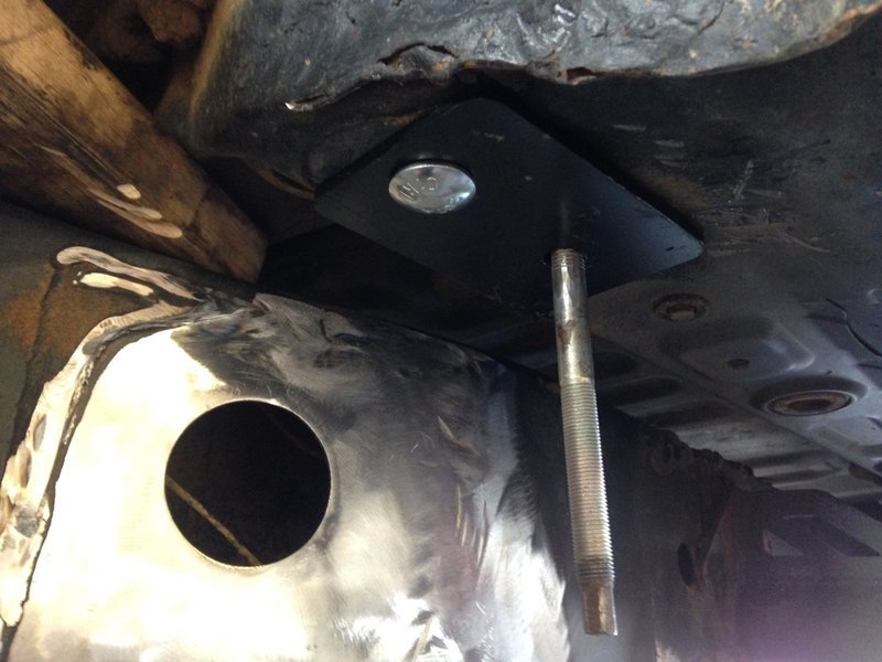

    I get the smaller, front bolt goes in with the threads facing UP, but I mean the longer, rearward bolt that goes through the body bushing. That should be no where near the tire since it's approx 3" behind the smaller, front bolt.
    does that make sense? Can the longer bolt be installed thread down (it wont contact any tire or anything since its so far rearward)?

    Yes! Thats how mine is installed. Thread down through the new mount.

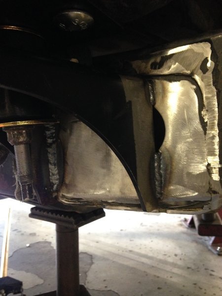

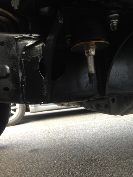

    Very pleased with the end result. the worst part is grinding down the stock weld for their mount. THAT WAS BRUTAL.
    Everything else, as far as these actual mounts are concerned, is legit. Great product!
    While I had the mounts off, I went ahead and changed the body bushings to the polyurethane Energy Suspension bushings. After 6 years of abuse, the stock ones were done

    Any reason you didn't fill the hole in the frame?
  10. Oct 19, 2016 at 9:21 PM
    #170
    Skootter14
    Skootter14 Upon my signal, unleash Hell
    Jan 1, 2011
    #48576
    4,655
    Jeremy
    '11 TRD Sport 4D LB 4x4 Metallic Grey
    "a lot of stupid stuff" -Wife
    I chose not to because after mock fitting it all up, the rear edge and all of the upper horizontal piece is flush with the frame and that little 1.5" gap in the front (to me) isnt going to make a structural difference of worth. I welded the front and backside of all edges, minus the top part of the horizontal (obviously you can get to it so thats the only reason I didnt). But that mount isnt going anywhere with it due to how much space there is to weld regardless.
    To me, it wasnt worth the extra time. I did think about it but after seeing how it would sit once complete, knew it wasnt going to have any negative effects. Thats just me. These mounts are solid though.
