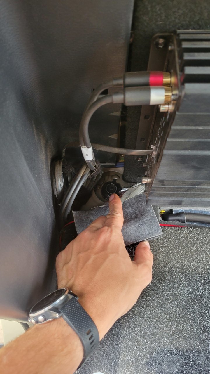

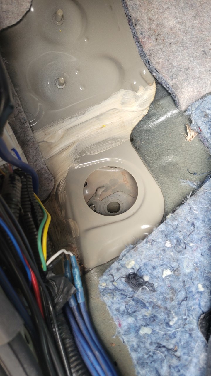

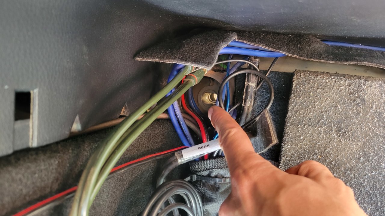

    For DCSB and DCLB Tacos, see the attached Diff Whine TSB for rear body mount access. This is not necessary. I am removed that TSB. There are two carpet flaps in the small pocket outboard of the rear seats. If you pick these flaps up, the Body Mount bolt cap is right there. Zero need to pull the interior back panel. This greatly simplifies the installation.

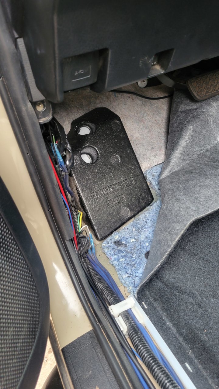

    -- Pull the plastic front door sill covers and kick panels. Under the kick panels / carpet are two foam blocks. The passenger side just pulls back. The drivers side needs to be unscrewed. Kinda of a pain.
    Under there, there will be a big plastic cover (about 2in). Pull those out.​

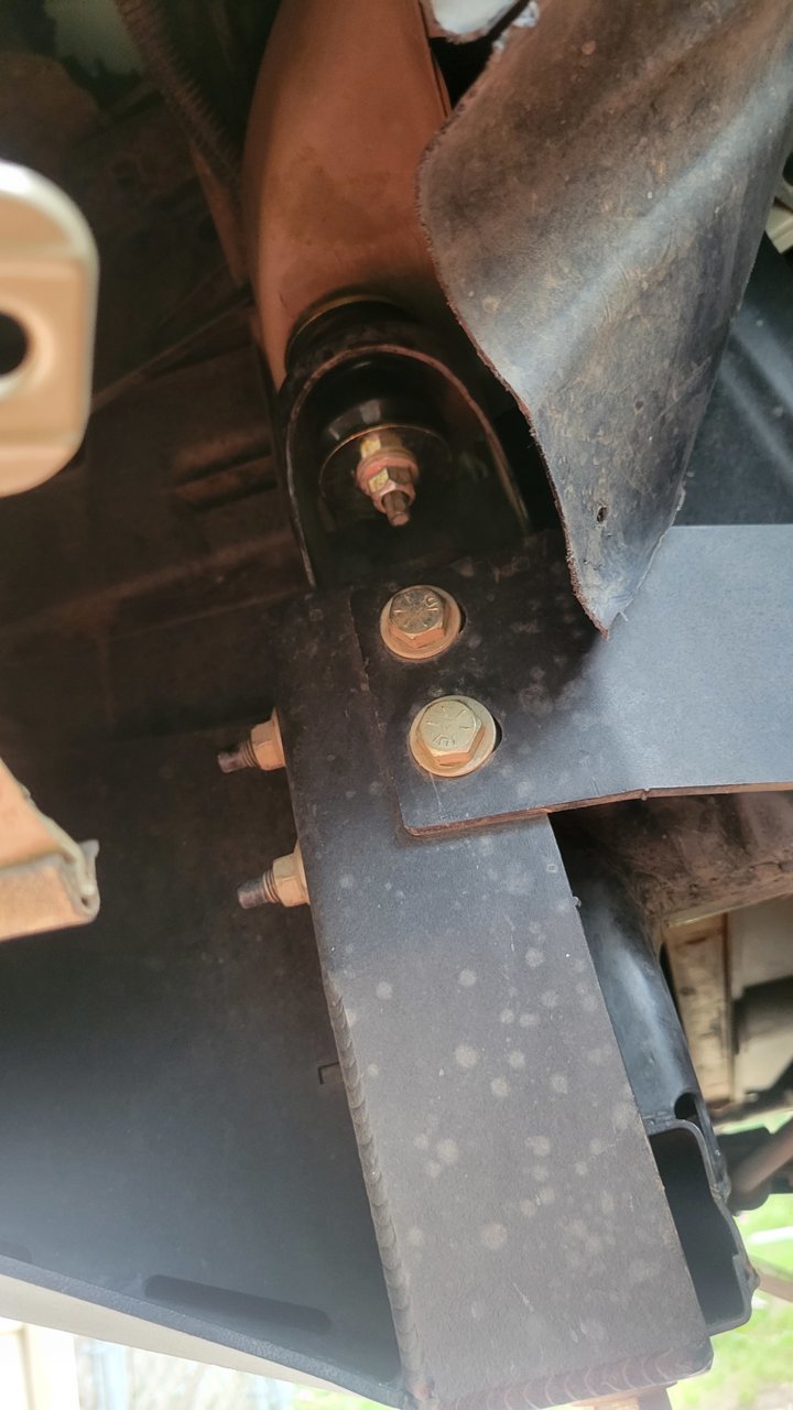

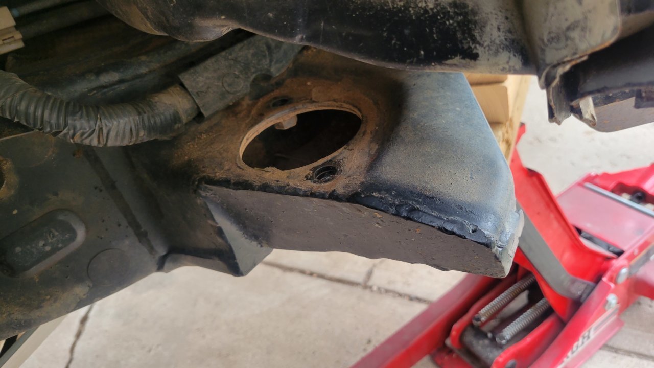

    -- Remove the lower parts of the three body mounts on the side that you are working on.
    -- Use a jack with a board on top to jack the pinch weld near the middle of the front cab. Only go up enough to get your hand in between the frame and cab.
    -- Use a 14mm ratcheting combo wrench to remove the rear two OE mounts. The fronts come out by hand.
    If you need to, jack just enough for the mounts to clear. I used a cheater wrench setup to loosen and tighten these. No easy way to get a torque wrench in there.​

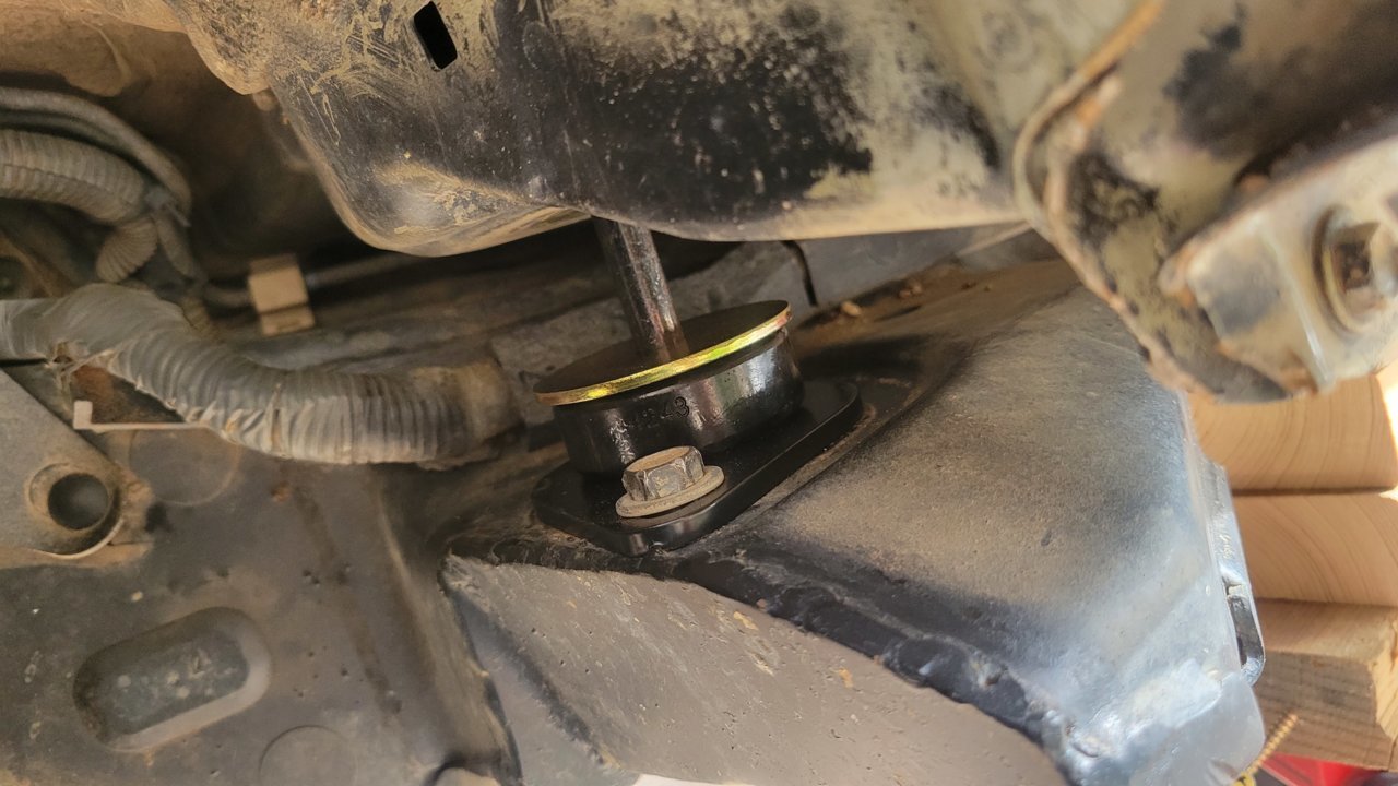

    -- Reusing the 14mm screws, drop in the diamond plates from the kit. Even though there are slots, they only fit in one position.
    -- I lubed my mounts, sleeves, and washers with marine grease.
    -- Drop in the mounts per the instructions.
    -- Lower the cab slowly and fasten them loosely.
    -- Repeat on the other side.
    -- When you are done, torque per the other attachment in the 1st Post.
    -- Reassemble the other parts of the Taco. The orange clips for the fender to bumper might be the worst part of the job? It needs to go between the bumper and wheel well while engaging a metallic bracket above it. Stupid setup.​
    I do believe because of the lube, the cab just settled in once all six were installed. I didn't need to do anything and all six were aligned well and the cab looked great.
