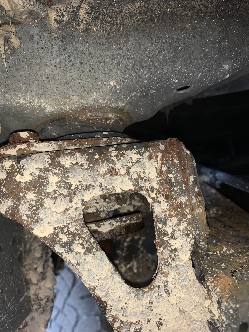

    I’ve been chasing this roughness on my truck when hitting bumps for awhile and spent to much and still haven’t got it fixed. But I think my body mounts might be the cause of my rough ride when hitting bumps. Down below is a pic of one of mine, they all look like that with the gap. It doesn't look right to me but maybe I wrong.

    Can you spin the washer by hand?
    It should be flush with the rubber mount.

    No but in the picture you can see there’s like a 1/4” gap

    i would try taping the washer with a hammer and see if you get movement from it. That does look like a bit of slop in the bolts if theres nothing between the rubber and washer.

    Yea doesn’t seem right to me, there isn’t anything between them. I’ll try that tm! I’ll let you know! Thanks!

    I gave it few taps this morning and the washer is solid with the nut it seems

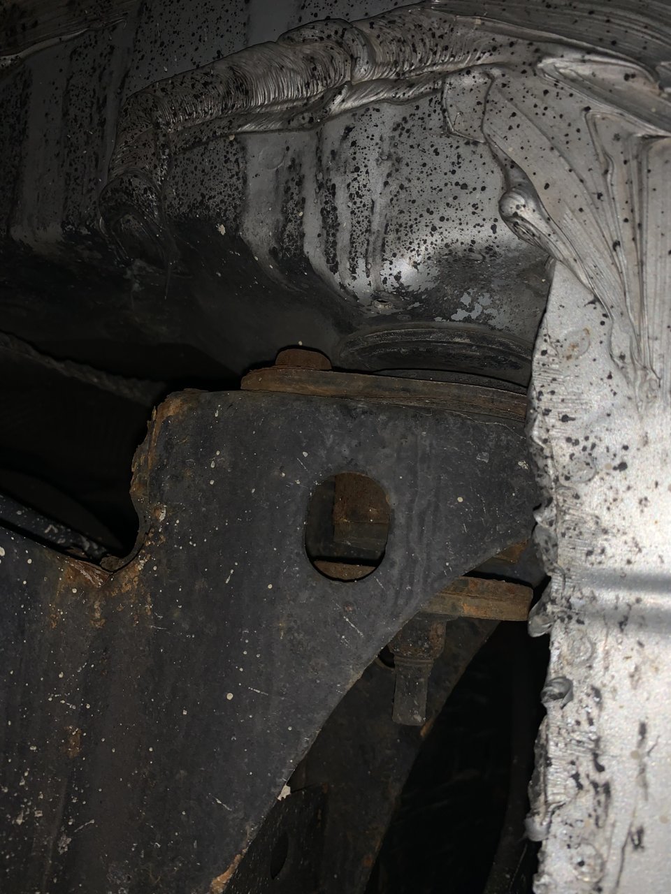

    Not sure if you can see it better in this pic but it looks like there is something in that gapCE516AE9-5CEA-4E13-81E2-29467751C80A.jpg

    I took a pry bar and The frame moved from the cab pretty easily

    Tighten them up and go for a ride!

    Do you know the torque spec? Thought it was 34ftpd which if it is then they are way tighter
